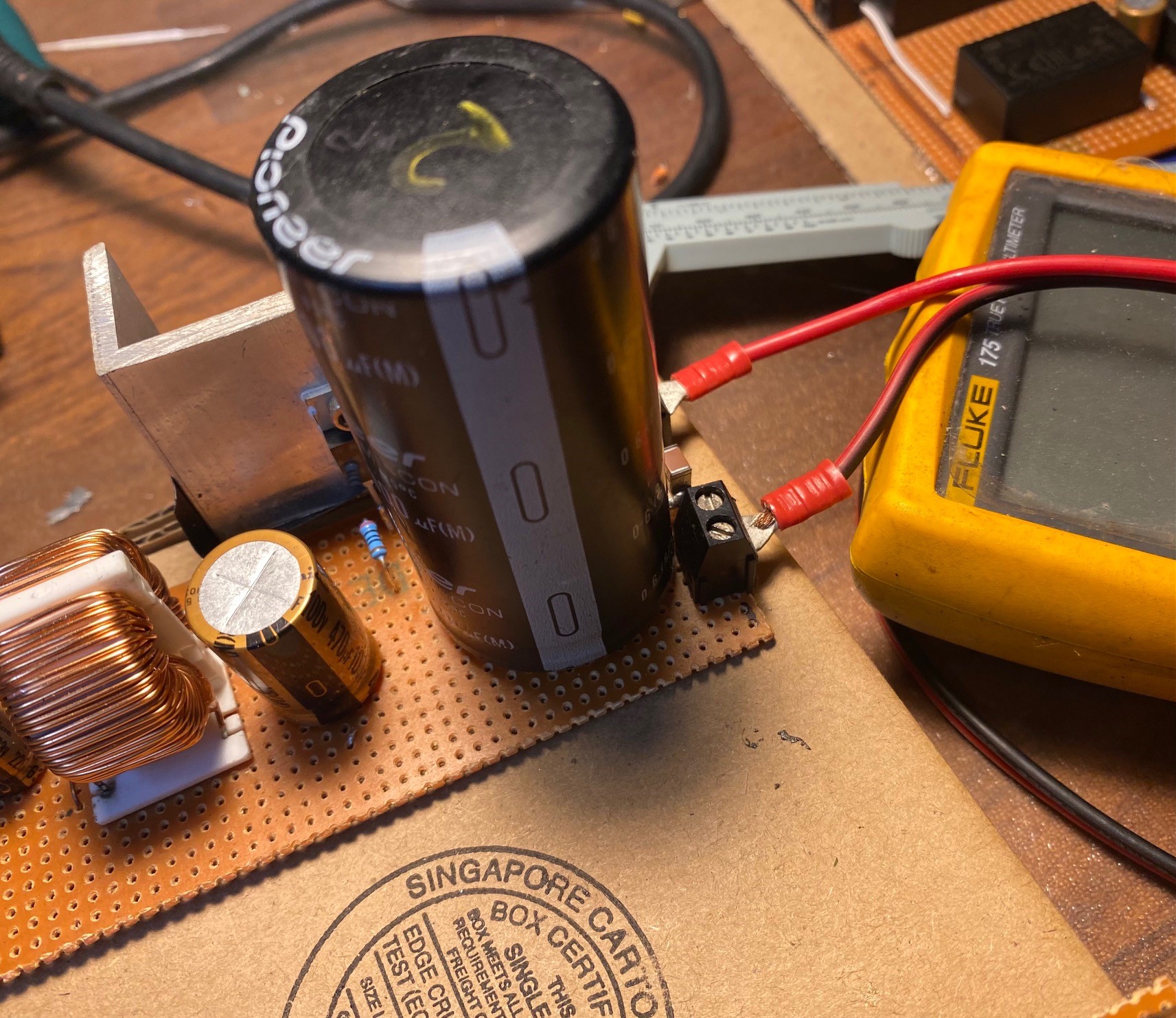

Excellent! Please tell members here the voltage dropped (the reduction) from input to output of your cap multiplier, so they can decide whether it would be acceptable in their own application.
That's a good point - I tried a number of logic level mosfets. The one with the lowest drop was the IRL640. With this mosfet, at a load of 1A, the voltage drop was about 2.5V. That total drop includes some (0.3V?) dropped across the passive filter too....
The schematic i used was (post#51): Mean well vs generic power adapter vs audio oriented smps

Built mine on veroboard! 😀

Very good point about the ground being noisy in a poor setup preventing meaningful measurements. I used a differential configuration (pin 2 to PSU+ and 3 to PSU- on an XLR, using blocking caps in both) to feed the ADC it seemed to help reduce common mode noise. I just got the boards from konst so I'll get a couple of filters built for experimenting.
