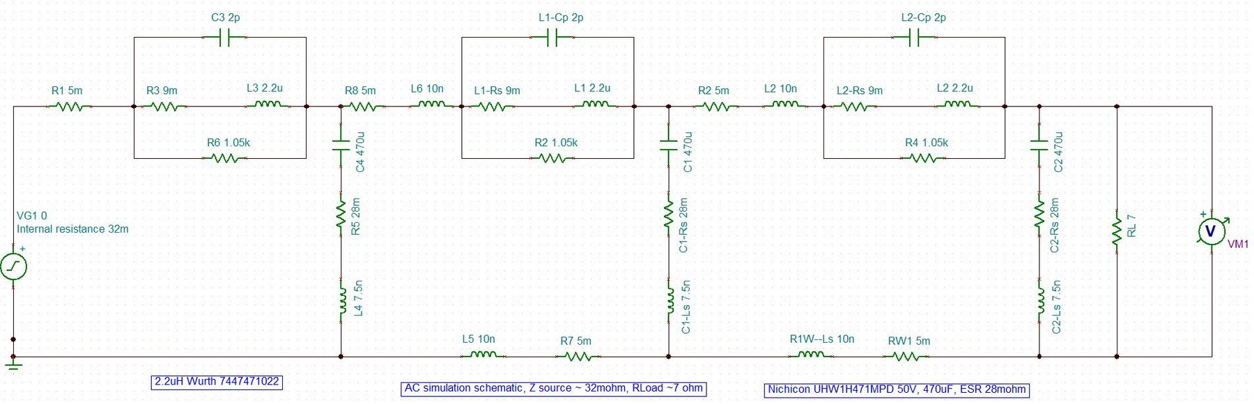

PO89ZB, an inline DC filter for SMPS wall warts. Preamps, HPA, Korg NuTube, etc
Yes, one could cascade two of Mark's filters in series for a 4 stage filter, but acccording to him it is limited to 3A.
The above three stage filter could easily handle 6A, which was my main motivation for application on a TPA3251 or TPA3255 amplifier.

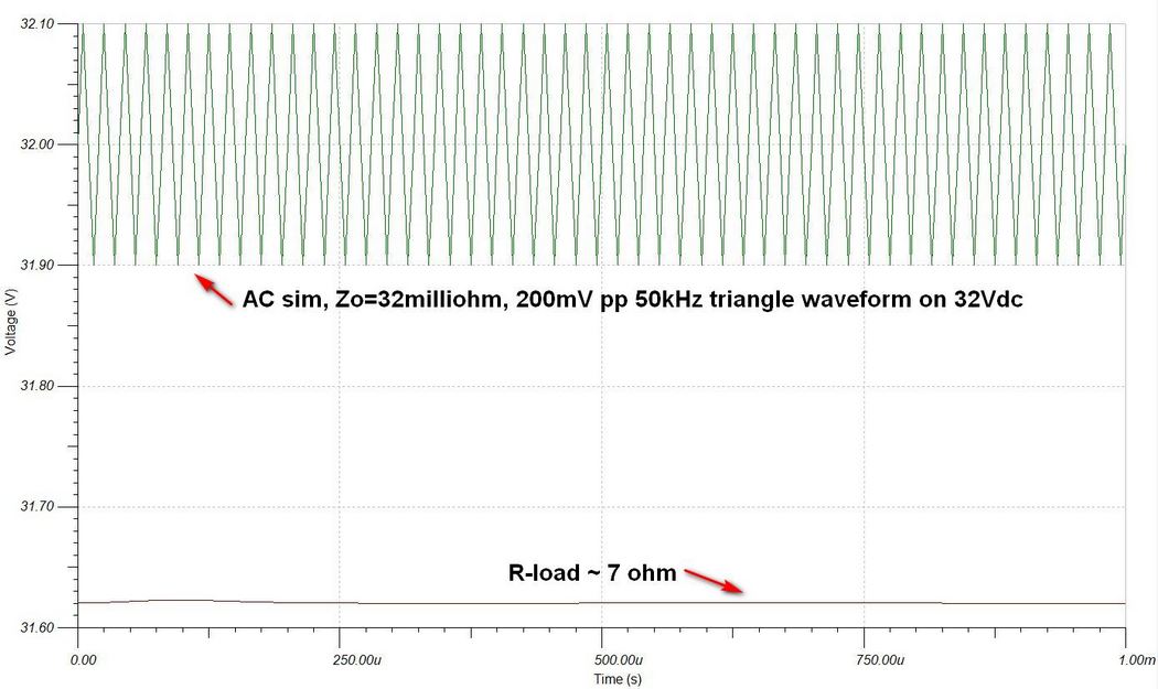

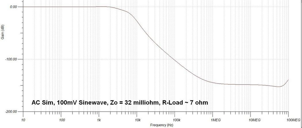

These simulations assume the source power supply (SMPS) output impedance is around 0.1 ohms, which seems like a reasonable simulation guess for a 32V 5A power supply. I have been assuming the load can range from around 500 ohms to 7 ohms. The application is for a cheap PS driving the Aiyima 04. The PC board RLC parasitics in the simulation are an educated guess. I may go measure the SMPS output impedance, later.
I grabbed the datasheet of a fairly typical 150 watt SMPS, made by Mean Well, attached below. It says the output voltage's load regulation (0% to 100% of full rated load --- page 2 row 9) is plus or minus 0.5%. So on a 5A, 32V supply that'd be 0.16V, giving Zout = (0.16 volts / 5 amps) = 0.032 ohms. The entire 5A current path would need to be similarly low impedance, to avoid excess voltage sag.

Simulation can only give an approximation of reality, but the SMPS source impedance change from 100 m-ohms to 32 m-ohms gives the same result. The true test is in measurement and results. :dice:

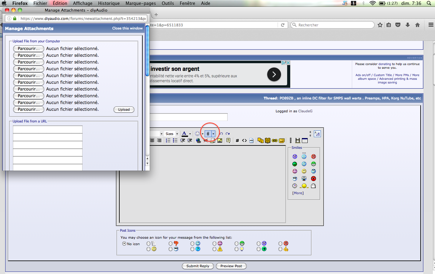

It seems the image attachments must come from a hosted site URL. I tried drag and drop, but it seems corrupt the forum web page.:irked:
https://www.diyaudio.com/archive/gallery/index.htmlhttps://www.diyaudio.com/archive/gallery/index.html
"Please note: This is a permanent archive. Due to this gallery module becoming incompatible with the latest version of the forum software, we have frozen/archived all old galleries (and their images) and made them read-only. No new images can be uploaded, all old images are still accessible, all images and links to those images will still work, and this archive will remain permanently....."
Are you sure you use that function for attachements?

This is a re-post of the 3 stage filter from local image (not hosted elsewhere).
This is an experimental design 3 stage filter for 36V 6A application, one could use the 63V capacitor for 48V applications. Waiting for parts.
