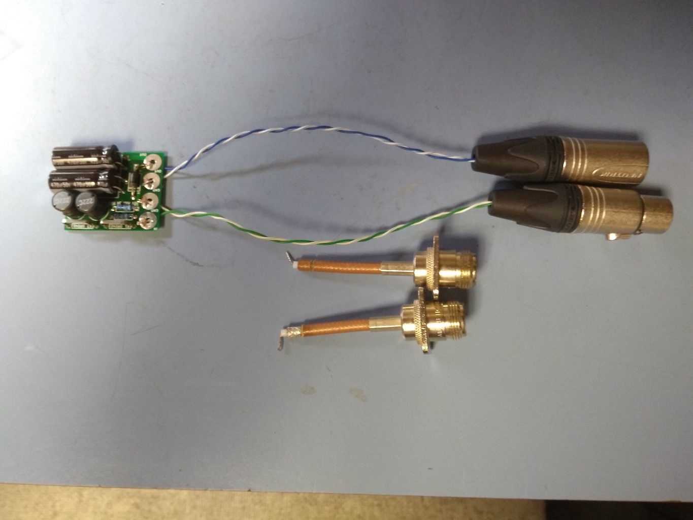

BTW the answer was to built the PO89ZB IN the devices when these have SMPS adapters/wall warts. Why making more mediocre connections with 2.1 or 2.5 mm connectors than necessary? When built in there will be just 1 x 2.1/2.5 mm connector as the bare minimum which is good. When the device has built in SMPS the PO89ZB can be put in between as well.

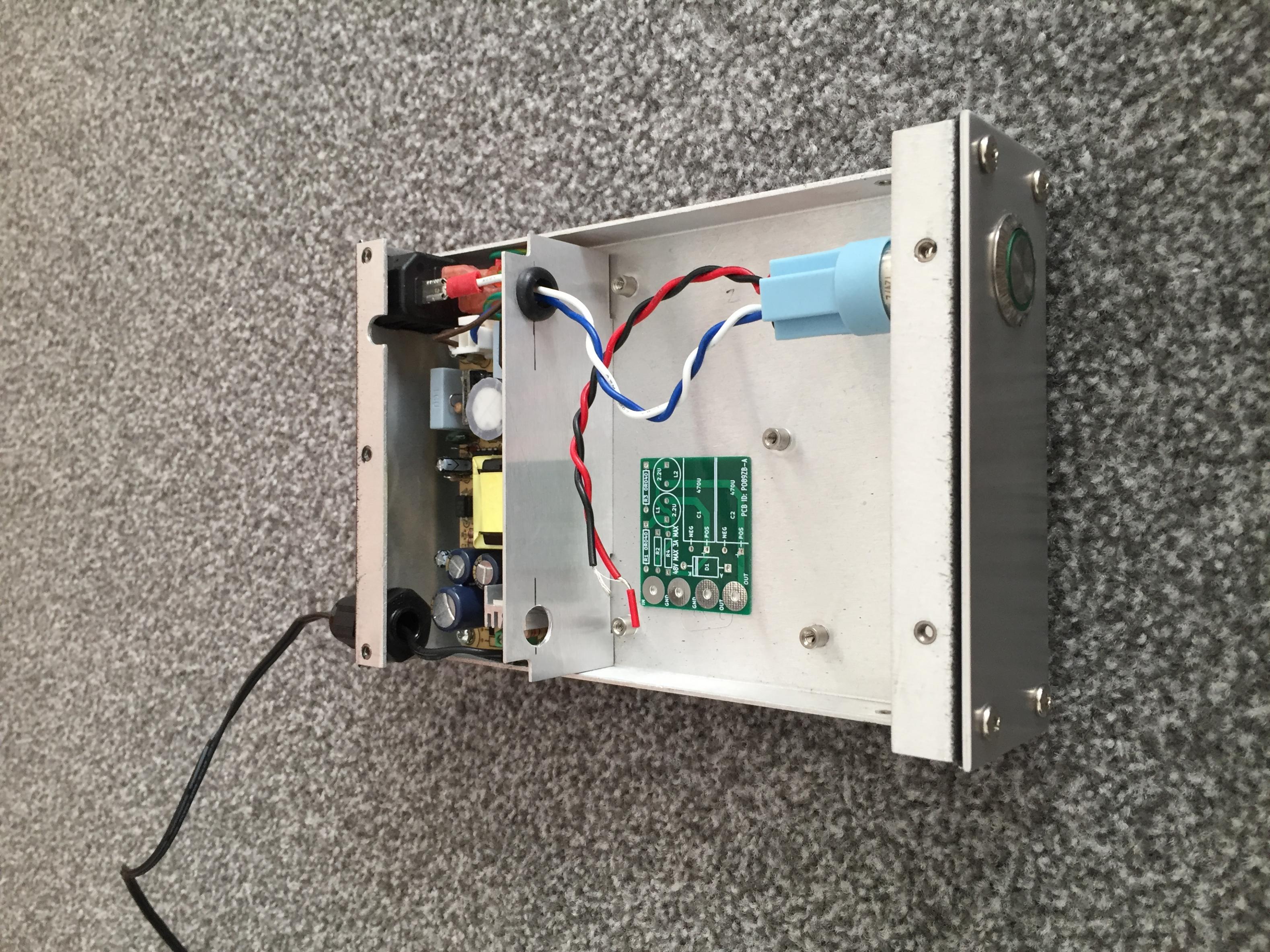

Here my second implementation but this time some of the parts are out of stock. This will be probably one of the last attempts with SMPS for my sources. All the well built (but factors more expensive) linear PSU's win by a margin but one must keep an open eye and do some experimenting IMO. In a previous one the PO89ZB was a good improvement.

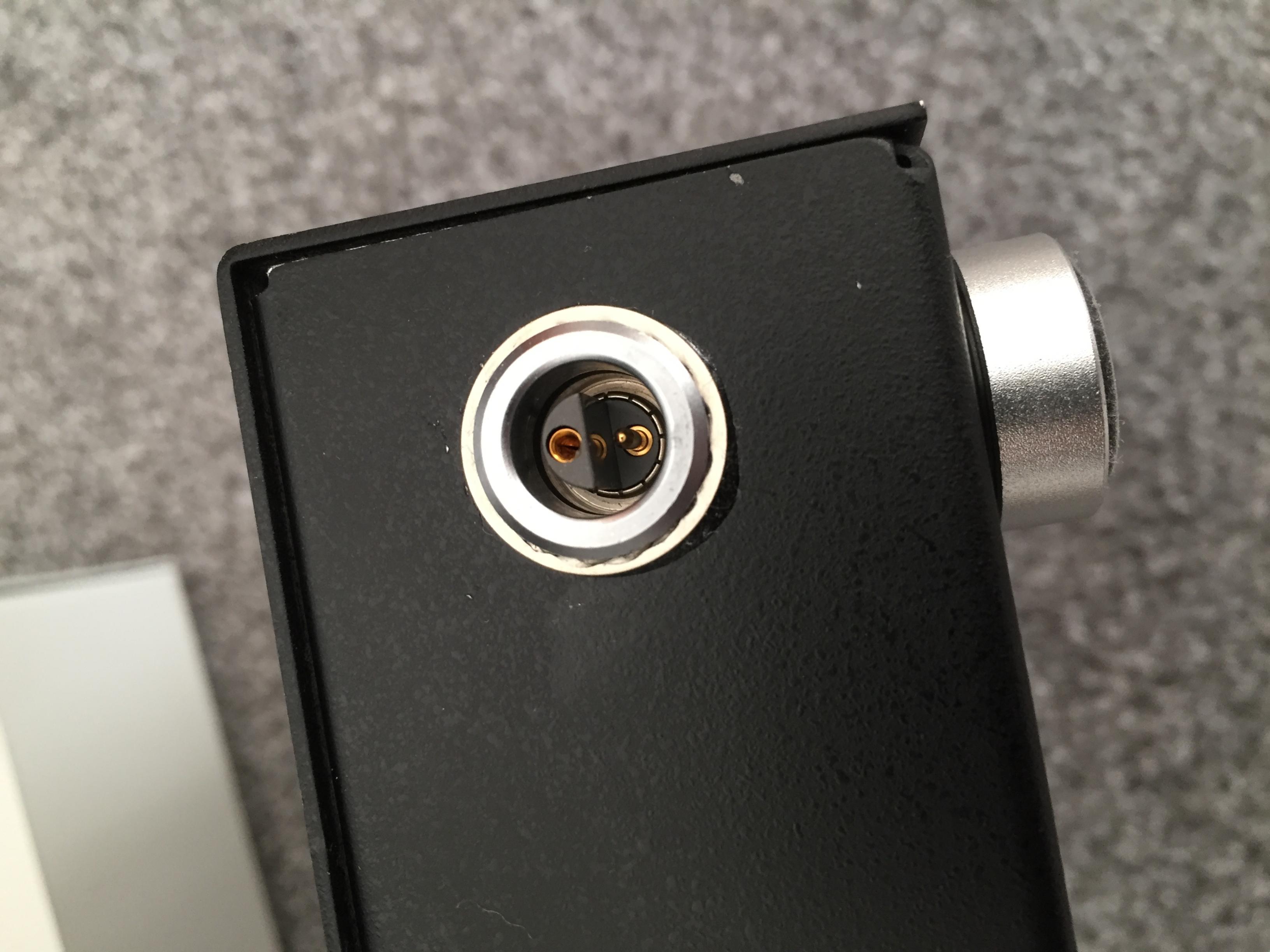

As a better connector I tend to use Lemo whenever I can. These are mechanically and electrically very well designed. These do have a retention mechanism which is often omitted with cheap connectors.

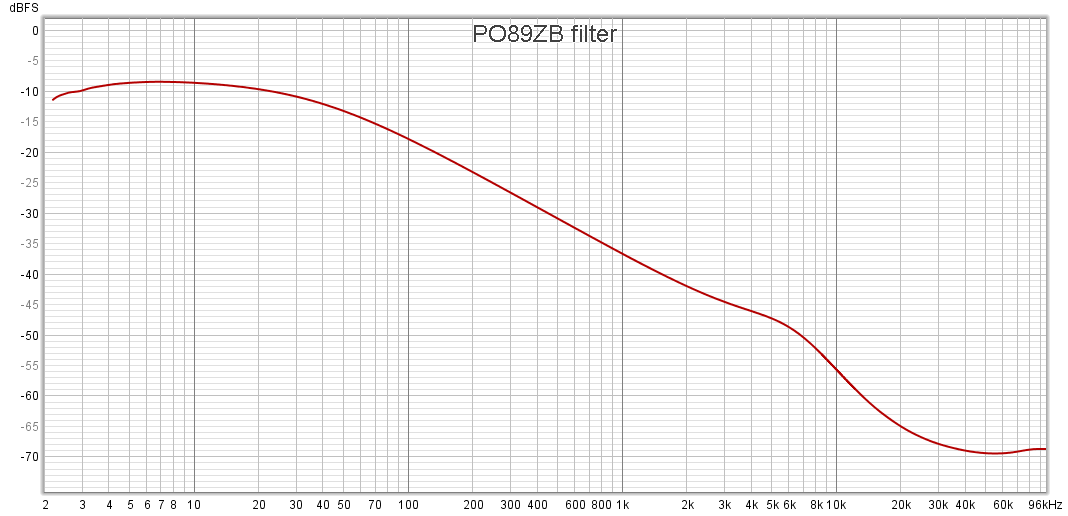

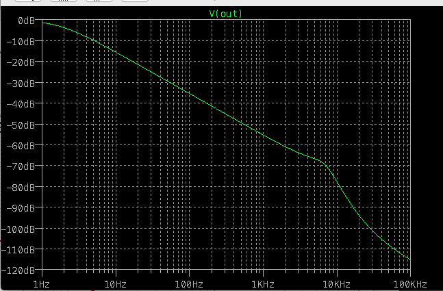

Is it me who is tired, or is that an odd result?
I know that real life differs a bit from the theory due to things not being perfect, but...
Given the layout, I would have expected 2 identical LC low pass filters in serial. That is in total 24dB/octave filtering slope and a unique Fc around 5kHz.
Here I see rather a 6dB slope (1st order filter) starting at perhaps 40Hz and possibly another 6dB/octave filter (making a total 12dB/octave slope) starting around 7kHz.
Odd?
Claude
Yes agree it is odd, I wasn't paying much attention to the low frequency response but after posting started thinking about it. I think it may have to do with the output and input impedance of the audio DAC/ADC and possibly the reverse polarity zener. R4 is there and the coils are Murata 13R22C not the ones from the BOM - they are backordered.
Sorry for the bad results, just ignore them - I'm experimenting and measuring a power filter is new territory for me.
