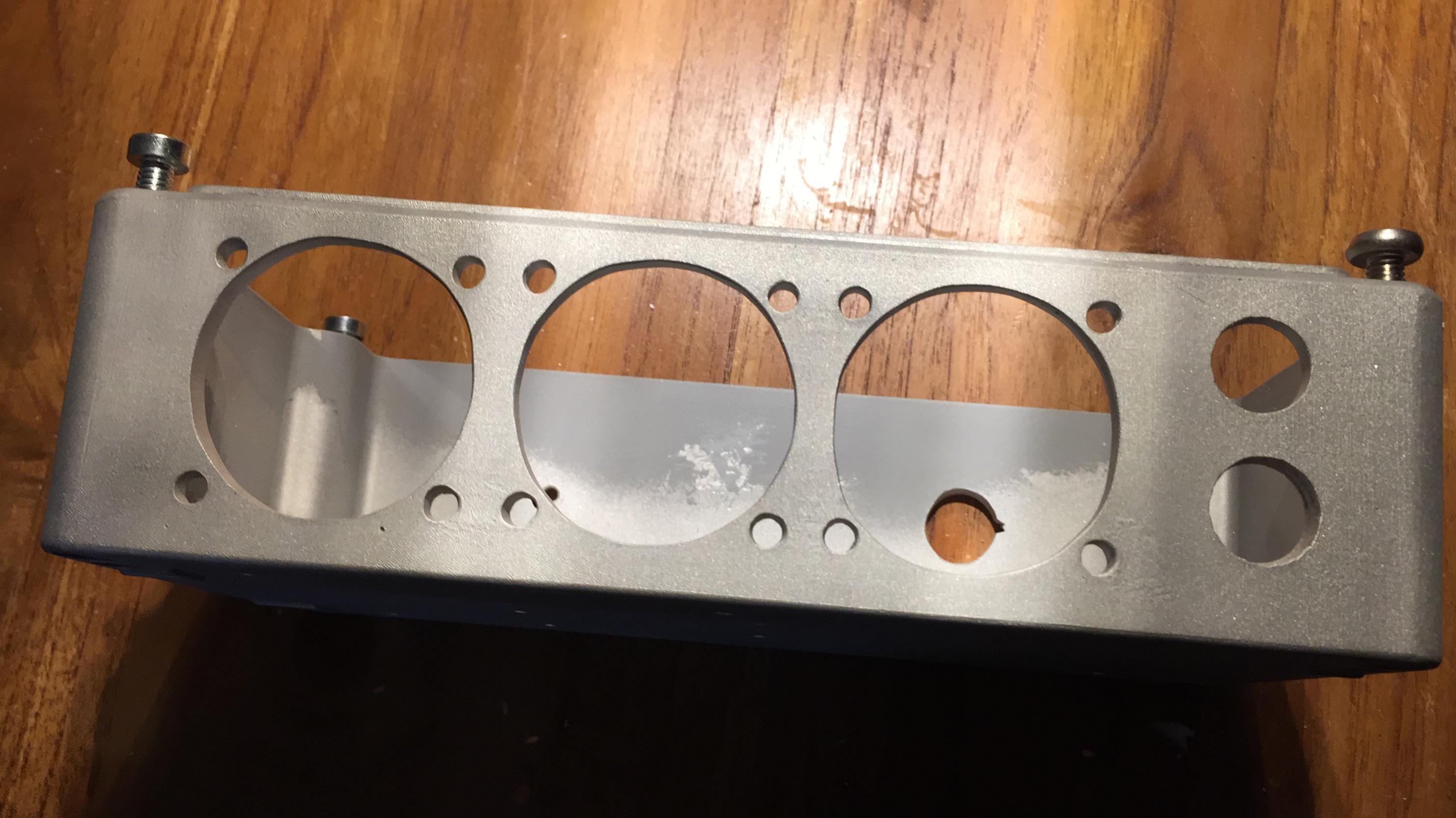

Since I absolutely hate short living unreliable cheap consumer stuff but still want to be able to disconnect all my stuff from mains at once when I leave my home I made a small solution myself. Today I brought my Netzverteiler (please pronounce that ) to the powder coater for some RAL7016. It switches 230V AC mains and filters 3 groups. German made Schüko connectors, Austrian made mains switch by Naim & Krauser, fused, shielded, PE, industrial rubber feet, the works. A 230V AC LED glows faintly red when switched off so I can find it when the room is scarcely lit. When switched on there is no disturbing LED. Just an example of how it also can be done. More work than plugging in and leaving a wall wart 24/7 for sure.
