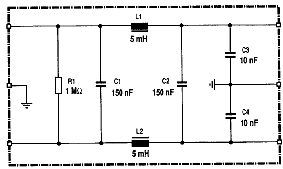

Here is its schematic. From memory the caps are WIMA MKS. Filter is OK for 50 Hz 230V/6A, Fc is 1.7kHz and slope only 6dB/oct. Loss / CC resistance through the filter is R=0.25. Depending on how you connect it, it can filters both directions if you bother with earth/ ground.

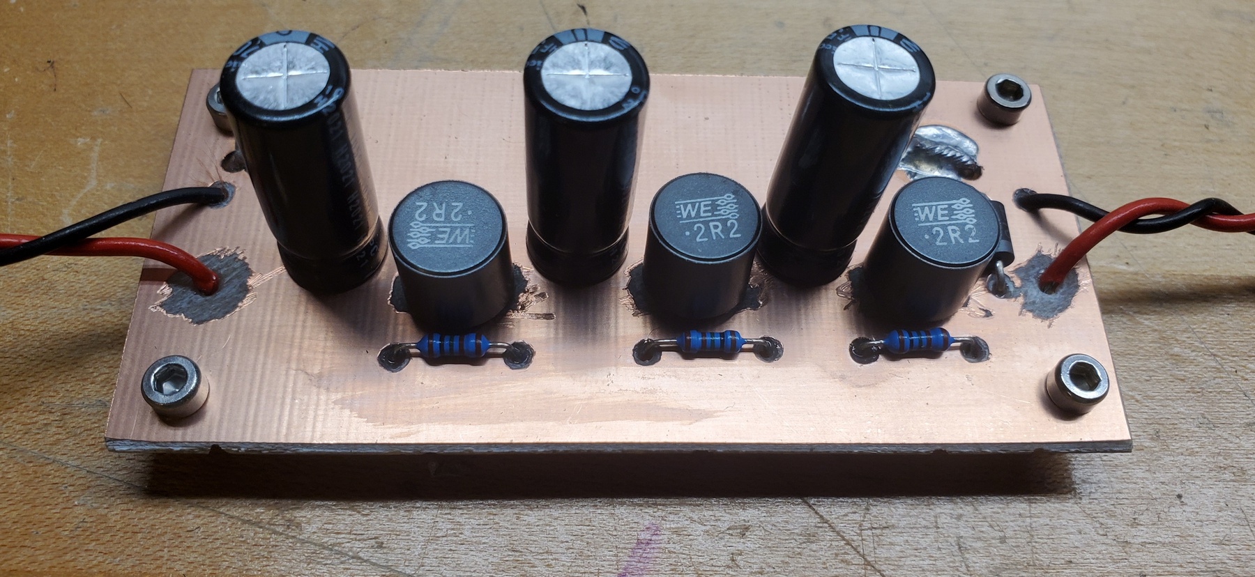

I put together my 3 stage filter breadboard, but now I realize my old oscilloscope is not stable enough for good measurements, so I ordered a new scope, so it can be re-measured next week.

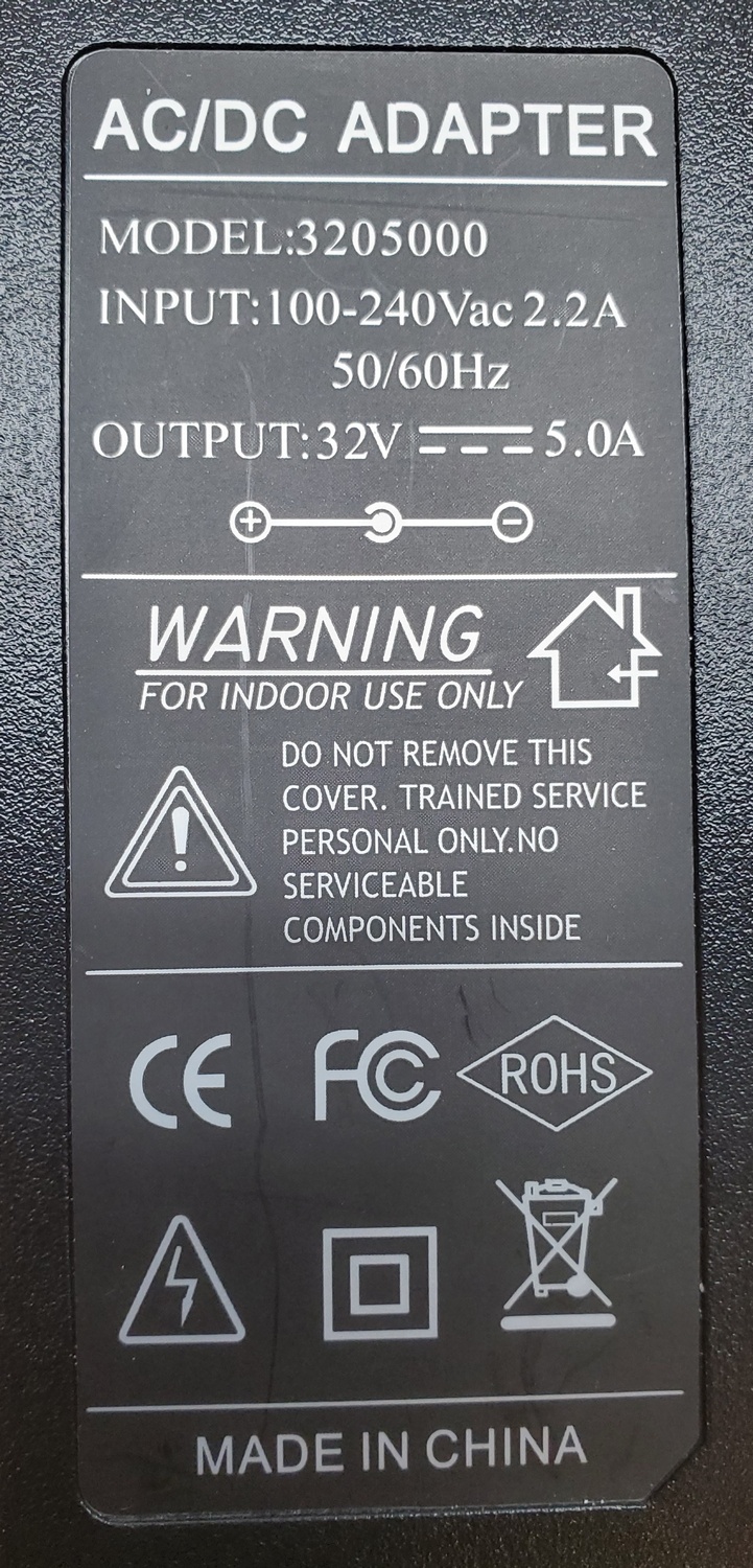

The cheap SMPS is 5A 32V, with Zout ~ 170 mohm

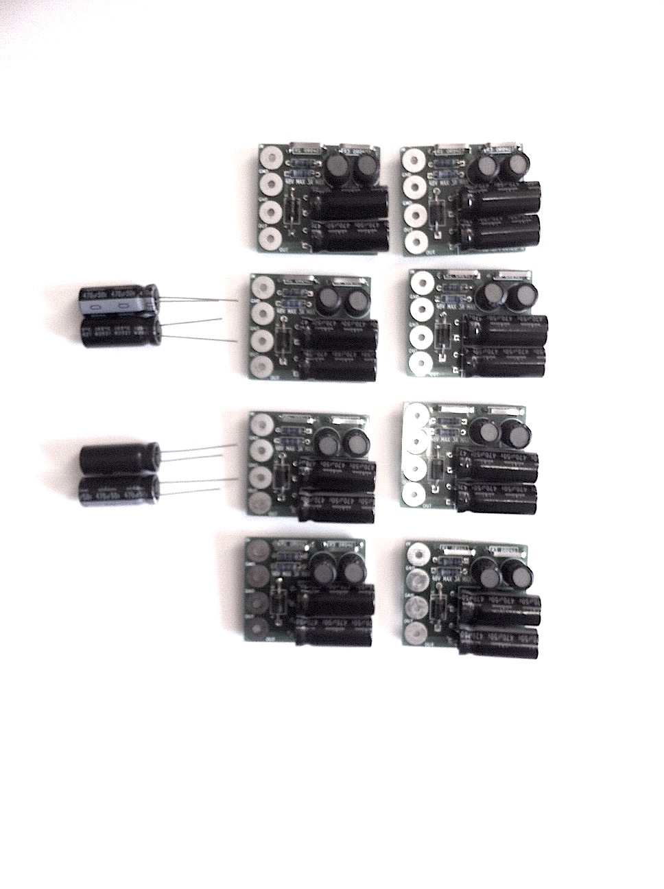

Mark's Filter Imperial Troops are all GO 🙂
Ready to join their metalic starbase(s)

PS: note the 4 extra caps in case I am not too lazy to upgrade some original filters to the latest spec
