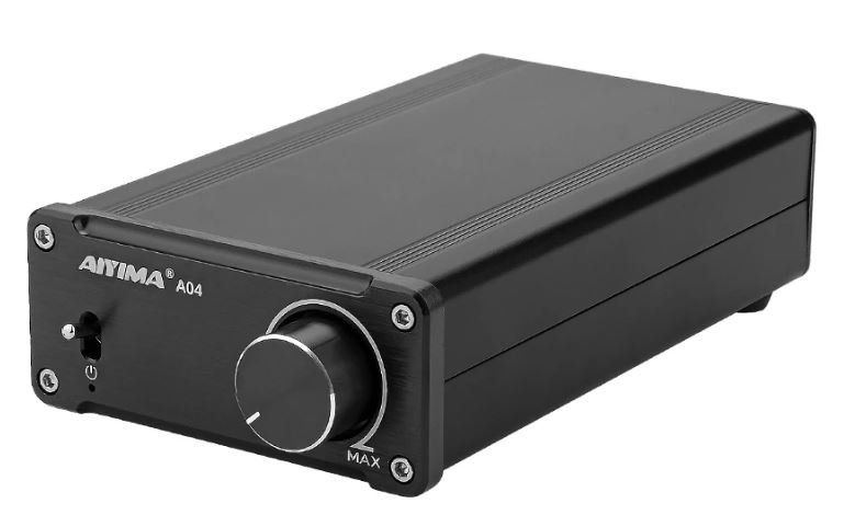

Nice case. That case design style looks like the one for the Aiyima 04 TPA3251 amplifier (other than one being silver and the other black anodized).
