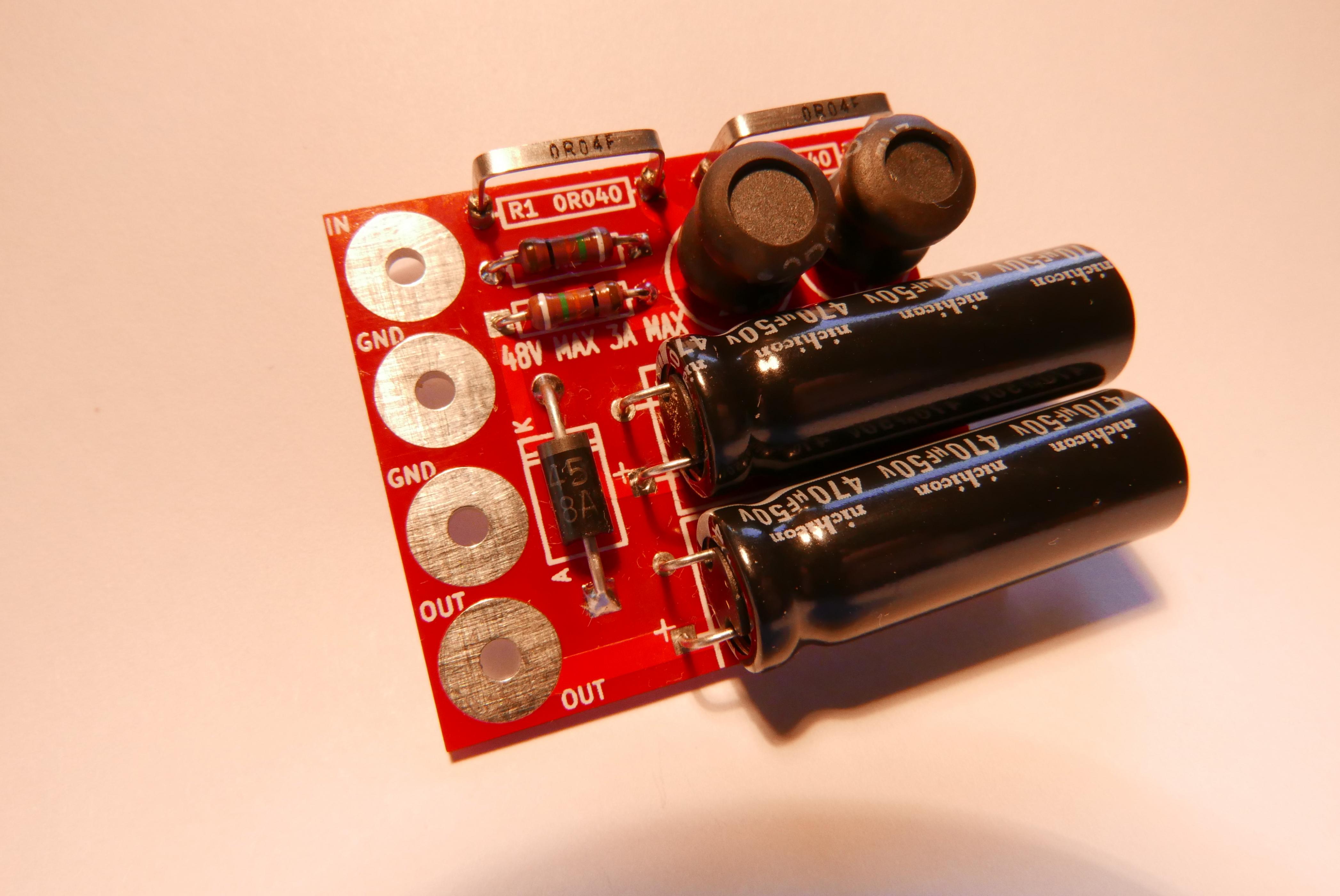

Carsten Witt YGL92S PCB with mounting holes : DC filter for SMPS wall warts
The PCB named YGL92S and/or YGL92S-A is by Carsten Witt . It is a SMPS DC inline filter PCB with four mounting holes. These holes allow you to securely fasten the PCB to a chassis, for example using M3 nuts and bolts.
You can freely download its Gerber CAD files from post #407 of this thread. Send these Gerber files to a PCB fab and have some boards made for you.

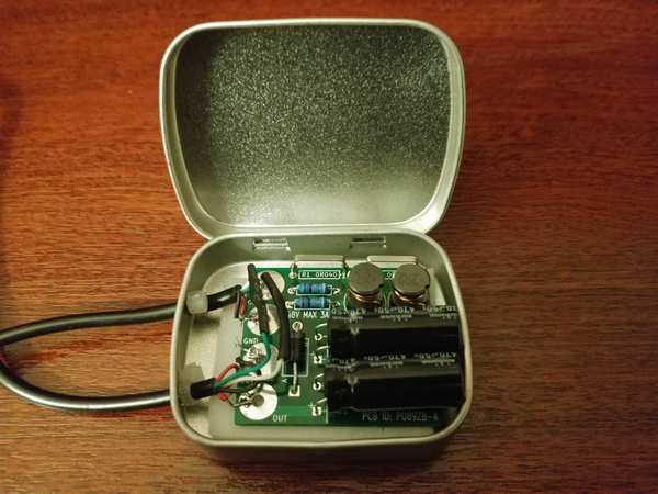

Finally able to post an update - my boards that should have arrived in December got to me yesterday.... a combination of DHL mis-delivering first time round and Brexit messing up deliveries from Germany for a while.

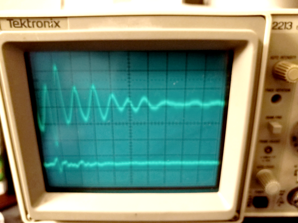

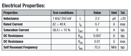

Anyway, built the first filter for use on my USB DAC, I used Wurth 744772022 inductors as the one's in the original BOM were unavailable at time of ordering (electrical specs below). I've tried to capture the waveforms on my scope, sorry the picture's not great, I think this is at the limits of what it can resolve - this is 5mV/division
I added the filter on a spare lead I had so I could A/B between the original and the filtered lead easily. Listening impressions are that the filter has made the sound a bit more focussed, transients are sharper and the placement of instruments in the soundstage is clearer. I know it's subjective (and I can't do blind testing cos it's me swapping the cables ;)) but I'm happy with the improvement :)
Thanks Mark.
Quick question - the original lead to the DAC is better quality but it has a large ferrite molded around the DAC end - if I swap the filter to this lead will the ferrite mess things up?

....Anyway, built the first filter for use on my USB DAC, I used Wurth 744772022 inductors as the one's in the original BOM were unavailable at time of ordering (electrical specs below).....
Since the Wurth 744772022 inductor has a SRF ~ 75.5MHz, maybe consider a 1100 ohm damping resistor
The original 652-RLB0912-2R2ML inductor has 65MHz SRF uses a 953 ohm damping resistor.

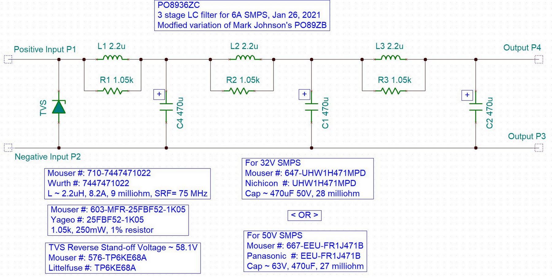

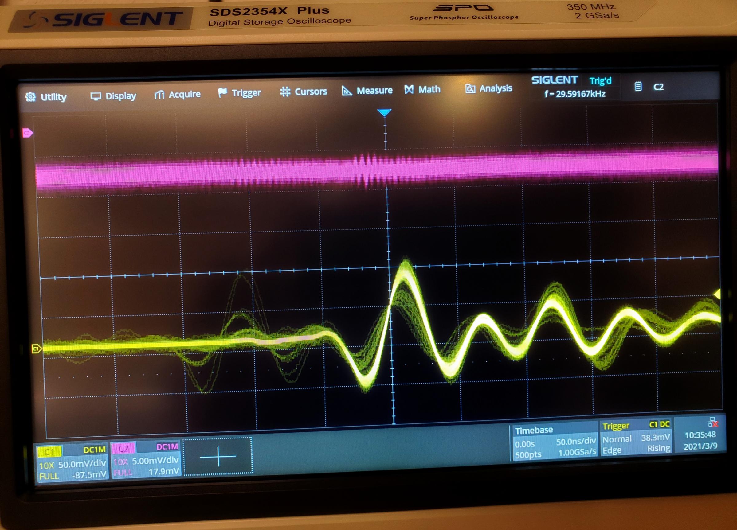

I finally got a decent scope photo of the noise from input and output of the experimental design 3 stage filter for 36V 6A applications, previously posted here: https://www.diyaudio.com/forums/ana...eamps-hpa-korg-nutube-etc-40.html#post6512950
The yellow trace is from a a cheap 32V 3A brick and the purple trace is the output of the filter. The power supply produces a wide frequency spectrum of noise, but the repetitive largest spike is shown in the photo. I need to do more measurements, maybe with a 1x probe, but it was the first evening with a new scope.

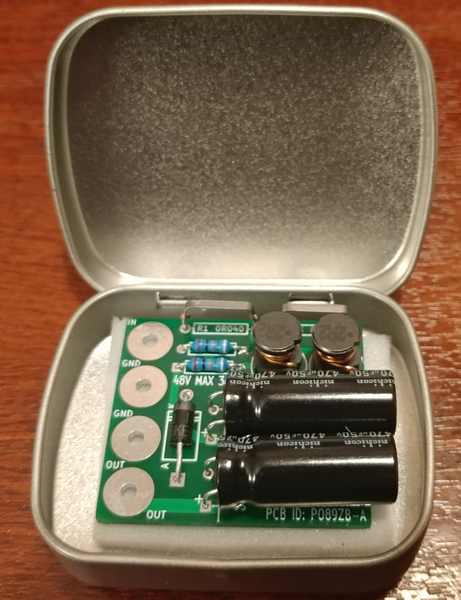

In the "For What It's Worth Department" cap wise?
UHE series from Nichicon is advertised as being Miniature Sized, Low Impedance, and High Reliability. Size works, V50 x uF 470 is 10 x 31.5. Rated for 4000 to 10,000 hours while ripple is at 1690. Just had 40 show up today. Will try and get a couple assembled and pic's up late tomorrow...
Couple pic’s, bad light temp. incandescent… sorry.
Well they (the UHE’s) are rather lengthy & rather heavy but do fit hence the recommendation per Nichicons spec. sheets deferring to UHW’s due to their favorable size compatibility. Price wise they’re comparable. The all important performance numbers will have to wait until we get back to civilization and my bench and equipment. We’re hiding out in the Blue Ridge’s till this is all over. Going off spec. sheets is one thing but what counts, for me at least, is most importantly what do they sound like? Was able to locate & ordered 37 UHW’s from Poland.

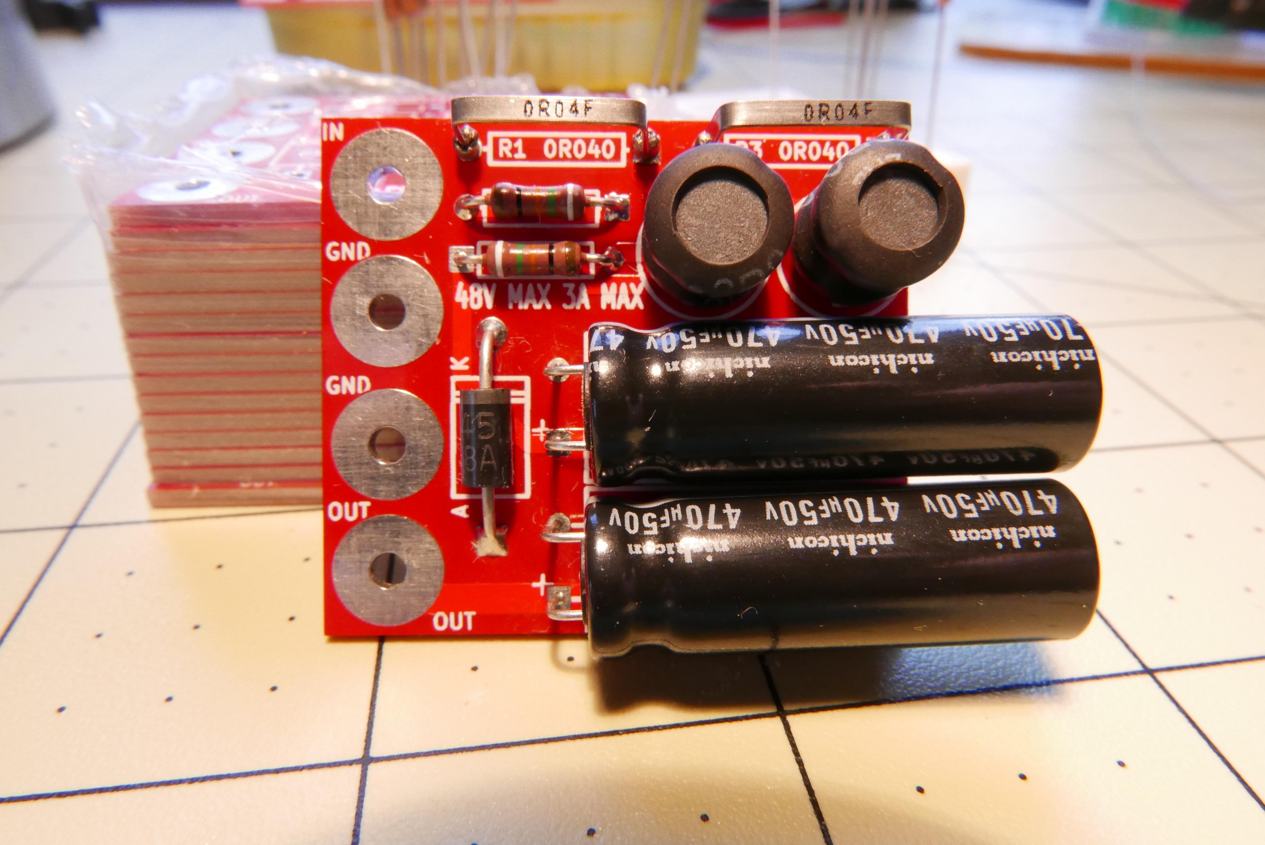

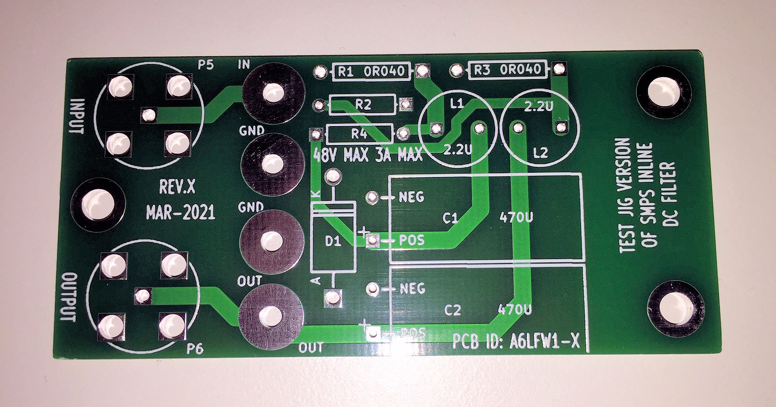

For those who use the Carsten Witt SMPS filter PCB [ID is YGL92S-A], see post #407, you may want to know its physical size. Knowing this can help you plan a mounting strategy within an enclosure. I recently sent the YGL92S-A Gerber files to a PCB fab, and got back 100 finished PCBoards this afternoon. Measuring one of them with a $10 micrometer, I believe that
PCB edge-to-edge size is 53mm X 35mm
Mounting hole center-to-center distance is 47mm X 30mm

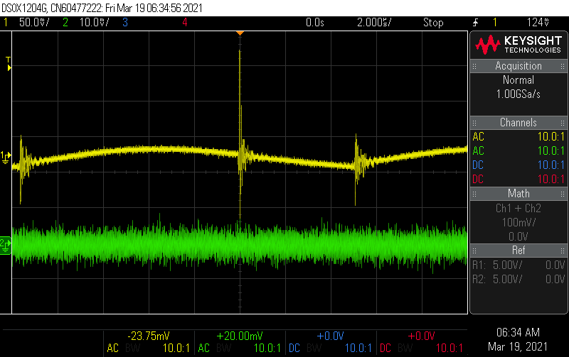

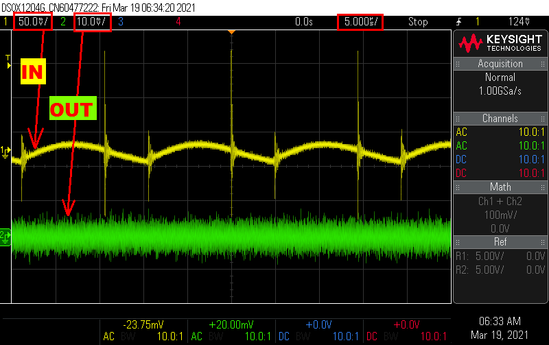

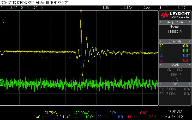

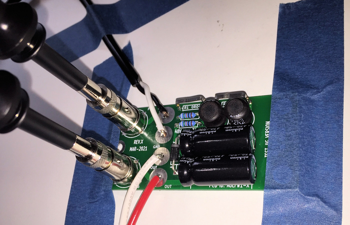

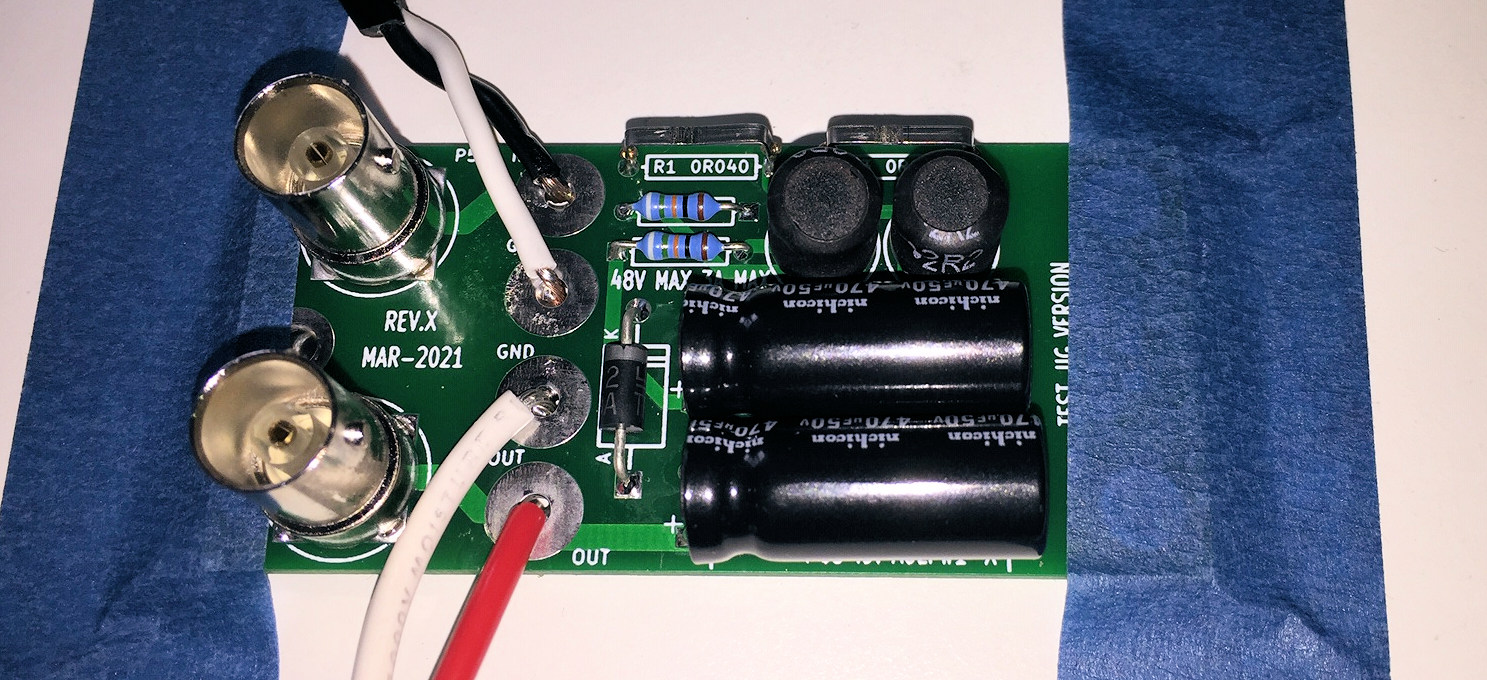

Last week I edited the PO89ZB printed circuit layout, and added a couple of BNC jacks for high speed signal probing, including ultra low inductance ground connections. I followed the recommendations in Johnson & Graham's textbook (link), as best as I could on a two layer board.
PCBoards arrived from the fab yesterday, and after an antivirus scrubbing and subsequent low temperature bake, I assembled one today. See Figures 1 and 2 below.
Unfortunately, the probes that came with my scope did not include probe-to-BNC adapters. So I bought two new "200MHz" probes from Amazon, for USD 23.00. These probes DO come with probe-to-BNC adapters: (Amazon link). You can see the probes and their adapters in Figure 3 below. Notice that the ground of the probe and the ground plane of the PCB are in intimate and low-inductance contact, thanks to the body of the BNC connector.
For this test I used a wall wart from Mean Well, part number GST25U28-P1J. It's a 28 volts DC output supply, rated for 25 watts (0.893 amps). I connected my DC electronic load and set it for 0.80 amps, so I was pushing the SMPS pretty hard but still within its rated specs.
Figure 4 shows the scope waveforms I obtained with the Figure 3 setup. On top in yellow is the filter "input" which is just the output of the wall wart. On the bottom in green is the filter "output" which delivers current to the load. Figures 5 and 6 show the same setup at finer horizontal resolution.
The peak-to-peak noise at the (yellow) input is 5.0 vertical divisions, which equals 250 millivolts. Peak-to-peak noise at the (green) output is 1.0 vertical division, which equals 10 millivolts. So the filter output has less noise than the filter input, by a factor of (250 / 10) = 25X. I am pleased with this result.

Yeah, to get my copper clad 3 stage 5A filter breadboard scope measurements, I had solder on some BNC connectors and used those BNC/probe adapters. The Siglent scope came with those adapters. The probe adapters and BNCs are great for dealing with high frequency noise.

Mark, if I am not mistaken, said SMPS has 150mV peak to peak advertised max ripple & noise, but here, in real life, it in fact exceeds that, making your excellent filter even more valuable.
I have to say I tended so far to trust the values on the Meanwell specsheets and was always surprised by the great sonic impact your filters could have on various devices despite looking sometimes "probably negligeable on the paper"... perhaps one part of the explanation is that these wallwart SMPS are worst than expected in real life and need even more filter curing.
