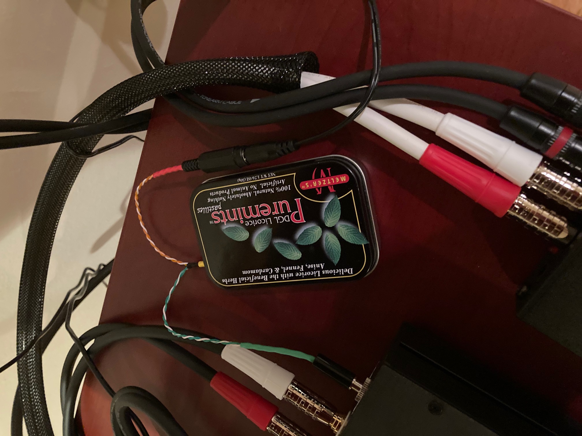

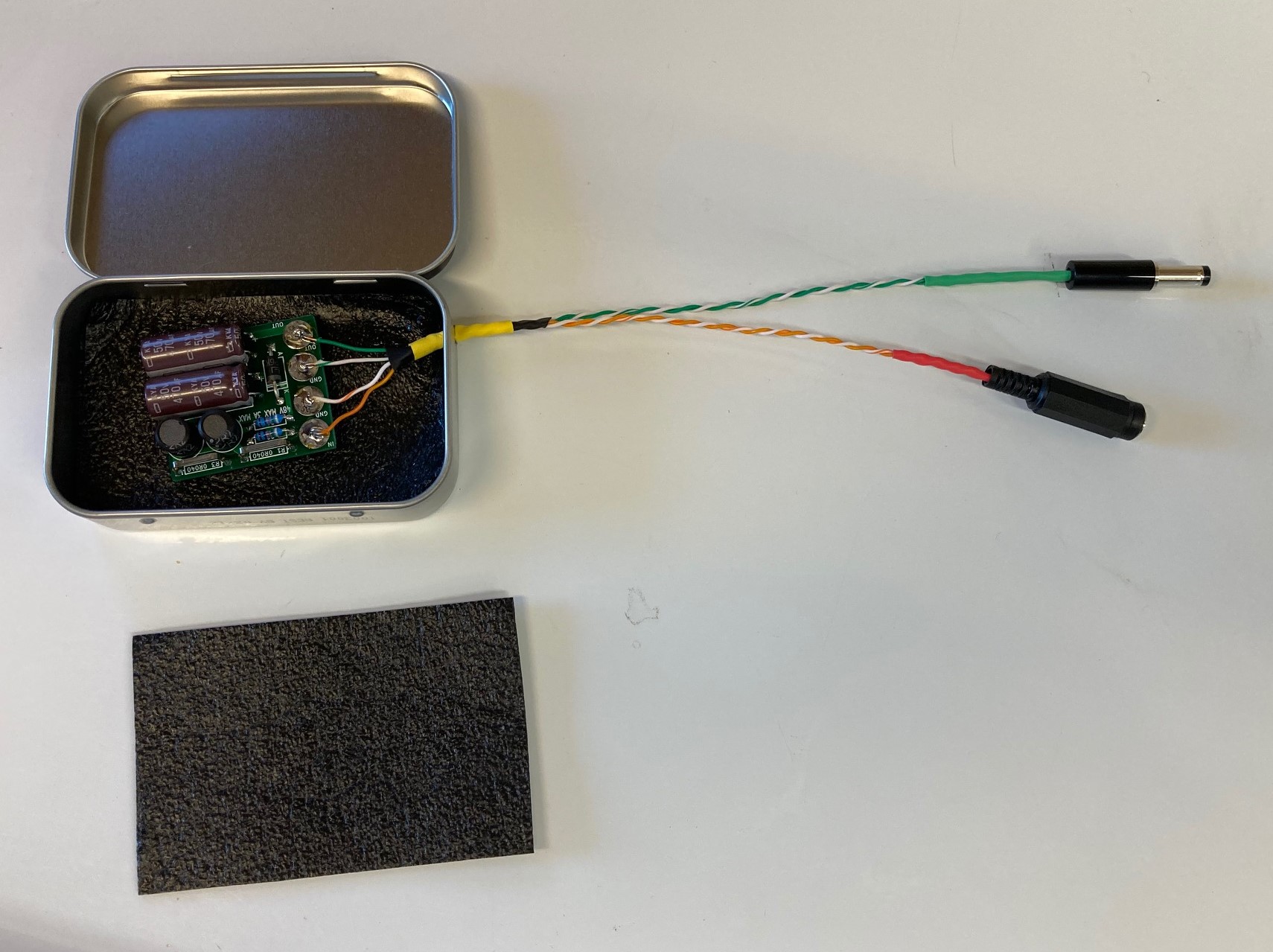

I put one together for use with my B1 Korg NuTube today, thanks rikiheck for the boards and Mark for the design. Mouser didn't have either the Nichicon or the Kemet caps in stock when I ordered so I went with United Chemi-Con low-ESR electrolytics, 661-EKYA500E471MJ25S, as well as some fancier EPCOS/TDK caps that I'm not sure I'll use for this. Unfortunately I only ordered two of the Bourns inductors instead of four so the second board will stay incomplete for now. Using a larger tin because that's what I had.
I set it up to be external to my B1 Korg while I evaluate it. Right now, I feel like the sound is brighter and possibly more detailed, but a lot more listening is in order.
Very nice! The pretty artwork on the box, and the good long pieces of protective heatshrink tubing, make for a handsome result. Congratulations!

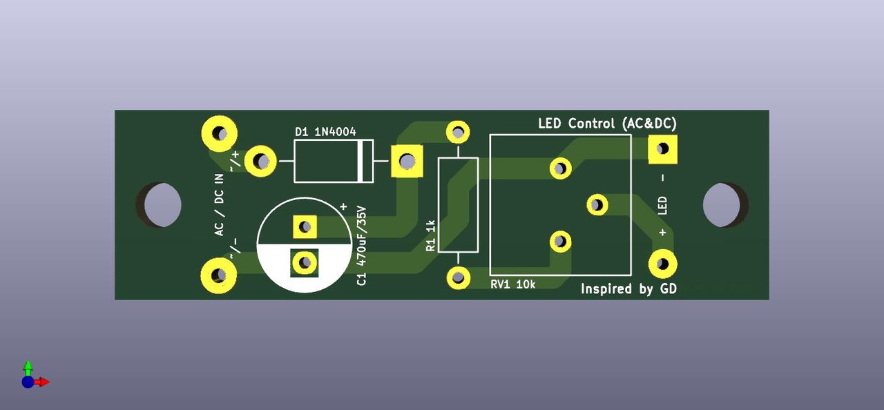

audiosy.net's Modified LED Board From Carsten Witt
Simple AC-DC LED rectifier for power on indicator – audiosy.net
I ask Carsten to add mounting holes to ausiosy.net LED Board and he was kind enough to send me the files.
I also contacted audiosy.net and received this email:
Looks good. Please feel free to post but please put a link to my site in you're post if you don't mind.

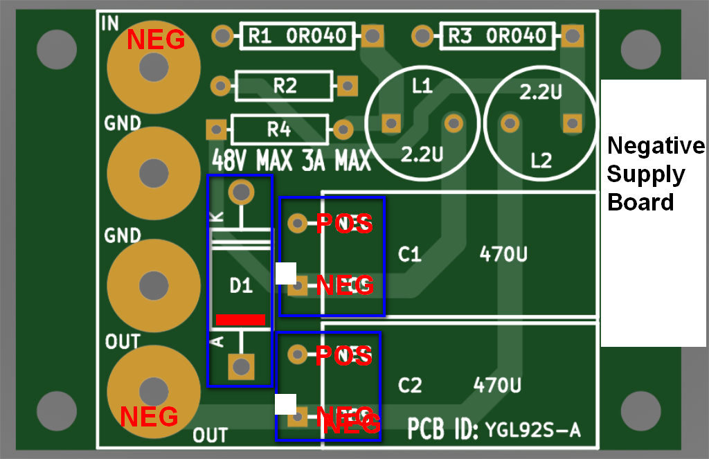

Why not use two boards; Populate one normally (Positive Supply) and on the other board, reverse the polarity of the tranzorb diode and capacitors (Negative supply)?
Yes, have thought of that, but also wondered if a purpose-specific board could be made smaller. The Korg preamp is pretty space-limited, the +/- is needed for an IR-capable volume control. The splitter SMPS is commercially available but an output filter is needed.
Also, if you do populate a negative supply board, make sure to label it negative supply (white sticker?).
One can design a PCB for pos/neg supply, but I do not think one has been made, as of yet.

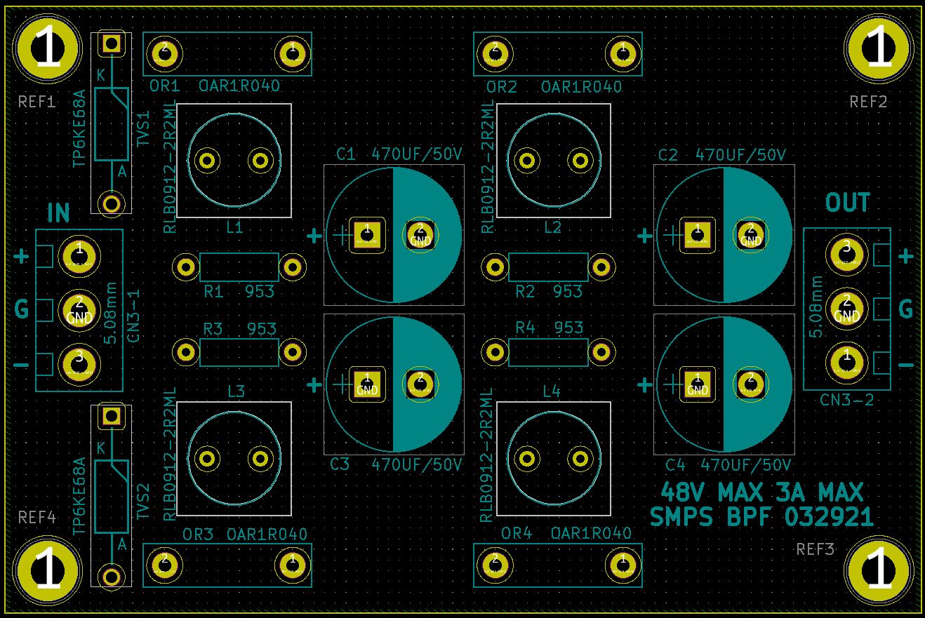

Here's a bipolar PCB layout. Boards are still on their way to me, so I have not verified the layout with actual parts yet. Caps are Panasonic EEU-FR1H471B
EEU-FR1H471B Panasonic | Mouser
There is room to lay them down to save 7.5mm in height if desired.
Boards are 57mm X 86mm. You can get a 5 pc. order for under $9 delivered, if you are willing to wait 2 - 3 weeks for standard freight. Double that price if you want them in just a few days.
