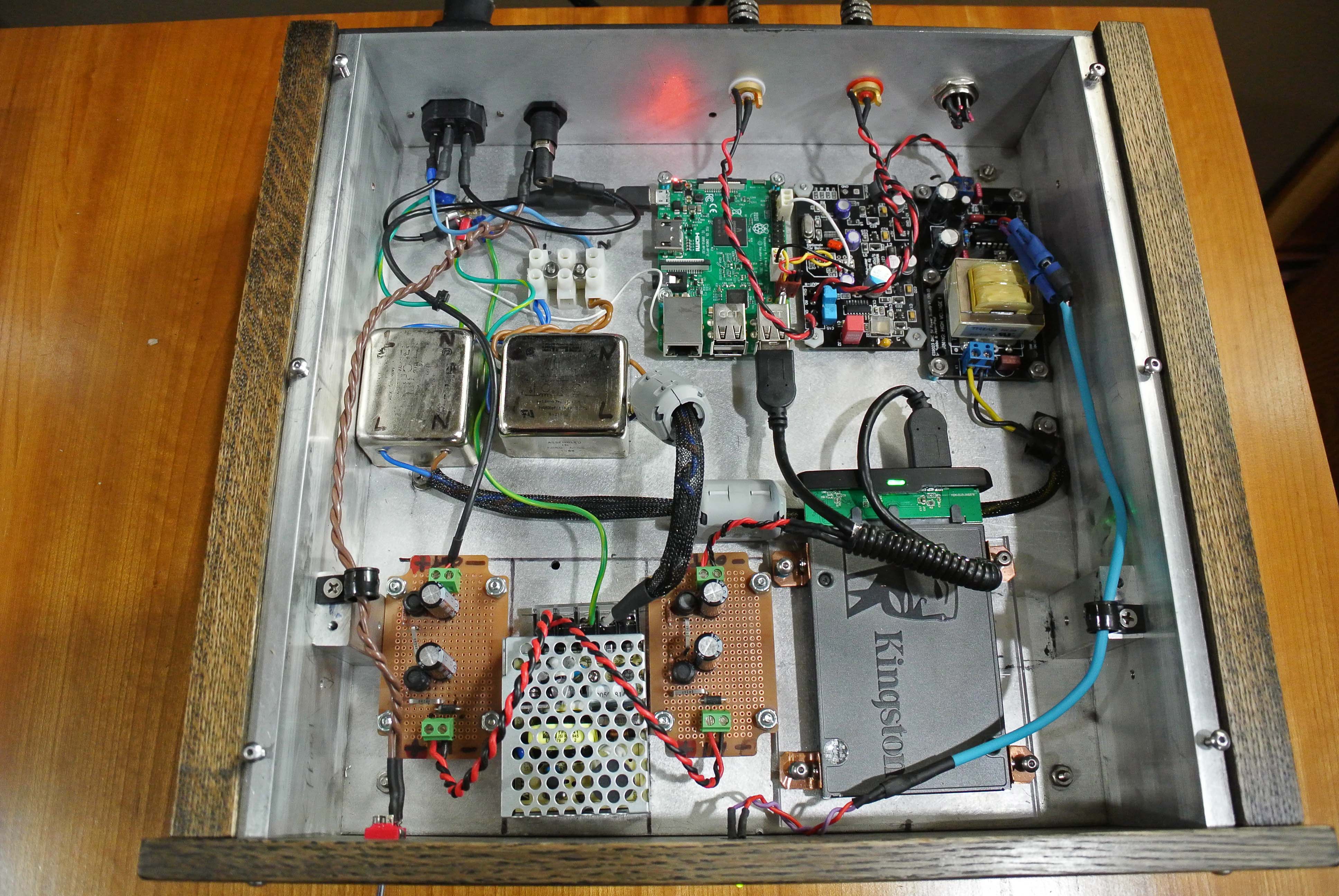

Filter for raspberry pi
Here is a photo of Mark"s filters installed in my raspberry subbu dac player using Moode audio software.I am using a Meanwell smps feeding the raspberry.I tried a Salas bib v1.1 power supply for the dac but preferred the original kit supplied one.I also tried A Meanwell with filter on the dac but it did not surpass the original.Using a filter for the smps feeding the raspberry improved the sound of instruments and vocals giving them more presence and realism.When I cut into the usb cable to power the ssd drive from the smps with filter instead of the raspberry pi usb port things improved further.I heard more details in the background and the soundstage improved.A big thanks to Mark for sharing his work.And I agree with Jean Paul about using linear low noise power supplies for dac"s.I will now retire my Aya tda1541 dac and shigaclone transport for the convenience of an ssd drive with my entire music collection at my fingertips.

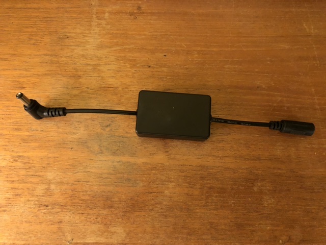

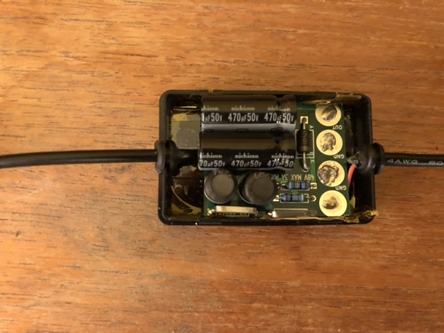

Minimalist
A snug fit - I had to file down both edges of the board to fit it in.
The cable came with an iFi Audio ipower, snipped in half.
Should I be concerned about heat, using it for B1-K pre-amp, so 24v and <100mA? It doesn't feel warm, with an hour's use.
To early to evaluate any changes to the sound, but no smoke so I'm pleased.

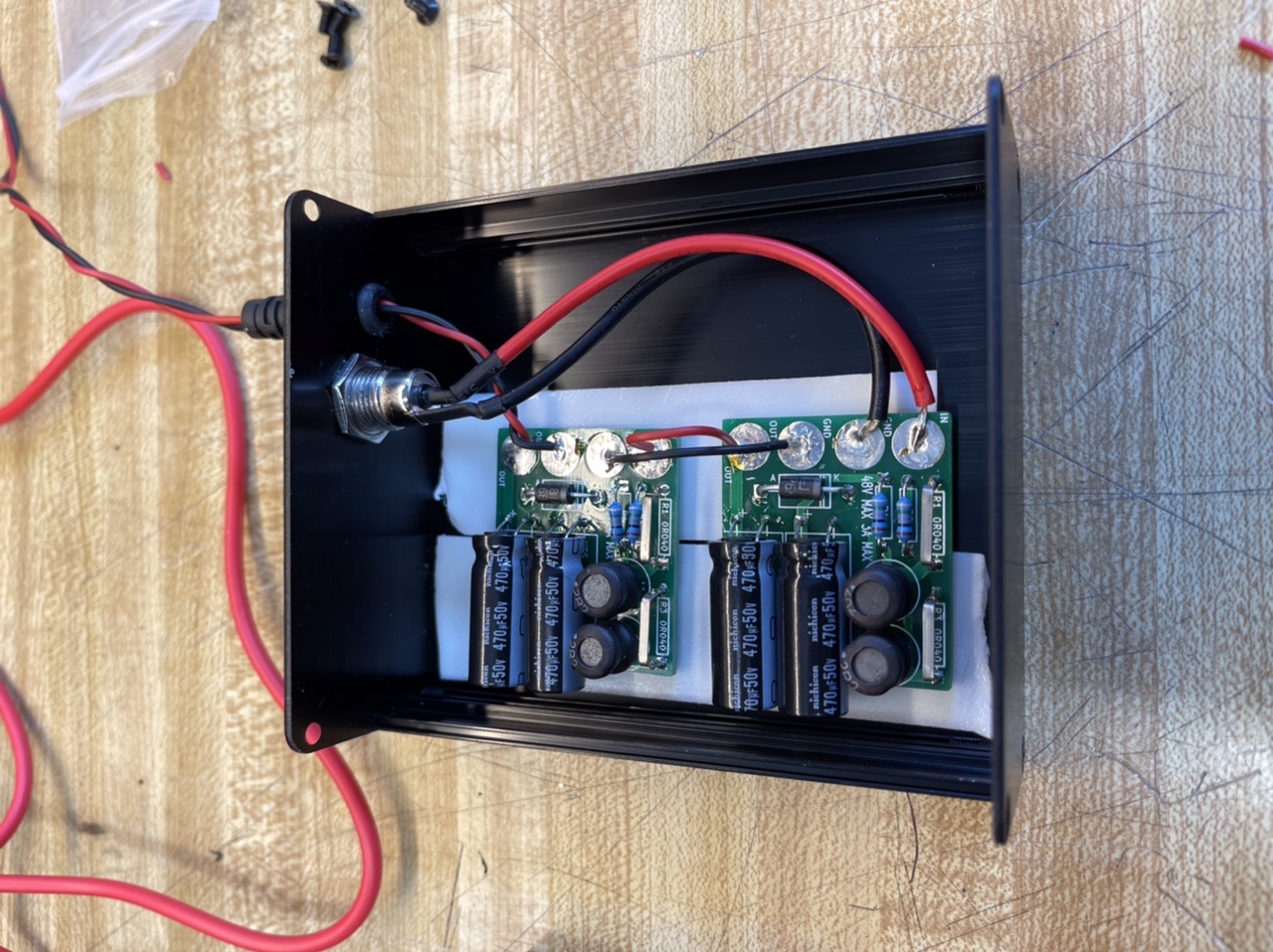

I bought it from Amazon- $11.99. I like that the case split in two, so you can set up the components in the lower half with ease.
I can't seem to get a link to work. Here's the item title on Amazon-
Jiuwu- Surface Drawing Split Aluminum Enclosure Project Box Electronic Enclosure Case for PCB 88x38x100mm
