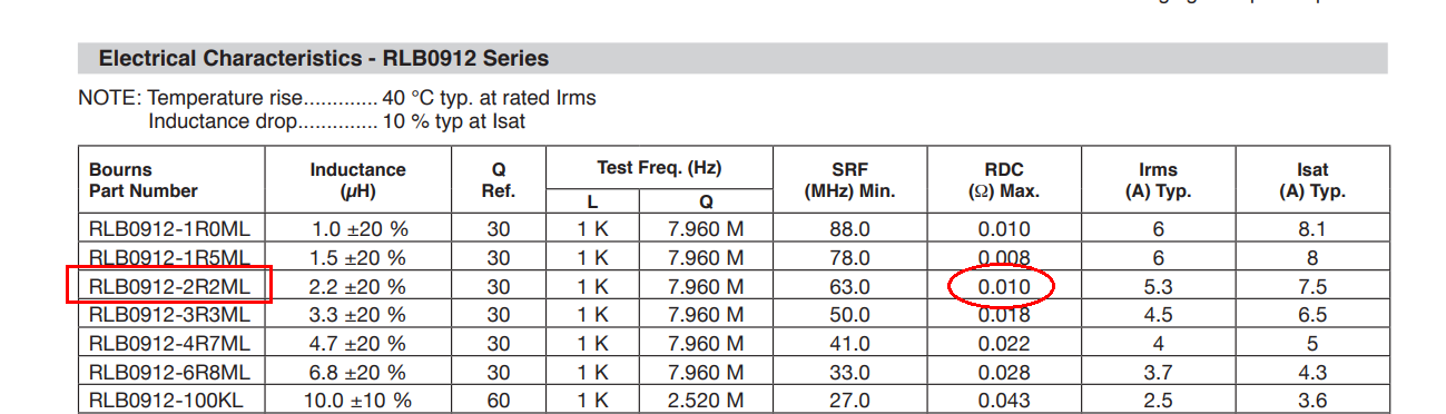

You mean [the inductor's series resistance should be] 0.010R, right? Is that value calculated ...
No it's simply the number that Bourns quotes in their datasheet. Mouser's sales page has a link to it. Snippet below.
After completing a three week refresher course in Signals And Systems, finishing all 100 homework problems in the Schaum's College Outlines practice book, and drinking two cups of strong coffee,
you might be be ready to derive and solve the equations (Laplace transforms) which govern this circuit. Then decide which of the variables are fixed constraints and which are free parameters, and iteratively converge toward a final design. Performing the exercise will remind you why it takes four years and not four weeks, to finish a BSEE.

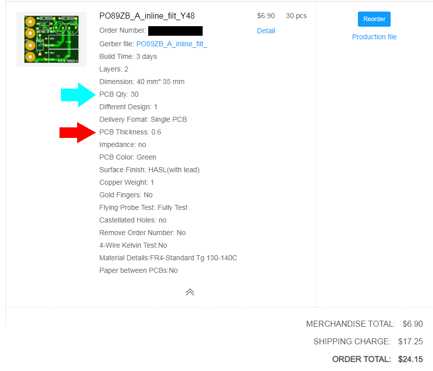

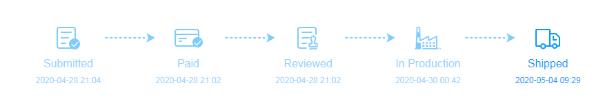

Back in late April, I used the website pcbshopper dot com to get price quotes from 20+ different fabs. I picked the fab with lowest price that day AND who offered DHL express shipping; in my experience, DHL gets boards to California faster than anyone else.
Here's what I paid for 30 boards, and here's how long it took. This was five months ago and things may have changed; get a fresh quote and make a fresh decision.

Thats cool. Looking at the costs, its this 0,04 ohm that sticks out. Isn't there a way to realise this with a specified length and gauge for a copper (etc) single core wire?
How about the copper on the PCB - what should I have ordered for this to work as intended?

That is what I paid yesterday, so prices have not changed.
