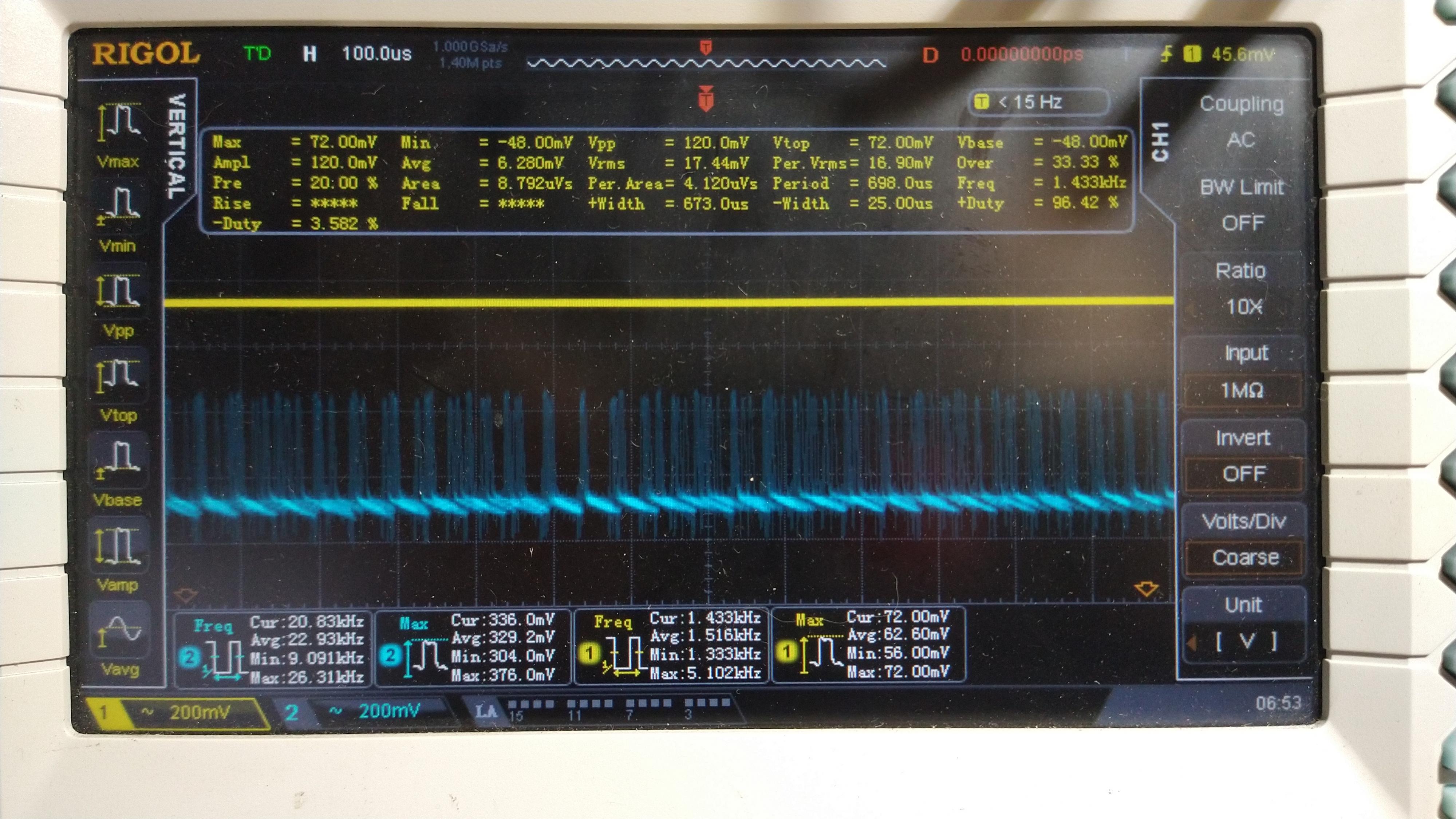

OK all out, the last ones went today. Please post pix and let us know what you are doing with them, I can't wait to see the ideas everyone comes up with.
I put one in line with my pi/Allo streamer and it seems to have cleaned up the power quite well. I will be putting one on a KorgB1 when I get a chance.

Ordering the parts at Mouser...
Couldn't find the 0,04R sensing resistor, took 0,02R instead... don't think a majour prob at that scale, but hope OK?
Claude
Claude
I really don't think that's a good idea; your RLC resonant circuit(s) will be poorly damped and they will exhibit decaying sinusoidal oscillation ("ringing") for many types of load current waveforms a/k/a stimuli.
Instead I suggest you pay a dollar more and buy the 1% tolerance version of the 0.04 ohm resistor instead of the temporarily-out-of-stock 5% tolerance version. Mouser has 368 of them in stock, this morning.
part number 605-RMCJ1U00R04FS
Mouser's website says they expect to restock the 5% 0.04 ohm resistor on 13 November.

OK Mark, will follow your advice
Glad I didn't push the button, thanks for your quick response!

While we are on the subject of substitutions, can the 470uF be lowered to 330uF or does that alter the filter too much. I only ask as I have heaps of them.
I have 100 µF and 0.01 Ohm resistors. Can I use those?
Seriously folks, why do you think the designer made a schematic, a PCB and a BOM? The filter works as published with the specs given if the specified parts are used. If "anything goes" would have worked he would have written that.
