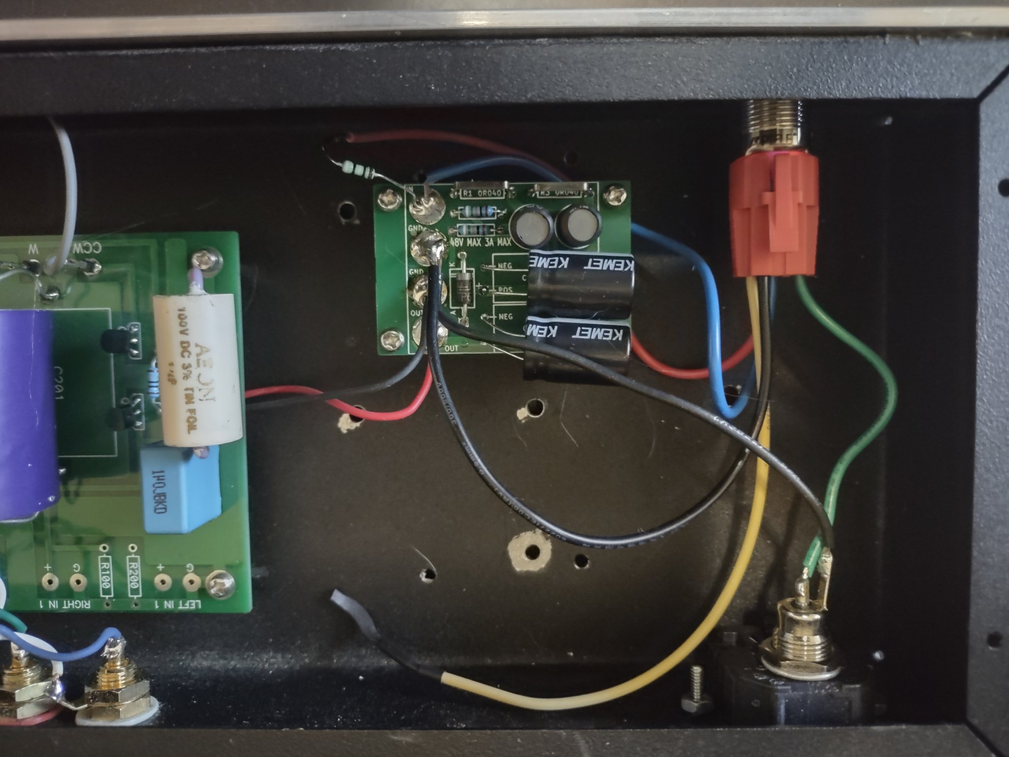

I had originally built my B1 buffer in this enclosure with a small toroid and LM317 regulator. A month ago I decided to move the B1 to a different enclosure and put a different circuit in here. Which required an external power supply connected through a barrel jack. Well, the new circuit was just a little too cramped for my liking so I put the B1 back in. I decided to stick with the barrel jack as it allowed me to use a low voltage external supply. Which in turn allowed me to use one of those cool looking "halo light" switches. And when I saw william2001 sharing his PO89ZB boards I jumped on the offer. Here it is implemented. I can't hear any negative impact vs using the linear regulated power supply. Thank you, Mark Johnson, for sharing the design with us and thanks again to william2001 for sharing your boards!

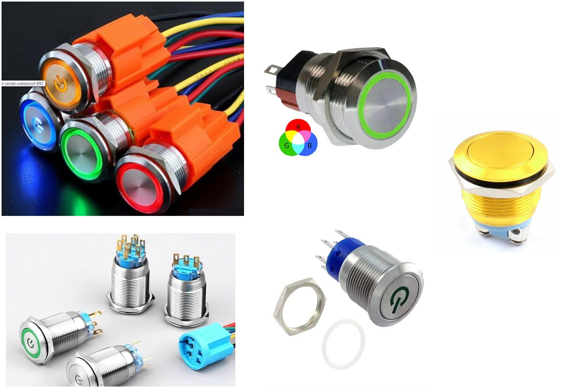

If you're interested in switches like the ones below, I found them on Amazon and DigiKey and (especially) Newark, using the search phrase "anti vandal". Beware, >90% of them are not mains rated; voltage too low and current waaaay too low. One common workaround is to connect the wimpy A.V. switch to a pcb like H9KPXG on this site, Intelligent Soft Start on neurochrome.com, project 166 on Elliott Sound Products website, etc. Anti vandal switch controls a second, much beefier, mains-rated switch of some sort (triac, relay, etc), which is not on the front panel.

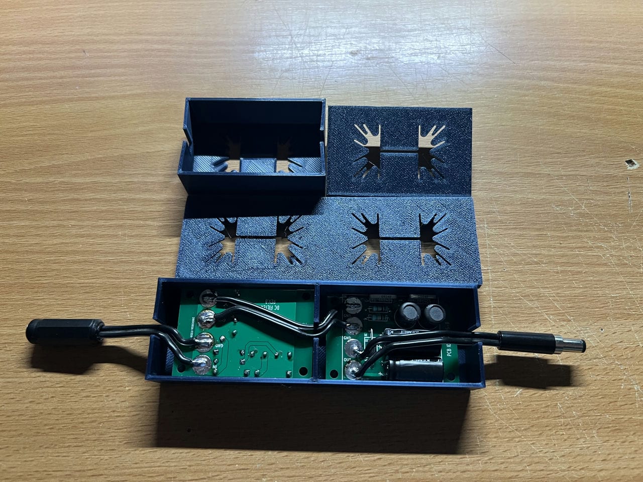

@Mark Johnson Does it make sense to use 2 P089ZB boards to filter the output of a dual SMPS, one inline with V+, one inline with V-?
Or is there a more integrated solution?
This design does not have the diodes, but you can add the diodes manually.
In this post you will find the info for the second negative board.
Also found 540, which seems like exactly what I was looking for.
