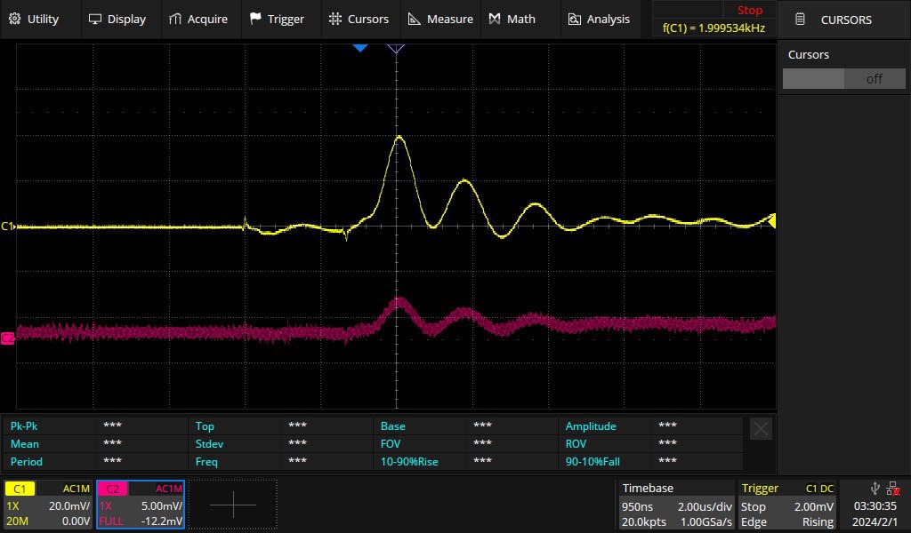

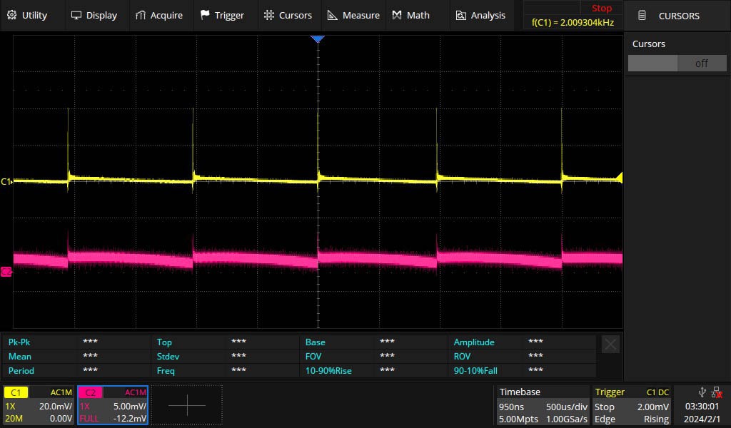

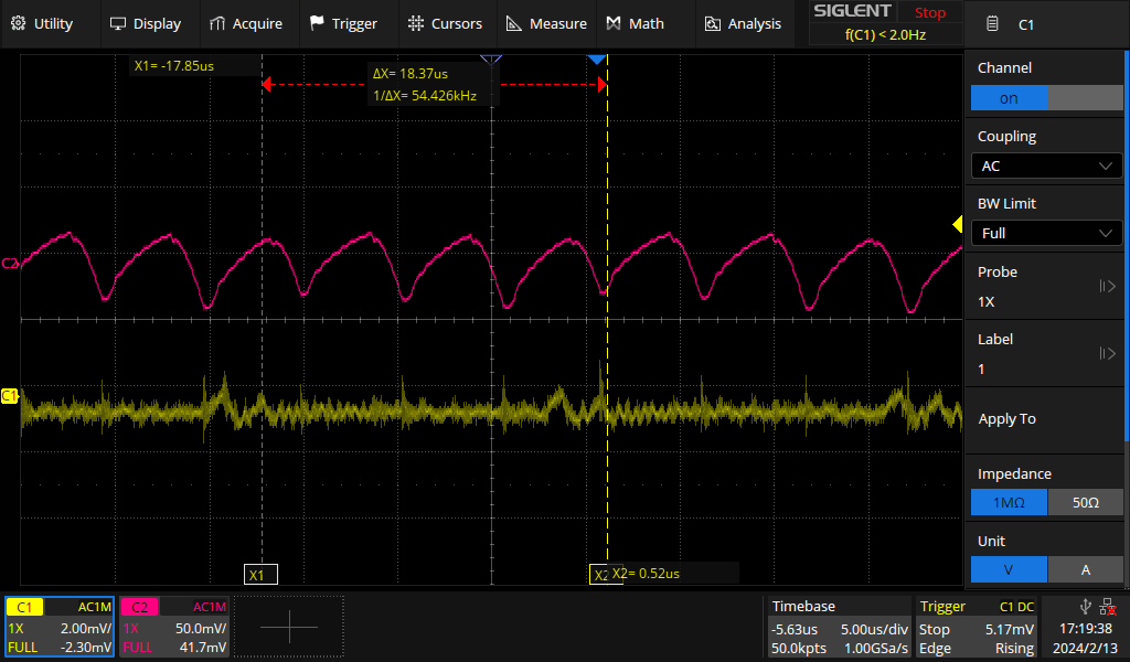

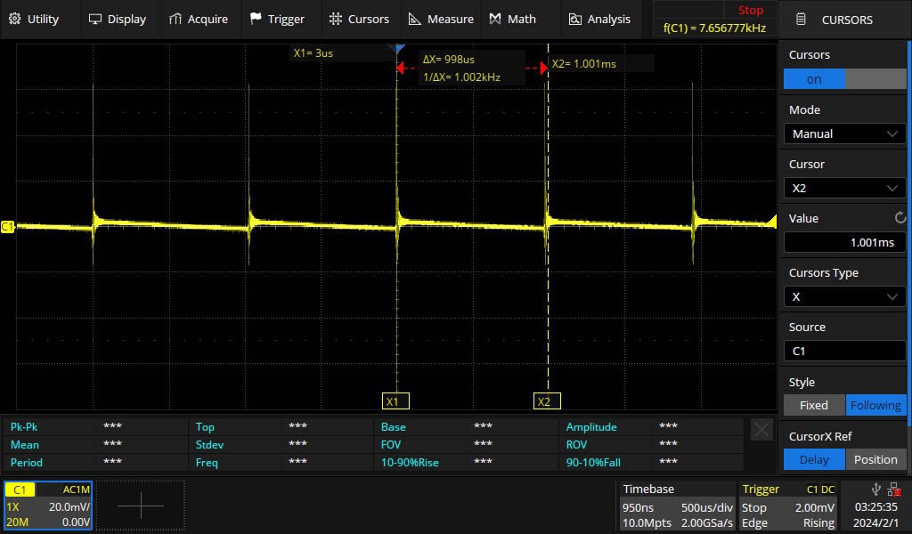

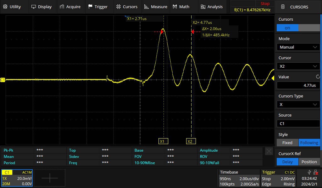

In pictures #1, #2, and #4 the yellow peak seems to be 3 vertical divisions tall, but not in picture #3.
Oh by the way your scope has the wrong date in the bottom right corner. Today is 31 Jan 2024.
🙂 It's still on China time! Heaven only knows what will happen during the Lunar New Year.
The magenta is about 4mV...the original spike was ~60mV
