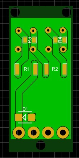

@Mark Johnson changing only resistors and diode to smd (diode is same manufacturer, same diode just smd package, resistors also same, current sense for 40mohm and regular 953ohm, but smd), shouldn't change any calculations you've made?
I've left trough hole inductor (since it's abundant again), and capacitors since no applicable stats in smd package. This way there is enough resistors (40k plus in stock on mouser) vs none for trough hole, which seems the main problem for this lovely device.
I'll be ordering a batch by the end of the month together with my assembly order, and will check and share if there is no issues.

Yes it could be smaller, and currently it is the same size as the original (mounting holes) one. It is already quite small, and this way inexperienced people in smd soldering can easily solder (good exercise seeing how world revolves around smd components) . Also, i like wider traces If all is good as with original, i can maximize space/minimize size as desired.

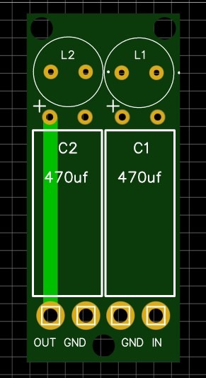

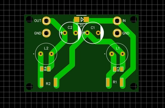

@PKI I've made a smaller pcb. Ordered parts for it, and will opet a new topic per mark suggestion when i test it out. It is 50% smaller, but had to keep the length to 5cm due to keeping all the calculated parts (cap (both nichicon and kemet can fit) and bourn inductors) of the circuit so it doesn't change the functionality.

Thanks for the tip, I haven't read the whole thread yet. I'll order the Nichicon UHW and compare it with the FM.
Within a series, the longer designs (with identical capacitance/voltage) have a lower ESR due to the lower foil resistance (wider foil with shorter length).
