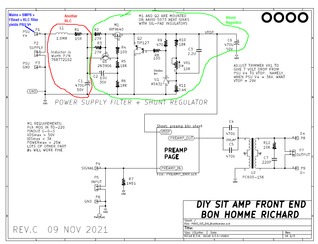

The Ship Of Theseus front end card called "Bon Homme Richard" (BHR), does both. Its power supply is a Mean Well SMPS, which is then filtered by FerriteBead + RLC, upstream of BHR. Then the front end card itself includes additional RLC filtering, followed by a shunt mode voltage regulator. Since each stereo channel has its own front end card with its own supply filtering, channel to channel crosstalk through the power supply is minimized.

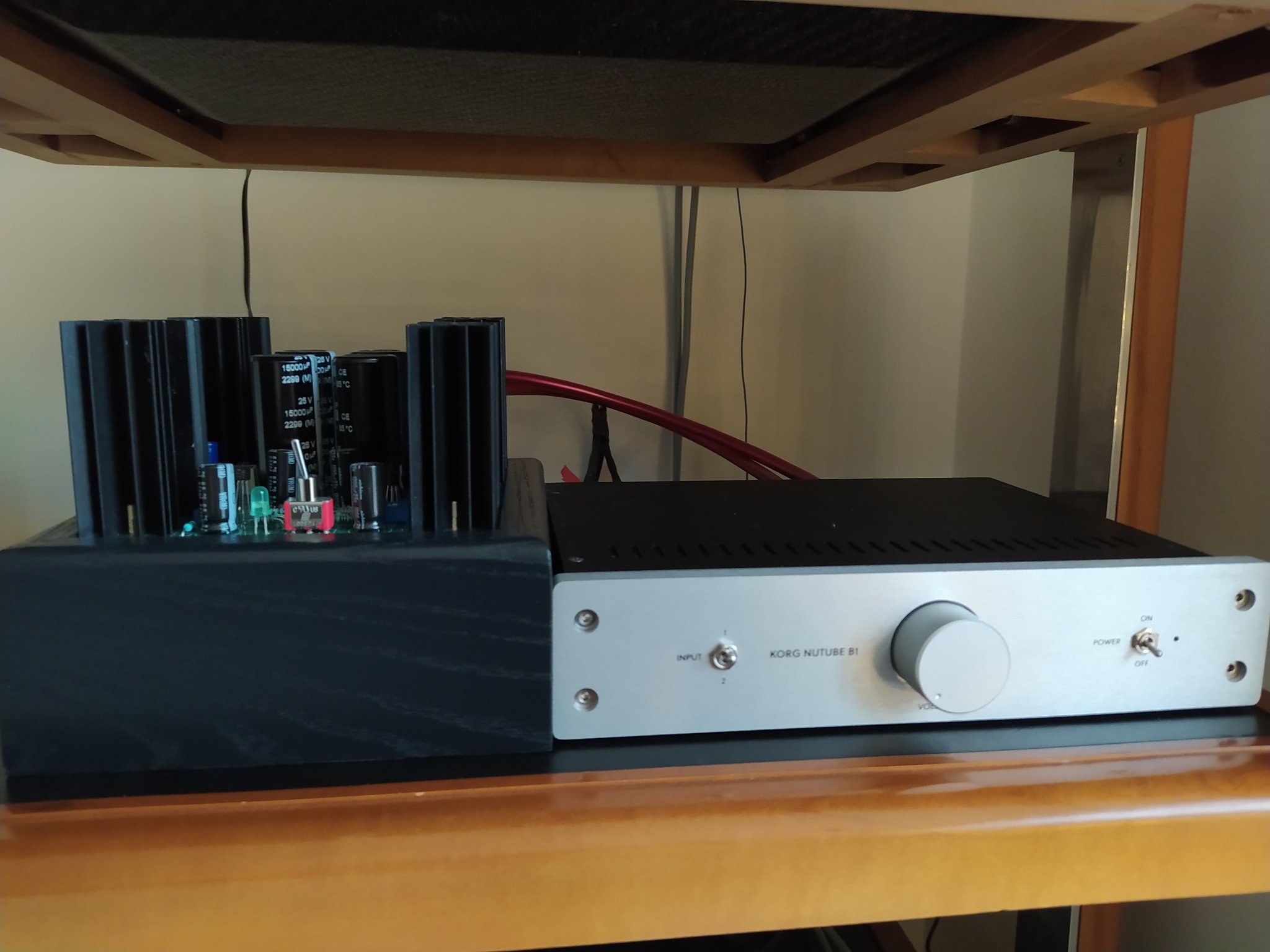

Hi PKI,
No measurment but listening tests, to my own preference and all IMHO.
You may want to use the search function, but I tweaked a few bits on the B1K, including its PS caps, and eventhough I found the filter to be benefical to my ears.
Perhaps more importantly, I compared SMPS + Filter vs Big linear lab PS (see B1K thread) and the winner was SMPS+Filter. By a small margin though, as air gets really thin on this unit re PS tweaks at that stage.
I haven't tried the highly praised Salas shunt, so can't comment really, but for whatever it is worth:
  • apart from taste and colour consideration, I doubt there is much more to be objectively gained in this set up
  • SMPS + Filter are delivering an outstanding result and I learned the hard way that SMPS can sound fine (once filtered etc.), for sure in this application it is not the limiting factor re neutrality (read: the B1K has its own "sound print" that is both its beauty and for sure its dominant trait, whatever tweaks we might try)
And that is coming from someone who always believed a switcher couldn't compete with a linear PS re sound... I learned meanwhile, and perhaps also the tech has improved over the years.

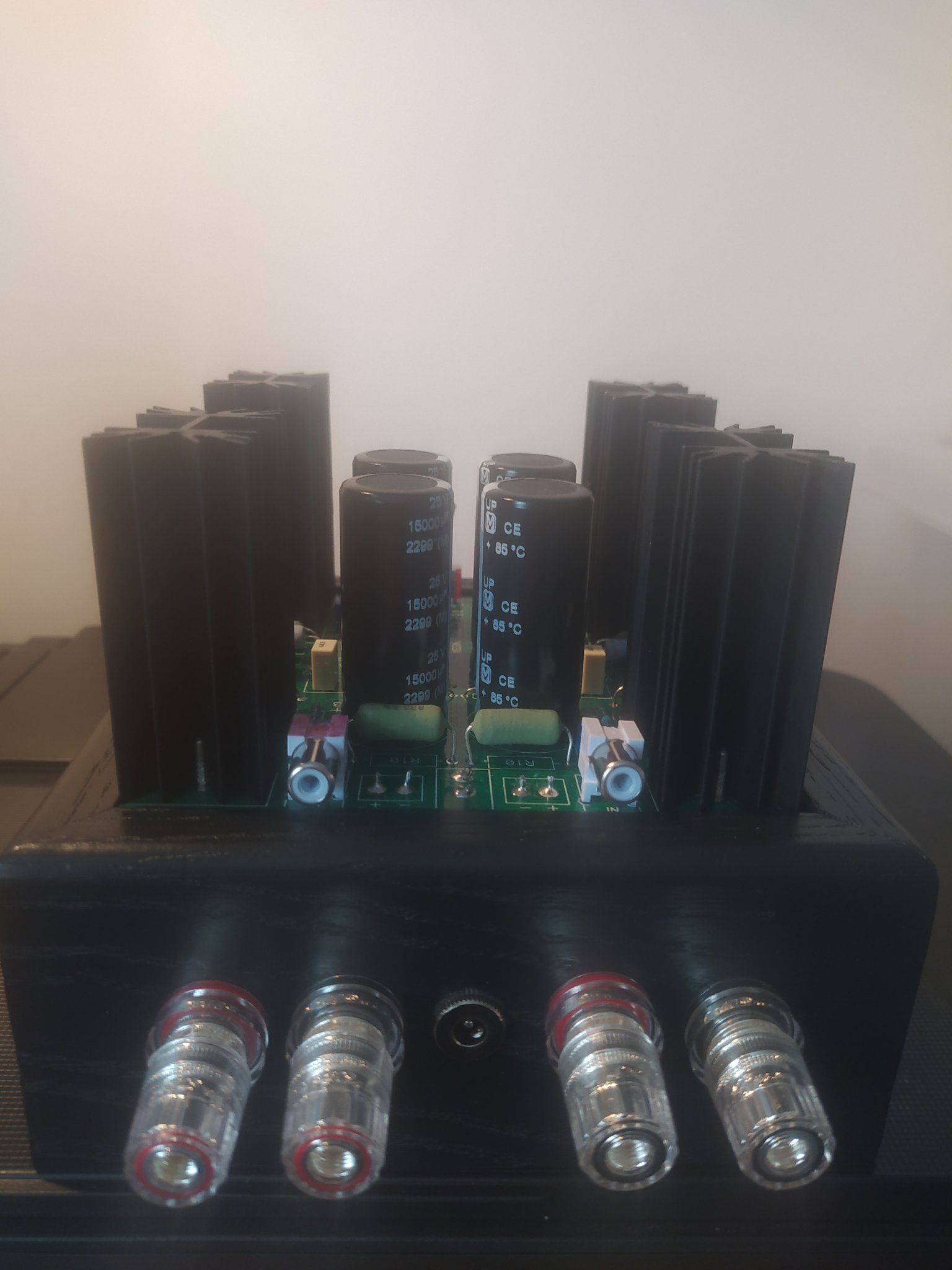

Congratulations @Alan D UK ! A very tidy build with lots of eye appeal. Good on ya.
Looks like there's plenty of room in your "basement" to experiment with using N>1 SMPS filter cards in series, if you want to. Take the incoming, less-than-clean DC from the SMPS, and filter it through a PO89ZB. Then take the much-cleaner DC and filter it again through another. Iterate as many times as you see fit.
