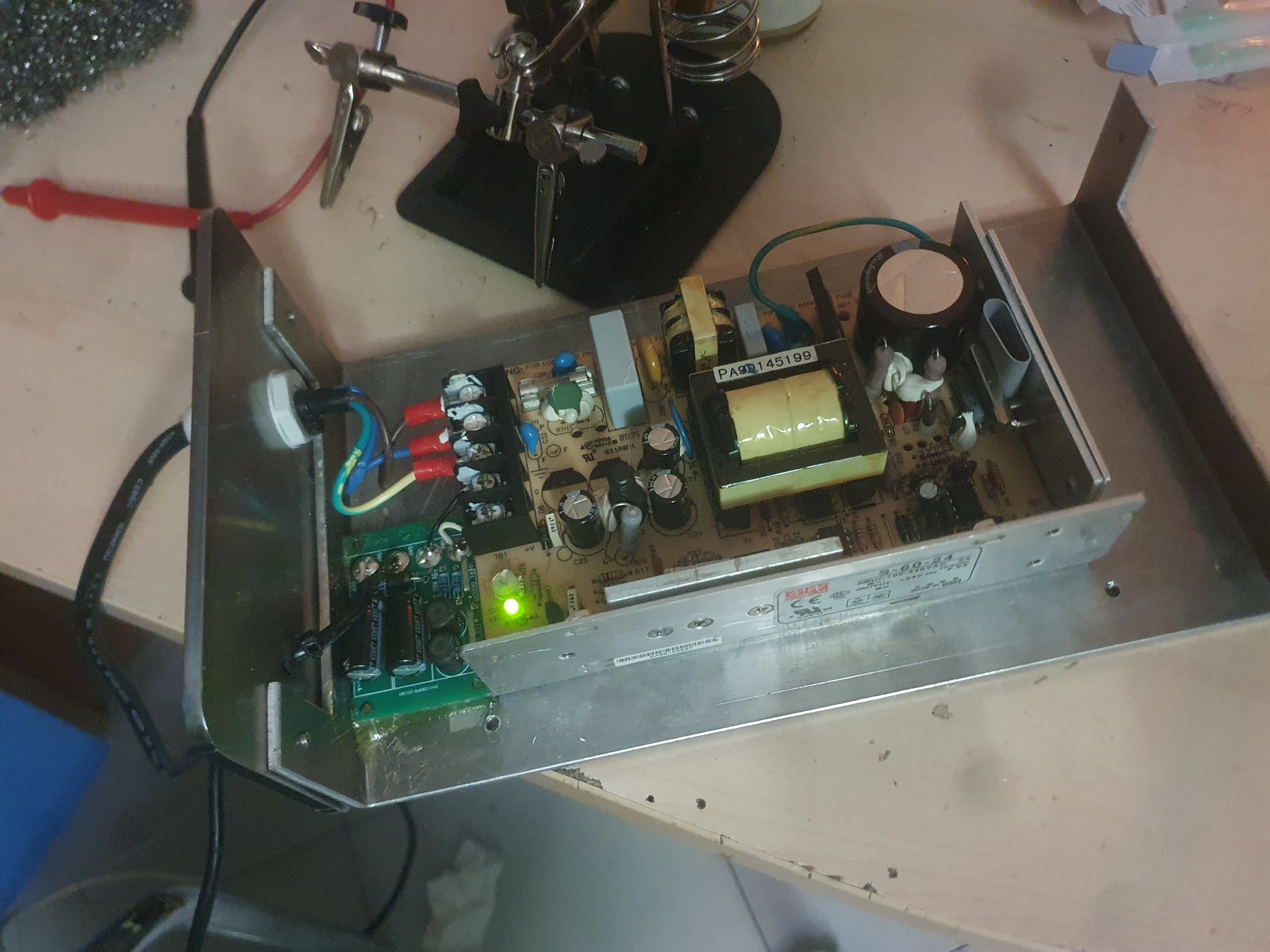

I played with anything from 0 to 4 daisy chained filters and the results depended very much on the devices I plugged them to.
As already posted, I have yet to find a HIFI device that is within the specs of Mark's filter re current and voltage requirements, fed by an SMPS (regardless its quality), that doesn't benefit from the filter(s). Worst case, seldom, the filter doesn't bring any real plus; in most (many) cases the filter(s) shine, be it 1 or sometimes 2 daisy chained.
Note that Mark's original filter is in itself in fact already composed of 2 "simple" daisy chained filters, and hence one of Mark's filters is already very efficient.
I still have some filters handy to play with at mine, and always 2 additional spares to bring them to friends so we can experiment at theirs together (enabling daisy chaining, or even 1 per channel PS supply, or whatever if more devices are fed by SMPS etc.)

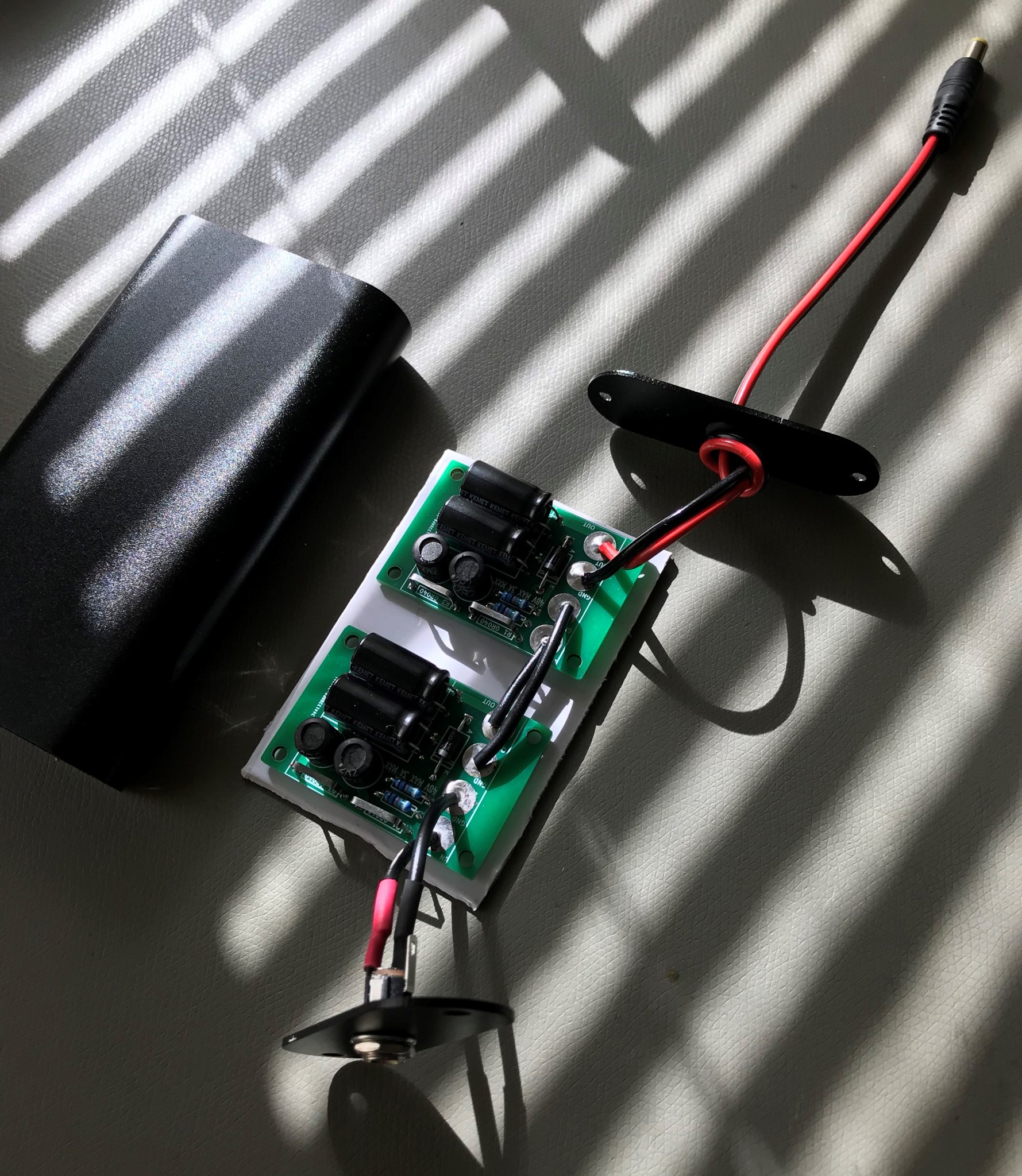

I've had a single one cobbled together on my ACP+ for awhile. A test drive while deciding what kind of enclosure I wanted to put them in. It seemed to elevate the SQ. Had not tried two in series yet. The proper amount of kill is....."over"??😄. Thought I would share a pic just before final assembly of this new dual version. I'm happy with how it turned out. I have pcb's coming (a bunch), and parts waiting in my Mouser cart to build some more to have on hand, give away, or whatever..
I have some boards on offer if there's any interest (price is good, free!). Maybe I'm too late to the game, haven't had many takers.. PO89ZB PCBs

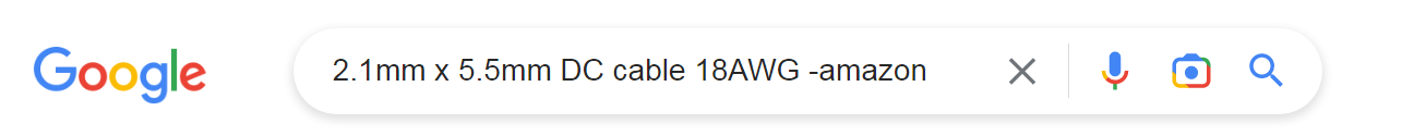

Try this search engine query and see if you're pleased. The " -amazon " flag instructs the engine to ignore search hits that include the word amazon . . . . . except of course for the "Sponsored" (paid advertisements) links, which you can scroll past very quickly.
