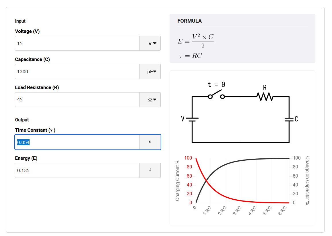

I'm still working on the idea of using a +/- 333mA supply with the po89zb filter on each leg for the BA2018 preamp and somehow getting around the initial power surge challenge. So far, the best/easiest solution seems to be to use resistors in the plus & minus lines to limit initial surge current plus a small relay to connect the PS directly to the capacitance after the surge has subsided.
I've looked at the time constants for resistance and anticipated capacitance (1200uF or thereabouts per side) and am trying to decide what value resistor to use.
Given a 15 volt initial differential, I could use a resistor of about 45 ohms to deliver full supply current to charge the caps, or a greater resistance of maybe 75 ohms for a 200mA initial surge. Either way, the surge lasts well under one second (see attached), and the 45 ohm resistor handles a momentary 5 watt load and the 75 ohm resistor handles 3 watts.
Question I have is, given the very brief period of high wattage, how small a wattage resistor can I get away with?
Can anyone help me with this?
You've made excellent progress, and have done some fine work thus far: Congratulations! In a slight twist upon a well known aphorism, I very much enjoy helping those DIYers who help themselves. So let's have a look at some follow-on calculations, together.
Firstly, if the SMPS promises not to current-limit until 333 mA, why not allow the inrush current to be 90% of CurrentLimit? This gives the mfr some leeway and provides a 10% "tolerance guardband" upon his datasheet spec.
So: (15V + 10%) / Rseries = (90% * 333mA) ---> solution: Rseries = 55.1 ohms
Round up to nearest EIA standard value: 56 ohms.
Maximum instantaneous power = (15V + 10%)^2 / 56 = 4.86 watts
Resistor datasheets such as the attached, all seem to say that the short term overload voltage is 2.5X the "RCWV", i.e., 2.5X the square root of (PowerRating * ResistanceValue). Okay, that's nice to know, but what we're interested in here is the short term overload power rather than the short term overload voltage. And math comes to the rescue: since power dissipation is proportional to the square of voltage, the short term overload power is (2.5 squared) = 6.25X the continuous power rating. That's the number we seek.
We now know that you want a resistor whose continuous power rating is greater than (4.86 watts / 6.25X) = 0.77 watts.
I myself would choose a 2 watt resistor, because 2 watts is comfortably greater than 0.77 watts. Maybe you want even more safety margin; maybe you can live with less. 2 watts is what it takes to make me feel adequately protected against undesired outcomes.

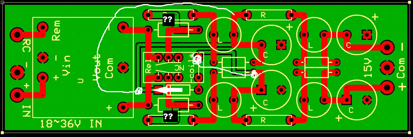

My first cut at making a compact +/- power supply with a DC-DC converter and a filter on each leg. PCB is currently 4.050 x 1.3 inches.
Hopefully the relay will work with just a zener in series and connect after the capacitors on both legs are approaching full voltage.
Edit: Diode reversed, will fix.

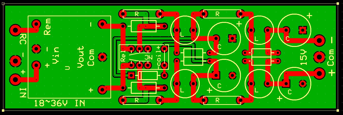

PCB is coming along. Realized zener is not appropriate here, replaced with a resistor for a voltage divider to drive the 24V (18V "must switch") relay. Also shortened the traces to more like optimal. Board is now 4.0 x 1.3 inches, still nice and small.
I have an off-topic question -- what size hole should I choose for the standoffs? I've always used .150 for myself, but now wondering if there is a "standard" that I should use?
For the standoff holes, you'll get people who tell you to use the metric or imperial ones, but its a personal preference thing. I prefer keeping things consistent across the board. I would suggest making sure they are on the outer edges of the board in a convenient place to mount it after everything is mounted. That is, make sure nothing touches the nut on top/etc....
Also consider adding positions for attaching a BNC surface mount for the best high-frequency/RF testing, or at least put that on your prototype to facilitate your pre-final board run tests. Mark explained why simply attaching regular scope probes to the circuit when testing is insufficient, as well as the need to put this inside a case that will further shield it from stray RF when testing, earlier in the thread.
--Tom
I recommend you fight a lot harder to keep signal traces off the green layer. Put everything on the red layer as best you can, and keep gigantic wide copper boulevards for electrons and holes to flow unrestrictedly, along the glassy smooth surface of the calm green lake. If necessary, move components around. Elongate axial footprints if necessary. Abandon perfect visual symmetry if necessary. It's a knife fight, use every dirty trick you can imagine.
Me, I use mounting holes that can accommodate either 4-40 or M3 bolts. Protip: look up the dimensions of the hex nut and star washer you plan to use, then lay out a mounting hole footprint whose under-the-nut copper surround is wider than either the nut or the washer. Presto: short circuits avoided.

Question on the above: Do you recommend the stand-offs contact the ground/return layer or be isolated so ground/return is only connected to the board via the specified connection points? I've seen this done both ways and you just reminded me that I've been curious about the pros/cons.
