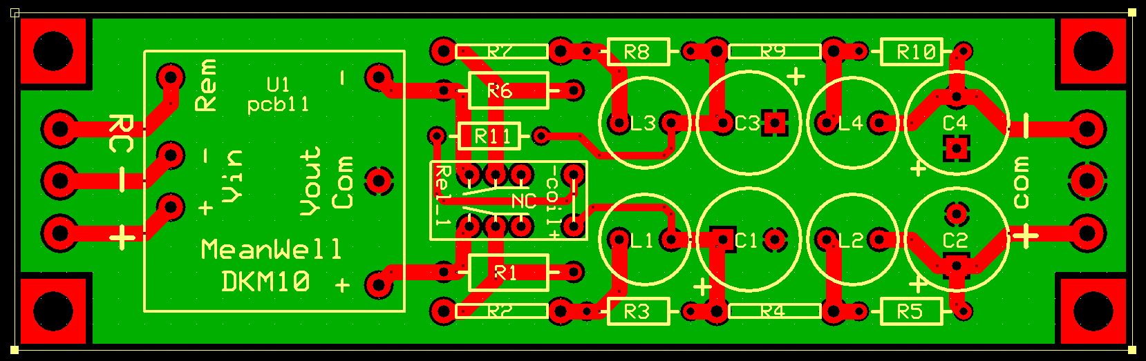

It's a religion thing. I generally "float" the mounting holes; they are electrically insulated from all other copper and all signals on the PCB. Other people do it differently.
Trial and error, uhh, that is, exhaustively thorough experimentation, often pays off handsomely in this case. Get out some alligator clip test wires and start short-circuiting the ground at point X to the ground at point Y. Which X-to-Y shorts are beneficial (e.g. reduce hum; reduce 120 Hz spikes on the THD plot, etc), and which shorts are detrimental?

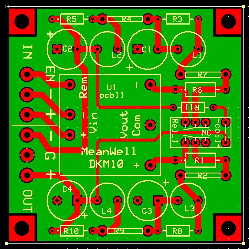

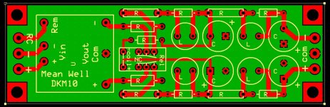

I like symmetry and found that I could move the first stage resistors to the outside edge of the pcb so have done so, and added my usual .150 standoff holes to the corners. Board had to grow to 4.125"
Question on the above: Do you recommend the stand-offs contact the ground/return layer or be isolated so ground/return is only connected to the board via the specified connection points? I've seen this done both ways and you just reminded me that I've been curious about the pros/cons.
--Tom
I always insulate. Also, decided to separate the power input minus from the ground plane, leaving only the Mean Well output pin grounded to the plane along with the necessary component grounds and output ground.

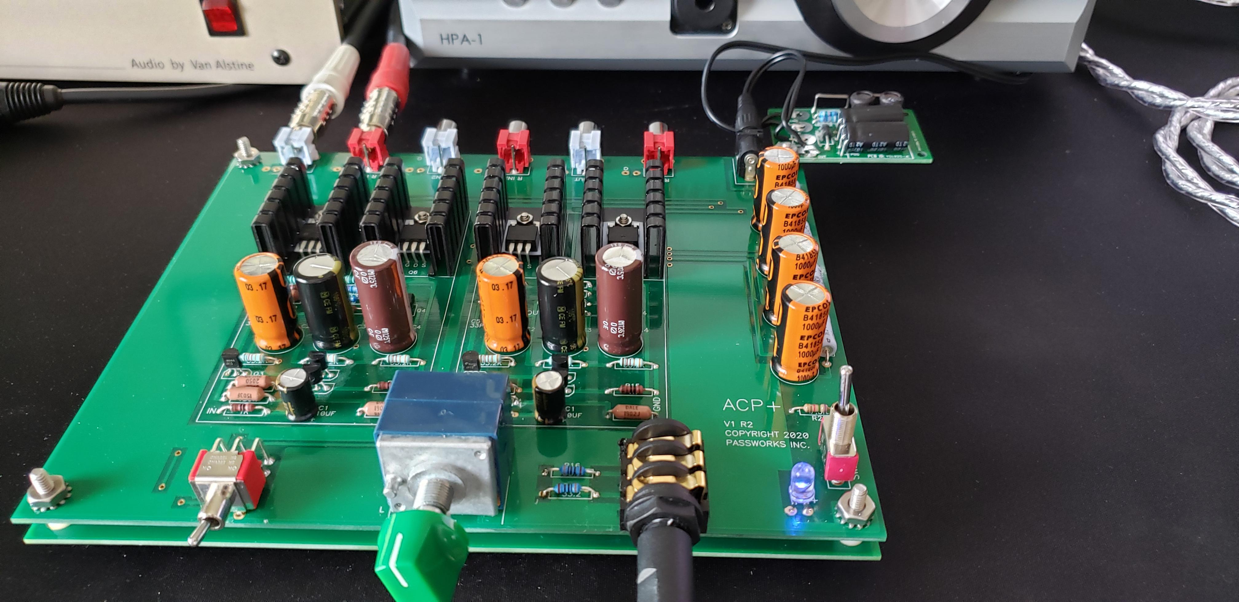

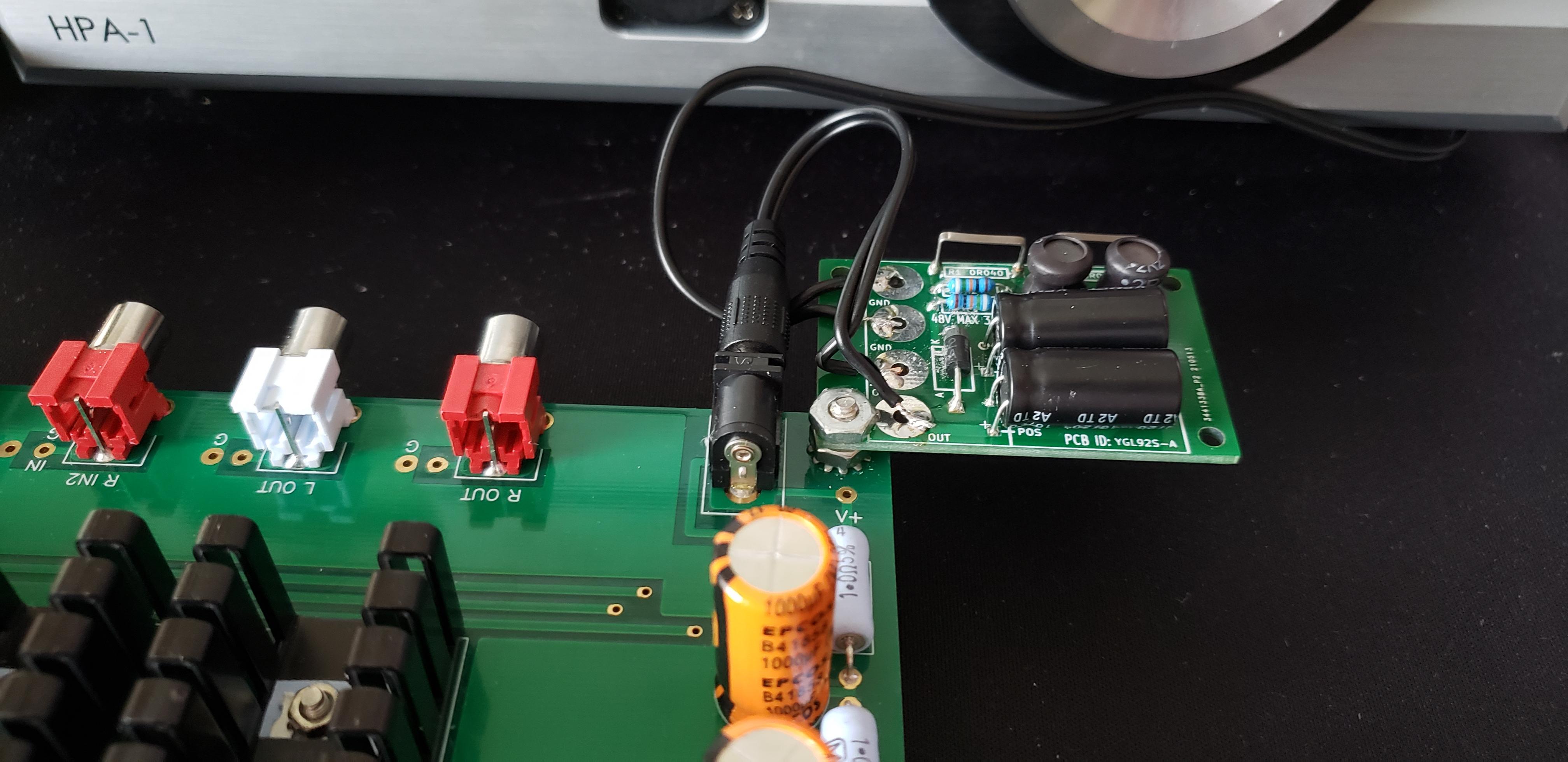

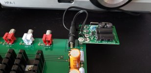

Mark...just got the really expensive kit from the store!! lol.
Took 5 minutes to complete...
Attached to my ACP + to one one of the back corner screws!
Really made a difference to me here...with HD650's
(also changed the resistors to make the ACP + pairing for 300 ohms).
I have never heard the 650's as nice as with this very, very simple and low cost setup.

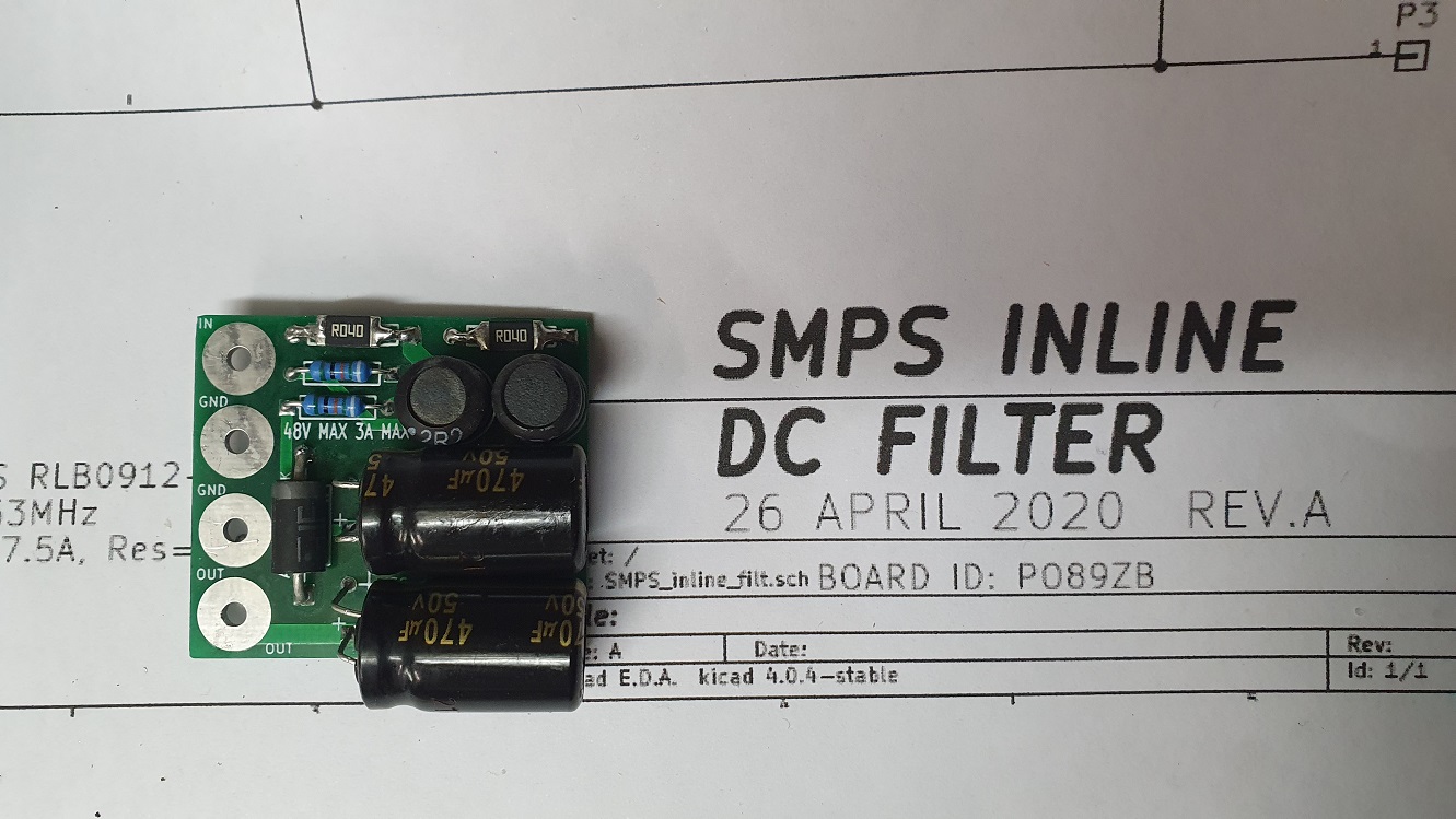

Finally got round to putting together one of these boards and thought I'd share the results.
The build was straight forward enough except:
* There were no through hole 0.04r current sense resistors available when I placed my latest parts order, so I squashed flat the end of some tinned solid core and made adapters for SMD parts.
* No mounting holes on this version of the board.
* The panasonic FM low ESR caps I had available were slightly too large.
Nothing insurmountable, and the board was a very quick to build.
attachment.php

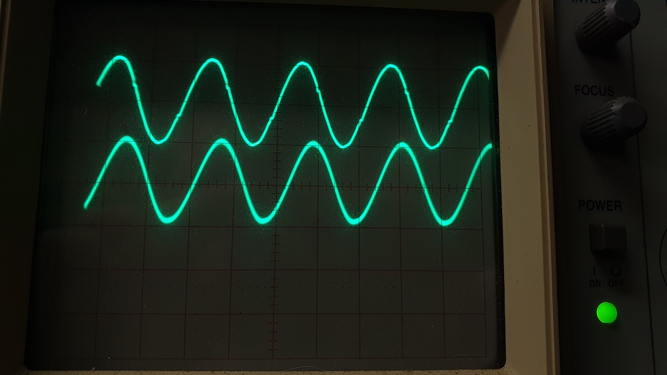

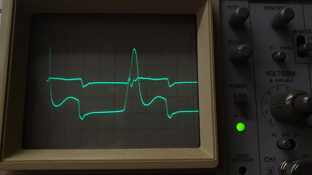

Next, I threw a 1Meg sine wave into the board. (Well, it used to be a sine wave before the long cables turned it into something fugly..):
attachment.php
~500mV went in at 1 MHz and 50mV came out.
Next was a 100KHz (not so Fugly) sine:
attachment.php
100mV in got 5mV out.
As you can see, I am using a CRO and not a fancy digital device capable of sweeps etc, but hopefully it illustrates that this filter is actually pretty good and doing what it is supposed to do.
As always, your mileage might vary, but I am happy with the results.

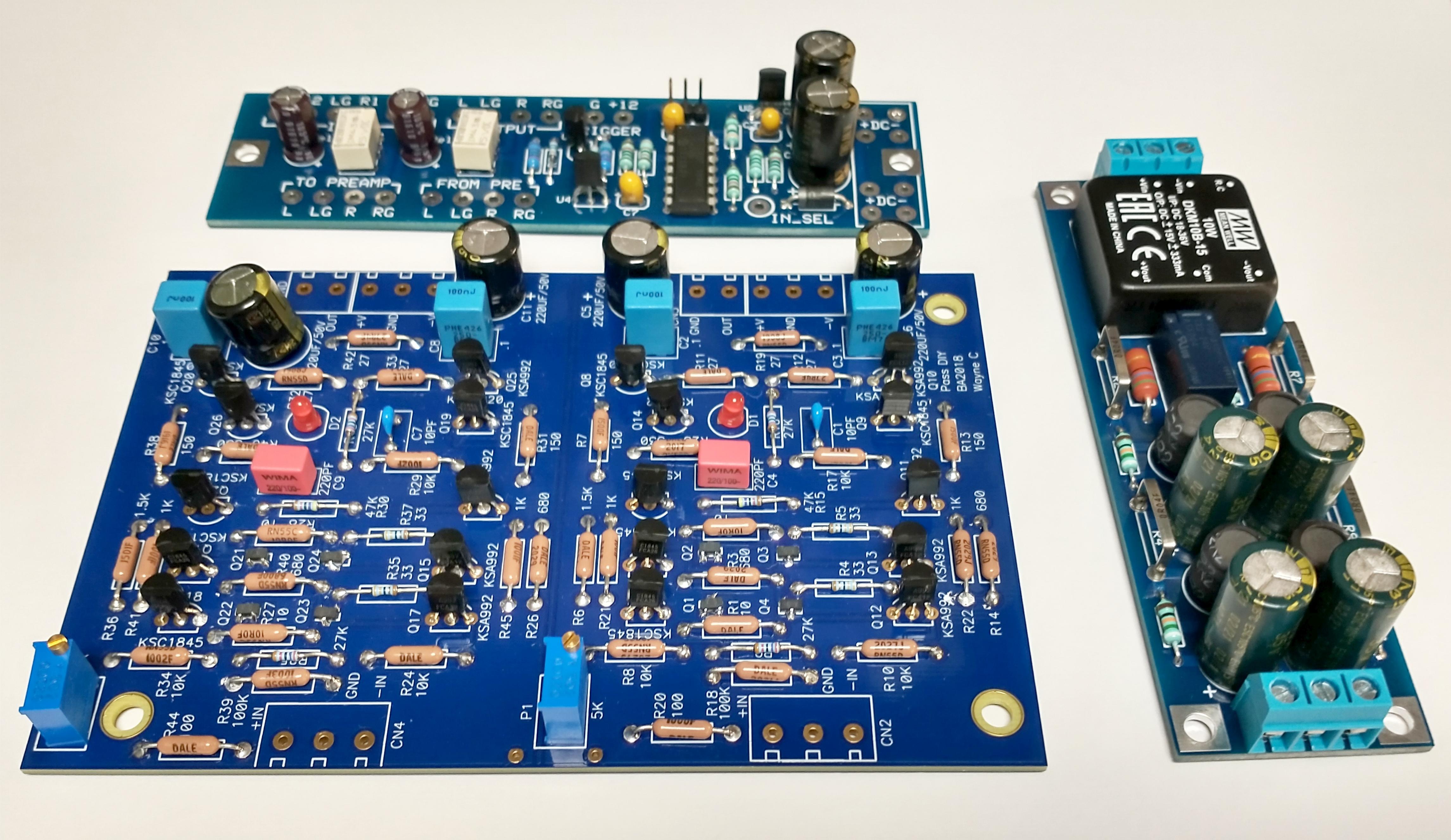

Finally got all the boards I need for my BA2018 preamp project. I tested the power supply with 1500uF on each leg (module rated at 330uF maximum) and I was at full voltage in less than one second with no glitching, I assume the relay is working flawlessly.
The filter board came out just about right except I didn't leave enough space inboard of the terminal blocks to include the needed text. Fixed in the next iteration.

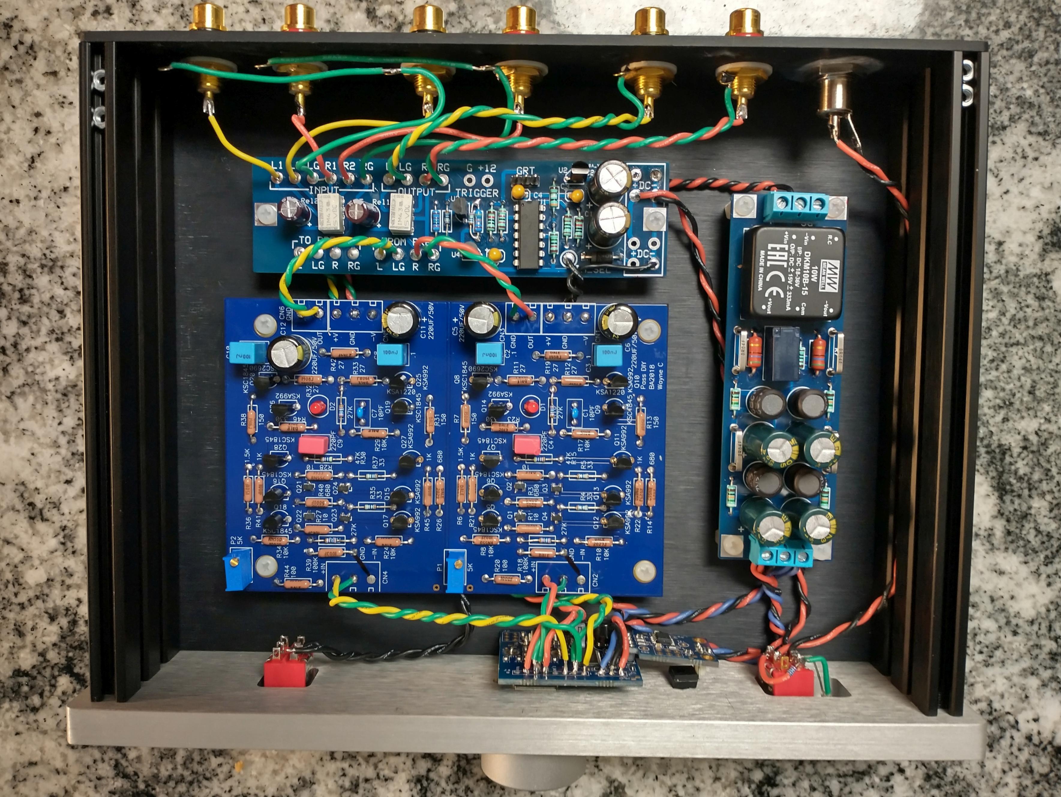

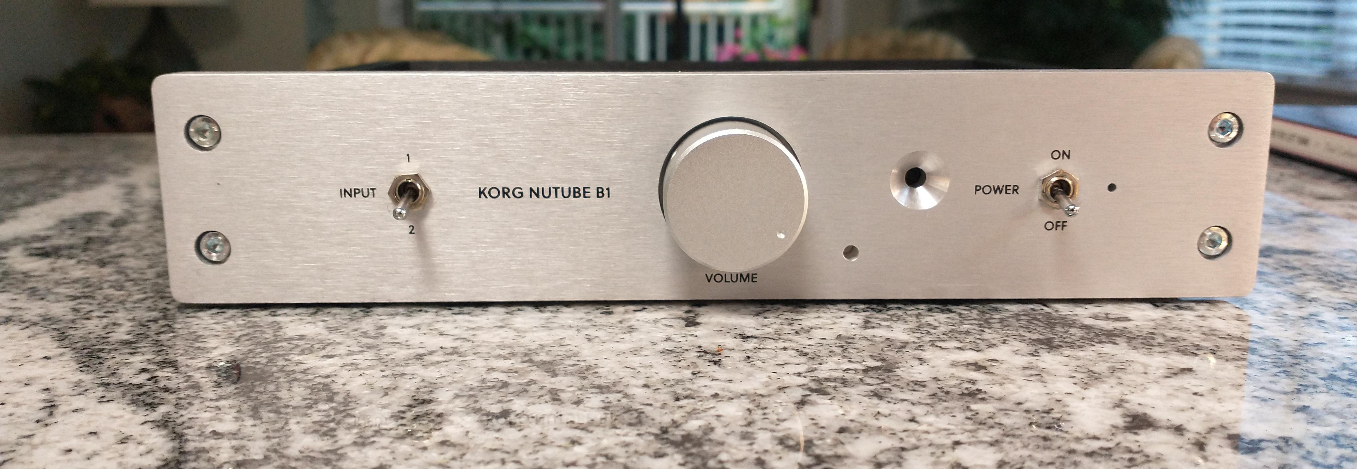

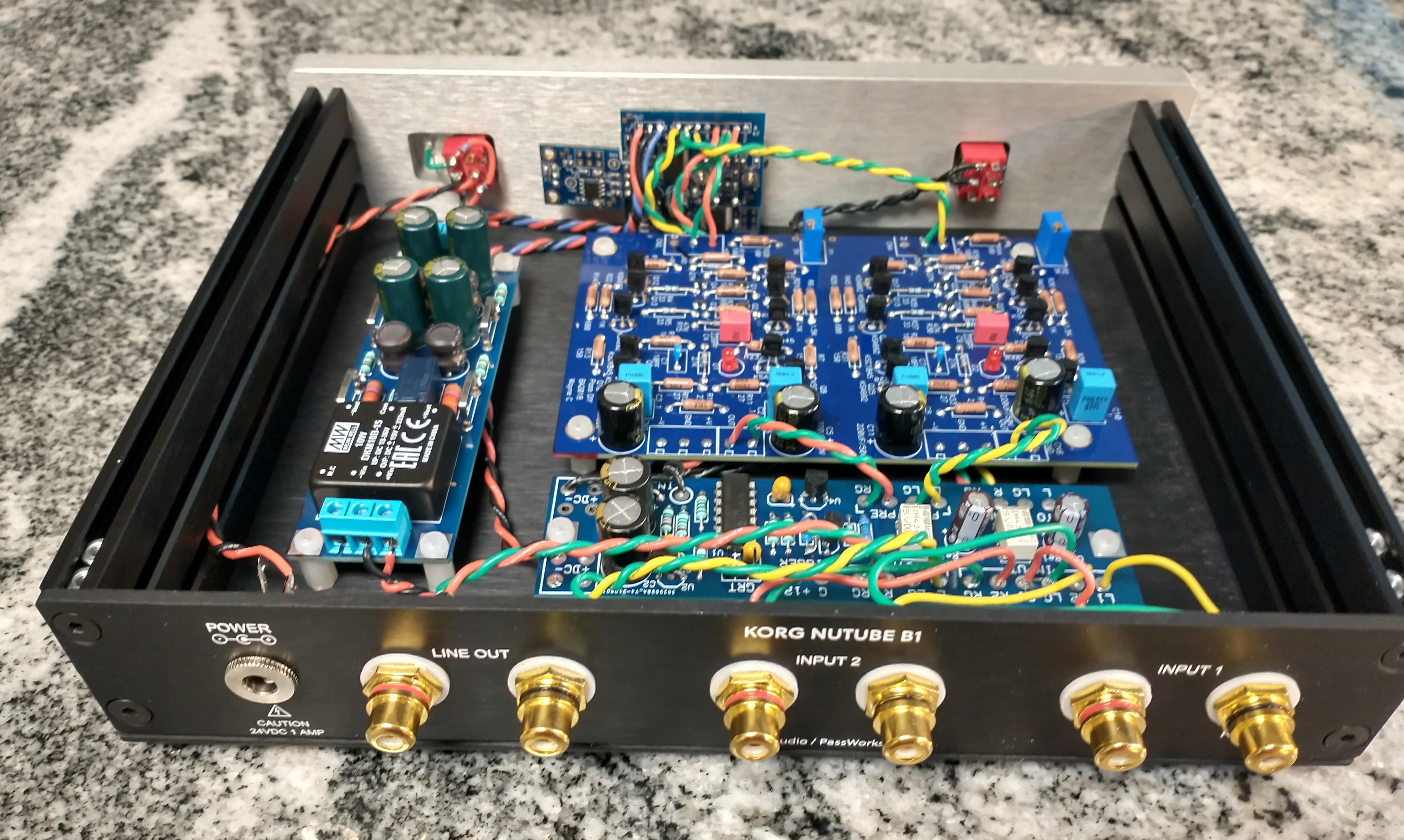

I wanted to build Wayne’s BA2018 preamp, and to save time and effort I decided to install it into my Korg B1 chassis, with a PO89ZB-based +/-15V power supply and my own pcb for delayed turn-on, relay-switched inputs, and a 12V 25mA Trigger circuit.
It all fit nicely into the 6.5” x 8.25” Korg chassis thanks especially to the PO89ZB power supply, along with a Muses chip-based IR remote controlled volume control and, surprisingly, I didn’t have to pack it in.
Sadly, it was going to be really tight to install a jack for the Trigger on the rear panel and since my current amp doesn’t have a trigger circuit, I decided to leave that capability for another project.

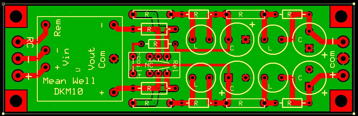

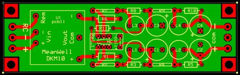

I don't know that anyone has any interest in a dual +/- supply from a single voltage and then smoothed by this filter, but thought I'd share my two layouts -- one a long rectangle to fit my B1 Korg chassis, and a more conventionally shaped 2.35"x2.35" square layout. The relay arrangement places a current-limiting resistor inline until the capacitors are mostly charged and then shorts the resistor. I can upload Gerbers if anyone wants them.
