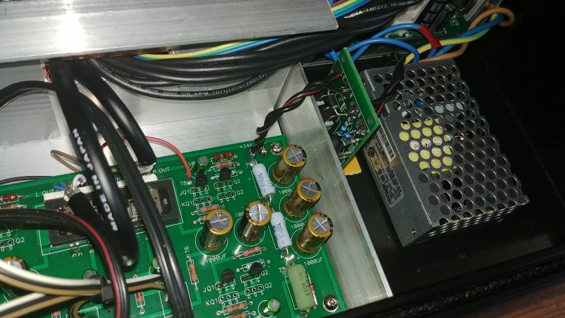

I ordered a cheap LLC switch mode power supply from Ali Express. Now doing that is a lottery, sometimes you are surprised.
This PS is intended as a built in for an ACA so it is single voltage and 24 V.
To use the filter in an ACA I will use slightly different values for some of the components, more on that later. Also a thicker copper layer on the PCB. And one filter per channel.

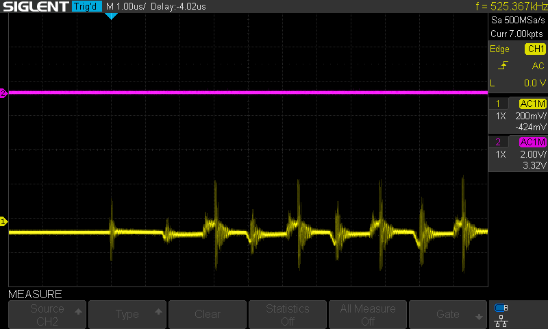

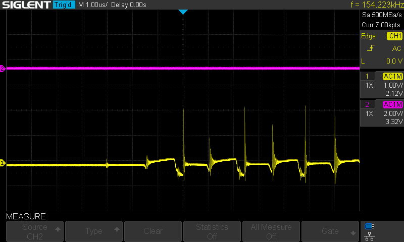

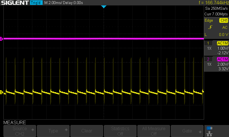

I tested it yesterday on the bench to see what I got. The voltage is stable to the second decimal between a light load and 1 A continuous, that is expected. But the noise... is interesting, 3 V peak to peak, horrible!

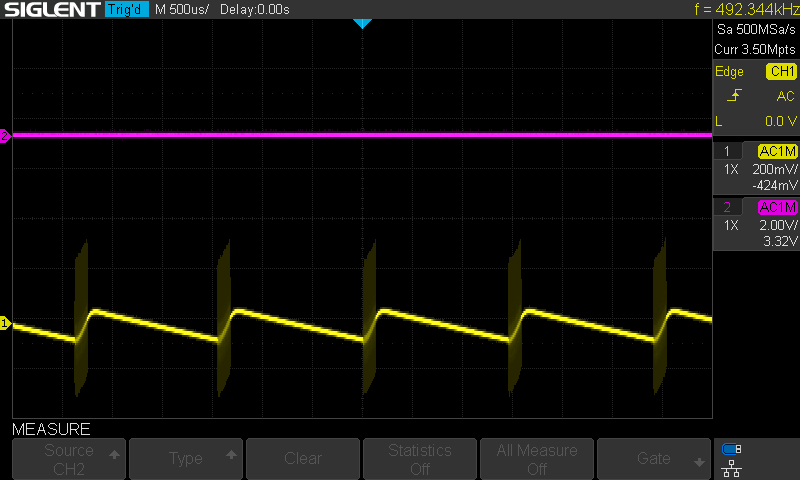

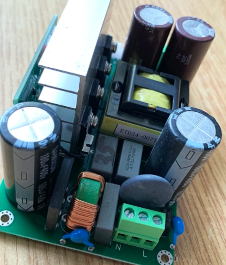

Putting a well known filter between the PS and the load made a difference, now it is 600mV of high frequency noise, at one ms interval....
I will see if it is possible to tune the filter to better suppress the high frequency content, but that will be a trial and error proposition for me.

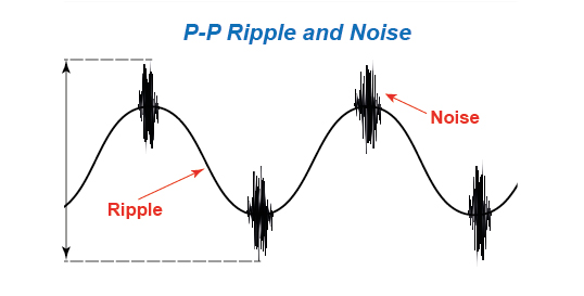

Price please because standard in the switching PSU industry is to have 1% of ripple so 240mV max for +24V output. Most of known manufacturers do that. Some of them are better (<100mV of ripple).
Manufacturers like Meanwell, TDK Lambda, XP POWER have very good PSU for a good price (for me).
Another remark, noise and ripple are not the same thing. Ripple is at switching frequency (value is on the datasheet). Noise is more difficult to know by technical documentation and only an oscilloscope can sometime give the information but it needs an oscilloscope with a high bandwidth (forget 20MHz, at least 100Mhz and maybe 500MHz in some cases).
So best way for filtering is tgo design a filter for each "problem". One calculated for ripple (f ~100kH-500kHz, see datasheet for swithing frequency) and another one for noise (f > 10~50~100MHz, small capacitors value + self with a high sfr value to "go" in the very high frequency).

Good points.
Yes there are better alternatives, but I see a lot of people buying there supplies, and this is after all DIY. I like to see how far I can take it and not ruining the regulation.
Low frequency ripple is resonable, I think. The high frequency not so and there is where the high peaks are. This might not be a problem in my application, but I like to tinker.
