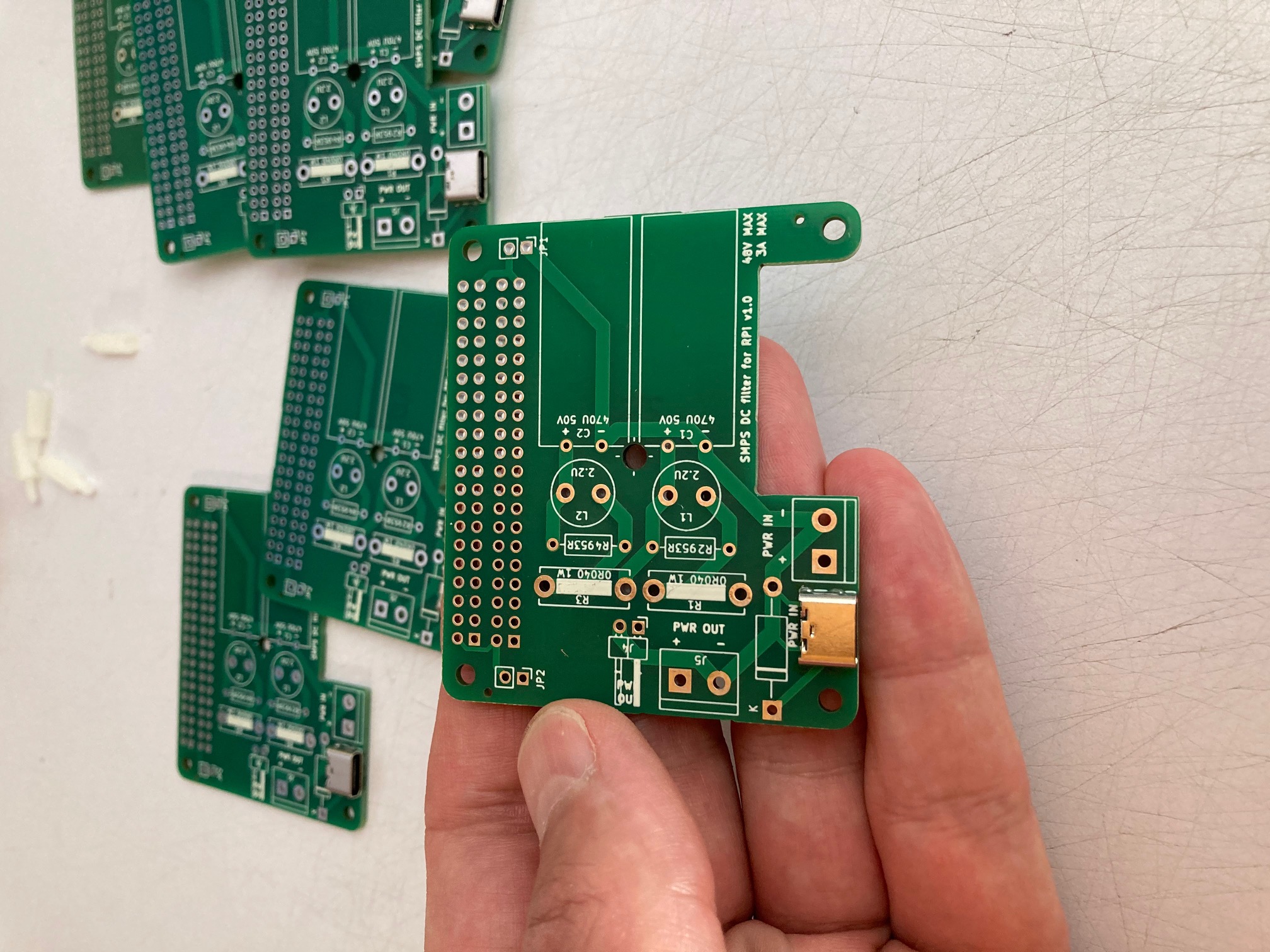

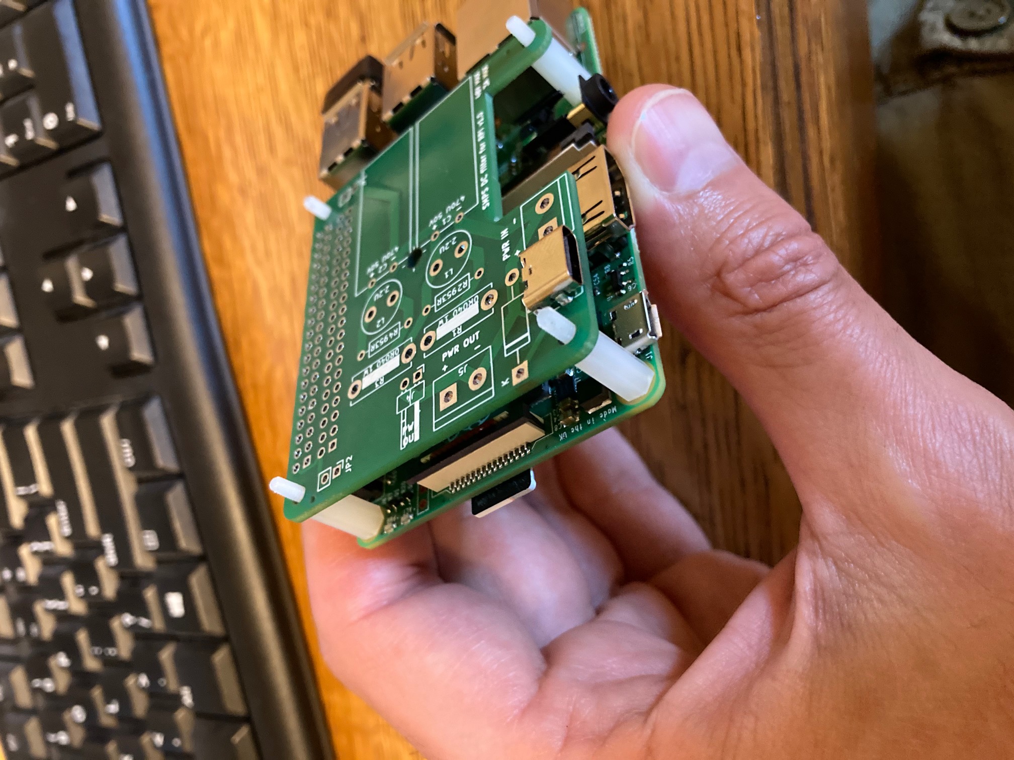

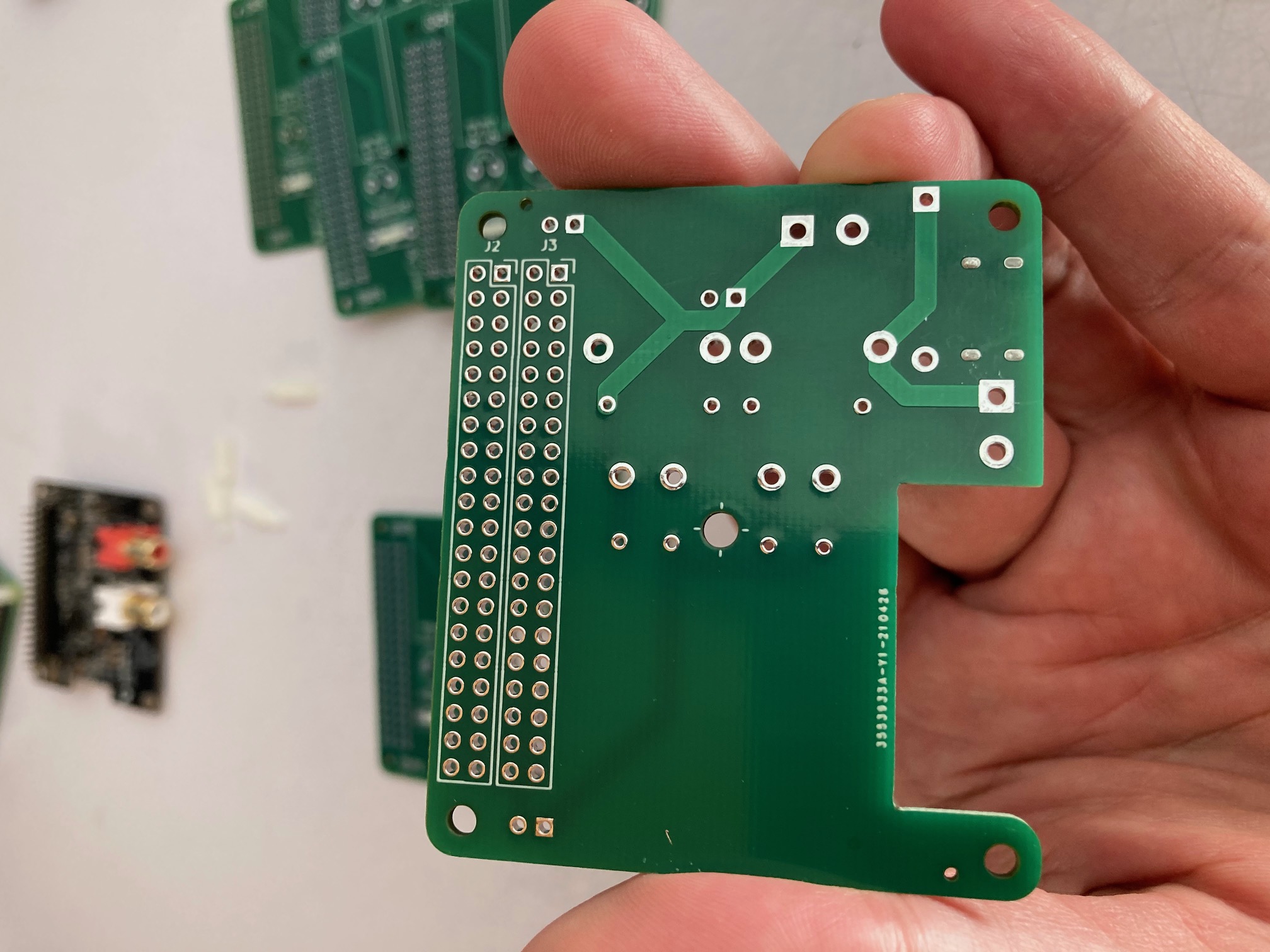

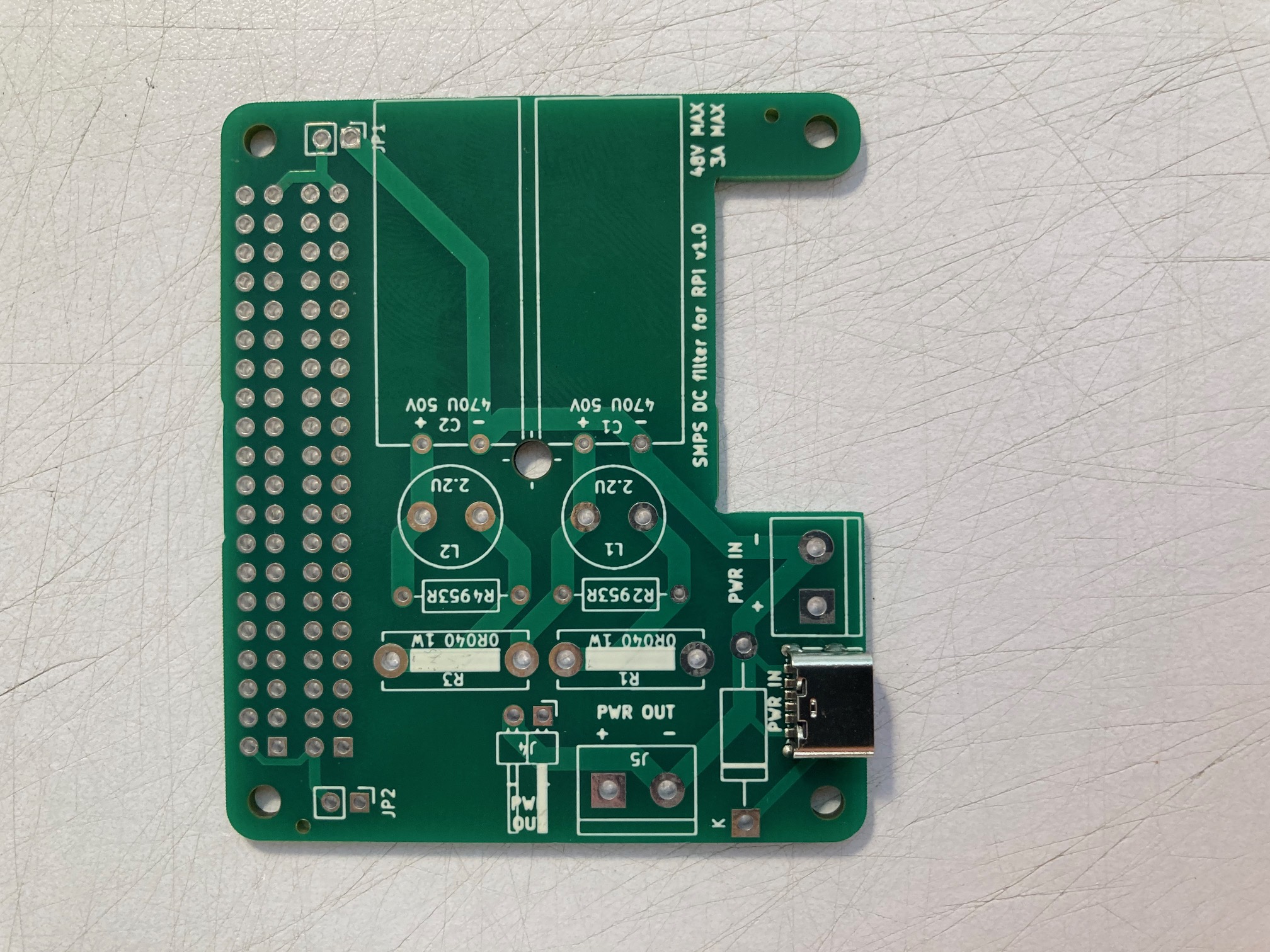

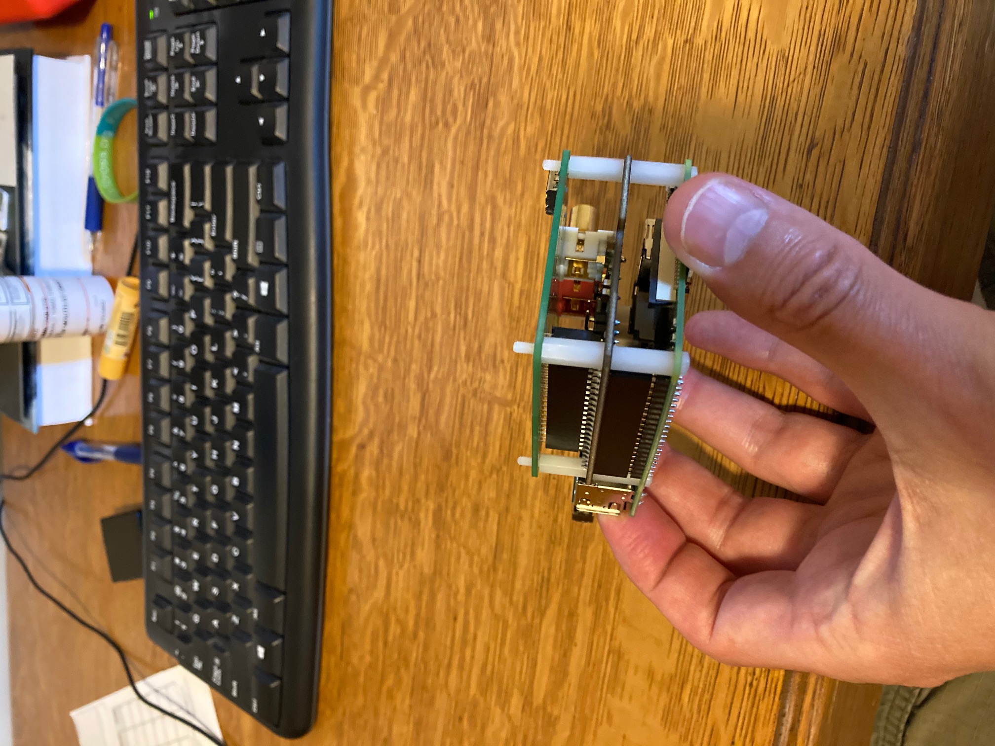

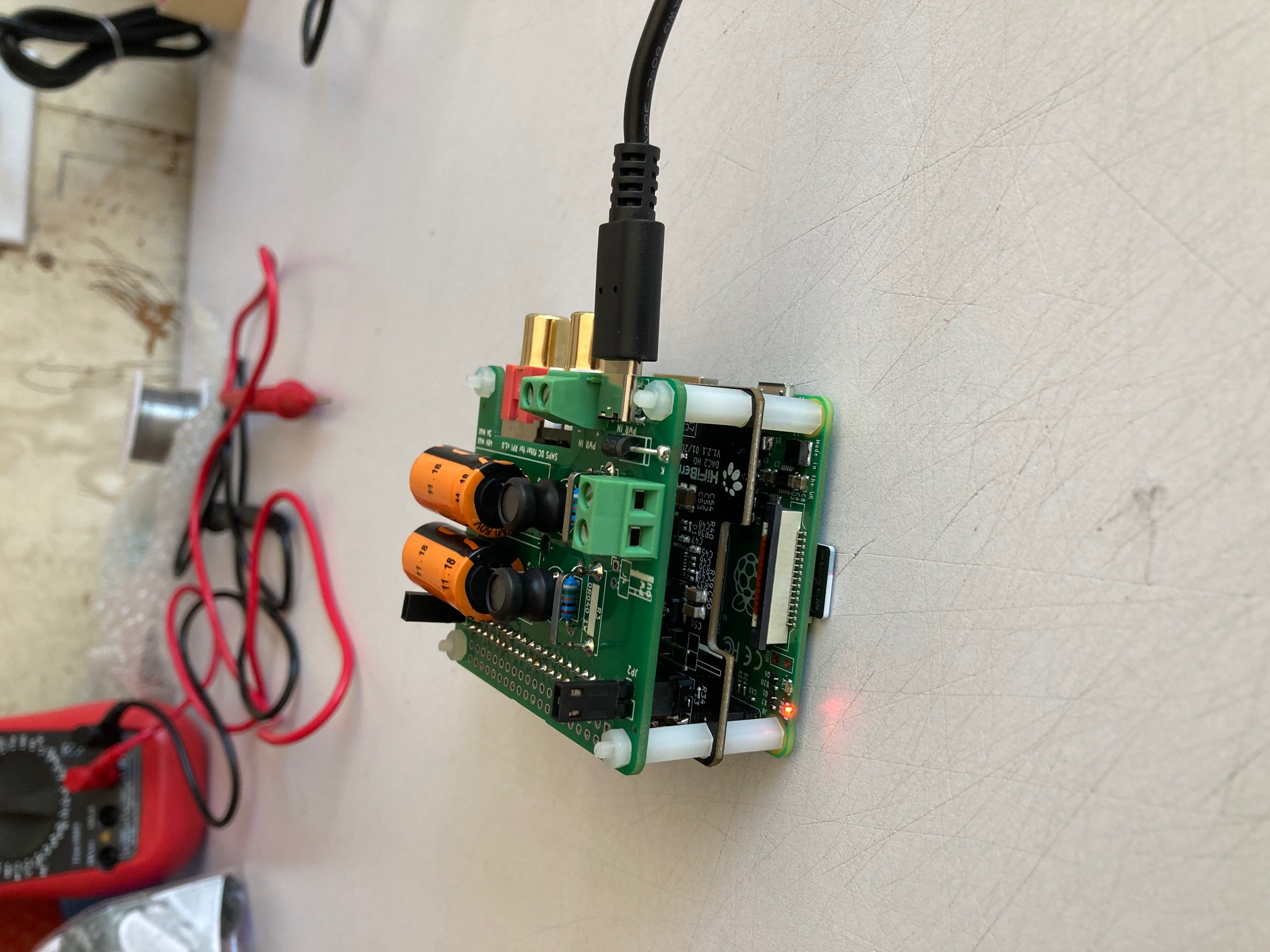

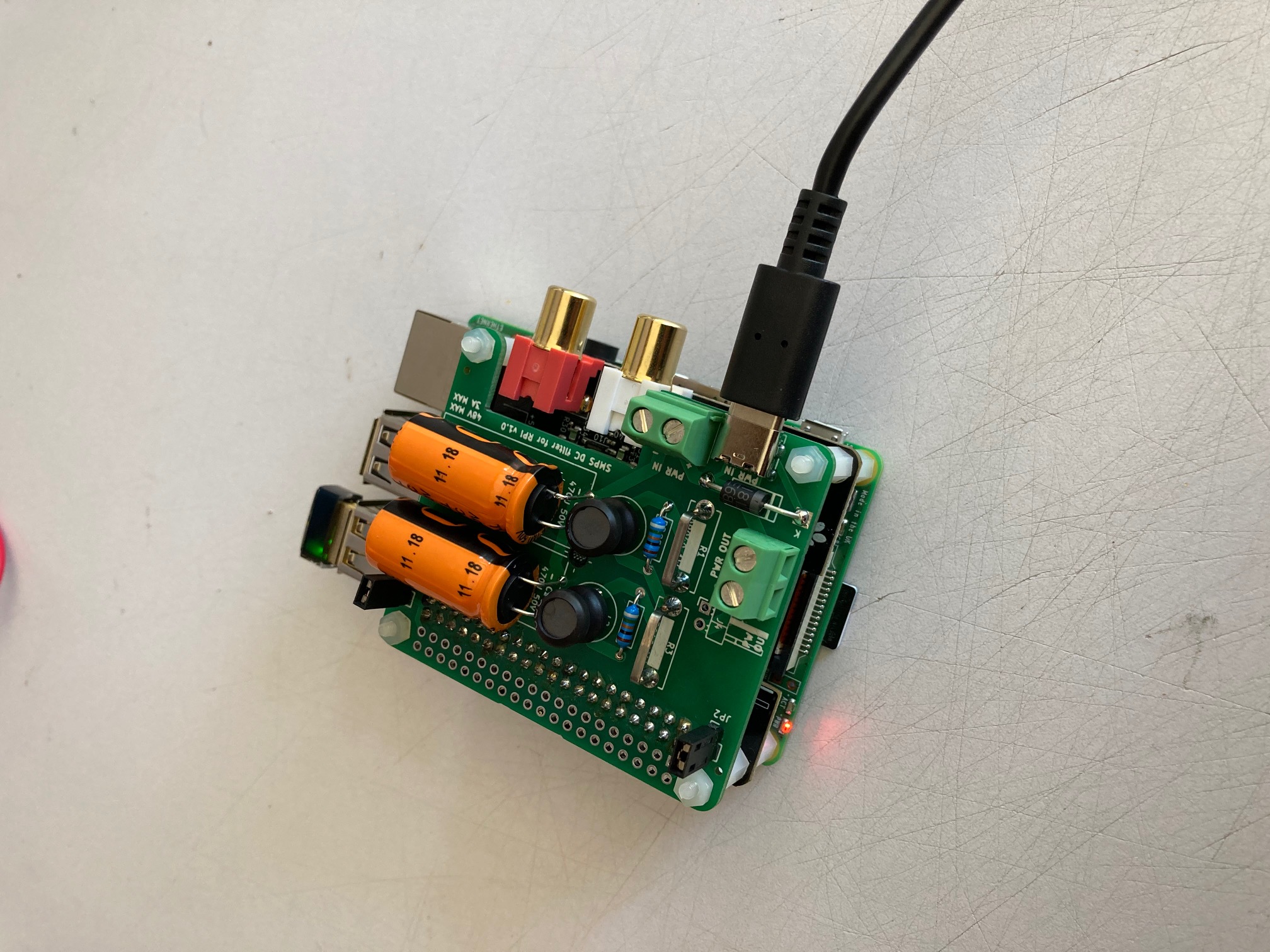

So the HAT boards I designed with Mark's SMPS inline DC filter circuit came in. I tested all 10 with a USB-C RPi power supply plugged in to the SMT receptacle and I can read 5.26V across the spot where the TVS goes, so the USB-C receptacles were mounted properly, though 4 of them are a bit crooked- just cosmetics. The two mounting spots for the 40-pin GPIO, one for direct-mount on top of a RPi, one for mounting on top of a HiFiBerry DAC or similar card in the lower position, look like they align as well (see the pictures). I'll be building up a couple and testing them with my RPi and sound cards over the next few weeks, time permitting, so I don't know yet if they actually work!
I have 7 of these bare boards to spare, to anyone looking to test and play with them. In the spirit of thanks to the diyaudio community, to Mark for designing and sharing this useful little filter with us, and to avdesignguru for encouraging me to teach myself KiCad and for reviewing the design, I offer these 7 for free to the first 7 people who pm me for them. I can even throw in a 40-pin header and a couple of jumpers if you'd like. For international folks, I ask that you consider reimbursing me for postage; for US folks I'll cover it.

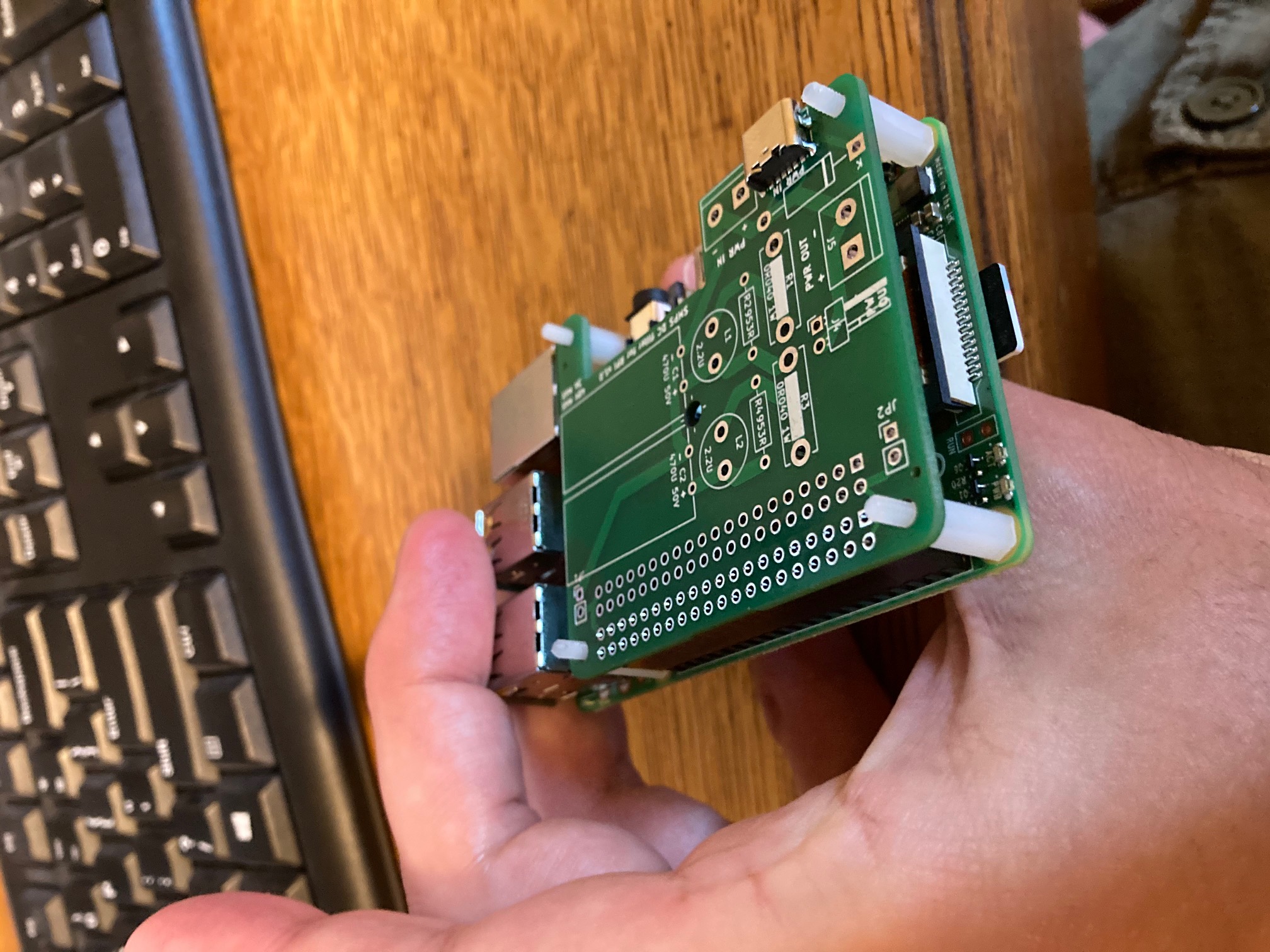

Lovely 3D arrangement! Congratulations. When the filter board is mounted atop the board with the two RCA jacks, one white and one red, it instantly becomes clear why there's a notch in your PCB. Please let us know how well it works when playing music.
Thanks, Mark! I didn't get as far as music today on account of some unresolved library file issues, but I did get through power up. I didn't see any under-voltage lightning bolts from the Pi (4.6V or so); the lowest I measured across the output with a cheap DMM was 5.05V, so hooray. Across the first current sense resistor which sees 5.26V I measured voltage drops of 25mV at idle (625mA I guess), up to 54mV (1.35A) under disk copying, so well under the 3A rating of the circuit and the wall wart. Also hooray.

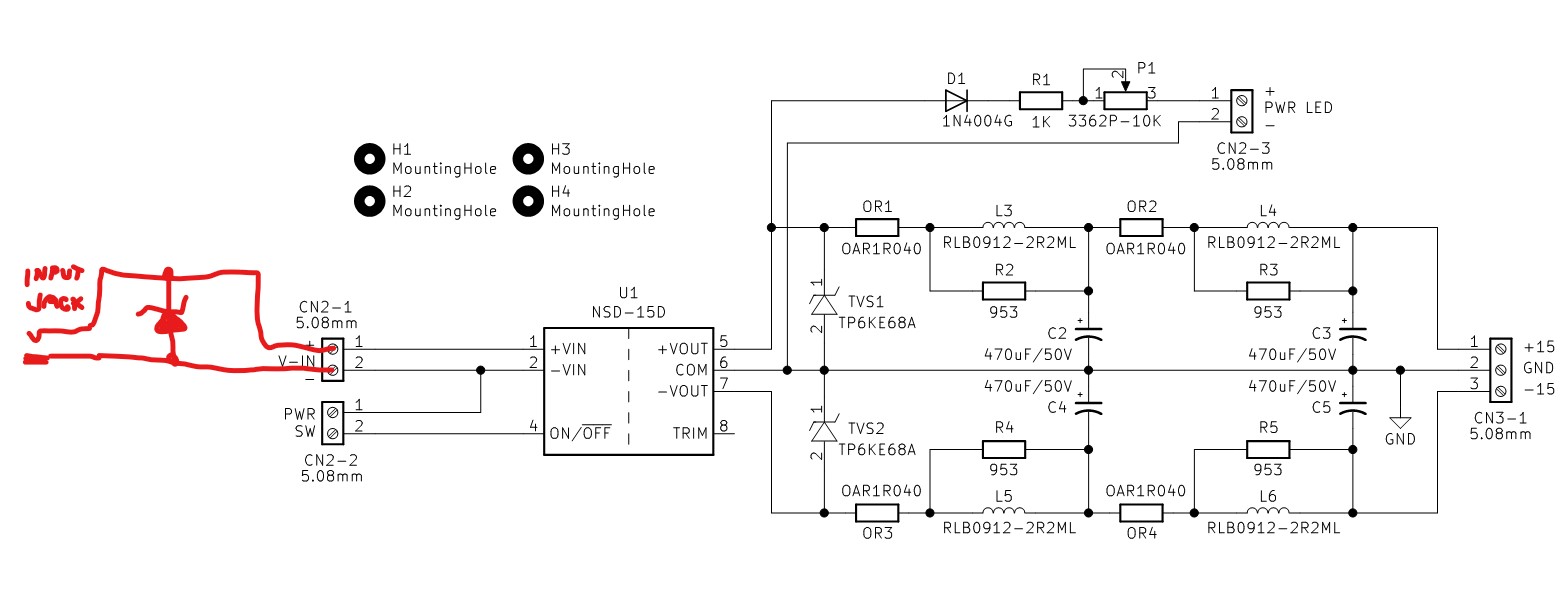

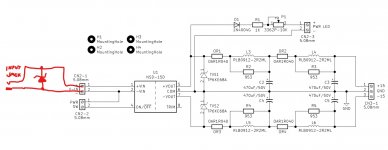

Question for Mark
Do you think I could/should add a TVS diode across the power jack input to the DC-DC converter to prevent someone plugging in a reverse wired wall wart supply and accidentally damaging the converter? Does the attached look correct? Am I correct in assuming the TVS does not load the supply in any way unless the input to it is reverse wired or exceeds 68V?
Oh, and the input should probably be labeled something like 18-48VDC, not 18-72VDC, correct? In the USA at least, you probably won't find a wall wart above 48VDC.
Yes, 48V seems to be about the highest. I'd definitely include a unidirectional TVS, a big ole bohunker 5000 watt device in a R-6 or P600 package with mongo hefty leadwires. Here's an example for just under two dollars: Digikey link

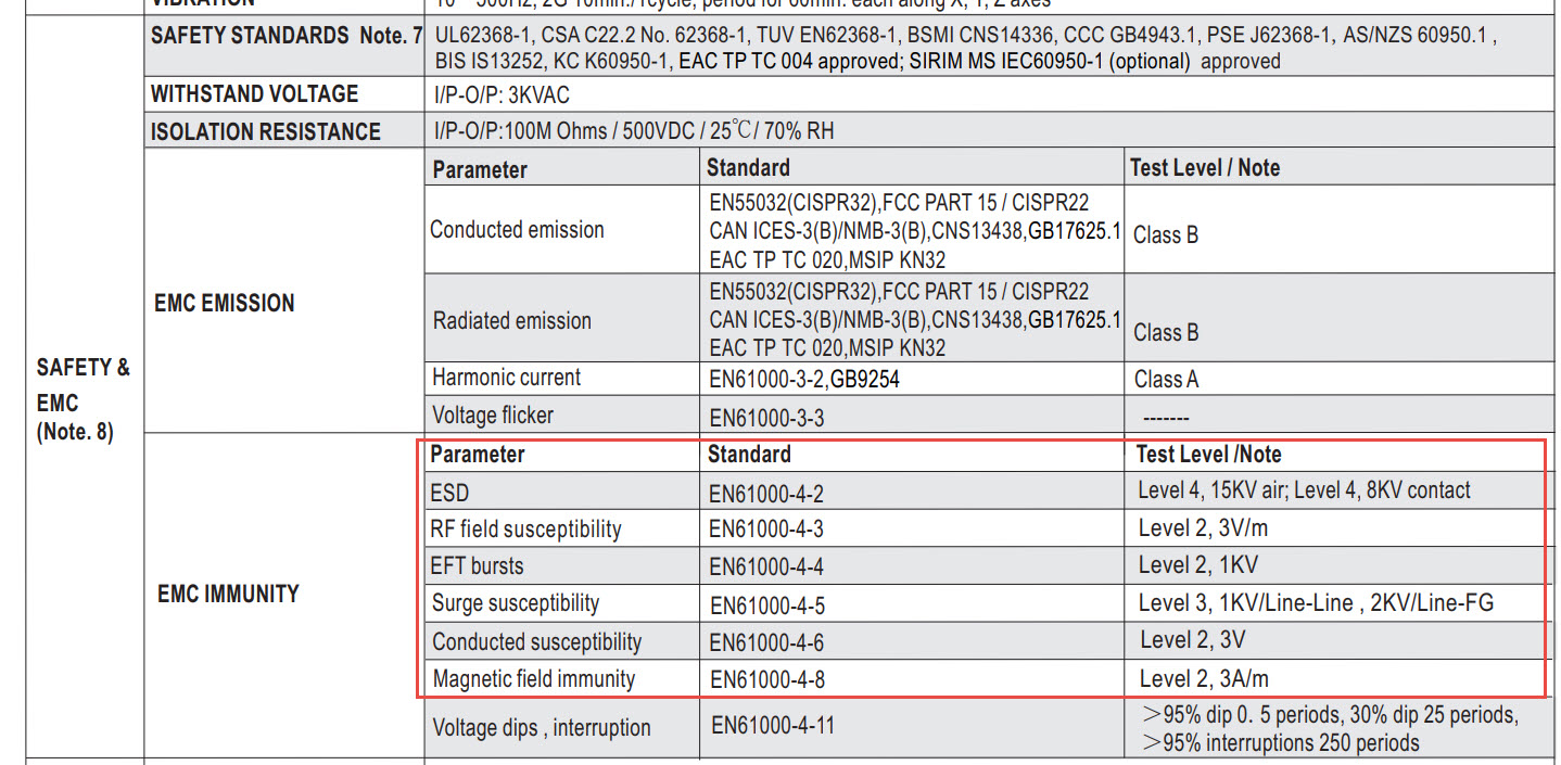

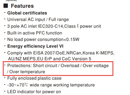

I am not familiar with the big Mean Well SMPS and don't know if they include some kind of protection should they fail. In short, I want to make sure my VFET will be protected if the SMPS fails and nothing like 230V or whatever bad may happen / could destroy the nonobtanium output transistors.
In your experience, could it make sense to add such a TVS at the power input in case the SMPS (or else) fails? Or are in fact these devices already protected / include similar inside?
What would be your recommandation?
Many thanks for your help
Claude
Thanks for the TVS link, always interesting...
Claude
On most modern AC/DC SMPS, there is a lot of protection. The input can whistand the "normal" transient on an AC line (input is 85-265Vac) + abnormal transient such those defined in IEC 61000-4-5 (a TVS is used to pass the IEC 61000-4-5 test)

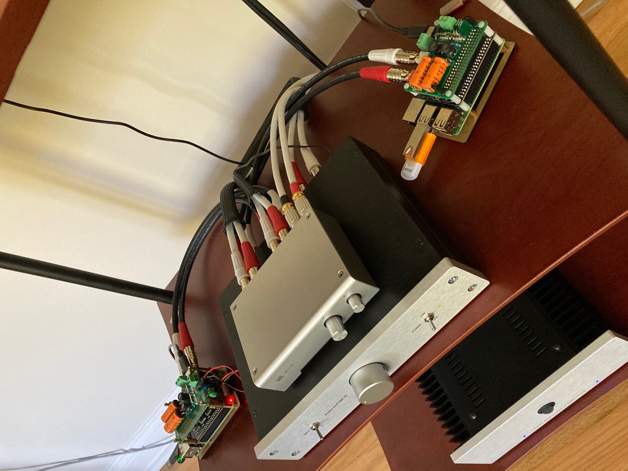

So, after extensive listening with two different Pi/DAC HAT combinations, I don't hear any obvious improvement when the DC filters are in use. If anything, there may be a slight reduction in dynamic range when they are, but I could be hallucinating. Setups are:
Raspberry Pi 2 Model B Rev 1.1, AD1868 based R-2R DAC HAT (audiophilediyer.com)
Raspberry Pi 3 Model B REv 1.2, HiFiBerry DAC2 HD
There's a rhythmic pop-hiss from the AD1868 card that isn't helped by the DC filter HAT. That said I personally prefer the sound of this card over the DAC2 HD, at least for the rock/pop/"girl and guitar" type music I typically listen to.

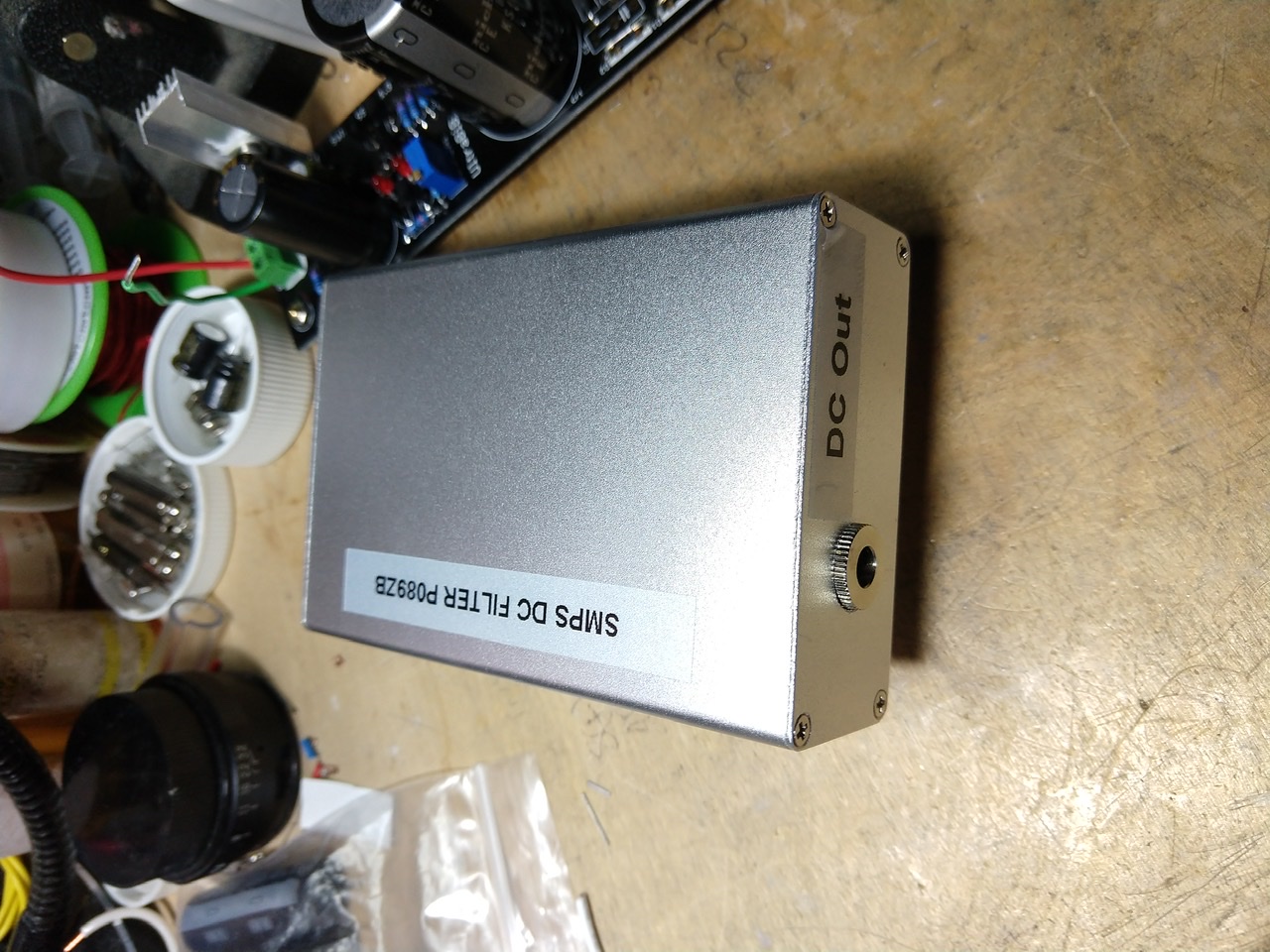

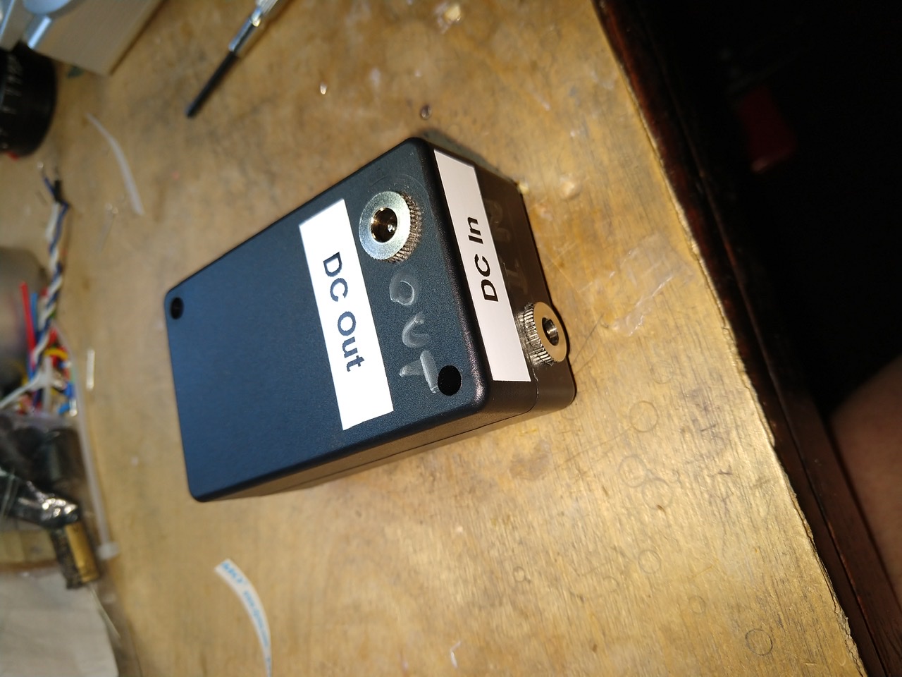

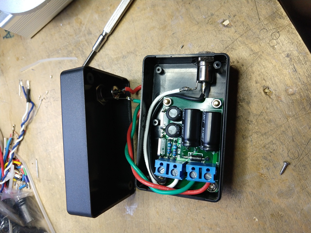

My two enclosure designs
Both cases were ordered from Amazon.
The black plastic case is: DGZZI Electrical Junction Box 4PCS Electric Plastic Black Waterproof Project Junction Case 3.15x1.97x1.38 inches(80x50x35mm; $8.60 for 4 boxes) while the silver aluminum box is: Eightwood Aluminum Box Electronic Amplifier Project Enclosure PCB Circuit Board DIY Case, 4.32 x 2.82 x 1.13 inch (LWH); $11.00. Little soft plastic feet stuck on underneath.
Thanks for the board design & kit sales!
