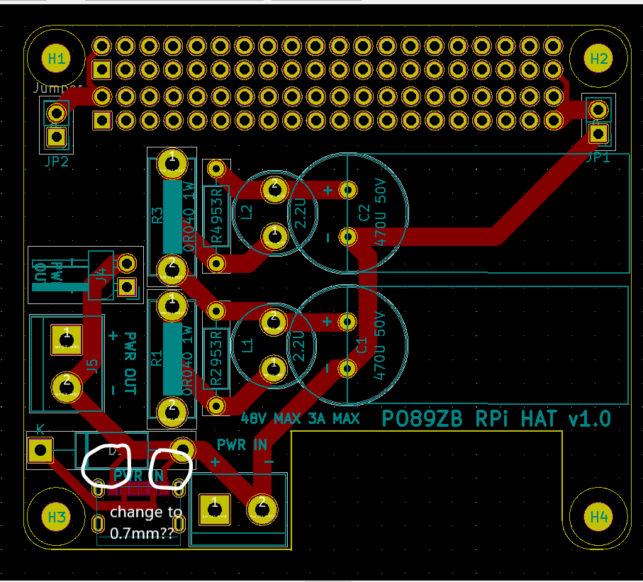

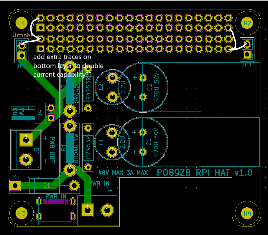

ranshdow:
Board appears to match the schematic.
RE: 0.6 traces. I noted what I think are some ways to get more trace width on the attached screen shots. Don't know if they will work until you try them.

ranshdow:
Mm, those are both good suggestions. I especially like the idea of running traces on both sides. Anyway, I got impatient over the weekend and sent the PCB to JLBPCB, they approved it and now it's in production. Other than these 0.6 traces, it has another flaw- I chose not to include a ground plane. It's such a simple circuit with no obvious ground loops, and I couldn't intuit whether there would be ground potential differences anywhere, so I left it as it was. Also I need to wrap my head around why one would want a ground plane but not a power plane in something like this. Once I get the boards, it'll be play time.
I'll have 6-7 extra boards if people are interested in playing too. Because of the single SMT receptacle, these boards are 'expensive'- a little more than $3 ea. with shipping included. I also went ahead and put in a Mouser order of the various headers, jumpers & screw terminals as a kind of 'completion kit', minus the components in Mark's original BOM.
Edit: I should note, I intend to test this board fully in my application before I'd be comfortable releasing bare boards to anyone else, so if you are interested, please keep that in mind and know it could be a while.
I would like to thank Mark very much for giving us this design.:worship:
