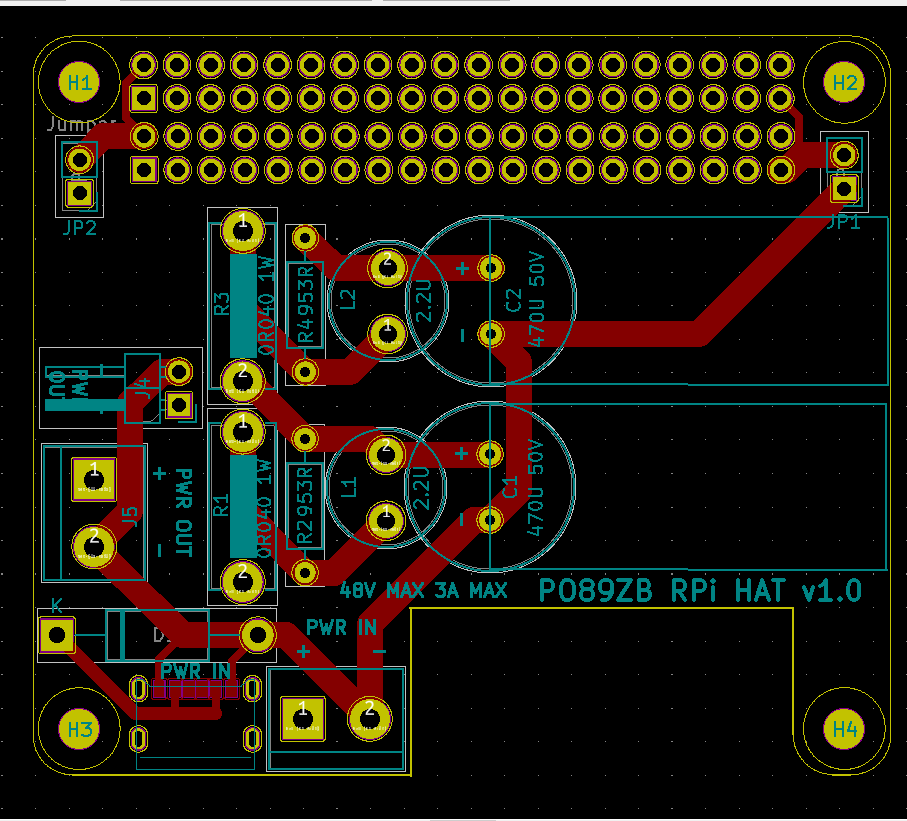

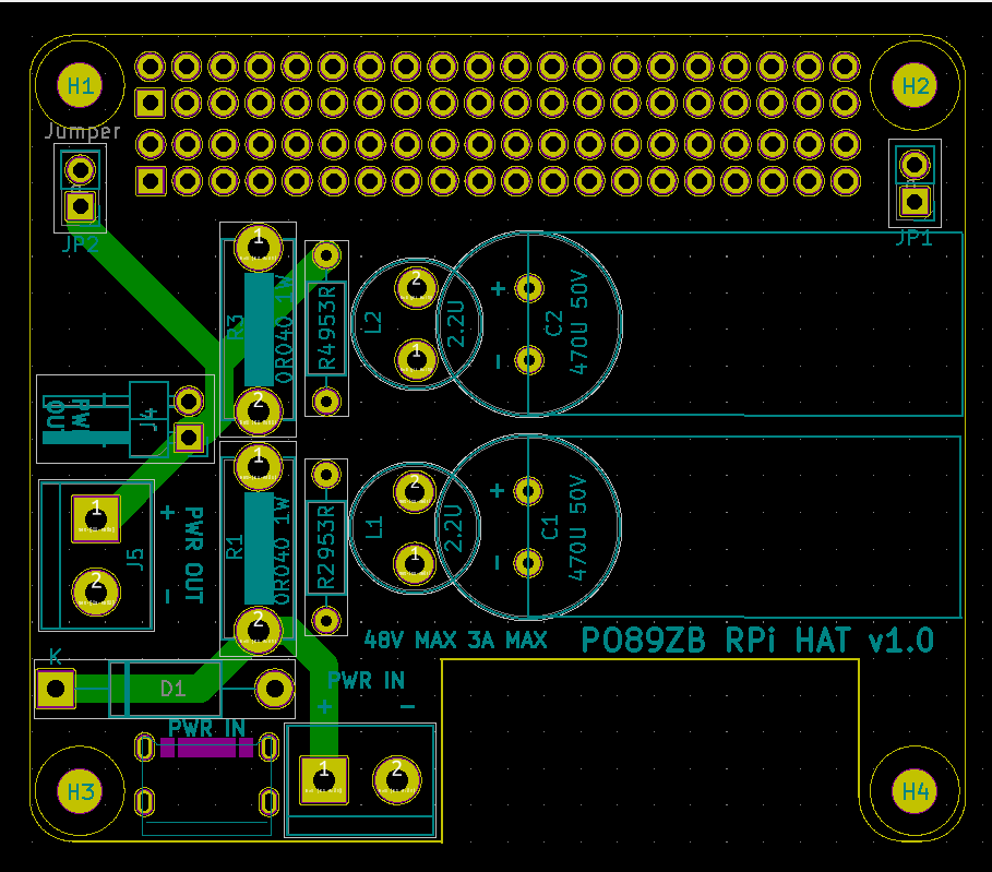

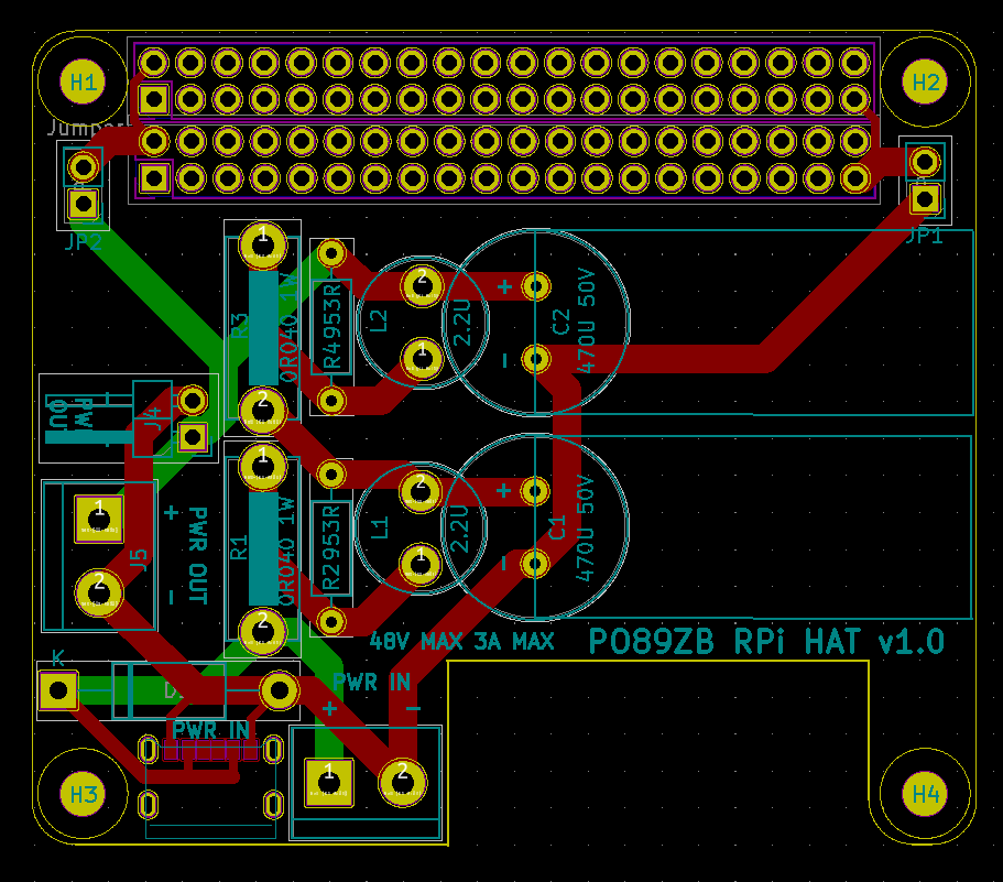

Thanks, Mark, and everyone else here who chooses to spend their time and energy having a look. So here it is, with some design notes.
I tried for 2.0mm tracks throughout, except where "steric hindrances" necessitated 0.6mm tracks or where routing on opposite sides of the board couldn't help. I'm not pleased about those 0.6mm traces, but the power-only surface mount USB-C receptacle, and the two stacked 40-pin GPIO ports in the standard locations for a Raspberry Pi HAT, don't allow for thicker traces to all pads. Power out through the upper block is relevant for directly powering an RPi through the GPIO when this board is the first board on top of a RPi. For use with HiFiBerry DACs, which is my preferred application, this board would be on top of the DAC and would connect and power both the Pi and the DAC through the lower GPIO block, which thankfully gets 2.0mm traces from the PO89ZB.
There are two power-in options (USB-c and a little screw block) and three power-out options (a horizontal jumper, a little screw block, and the GPIO blocks). I wanted jumpers to both +5V and GND to the GPIO so it could be isolated from the power out of the PO89ZB in case of experimentation or troubleshooting.
The board cutout is intended to accommodate the paired RCA jacks in HiFiBerry soundcards, which are a little too tall to allow this board to mount and connect through the GPIO bus if the board lacked the cutout. The capacitor rectangles are sized to accommodate the TDK capacitors I bought by accident which at 12.5mm x 25mm are a touch longer and wider than the 10mm x 20mm KEMETs and similars.
I don't have a ground plane (yet), or a board margin, or probably any of the other secret stuff a proper PCB layout needs. I was hoping that these images are enough to see if this looks square to you all, before I proceed with it and look into getting some prototypes made. Thanks again for your attention!🙂

I should add, the official HAT spec includes voltage protection circuitry for anything that draws power from the GPIO. Since the whole point of this is to put power to the GPIO, I wasn't sure it was necessary. I've thought about adding a spot for a 5.1V Zener diode in parallel with the output lines to the GPIO but decided I didn't know enough to judge whether that would actually work to cap the voltage to or from the GPIO at 5.1V.

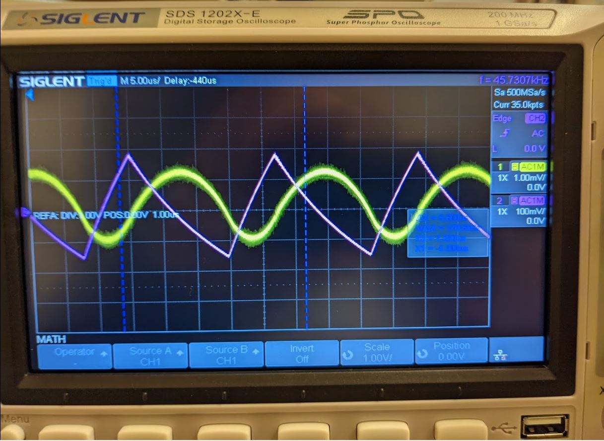

A friend of mine was looking into the possibility of using some inexpensive ($1.60) buck voltage converters for a project but they were so noisy he deemed them worthless. I suggested he try Mark's filter before he threw them away.
He was a bit puzzled (and perhaps skeptical) when he saw the resistors in parallel with the inductors, but tried it anyway. He couldn't get the resolution he wanted with the scope probes, so he soldered on a coax connector to connect the scope (he's a microwave engineer) and arrived at the attached photo, claiming that Mark's filter provides a better than 100 to 1 improvement in the signal.
Purple line is the input, but re-scaled so much you don't see all the noise.
Yellow line is the filter output.
He's impressed!

@ranshadow, "PO89ZB" is the identifier of my specific PCBoard layout. That's why the silkscreen text says PCB-ID: PO89ZB . See also post #406 in this thread. The idea is: there's only one PCB layout in the whole wide world with that ID, so there's no confusion.
I don't mind if you create a new board layout but please invent your own PCB-ID and don't reuse mine.
Ok, happy to change it. I thought it was the suffixes that you mostly wanted changed.

Thanks for the perspective and the encouragement- it was you pointing me towards KiCad that got this going for me. Your earlier dimensions guidance on the current sense resistors was useful and I found a footprint in KiCad that I think matches, which I'm using for them. If you're curious, it's:
Resistor_THT:R_Bare_Metal_Element_L12.4mm_W4.8mm_P11.40mm
It was that last bit, the hole pitch, that matched.
I'm going to try JLCPCB for the simple reason that the USB-C receptacle I used in my design is one they stock and offer as an SMT option. It took some work to find a footprint for it and to make a symbol but I think all that is square.
