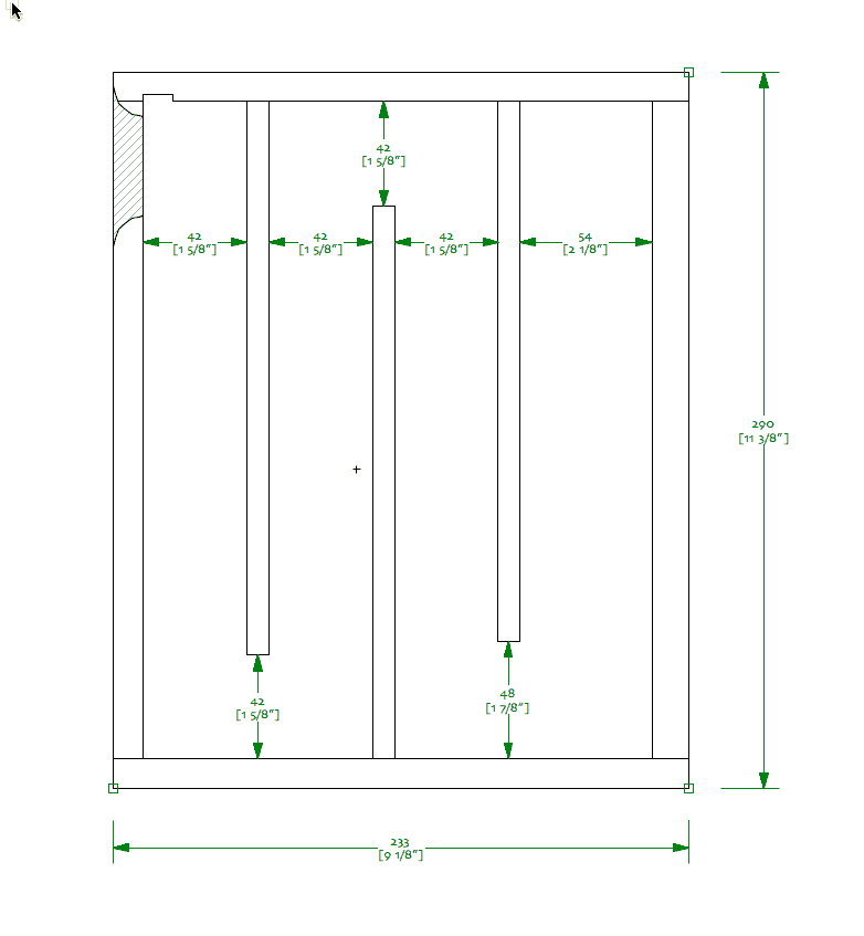

The brochure says the exterior height is 400mm and TL length is 48in. As drawn above is not 400mm high and only about 40in TL length.
https://pmc-speakers.com/sites/default/files/attachments/TB1-Brochure.pdf

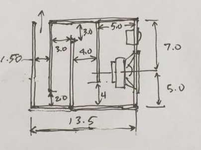

Your drawing is for PMC DB1 (height=290 mm). Height of PMC TB1 is 400 mm.Here is a drawing extracted from a PMC extents drawing to which i have added internal dimensions.
Test Case TL w/ DC130A-8

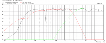

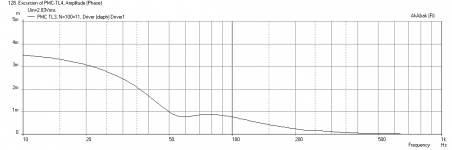

For fun, I designed a tapered TL with a 48in path (same as TB1) but made it with the following segment depths for each 12in traverse (4 total for 48in): 5in, 4in, 3in, 1.5in. Width is 6.0in (internal) and I designed it for the Dayton DC130A-8 driver. I will probably build it out of foam core and pair it with a DC28F-8 dome tweeter for a cute little 2-way TL monitor. The driver is located 7in down from the closed end, and the vent is up firing at the back. Here is a sketch of the design:
I modeled this in Akabak with 180 deg hairpin turns represented with the usual four 90 deg turn segments (expansion/contraction/expansion/contraction). There is stuffing in the closed end down to where the first turn is. However, I am doing two cases where I can add stuffing or not for the last straight segment (10in long) up to the vent. Adding resistive flow here has a large impact on frequency response, electrical impedance, and cone excursion as we will see.

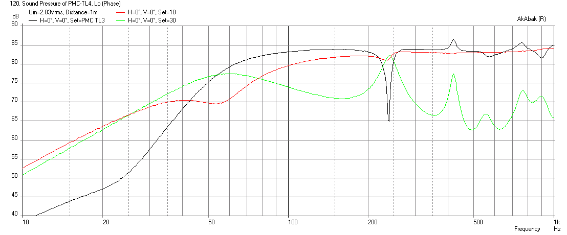

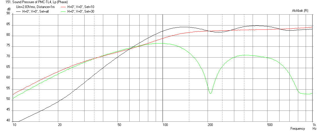

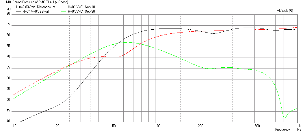

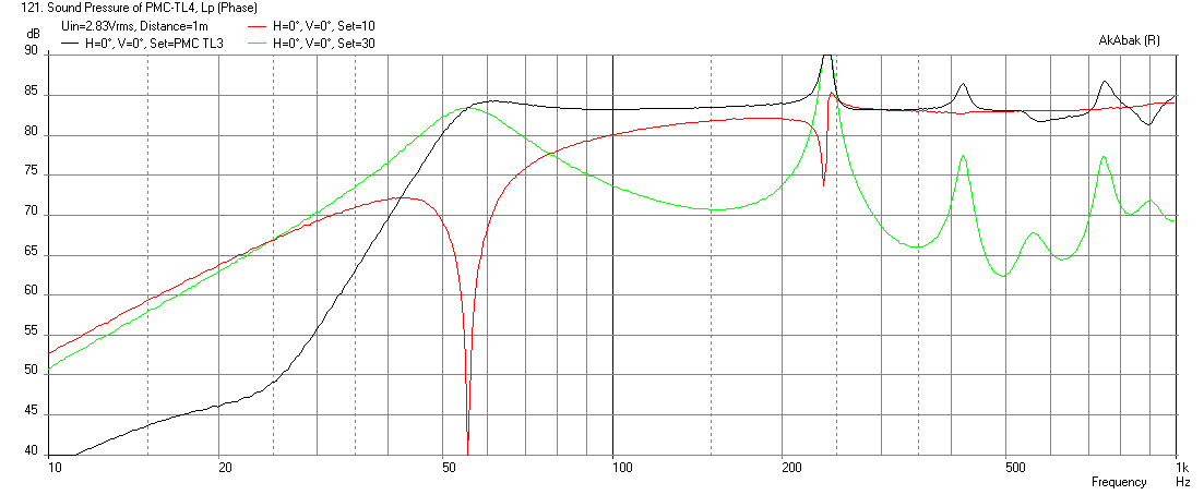

Here is the predicted frequency response at 2.83v and 1m for the unstuffed and stuffed case, respectively:
With Stuffing:

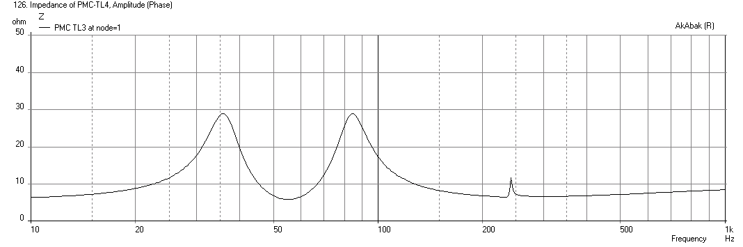

Here is the predicted impedance for the unstuffed case (max is 29 ohms):

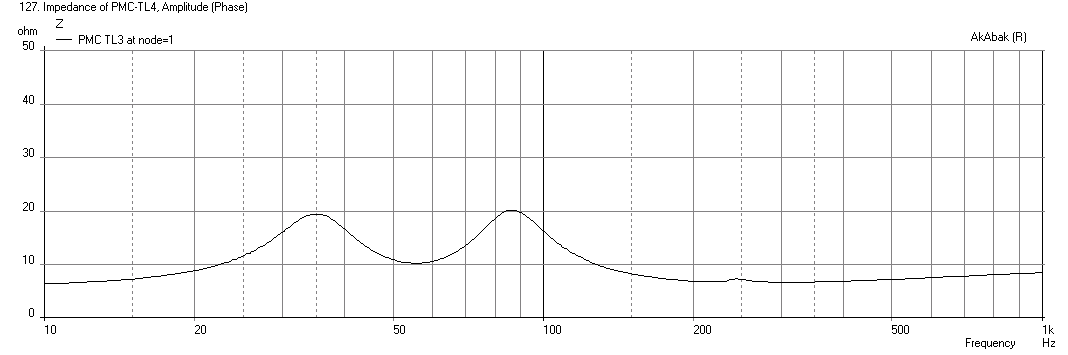

With Stuffing (max is 20 ohms):

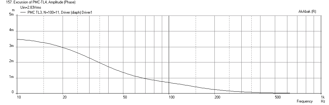

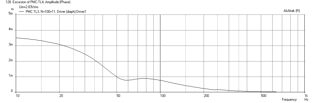

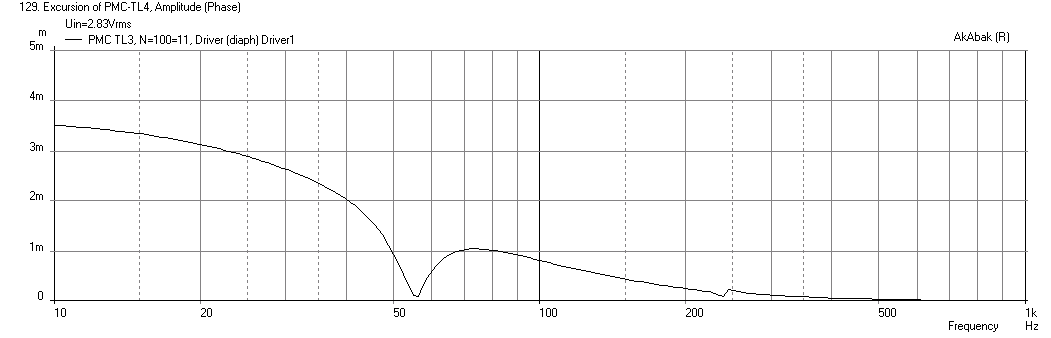

Here is the predicted cone excursion for the unstuffed case:
With Stuffing, the motion null at fb goes away:
As we can see, the addition of some dense stuffing just to the last segment can really remove the sharp 24dB/oct fall-off and give it a more gradual slope, at the expense of SPL at the low corner. The impedance peaks are flattened somewhat, and the cone excursion is smoothed out so it doesn't go through a motion null at the tuning frequency (possibly keeping the cone moving to cool the voice coil for low notes). The TL tuning frequency fb was about 55Hz and remains the same with or without stuffing.
Stuffing in Akabak is set in "waveguide" elements by specifying the equivalent resistive pressure loss due to flow in Pa sec/m^3.

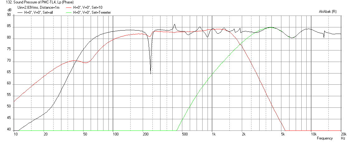

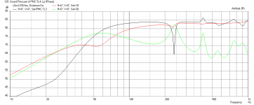

And here is what the predicted response looks like with the tweeter and a 4th order BW LPF and 2nd order Bessel HPF XO at about 2kHz.
With Stuffing:

Why is the simulated stuffing only affecting the amplitude of the first and second resonances but not the higher ones. I would expect stuffing to be more effective at higher frequencies.I modeled this in Akabak with 180 deg hairpin turns represented with the usual four 90 deg turn segments (expansion/contraction/expansion/contraction). There is stuffing in the closed end down to where the first turn is. However, I am doing two cases where I can add stuffing or not for the last straight segment (10in long) up to the vent. Adding resistive flow here has a large impact on frequency response, electrical impedance, and cone excursion as we will see.
The equal magnitude of the output from the port and driver looks like a problem at the second resonance. Presumably more stuffing is needed to pull it down further?
Why have you chosen not to lightly stuff most of the line?
Yes, more stuffing can be added easily - it's just a starting point. Typically, the damping will be enough that the second peak doesn't show up. I can add more segments with light or moderate stuffing to see...

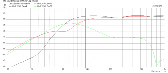

Effect of stuffing entire TL

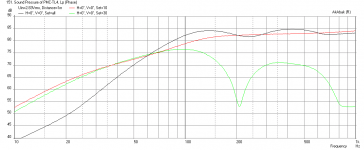

If I apply moderate stuffing along the whole line and light stuffing on the last segment, we get much less 2nd resonance peak:
If I exchange light stuffing for dense stuffing on the last segment (essentially plugging it up to reduce bass output from port and tending towards and aperiodic vent) - much like what PMC did, the response now looks a lot more like the measured response for TB1, with falloff starting around 90Hz. This smooths things out even more:
Here is corresponding impedance (single peak - aperiodic TL):
And corresponding cone displacement:

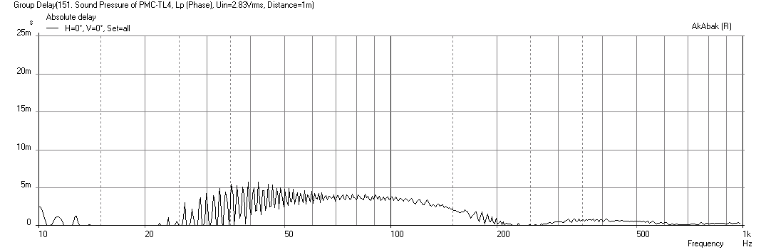

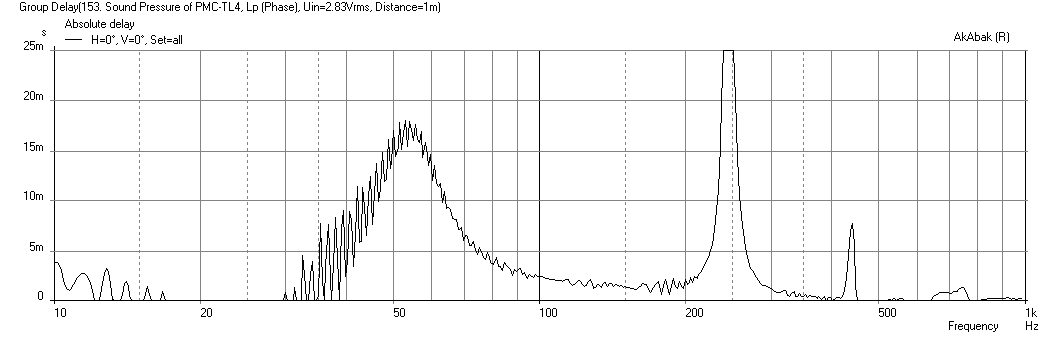

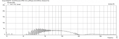

But the most remarkable improvement (at the expense of bass extension) is the reduced group delay, which is now around 4ms at fb (60Hz):
Compare this with the group delay for a TL that is only stuffed in the section from closed end up to just the first turn (as is usually done to effect max bass extension and bass SPL) - about 17ms:
So for a studio monitor where accurate timing of bass kick drum is desired, the tightly stuffed last segment seems ideal, although there is a lot less 50Hz kick drum to hear (70dB vs 74dB for lightly stuffed terminus, vs 81dB for no stuffing except for first segment).
