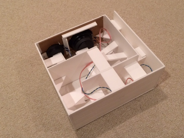

Prototype PMC style TL with DC130A
48in long TL with 5:4:3:1.5 ratio and DC130A-8 driver and DC28F-8 tweeter.
Some progress in foam core... still need to do capping operation of gluing final side on.

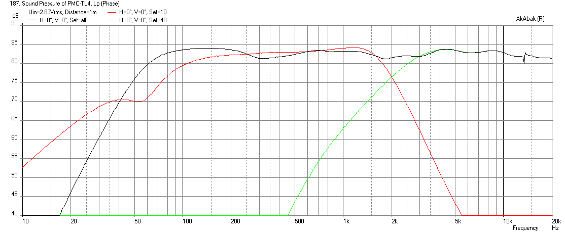

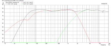

Model of above TL

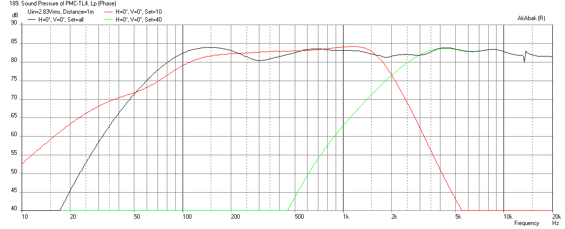

Here is the model of the above front firing vent TL for a loosely and moderately stuffed case. This is a Harsch XO at about 2kHz (BW4 on woofer and BES2 on tweeter).
Moderate stuffing freq response:

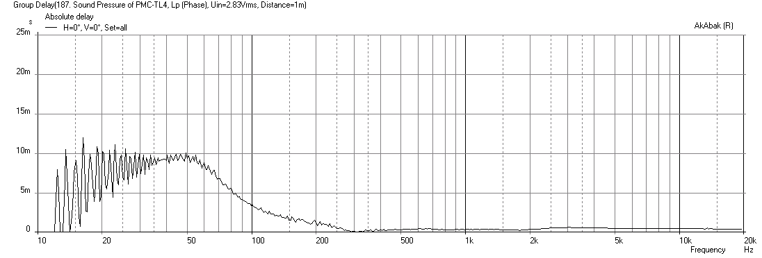

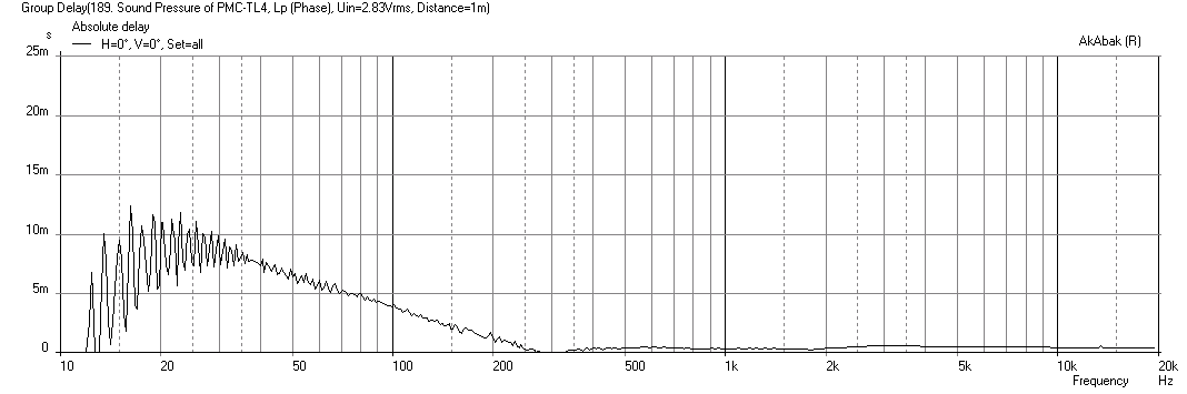

Group delay for modearate stuffing (about 9ms at 50Hz):
Dense stuffing in tail section:
Group delay for densely stuffed tail:
I am debating which way to go, although once can change amount of stuffing in tail ven easiy enough.

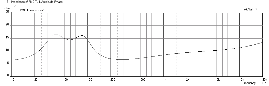

Impedance for moderate stuffing (not quite aperiodic yet):

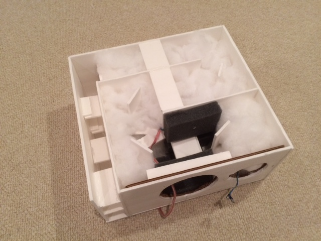

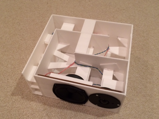

More progress...
Added the twin terminal cups for an active 2-way, added moderate stuffing in the TL except last leg where model shows with/without switches to aperiodic TL. Also some open cell foam behind driver to reduce reflections back out of cone.
Stuffing and foam installed:
Capping operations - heavy boxes and waiting for Liquid Nails (low VOC) to dry:

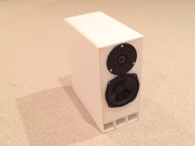

TL monitor build completed
Completed TL monitor:

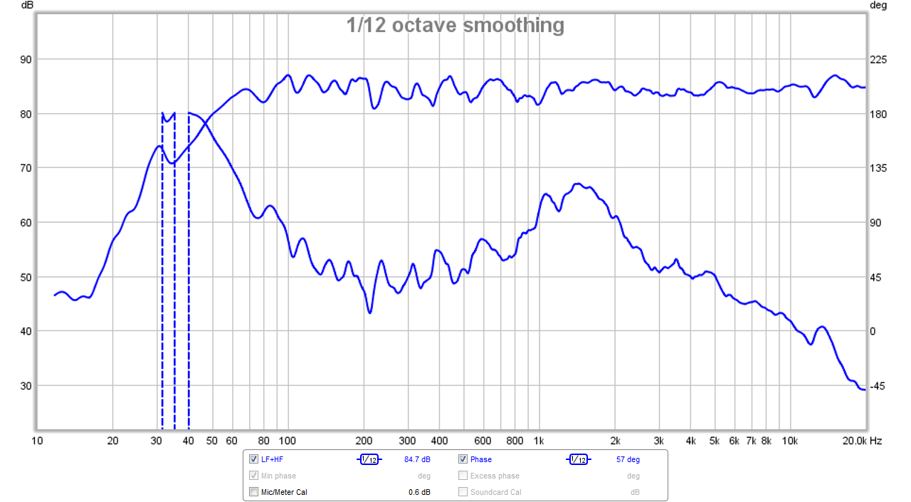

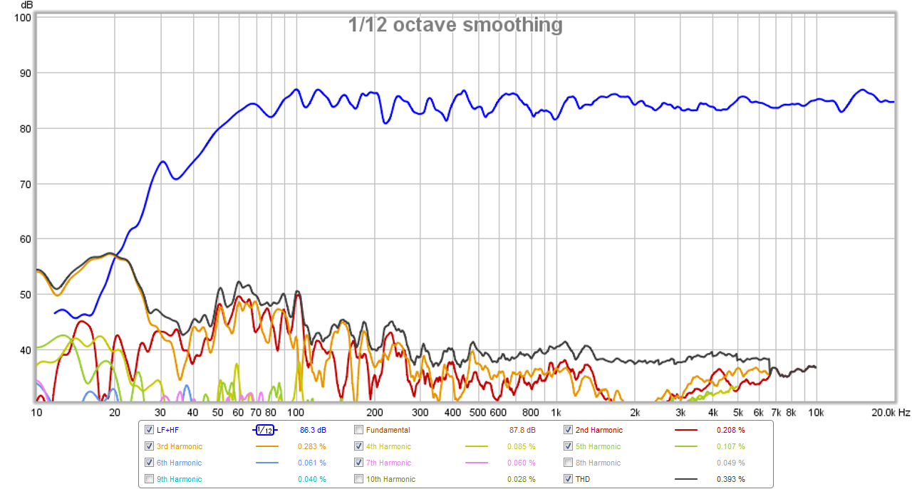

Measured raw response of woofer in moderately stuffed TL running full range:
Active 2-way with miniDSP and rough-cut Harsch-like XO at 1350Hz (electrical 1st order HPF at 2kHz for tweeter, electrical 4th order BW LPF at 1000Hz for woofer) - XO plot:
Measured system HD:
Measured Phase (note characteristic rise of phase at XO point for Harsch-like XO's) :
Measured Impulse Response:

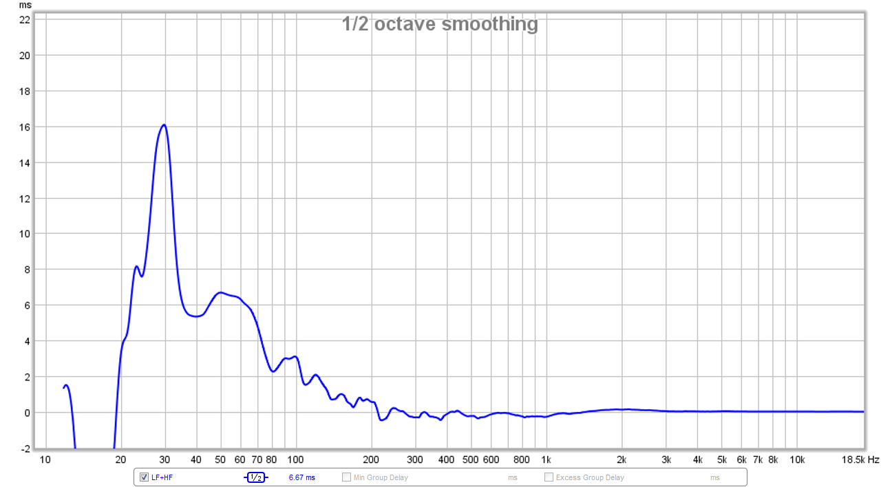

Measured Group Delay (with 1/2oct smoothing for clarity) about 6.4ms at 50Hz:

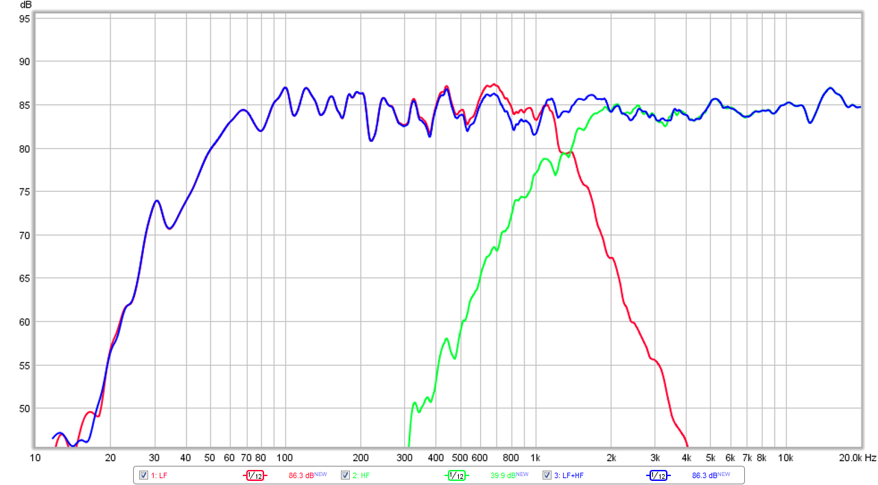

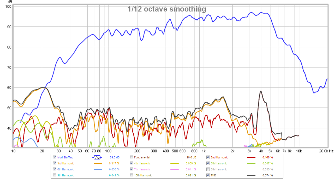

Measured system HD:

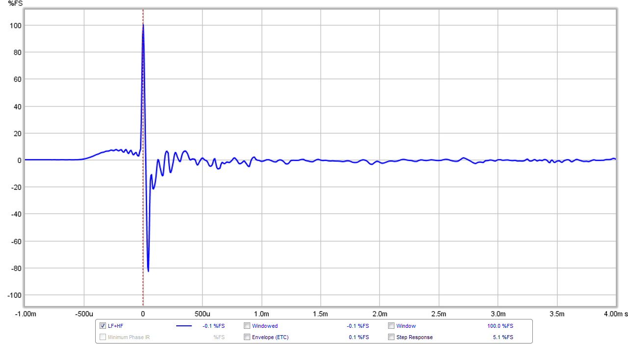

That is exactly my experience - only one impedance peak result in a overdamped design. Well attenuated first impedance peak is an optimal design. Two impedance peaks design (like all PMC designs) is not much different than a vented box.the measurements pretty much confirm the model's low group delay and impedance response. You need to look for a squashed double hump. If single hump too much and you should just use a sealed box. Two sharp peaks and you have large GD like a bass reflex. Tuning the damping to the right amount is critical
But it is. Martin King clearly showed the difference with his published ANSYS sim.
dave
Which is first peak? Lower or higher frequency peak? Mine has the lower peak more attenuated than the higher frequency peak.

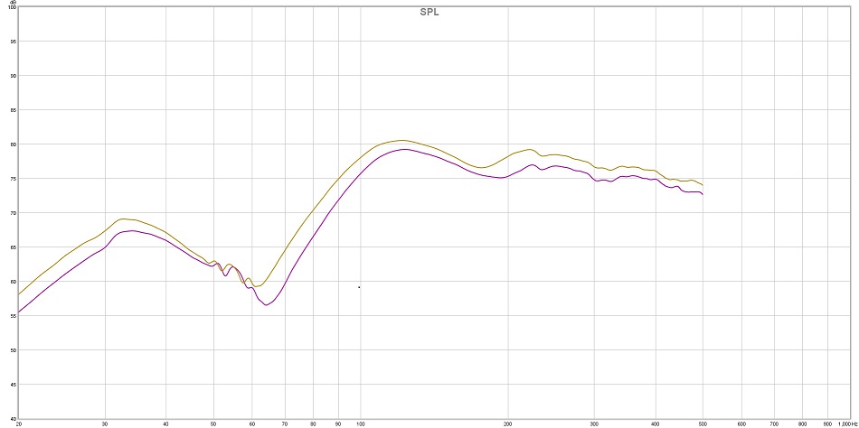

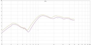

Hey all,
It's been a while since I've been on here! I need some help from someone better versed in the TL design than me.

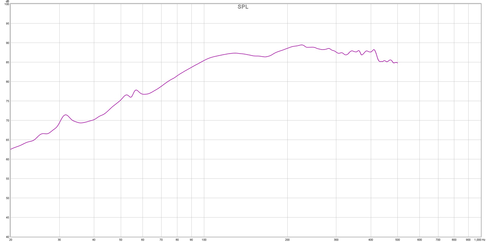

I bought a pair of PMC TB1s super cheap on eBay to add to my studio. I've been struggling with a big 50hz null, which I thought was the room, but after measuring closer to the speaker it looks like it might be the stuffing in the TL They had some black foam covering the rear ports, which was starting to crumble, and completely fell out when I pushed it.
I've experimented with an RTA mic 6cm from the center of the woofer. I took 3 measurements, one without the foam, one with the original foam (which did very little in it's current form) and one with a rolled up tea towel stuffed in the port, quite loosely but enough that it's fairly sealed.
They sound much better stuffed, although I feel like they've lost some "life". Could anyone advise me on a better way of going about this? What materials should I look at? Is this port supposed to be fairly open, in which case is this a driver issue? I noticed that my LEAK 3090 TLs only have a bit of speaker grill across the ports, although they are front firing.
Many thanks,
Blindmelon6

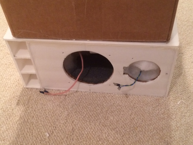

So hello guys !!!
I had hard times treating my home studio room and trying to make my PMC TB2s (the model with the soft dome black tweeter) to work.
Basically it's the same issue is this poster's. My pseudo-anechoic close graph looks similar, and the foam in the speaker itself is loose and it's crumbling when I touch it.
I found this thread, so I tried to stuff a pair of socks in the port, just to see what's going to happen with the graph, but seems that I didn't put enough in it, because well, nothing happened, the graph stayed the same.
Pink line is without socks, and yellow is with, basically no changes.
Could it be the speaker response got altered so much because the foam in it decayed ? Should I stuff some more material in the port to get more smooth roll off ?
With this 50-80hz dip is impossible to work at all.

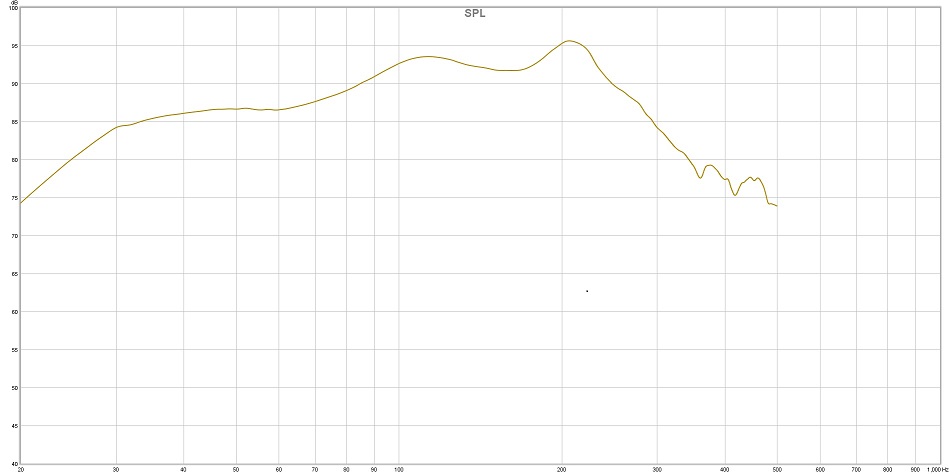

So, I wasn't lazy, and I measured what's coming out of the rear transmission line port. And this is the result.
I don't know the physics behind it, I'm not a speaker constructor, I'm just trying to get the best of it if possible, but if those two graphs augment each other, than it's no wonder why I perceive them as a "ringing honk festival".
So, yeah, stuffing the port with basic foam for speakers made them smooth.
Now how the hell was PMC advertising this as +/- 3db flat to 40hz... They are +/- 3db until 100hz or so... My Adams A7x, that are also 6.5 inch drivers, are going flat till 60hz and then starting to roll off... These things (TB2s) are rolling off from 120hz or so...
