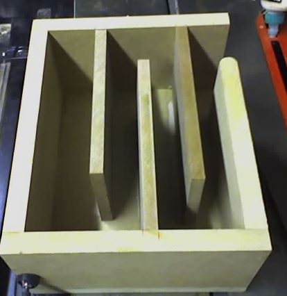

Does anyone have dimensions of this TL, and the XO frequency and slopes? I would like to model it in Akabak. I believe it uses the P17Wj 6.5in woofer and the D25AG-35 tweeter. Are these the correct drivers?
This one has a silk dome tweeter:
There seems to be an older version with an aluminum dome tweeter:
It seems to be the PMC posterboy for the ATL as shown in many cutaway images such as this one (I could extract dimensions from this image, but easier if someone has actually measured one or has provided specs):

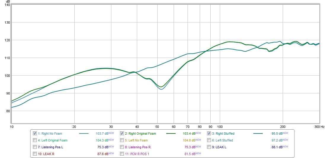

Well, the metal tweeter looks like the Vifa D25AG to me. It's a 5" or 6" Vifa bass, maybe the splendid old P17WJ 6", maybe polycone, maybe paper. Apparently second order slopes with the characteristic omega impedance profile.
But as far as the stuffing goes, which is what this thread is about, the guy who cloned either the TB1 or the DB1 ended up with the below. Says it all really.
https://www.gearslutz.com/board/geekslutz-forum/114230-my-pmc-inspired-monitor-build.html
It looks like about 15 or 20L. Since it's close to closed box, the length of the heavily damped port TL probably isn't too critical.

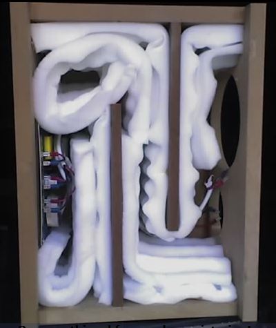

That diy attempt appears to have way too much stuffing compared to the original shown in the cutaway photo. I don't think there will be much bass coming out of a TL packed with that much open cell mattress foam. The driver does look like the popular P17WJ polycone.

Measurements of a clone built to the TB2 dims don't seem very impressive bass wise. I could have gotten 90Hz f3 with a sealed box and any number of 5.25 or 6.5in mid bass drivers.
The link was confusing about the TB1 and the DB1.
But he said he had too much stuffing along the line initially.
But the main event is the termination. Well stuffed. Which makes sense. Near closed box.
So really the purpose of the DB1 ATL is to provide a good aperiodic absorption of the back wave rather than augmenting bass with any real terminus output? Heck, a Dagger or coiled up Dagger, the Nautaloss (derived from the B&W Nautilus) could have done that in a much smaller compact form factor.

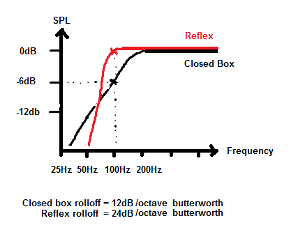

I don't know why people get their knickers in a twist so much about bass performance.
If you want big bass from small boxes you sacrifice efficiency. Acoustic Suspension is the most extreme example. Which uses low Qts aka reflex type, high mass drivers in overstuffed closed box.
This untapered TL from PMC clearly runs into a Chebyshev type bass ripple if underdamped. Which is what Blind Melon7 is talking about.
For every reflex, transmission line or closed box, there are clearly in-between solutions. Choose your poison. The same goes for small baffles and infinite ones. But really there is no replacement for displacement IMO.

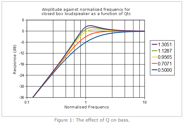

Presumably this speaker has an internal volume somewhere inbetween the closed box optimum and the reflex optimum, being a bit inbetween itself! 😀
The closed box formulas are here, and the optimal closed box is less than the Vas for Qts less than 0.5:
http://www.diyaudio.com/forums/diyaudio-com-articles/158899-arpeggio-loudspeaker.html
With a Qts of 0.38, the optimal reflex volume is simply the Vas.
Presumably there will be an optimal damping and room placement that hits the spot for you. And the room and nearby walls affects bass greatly.

You hit it right on when you said "With the original foam they sounded a little bass light, but with a lovely smooth roll-off and loads of clarity."
The objective of a Bailey TL or aperiodic is to get the non-ringing bass of an infinite baffle that is characterized by the slow 12 dB/octave bass slope and the single impedance peak. TL gets the efficiency back using a large cabinet to create a half wave phase inverter. Aperiodic keeps the box small, but sacrifice some of the efficiency. PMC seems to execute these basic principles quite well in their designs. It is good to stick with the original foam stuffing and terminus puck.

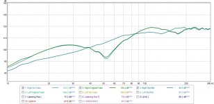

From your measurement, the PMC TB1 seems like an excellent design. Like for Steve (System7), a 24 dB/octove fast rolling off bass of a bass reflex box just does not do it for me.
My TDL T-Line 3s have a very flat impedance curve.
Impedance is much easier to measure than low frequency acoustic measurements
At first try, one speaker curve looked odd, revealing an air leak
I was doing some modelling of a second order high pass this morning, which whether electrical or mechanical is like a 12dB/octave 2nd order butterworth closed box.
What happens if I add a resonant pipe aka reflex or LCR notch to it and play around with the red damping resistor?
Blow me down, it looks just like the PMC's behaviour! Filters are filters, whether electrical or mechanical. 😀
