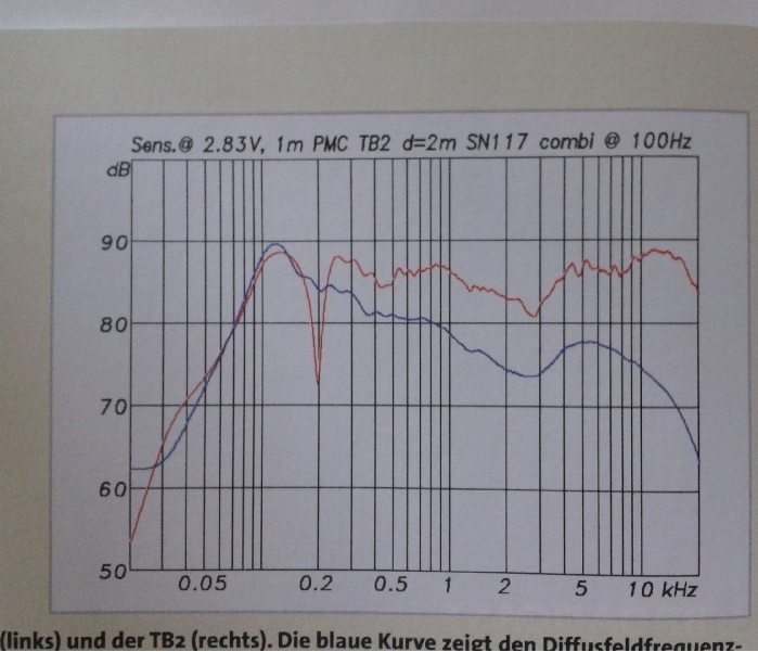

As you've posted my measurements of my clone, I'd like to add measurements of an genuine TB2S (made by german magazine "production partner")
The driver PMC was using is excatly the same as I used - Vifa M17WG09-08 (german type designation: 17WN125).
The bass response of the PMC TB2S looks like an aperiodic cabinet. The response of your clone looks more like a bass reflex box.
Any insight on the reason of the difference?

I don't see the difference - there are some room modes in Burnett's measurement. You can't say if it's aperiodic vs TL vs BR without seeing the impedance sweep. Given how much stuffing is in Burnett's I would say it is most likely closer aperiodic TL.

No, it looks like underdamped TL, vith very high resonant peak in the high-bass rangeThe bass response of the PMC TB2S looks like an aperiodic cabinet.

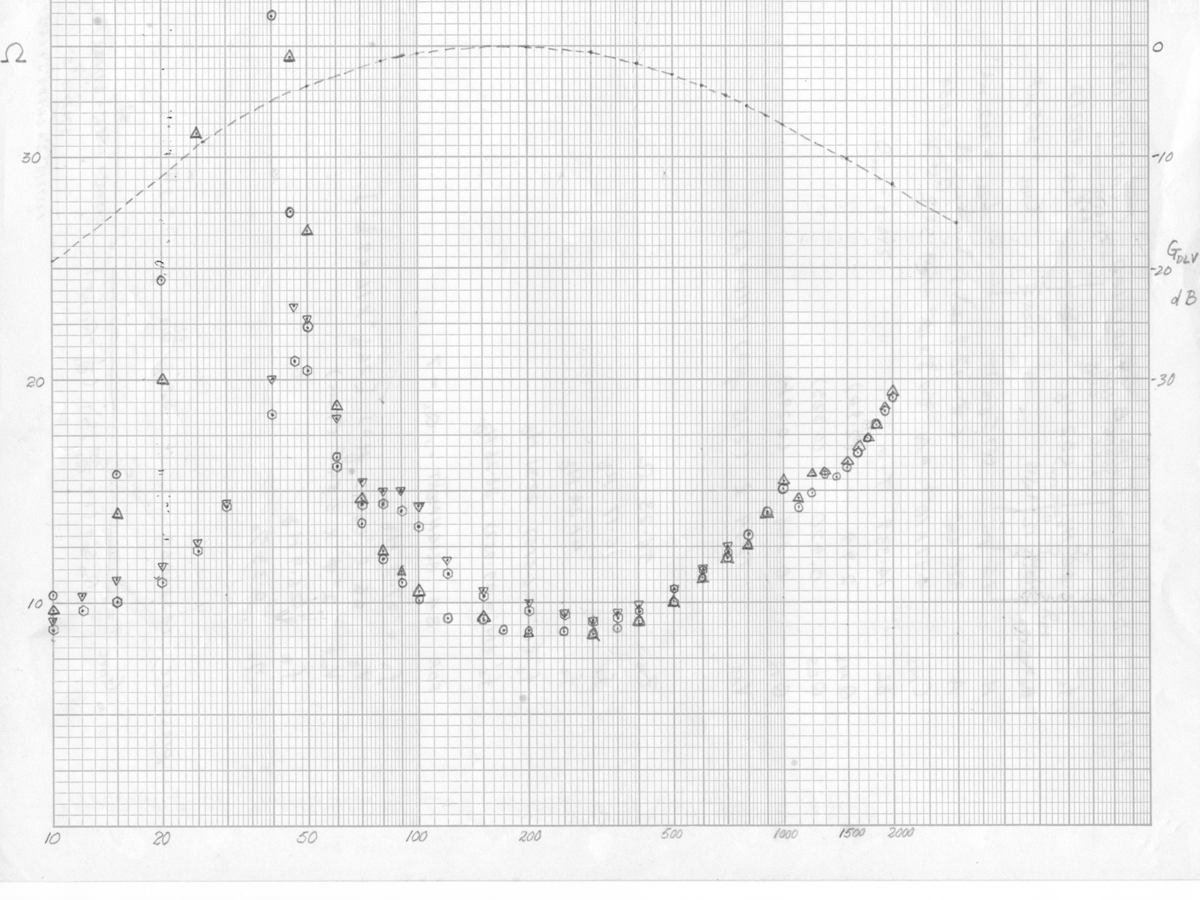

There are many articles on the Bailey TL DIY projects in the "Speaker Builder" magazine in the 1970's. I built a pair myself and the plots below are the measurements I made almost 40 years ago. Building and listening to these speakers convinced me that Bailey was right.
Sorry about the poor quality pictures. The plots were done by hand on graph paper. It was long before the PC time.
