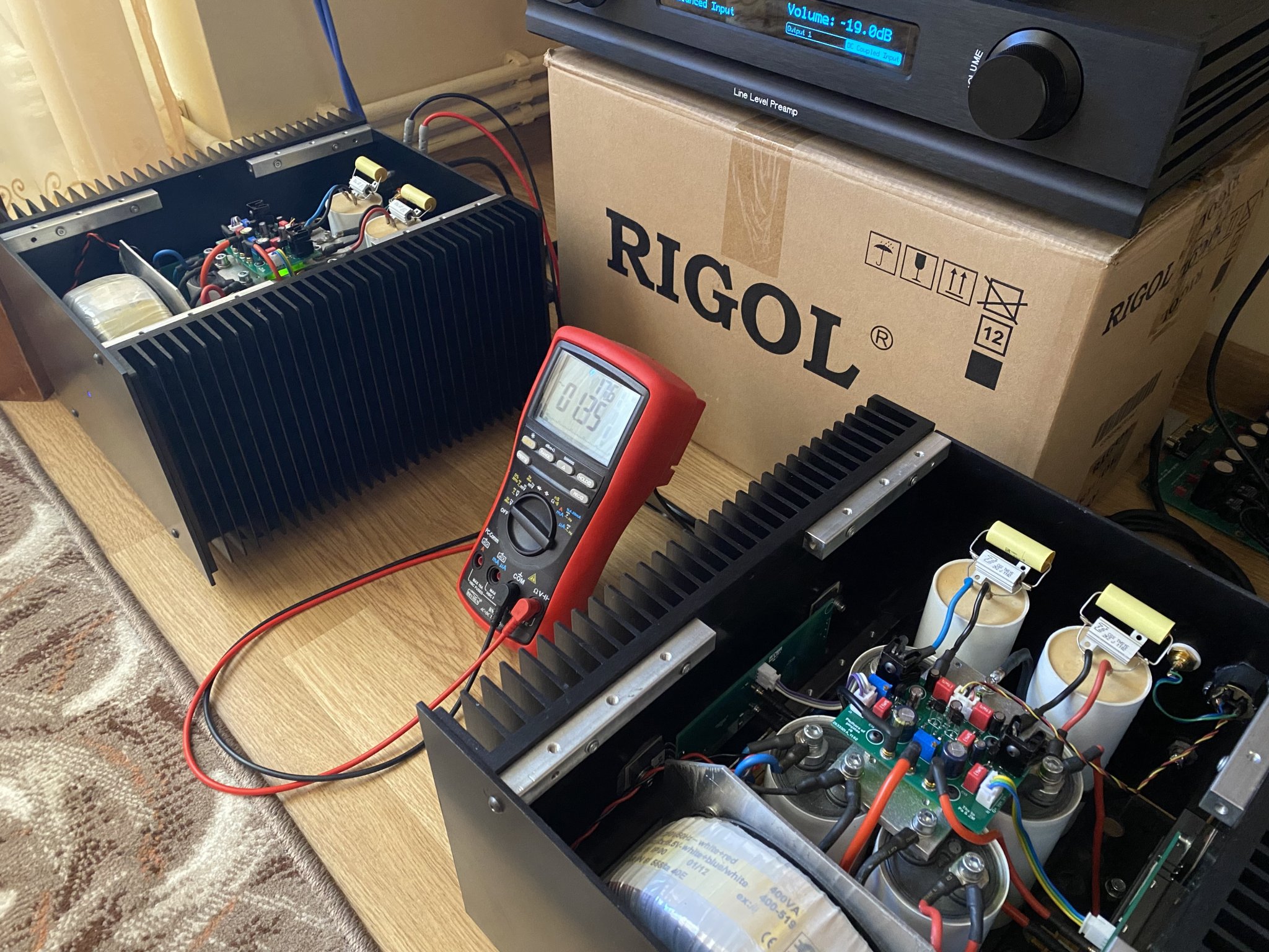

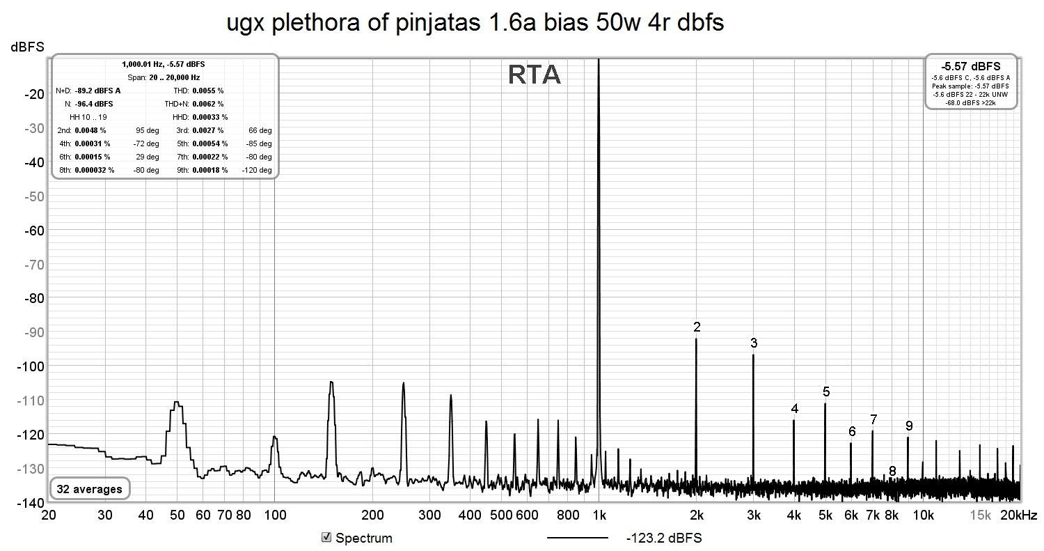

Second channel finished today. Both playing music now.

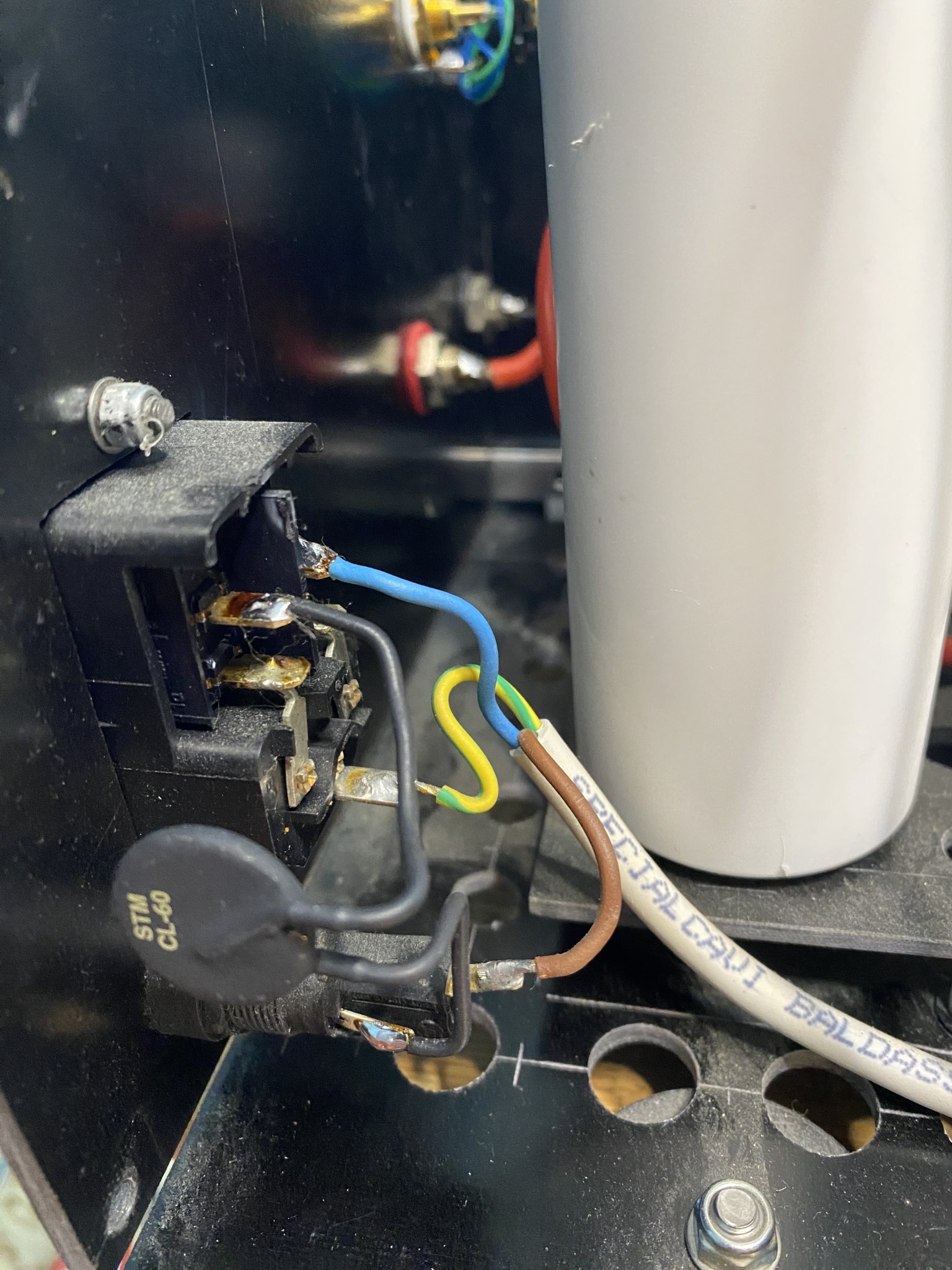

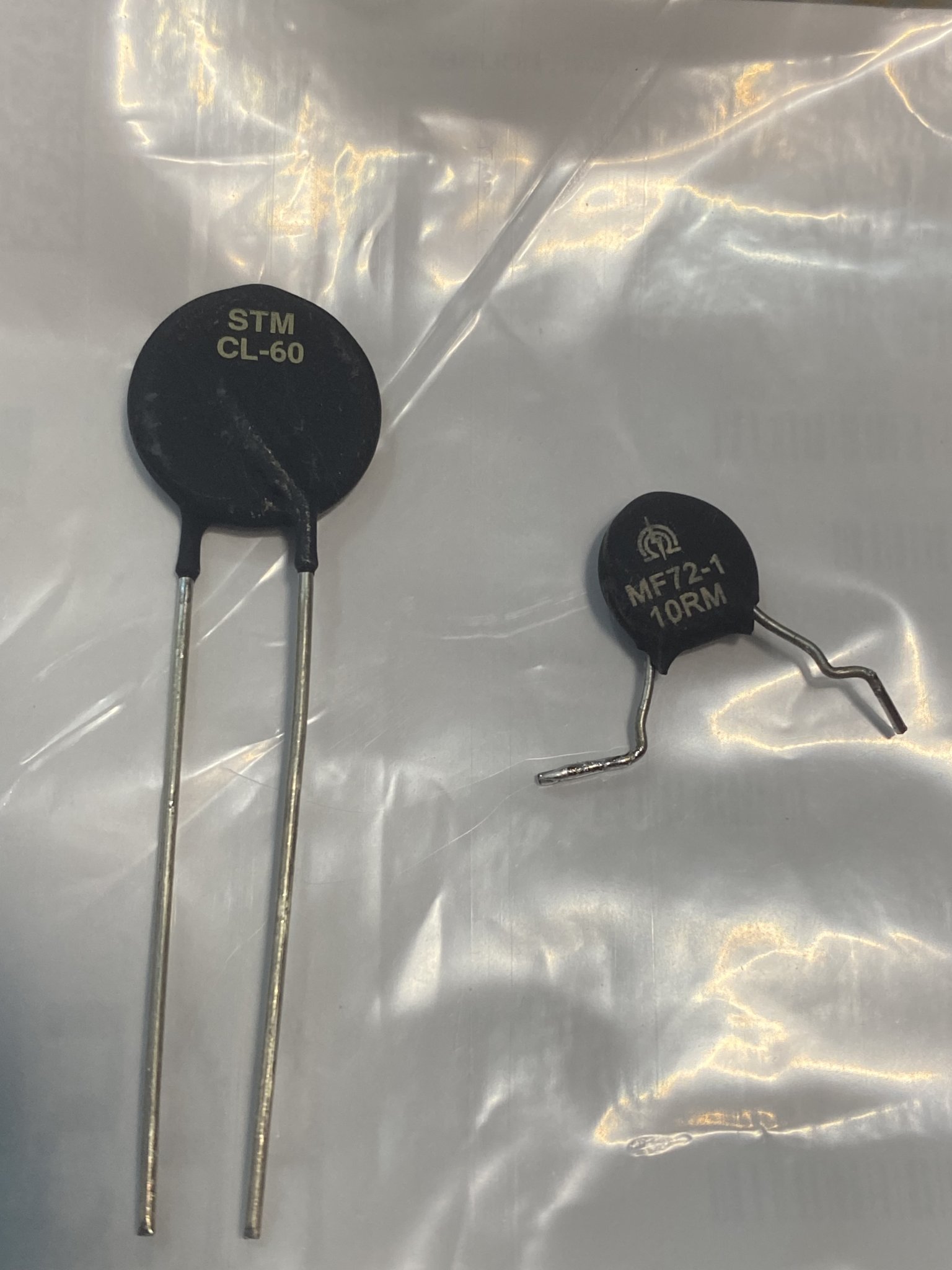

In the upgrade process I lowered the resistors in the crc filter from 0.5r to 0.083r and changed also the ntcs in the primary of the trafos.

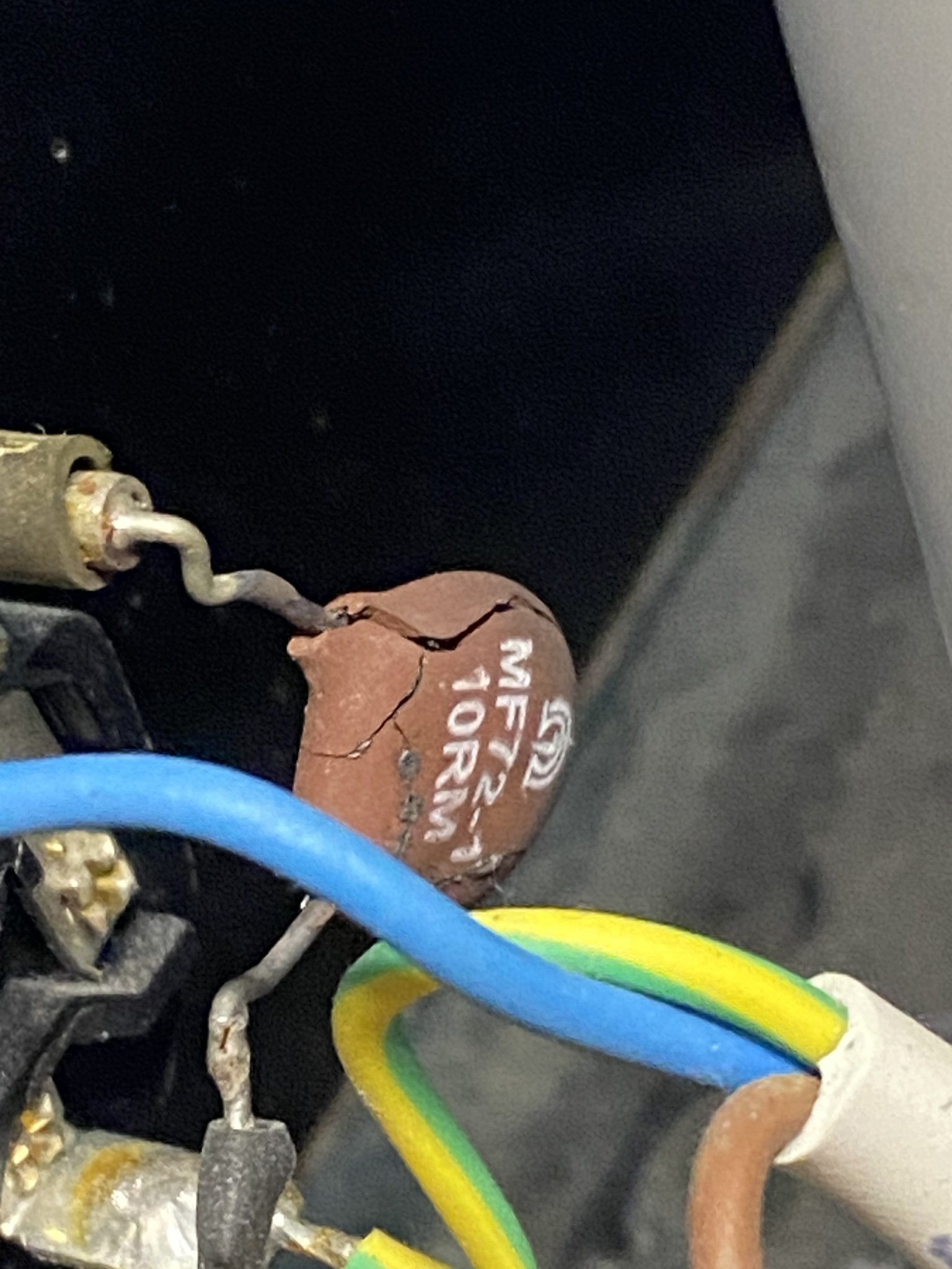

One ntc failed recently. The case broken apart but it still was working.
Now I have 25V under load and the bias is set at 1.6a for the moment but I plan to go higher to 2.2a(the bias for eqch mosfet is half).
A big thanks to Pa and ZM!

For now this one is more than enough and close to the max dissipation my heatsinks can take without extra cooling and also for my 80w rms(120w peak speakers). I can say a perfect match for my speakers (at least for now )don't use force - use bigger hammer

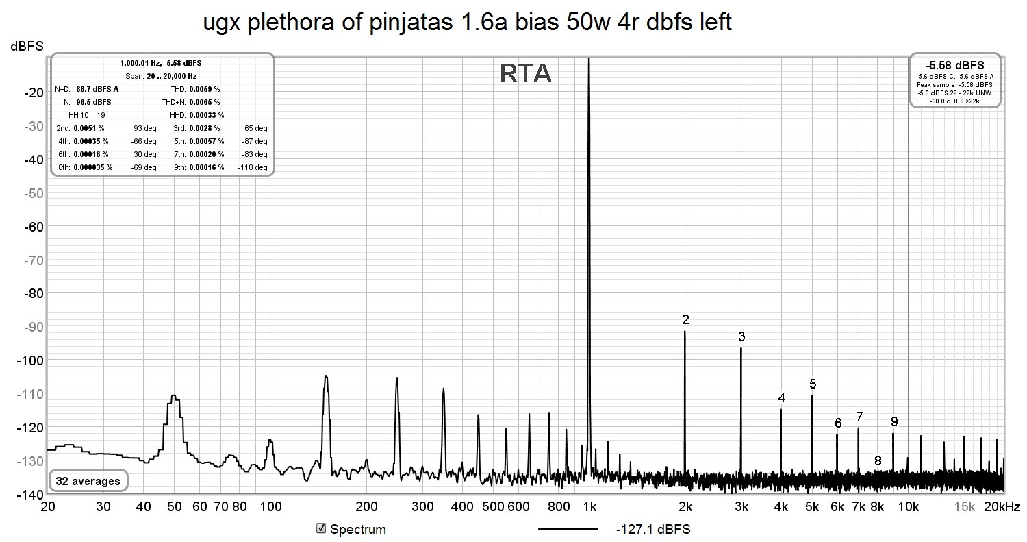

From simulation it does more than 80wrms into 4 ohm and more than 40w into 8ohm without too much thd.
More important is that I like the sound, sounds powerful like the bridged boo but a lot cleaner specially at high power levels.
When the led starts to flash the distortion is still not perceived. I have to go a little further with increasing the input level.
Now I can say that my AJ was successfully replaced and my desire for better efficiency was met, it was a nice journey until the next one..
I still have to mount a upc1237 speaker protection and then happily close the lids.
Ps. To make it shake the cage properly I had to invert the speakers wires.

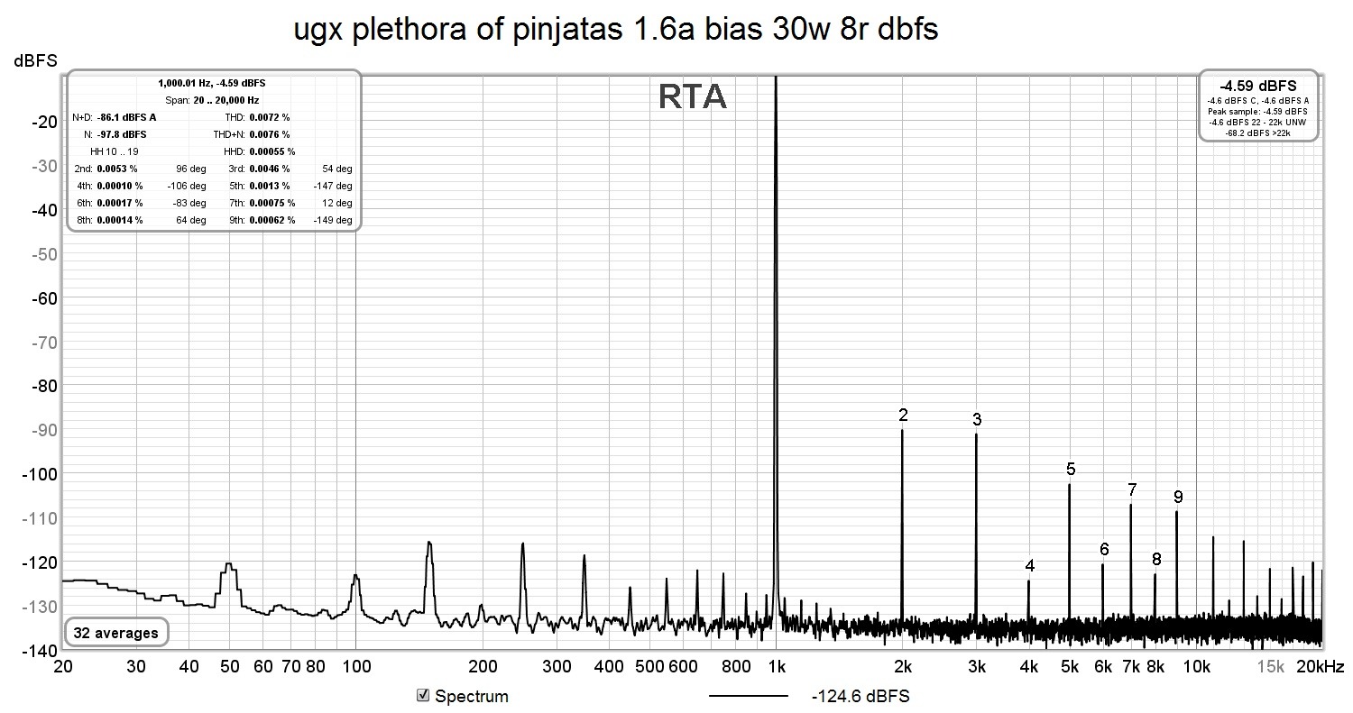

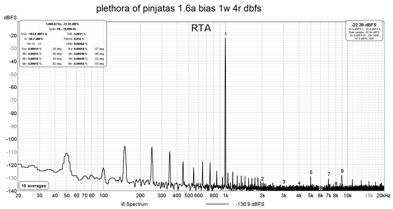

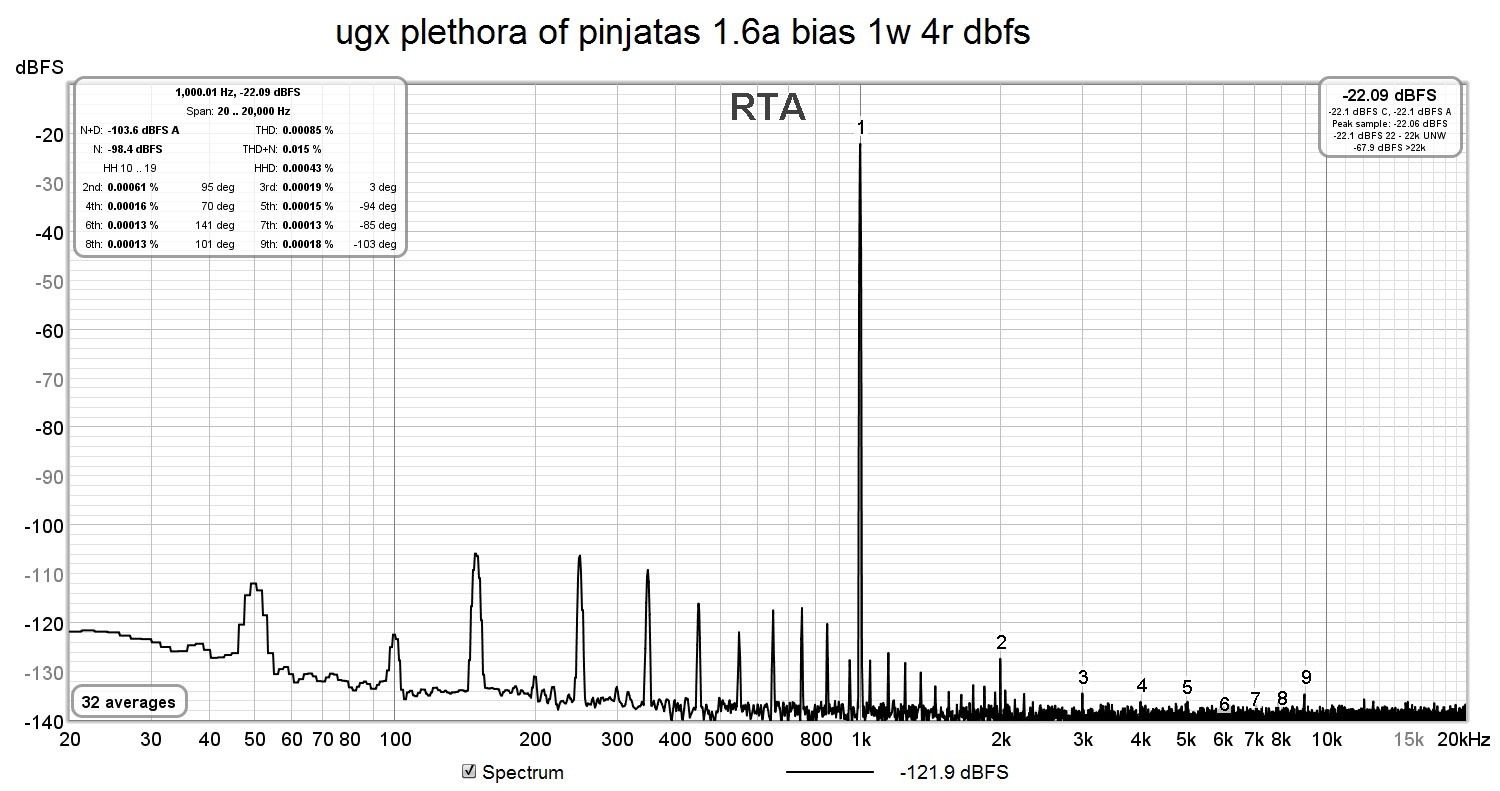

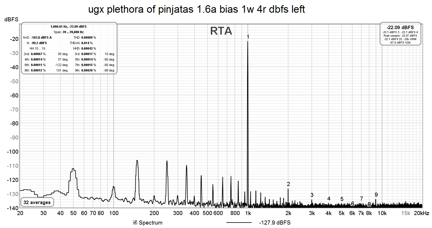

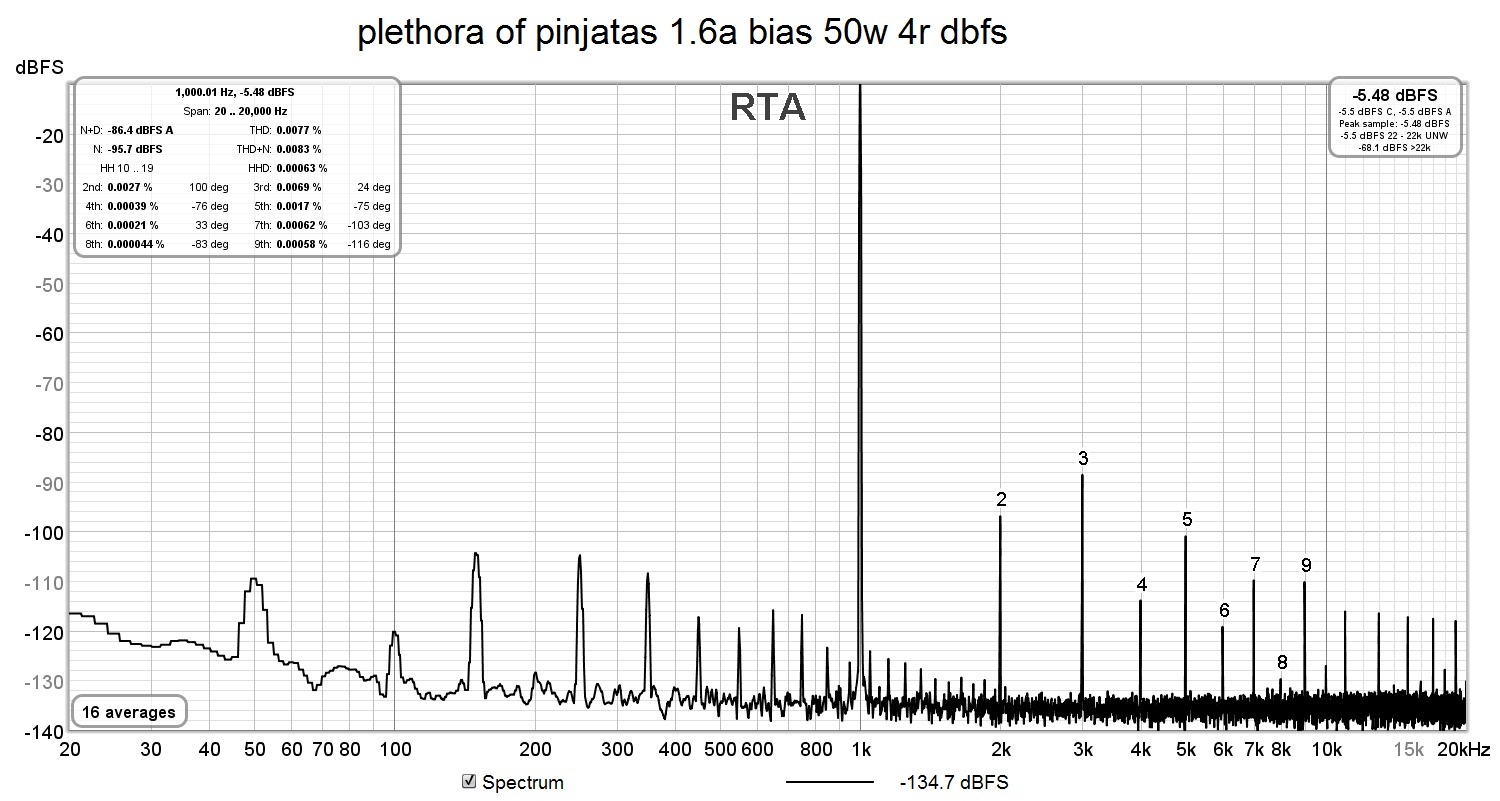

Changing the gain stage in front on the preamp gave a bit better results and an interesting thd profile, this time the same on both channels.

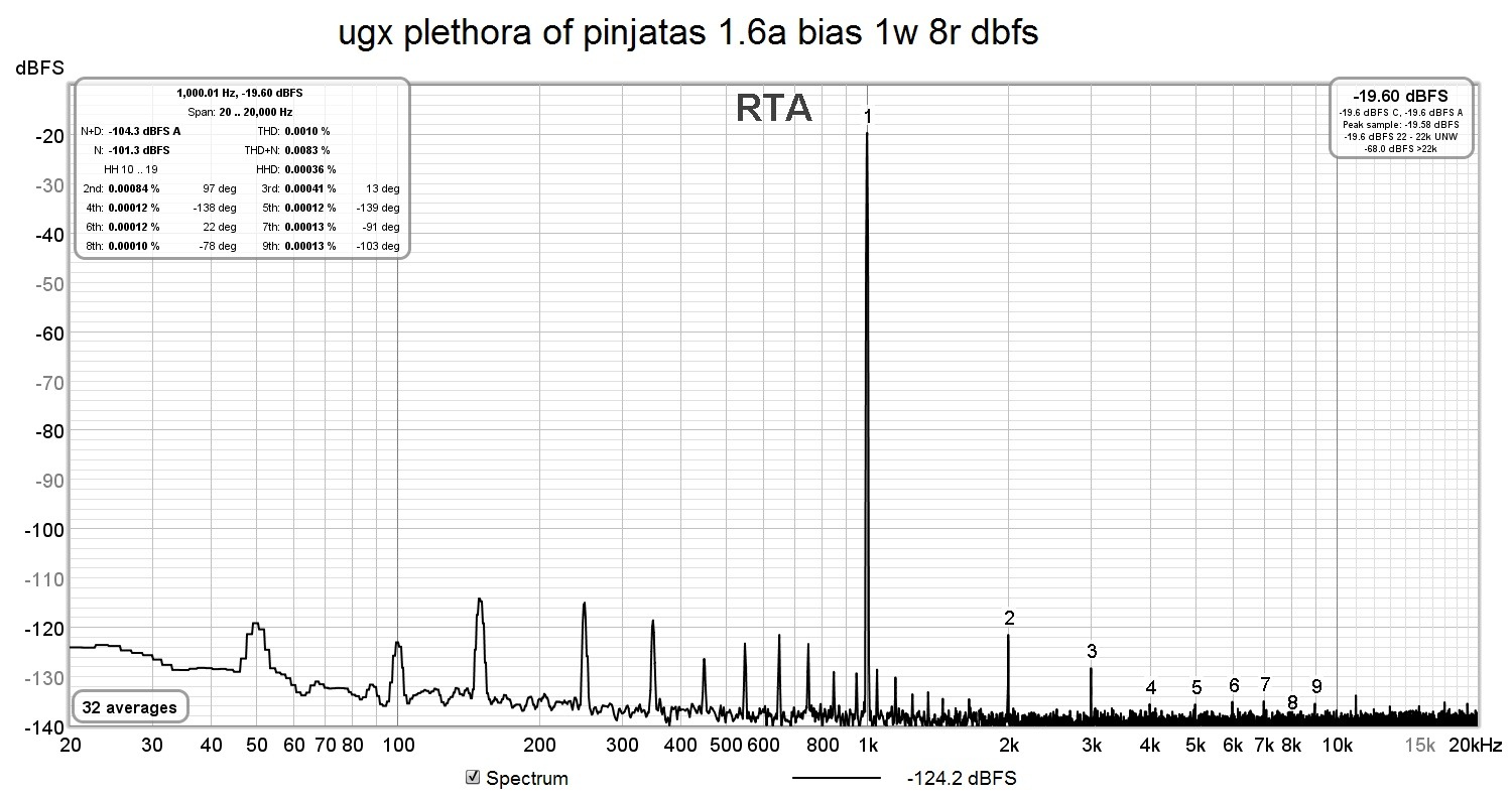

out of curiosity I measured also into 8 ohms.
next step will be to add active rectification and voltage regulators to the rails. this to have something further to learn and experiment, the amps are dead quiet as they are now.
