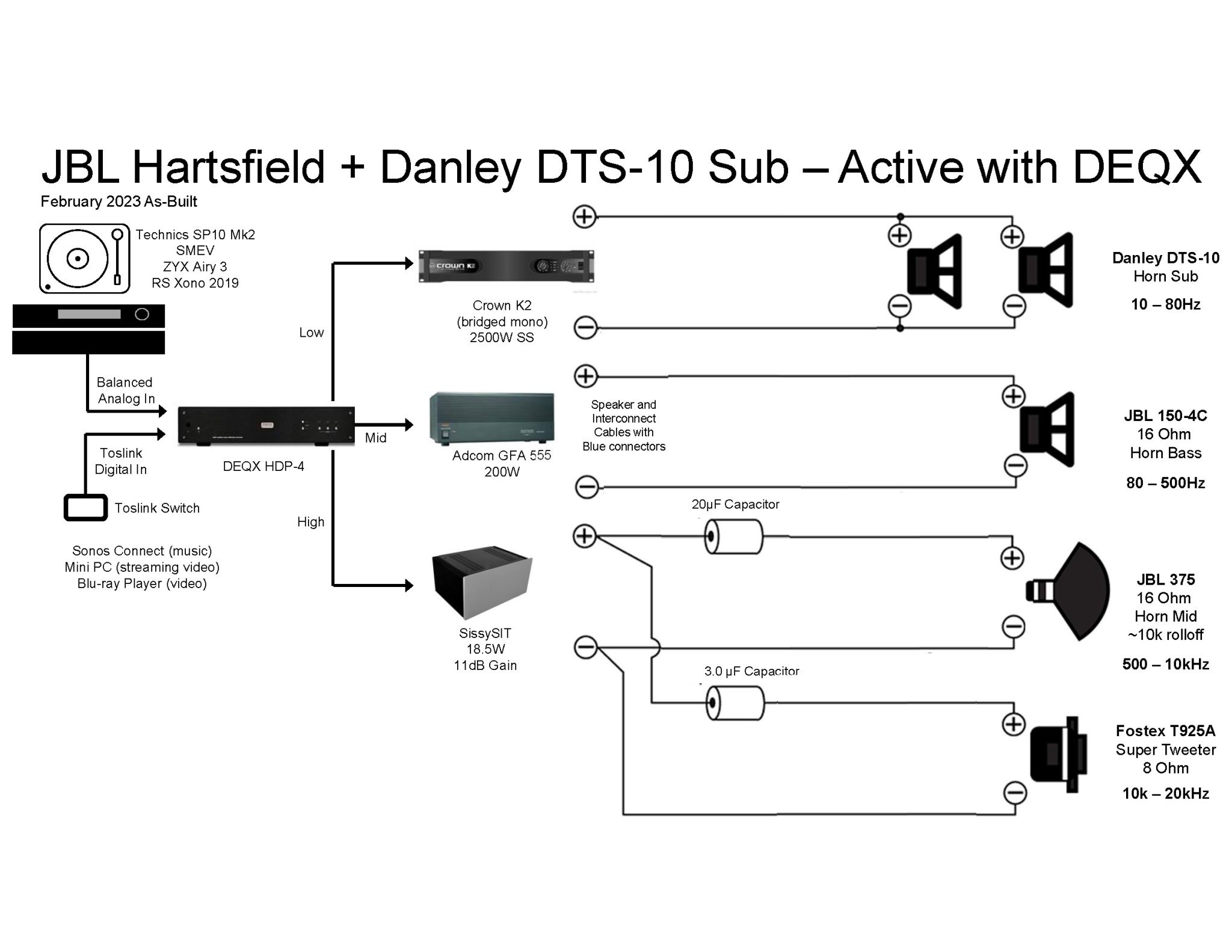

I love how you have a diagram to keep track of how to wire the stereo... ;-)
You need to explain, again, how you are using and programming the crossovers.... the diagram is not clear in the picture..

Tony - here's the diagram before the amp swap. EQ was originally done with a "DEQXpert" in Colorado who hooked into my PC while on a call with me on the phone. We set up a measurement mic and he ran sweeps, set EQ details, timing/delay, etc. Now when I swap amps I simply go set the gain for each amp. I have a spreadsheet where I have all of the gain settings that I use to get them all level. There are 4 pre-sets where I go for "flat" and then a few with a little tweaks in sub, and sub+mid/bass levels.

Eons ago I bought one of them fancy equalizers with spectrum analyzer, mikes, etc... It turns out I didn't much care for a "flat" response. I ended up toning down the treble by more than 3db.
BTW, isn't your set up now sort of Nuklear Overkill when it comes to gain? I'd say you've gone past opening up a can of worms.. you just blew up the piñata!
At full blast, meaning 105db peaks... how many watts are the amps gonna be putting out? 3? 10?

Amps are 20 db range. Nothing crazy. DEQX is low gain. Maybe 6 max? You might say the speakers are pretty efficient / sensitive, though.
There is one preset for “make this harsh treble mix stop my ears from bleeding”
