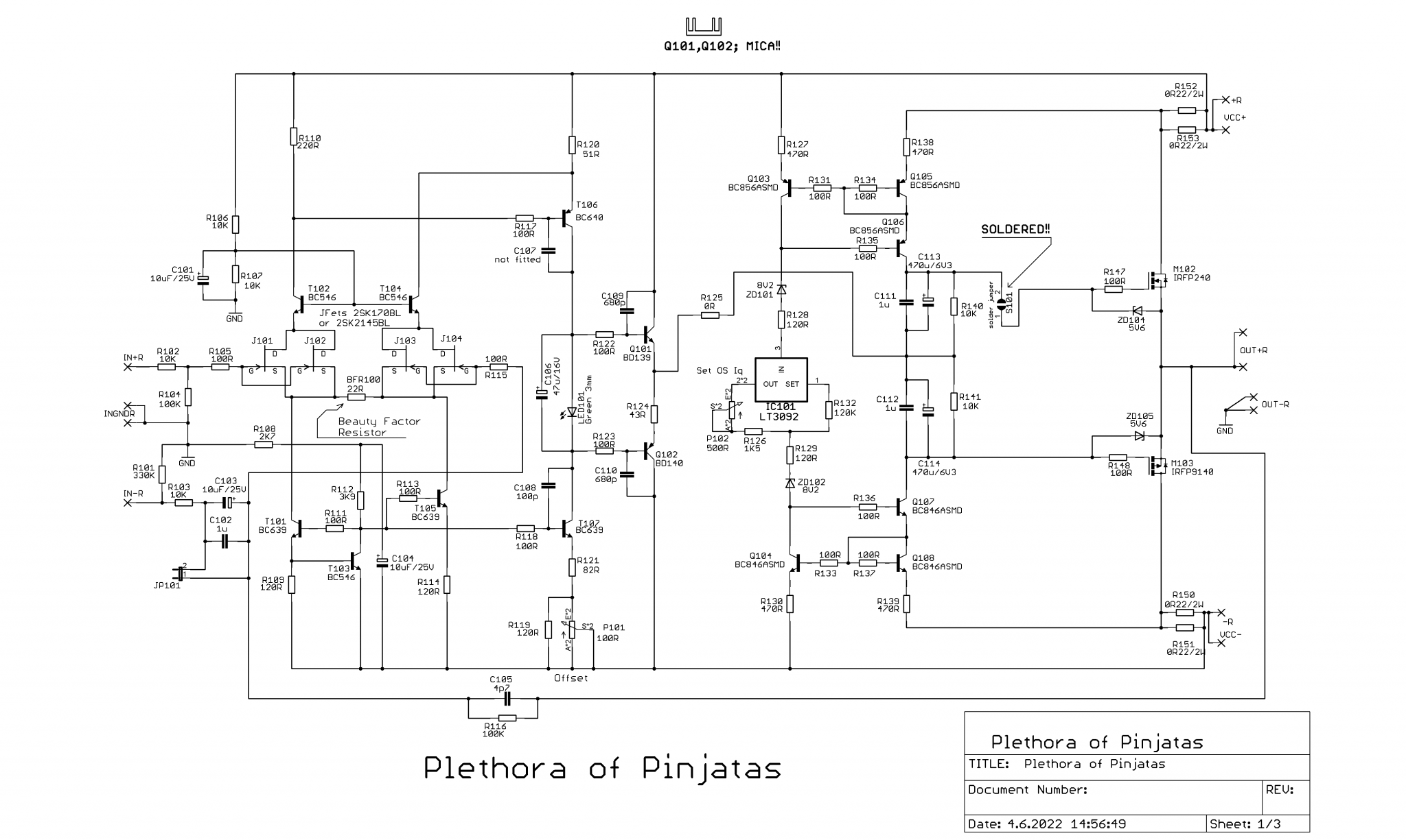

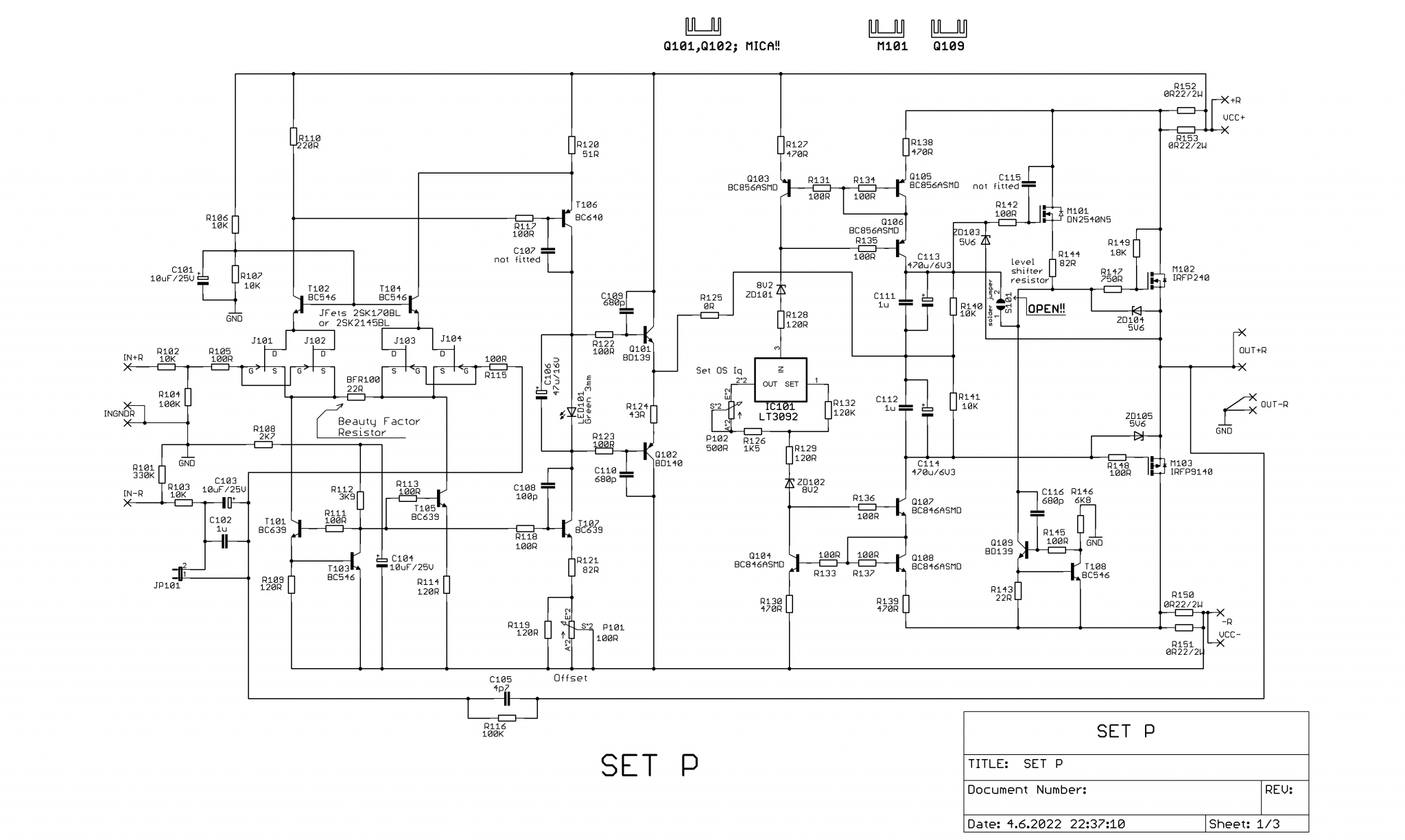

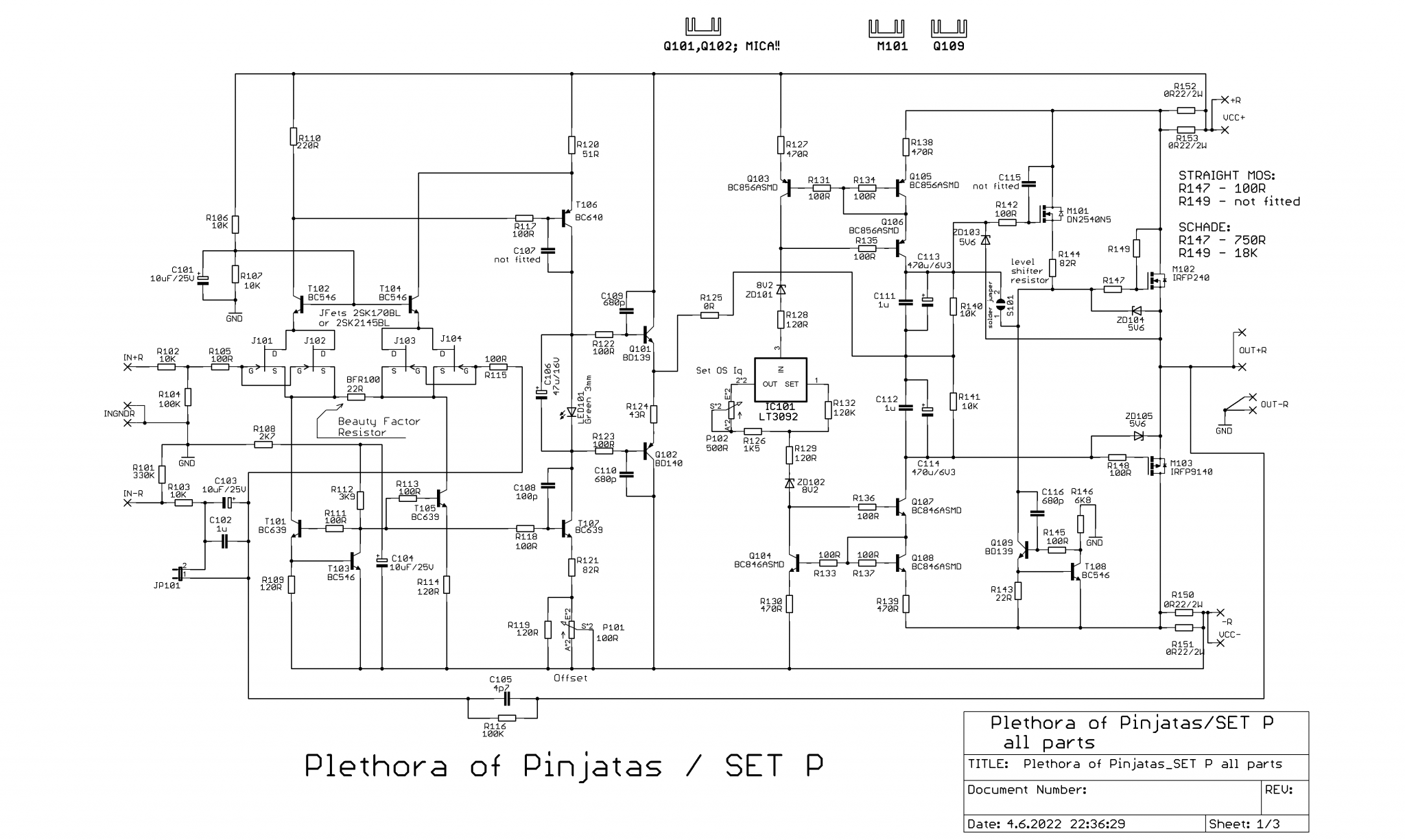

Finally, Plethora of Pinjatas, origin of P series of amps
These (P) being more or less derivatives of my recent M2 derivatives ........and you know them , so no need to go in detail
So, active FE instead of buffer+autoformer FE; biasing mech. being more or less same (current sense in rails), only - with help of current mirrors, being sorta flipped upside down, vs. previous optocoupler based one
even if optocoupler based biasing is more than good, believe me, this one is even better ...... in anything you can remember to ask about
Iq and Offset stability is bespoke, in any domain I can think of - time, temperature, rails change ( mains fluctuation), no even slightest pops during Power On and Power Off
everything to embrace Square Law OS
(aha, this one being origin, even if its bigger brother - Babelfish XA252 been made first)
OK, straight MOS being real Plethora of Pinjatas ....... (is it Mini Babelfish XA252?)
SET P being then same pcb with twist - upper mosfet in Schade arrangement (is it Mini Babelfish XA252 SET ?)
pretty close to point where I can't even follow my self, go figure
'nuff babbling, some usual pics
schm is cumulative; down will post separate ones

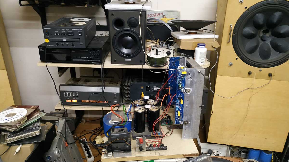

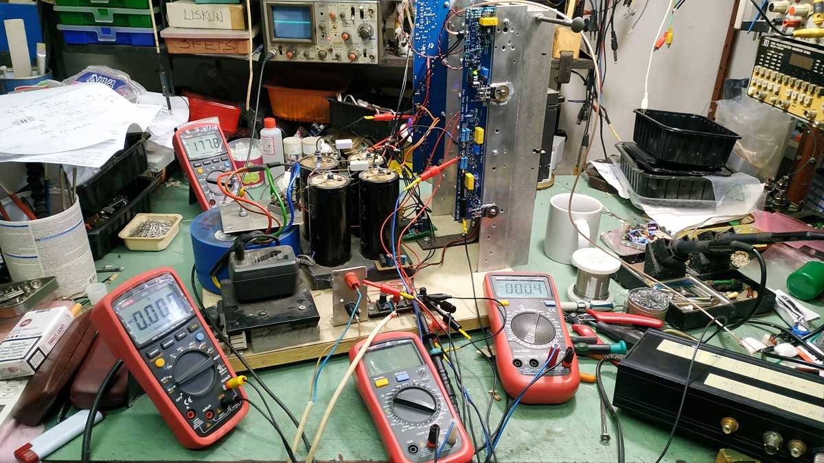

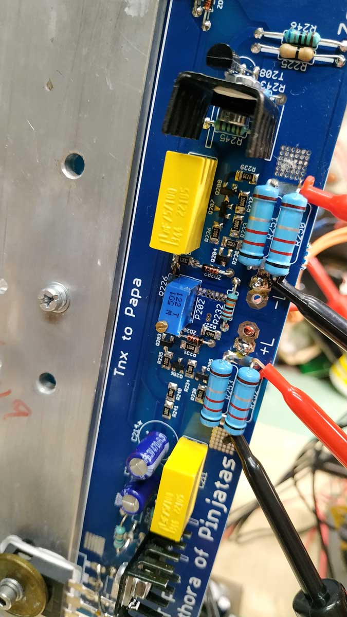

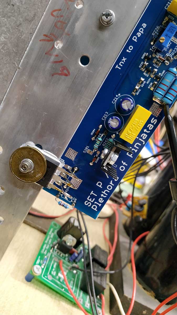

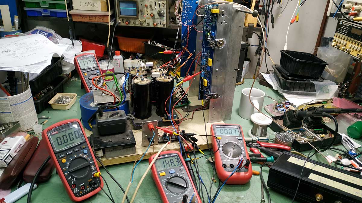

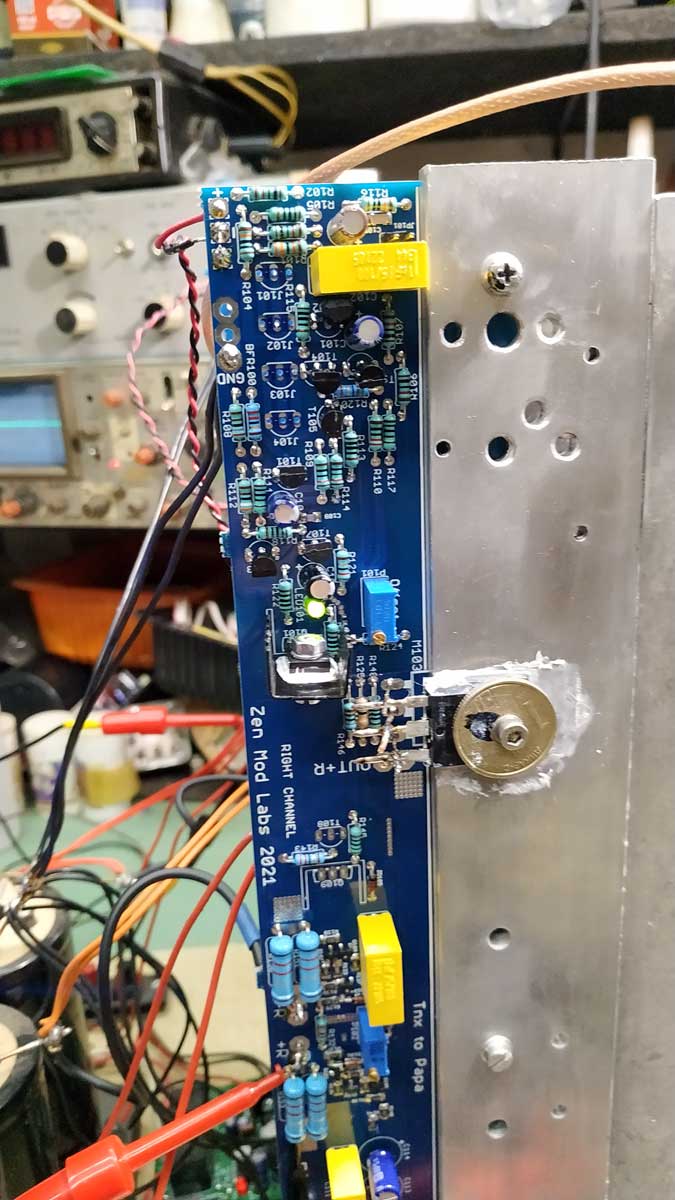

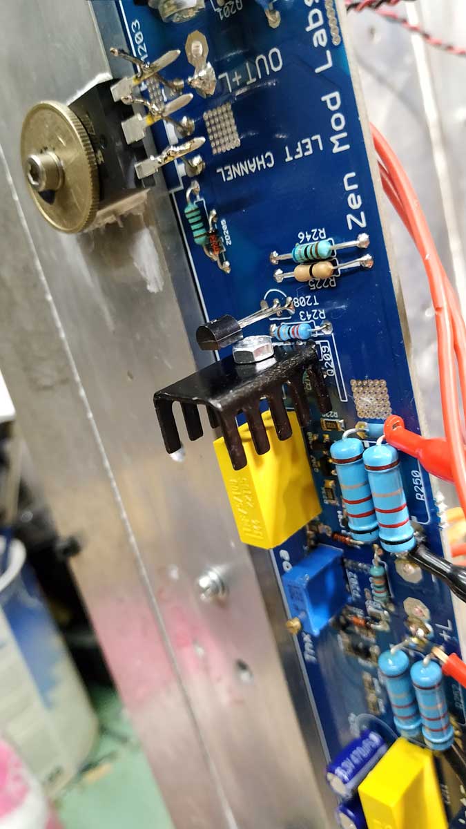

Now what ...... some pic of Pudding.

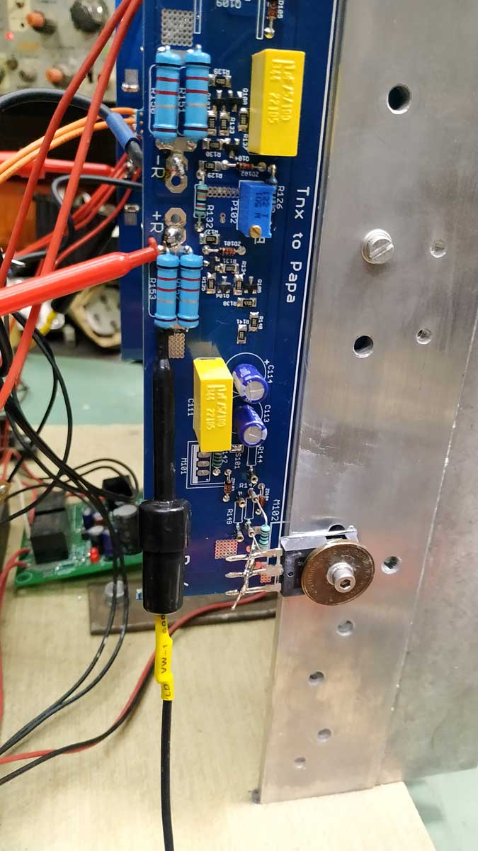

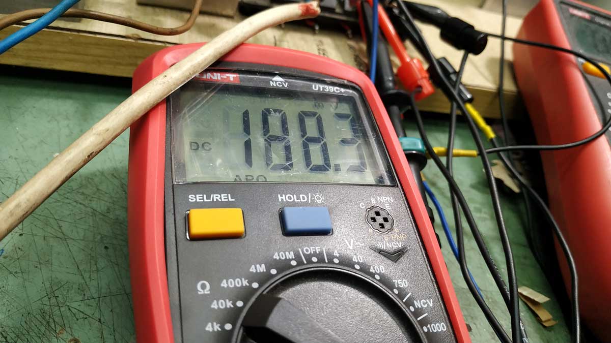

Proof of Da Pudding

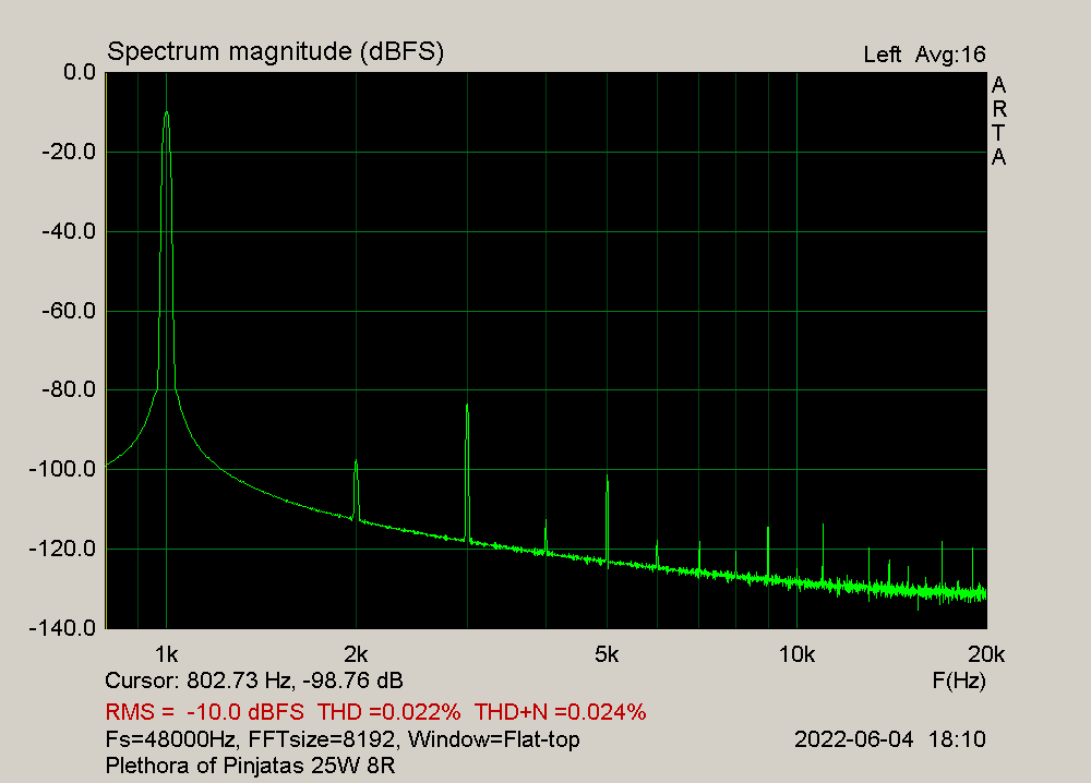

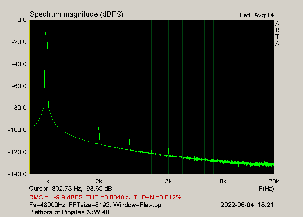

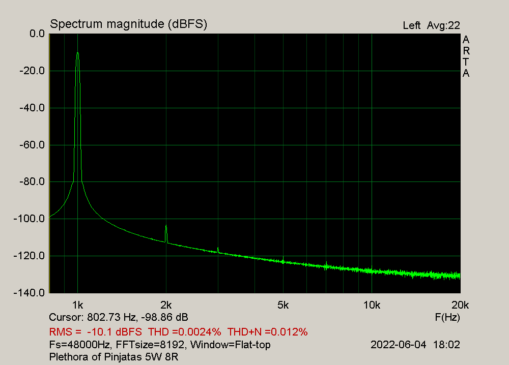

Iq 185mV across 0R11 current sense resistors, so 1A68
Rails +/- 23Vdc
Load 8R
Rails +/- 23Vdc
Load 8R

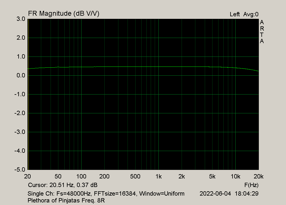

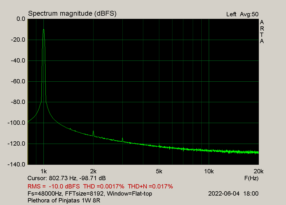

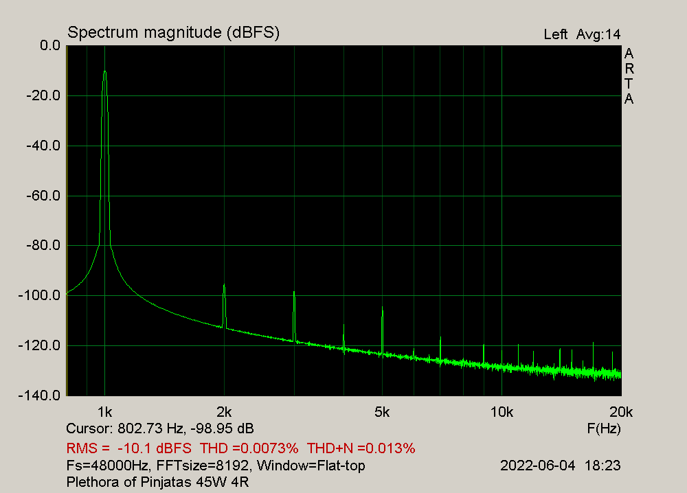

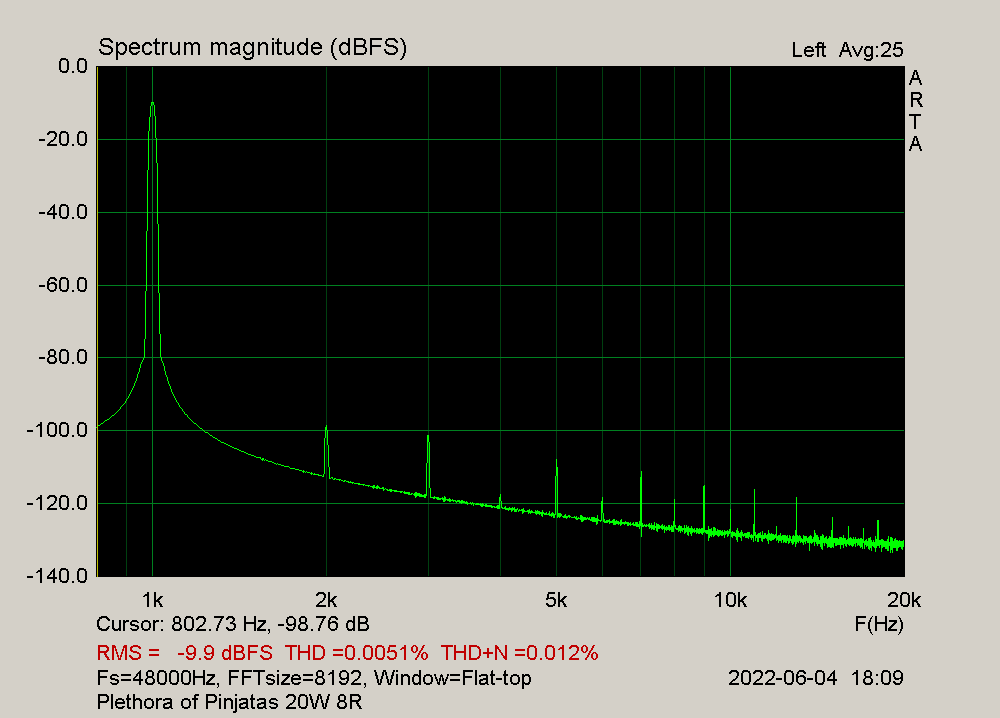

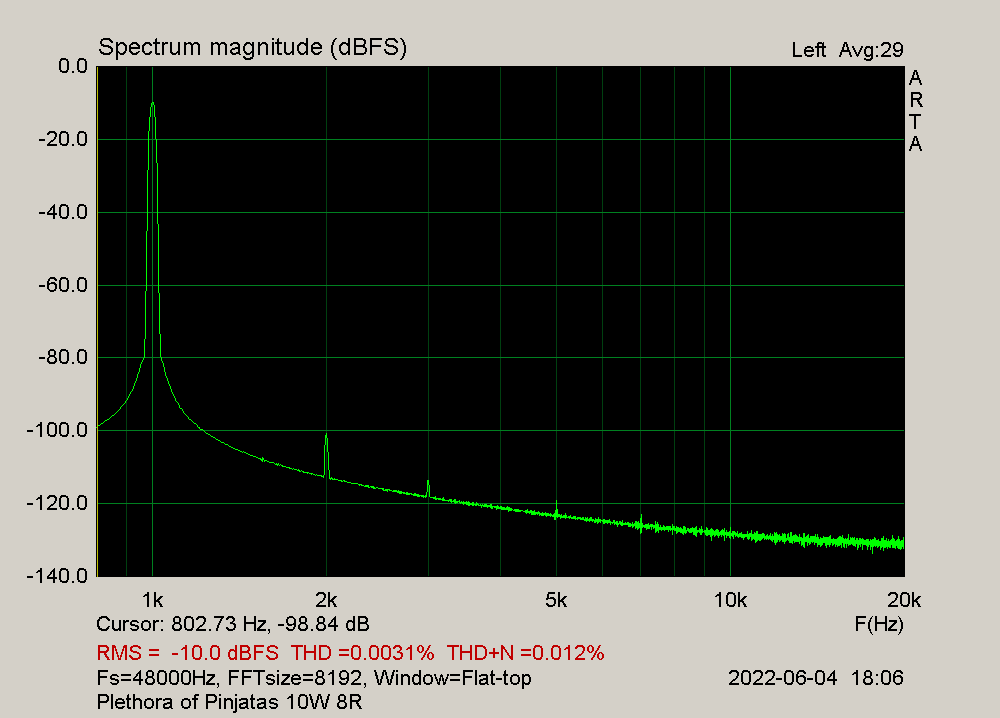

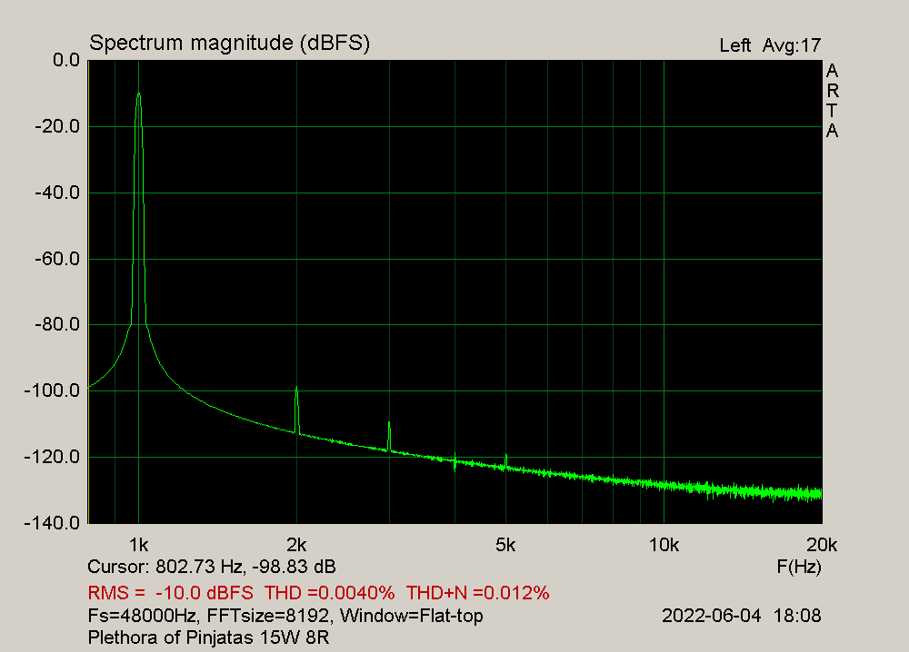

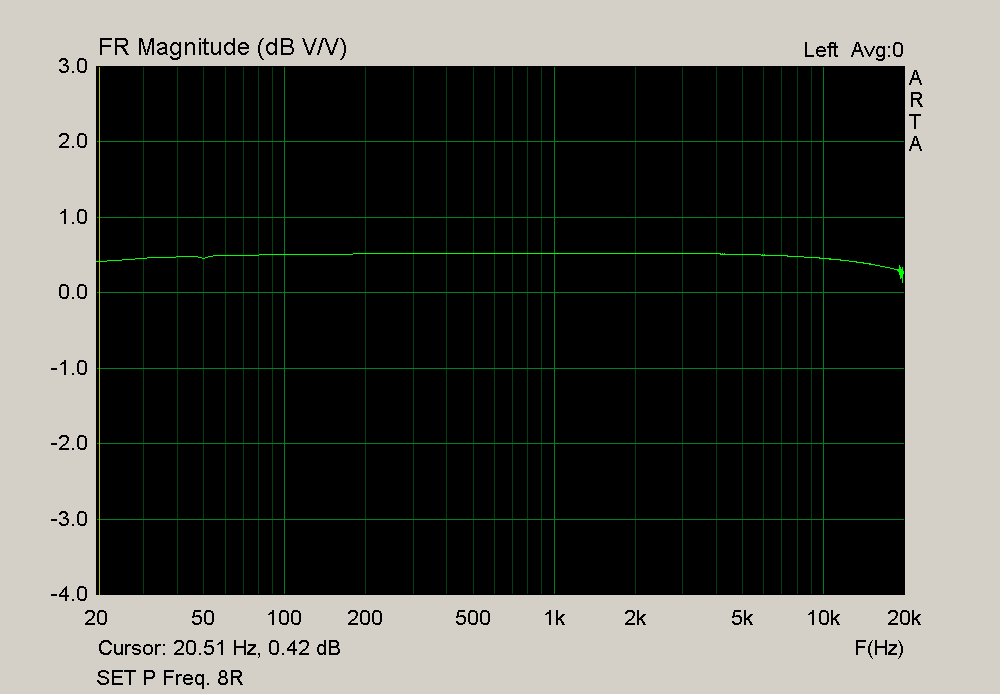

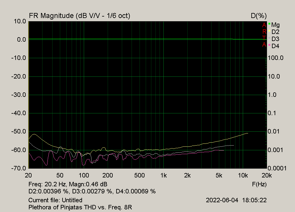

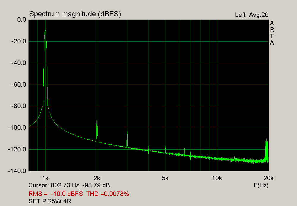

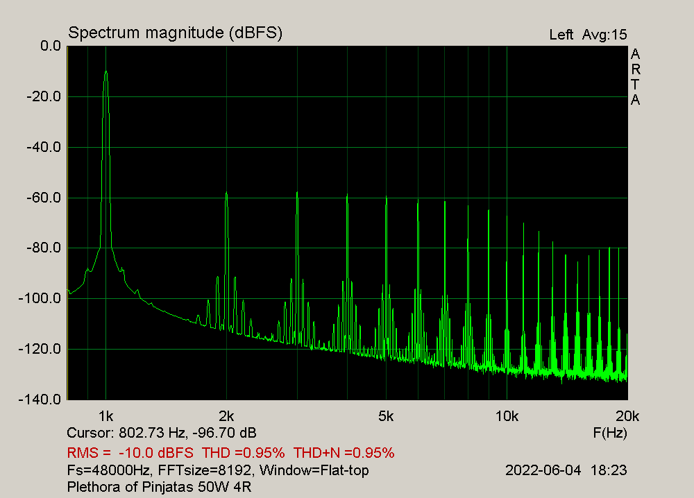

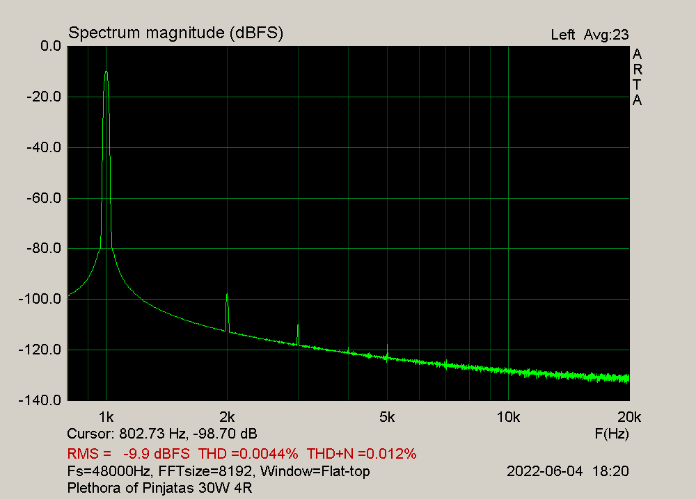

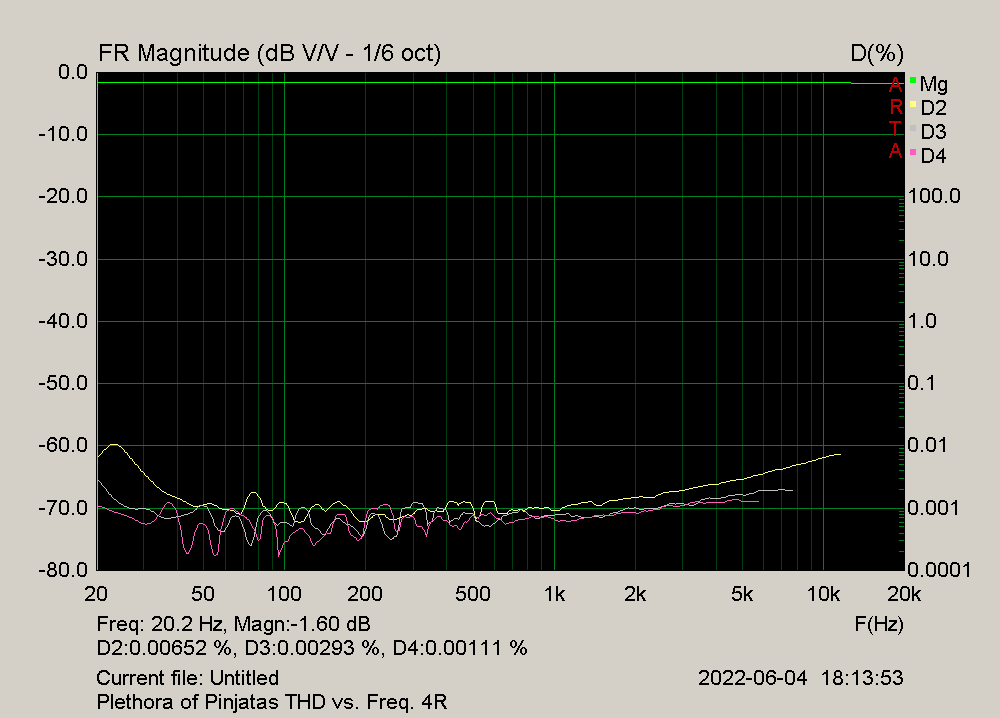

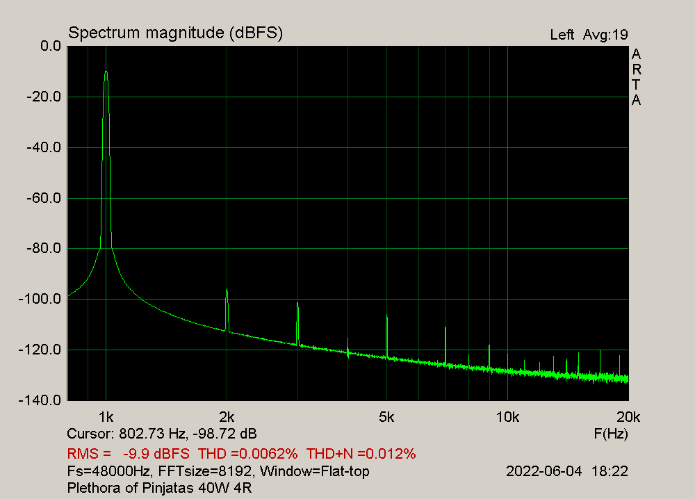

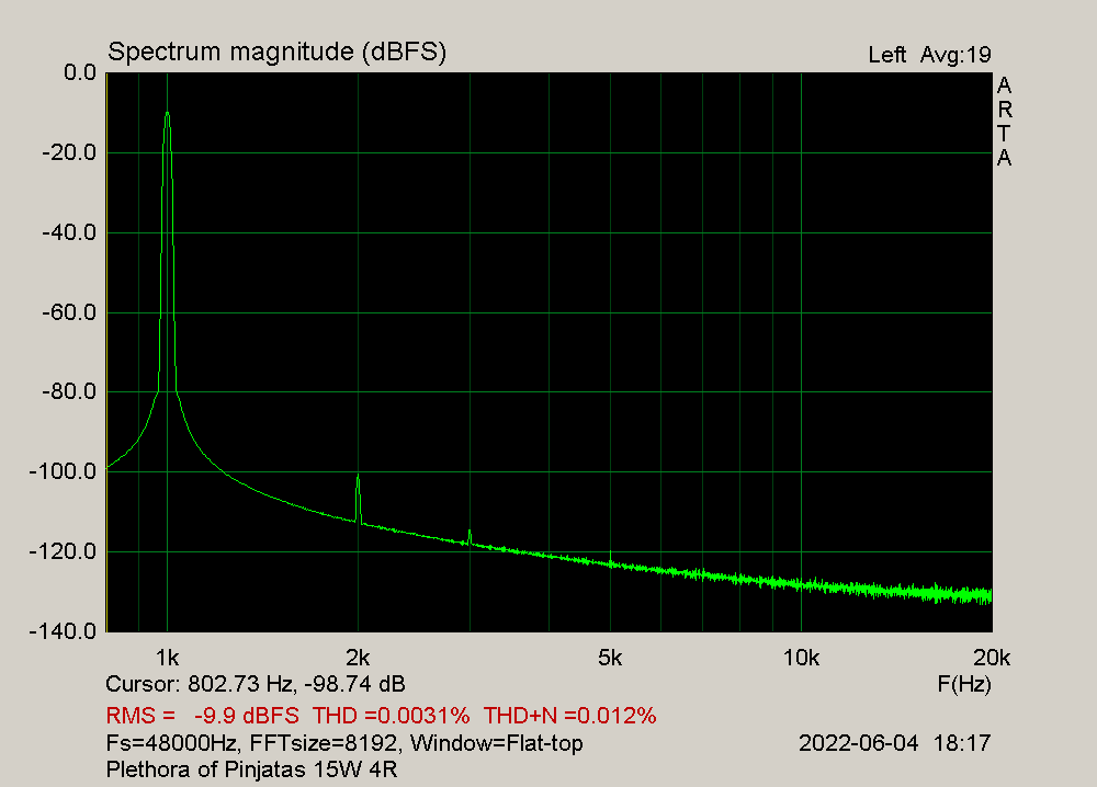

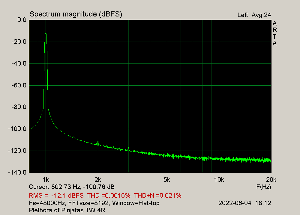

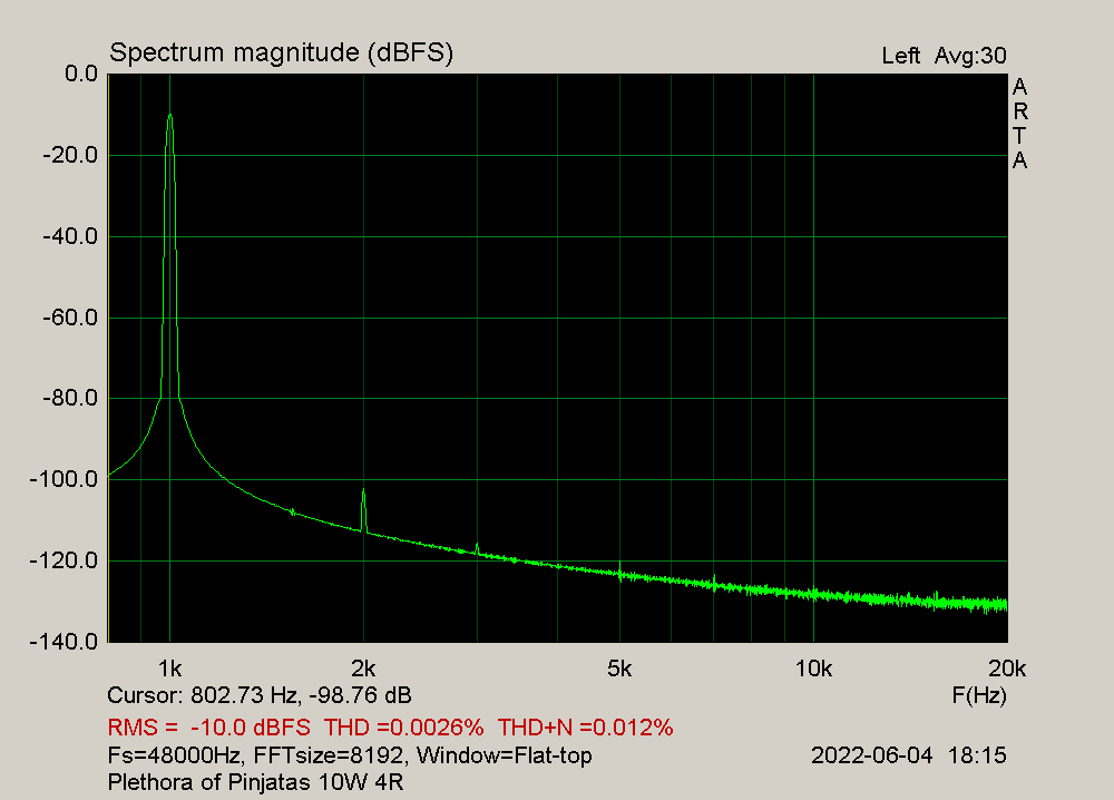

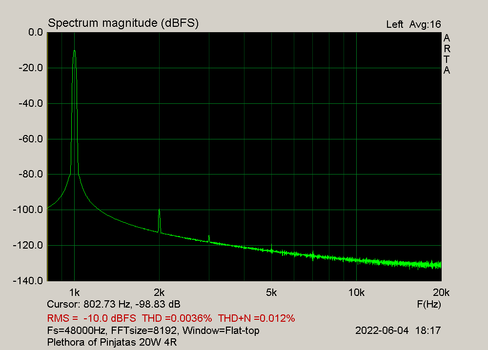

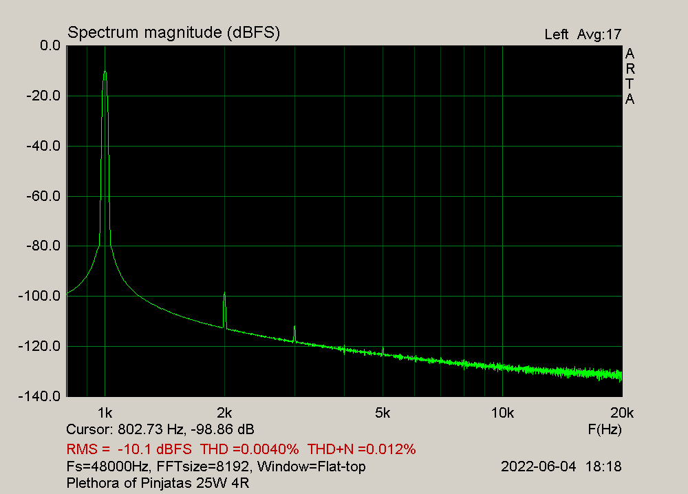

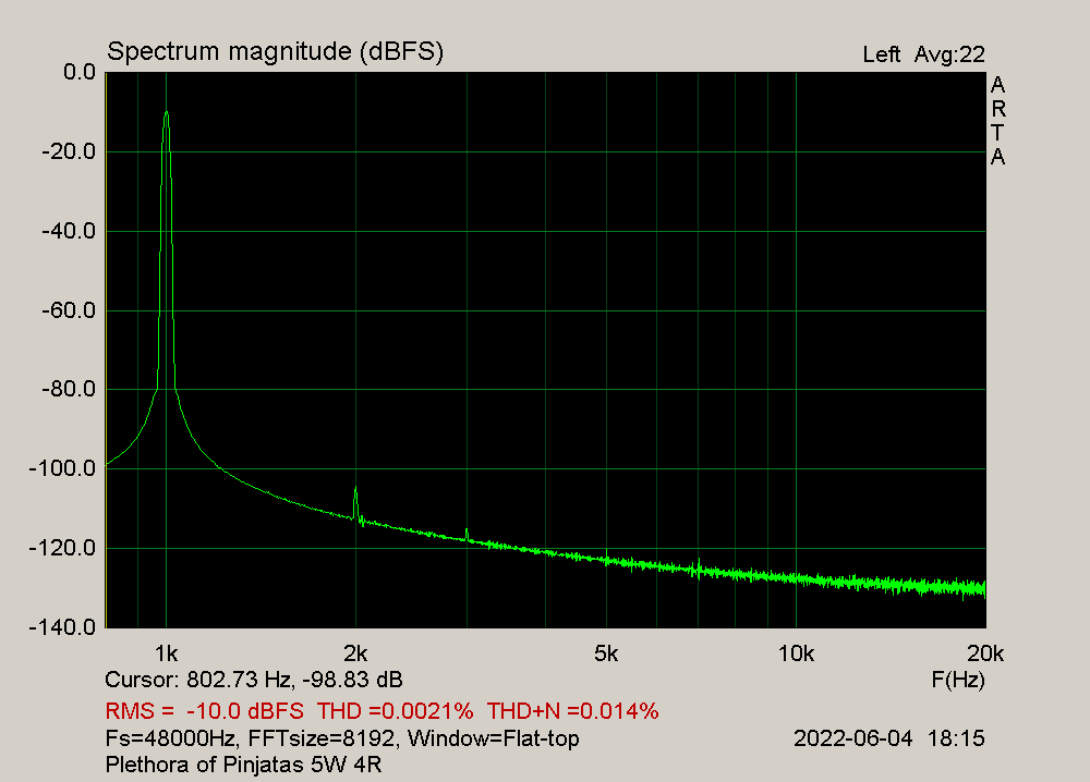

everything same, Load 4R

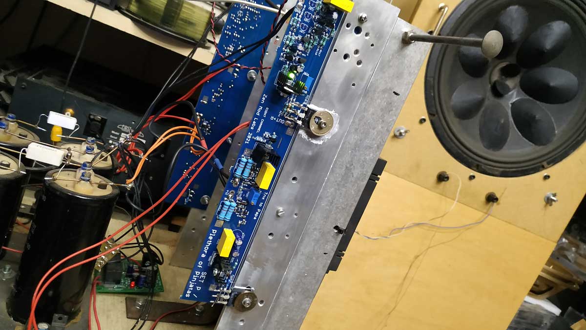

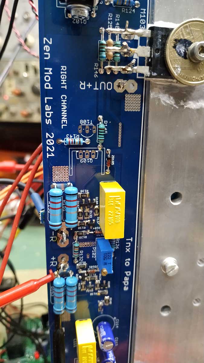

some pics of that in action

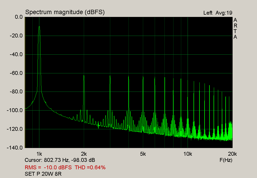

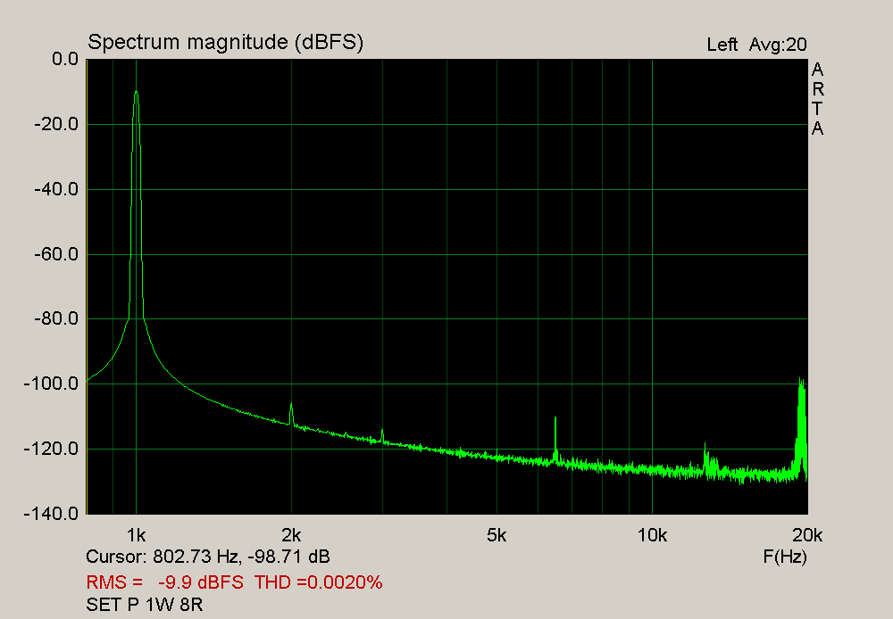

This one being Cheapskate SIT ........ or SIT Emulation, whatever
Schaded Mosfet - giving not just same wakoo current distribution between output parts as in DEFiSIT, but also having practically same output power as SissySIT - around 18W ..... after that level, everything is going Berserk

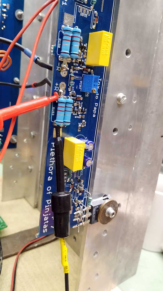

again, Proof of da Pudding;
Iq 195mV across 0R11 current sense resistors, so 1A77
Rails +/- 23Vdc
IRFP240 Ug +4V35
IRFP9140 Ug -4V78
DN2540 Ug +4V25
all ref to spk out
Load 8R
Rails +/- 23Vdc
IRFP240 Ug +4V35
IRFP9140 Ug -4V78
DN2540 Ug +4V25
all ref to spk out
Load 8R

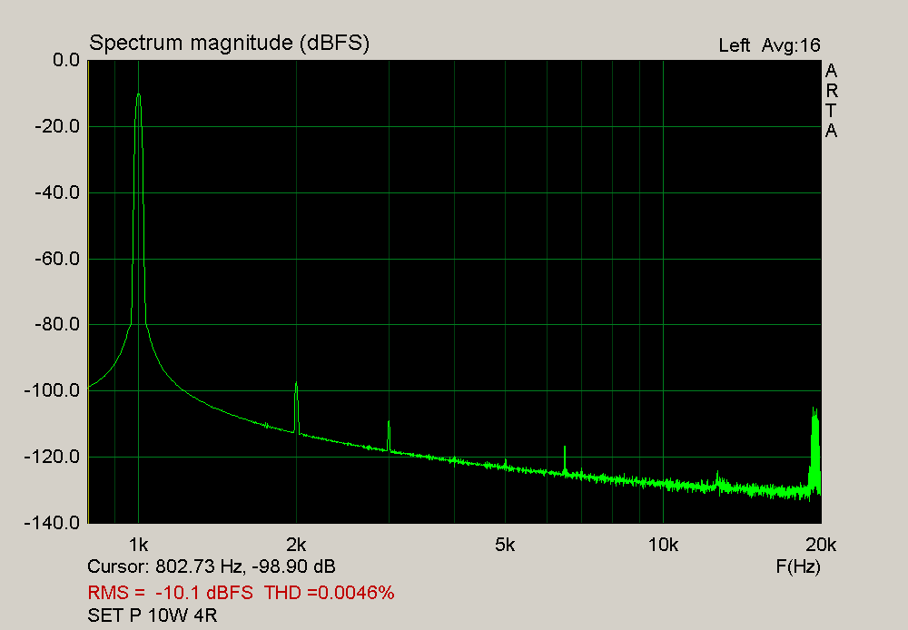

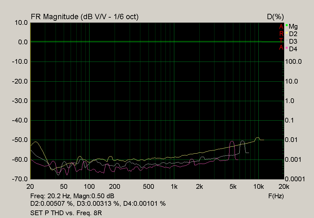

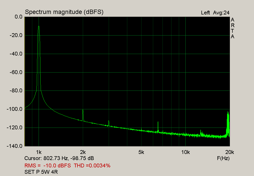

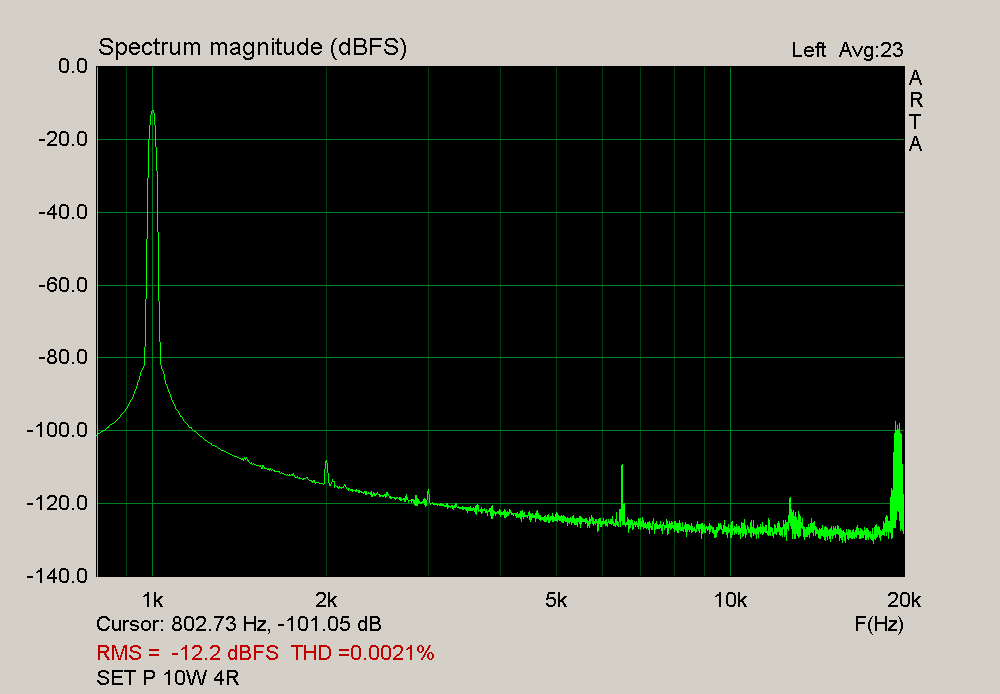

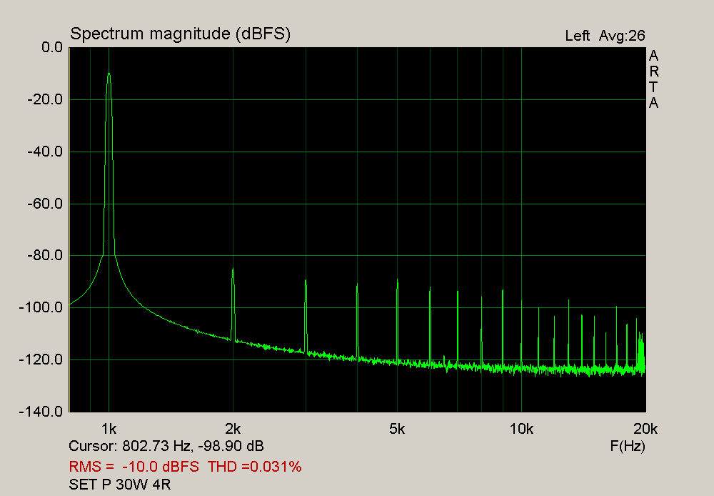

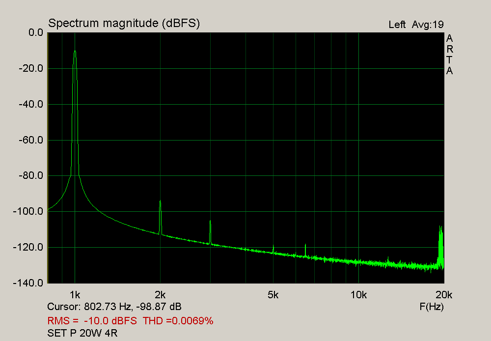

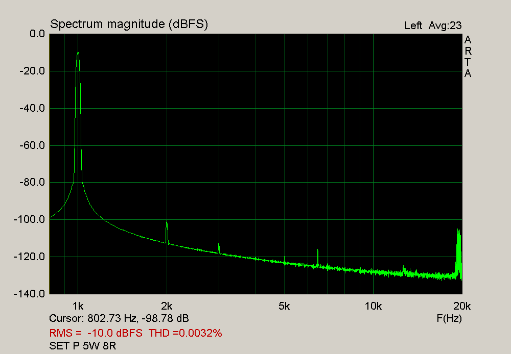

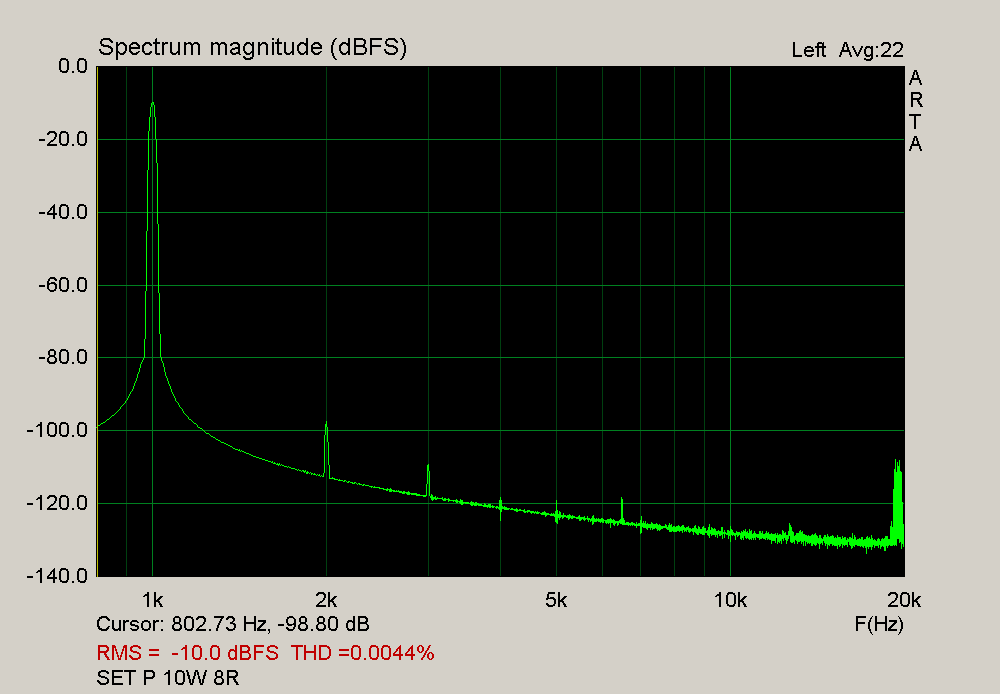

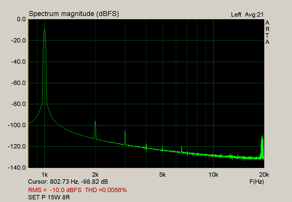

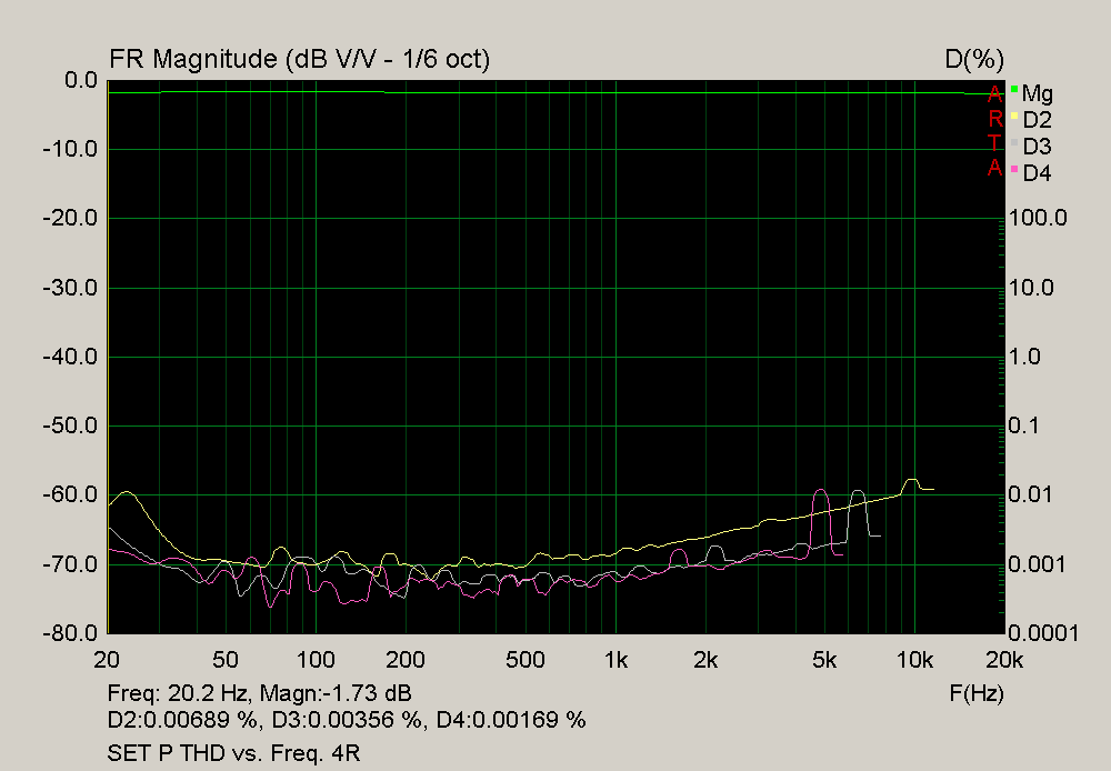

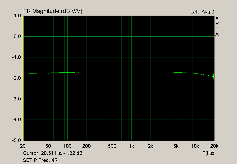

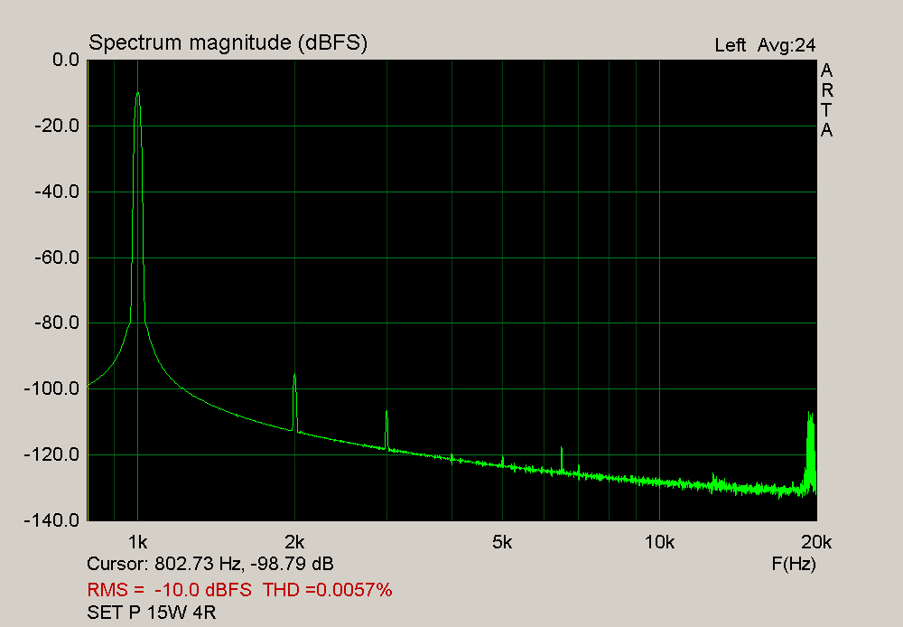

Same, Load 4R

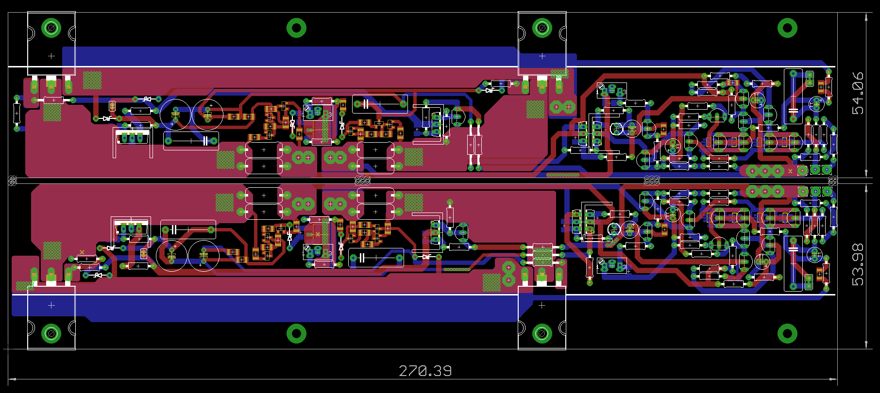

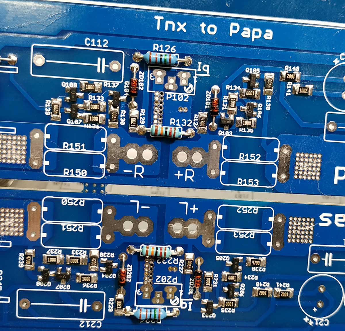

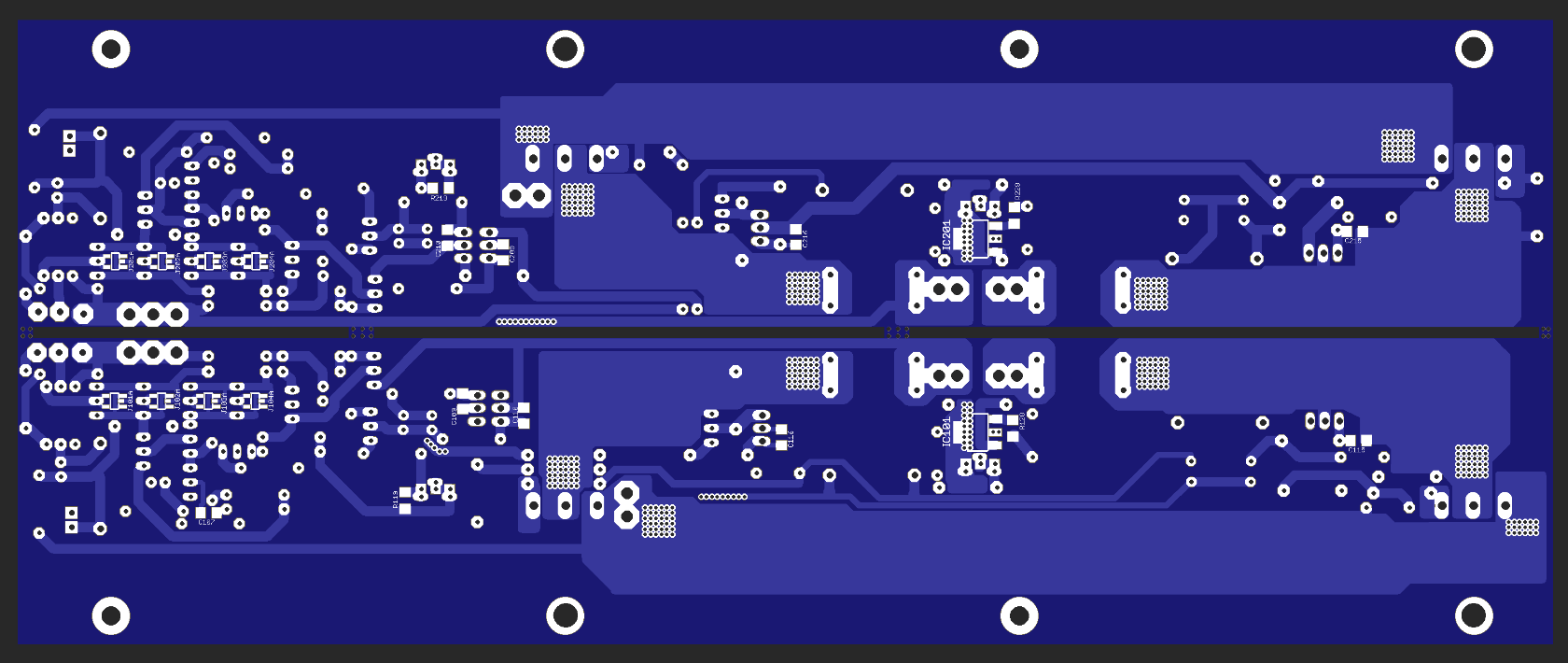

ha, just for your amusement ....... funny pic

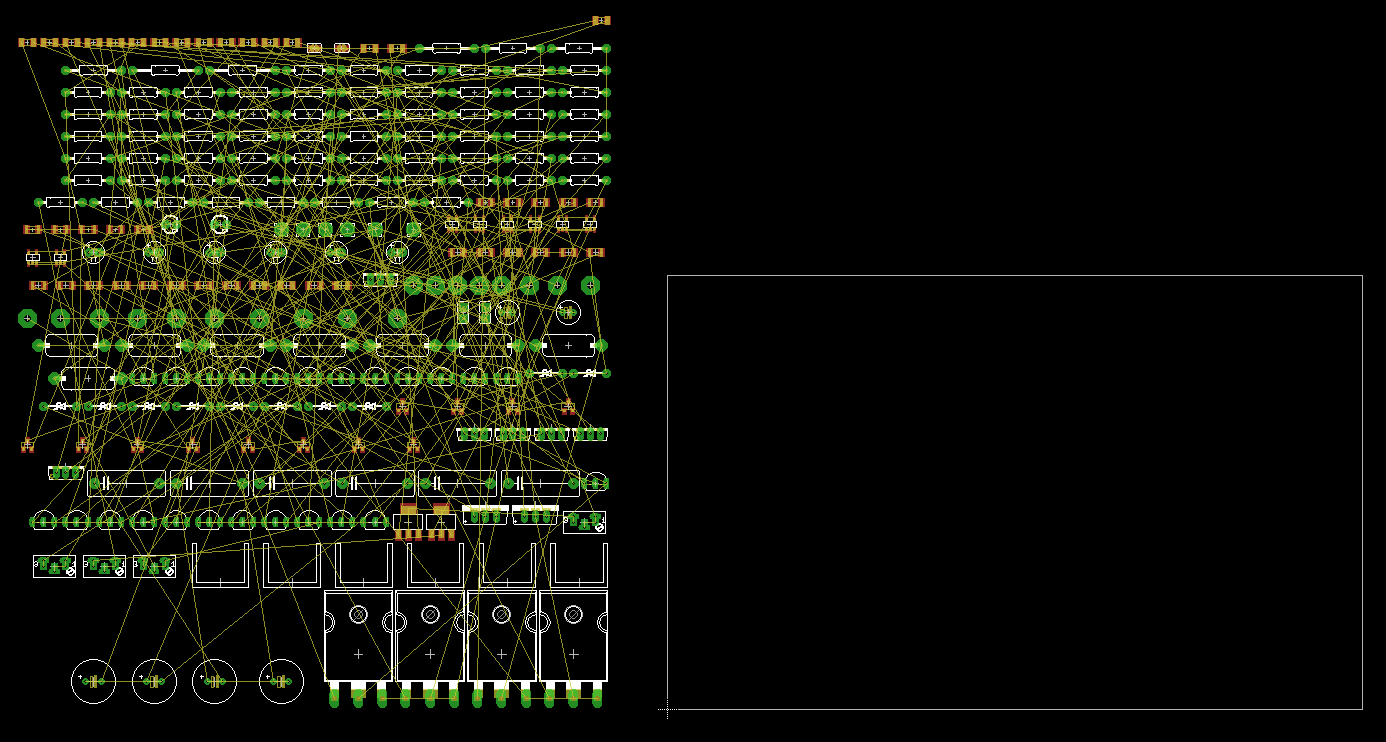

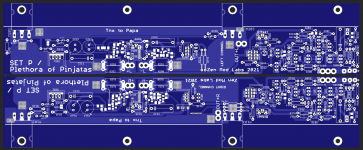

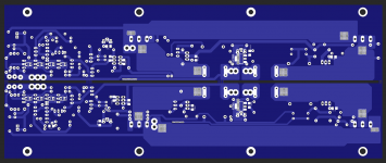

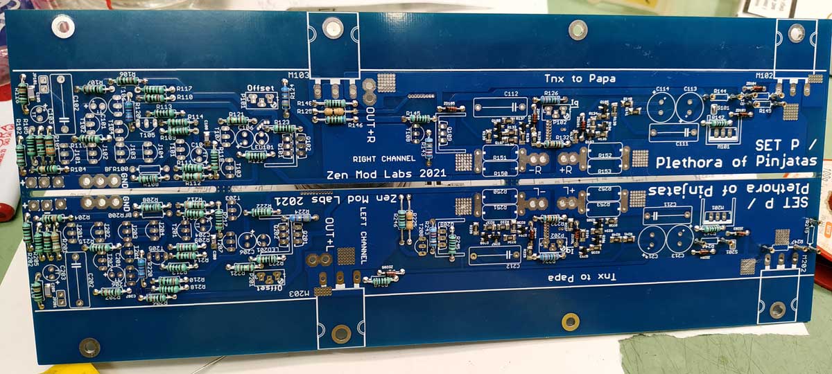

as with all pcb construction programs, first and logical step is to draw schm, hopefully imputing exact physical packages ( size, power, voltage) of parts one is going to use
when that is done, you have *sch file, with missing counterpart *.brd file
getting to that is easy step - File-Switch to pcb
then Eagle (old one, I'm working with.... for me as old sock) ask for confirmation "to create from schematic?", you give it
and outcome is something reaaaaallly frightening
see, what's posted in #1, first was looking as:

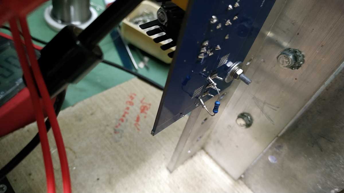

build anecdote:
was sorta late;
after all THD and whatnot tests I did, final thing I wanted to measure and include here, is Ug table (post #8)
lazy but, or rather lazy brain:
black probe on spk out,
red probe on 9140 gate, easy
red probe on 240 gate, easy
then red probe to DN2540 gate - tricky, head leaned, which one is gate ....... probe slipped , shorted D to S
hehe, instead of moving but from chair, and put red probe on C113 positive .... plenty of room , nothing close around
outcome - both IRFPs Dodo, pair of 0R22/2W Dodo
nothing else
replaced IRFPs, all four 0R22, redial Iq , case closed, up to listening position
moral of the story - do not work late and if you are, move your but - helps keeping brain active

The distortion plots are excellent. Do you have any estimate of the open-loop gain of the front end?Looking at the schematic(s), the voltage gain stage provided by T106 and T107 appears to have a very high open-loop gain, since there is no load resistor of the collectors and the only load is the base currents of Q101 and Q102.
no estimate........ I was eye-balling that (contemplating what to do) and doing mental comparisons with FE stages for which I know they're sounding good - how OLG is high and where to keep it
anyway, in some things I'm trusting Pa, avoiding to be Chicken in everything
it's stable and behaving, Freq. range muchmuch better than my measuring setup ( none of this recent amps is going less than 100KHz strong), it sounds good ...... ultralow THD is name of the game, for change
of course, I investigated OLG in sims. but really can't remember figures and lazy to do that
and, what's wrong if I want to make MC phono from amp?
aha - you can see that I started very conservative with pF caps position and values
