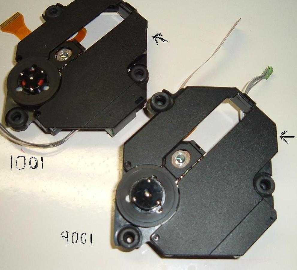

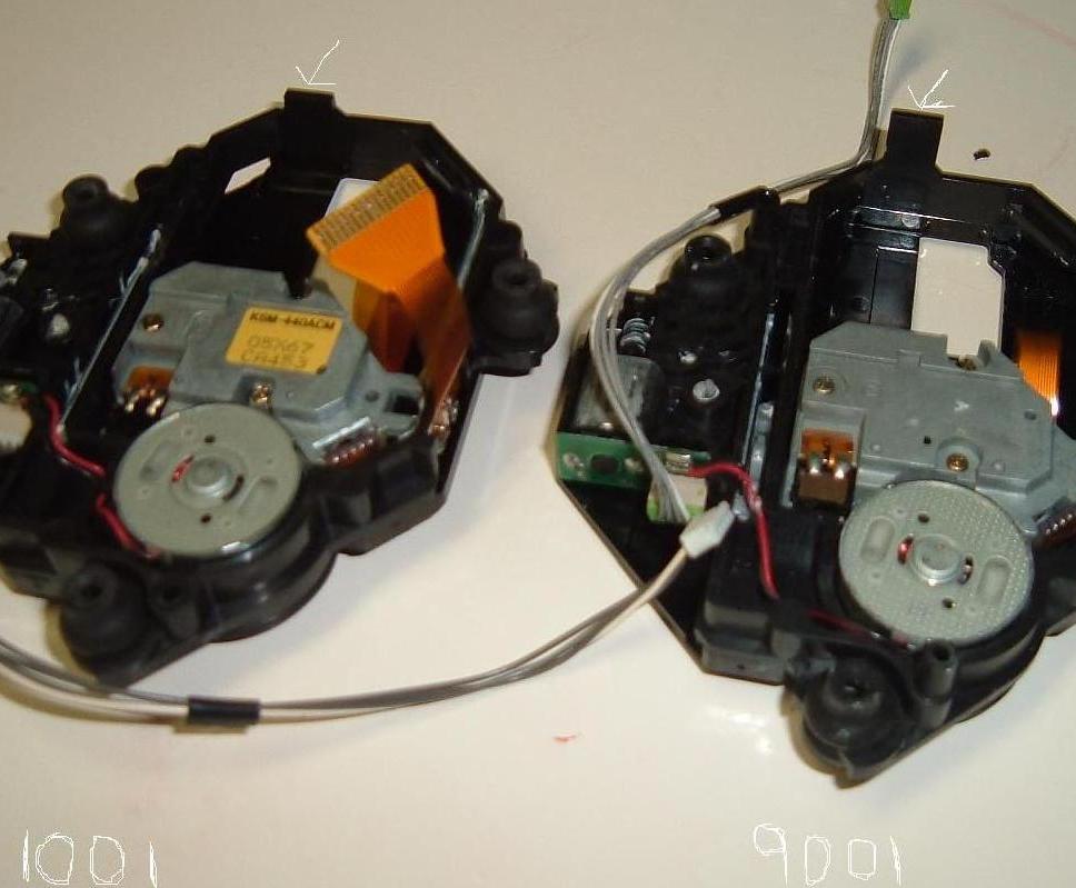

9001 laser
It looks like mrskinny and willbewill are the only ones to install a 900x laser into a 100x.
Past post say you have to modify the 9002 drive by cutting off 3 plastic legs and a plastic bracket, and the 1002 cover opening has to have one edge slightly enlarged.
Wondering if any ones have pics of this.

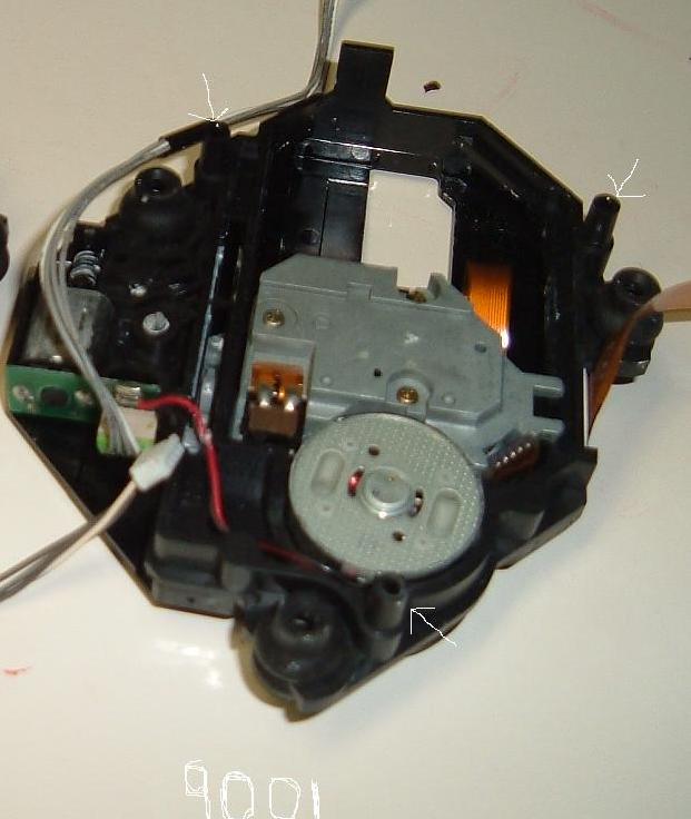

Had a hell of a time making these pictures small enough to fit the file size limitation, so I hope these will suffice.... The picture below shows the bottom of the 9001 drive. The arrows point to the round "tabs" that need to be removed. As you will see on your 1001 drive these tabs are not present.
The final step is the case cutting. The photo shows the part of the 9001 drive that is different. This part will stick out too far to allow the top cover to be replaced. You could just cut this piece off the drive as I did. A better choice, though, would be to cut the opening in the case to fit the drive. That way, if the new drive develops problems at some point, this will be one less step to redo. Good luck!

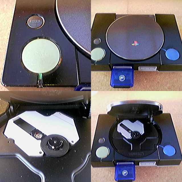

I got the first sound from my 1002 tonight! Its got the Mick F output stage bypass and the original power supply rehoused until the budget allows for a linear supply.
I've no experience of high end players to judge it against, but it is without doubt the best sounding sub 25 pound CD player I've ever heard.
Many thanks to all for the info and a special thanks to Mick F and his splendid photos.
