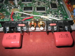

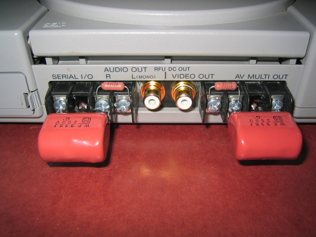

Can some recommend some cap and resistor combo's for a 100k input impedance to my linestage? I plan on using some terminal blocks at the rear of the ps1 to allow me to swap these around and for a later upgrade of better caps. Should have some pics of this soon.
I don't have a problem doing the math on Mick's website
http://dogbreath.de/PS1/output/output.html
I am just not sure what I should be shooting for with the high pass filter going into 100k. I'm dumb in this area 😕 but I can solder.

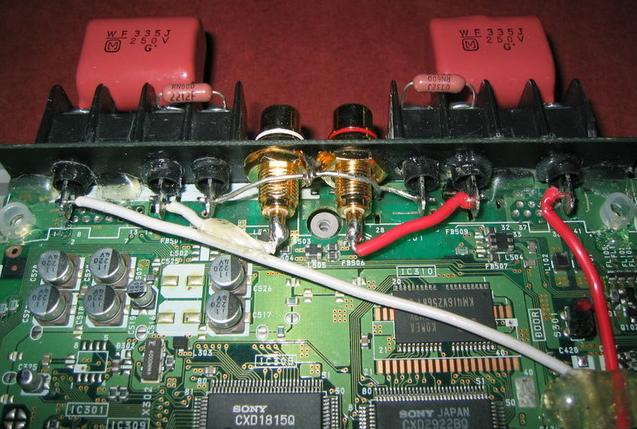

Right off the bat I messed up before I even started. When I went to remove the power plug for the laser the receptical ripped off the board. Now I see why many have said nice pics Mick because man these parts are small on this board. I never soldered such small componets before. Luckily I was able to solder the receptical back down and think I got it to where it is better than before.
Everything else went as planned and pretty smooth until my last solder joint. I had everything done and couldn't leave well enough alone and decided to add a little more solder to the left channel next to the dac. I think I used to much heat and the pad lifted off the board. Now I know the meaning of in and out, I just left it in too long. Caution to those thinking of performing these mods, this has to be the most delicate part to deal with. It wasn't easy and not sure how I had success at it but I was able to solder a small piece of wire straight to the dac on pin 16 for the left channel and all is good now.

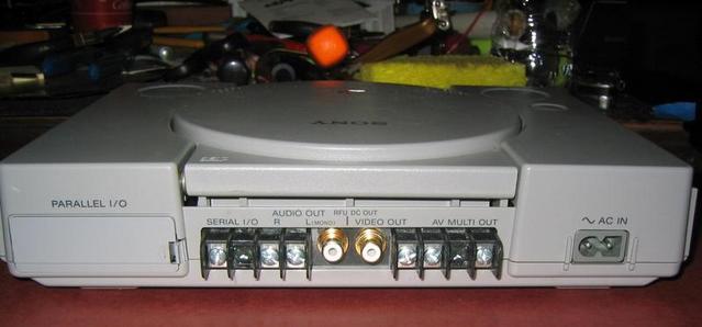

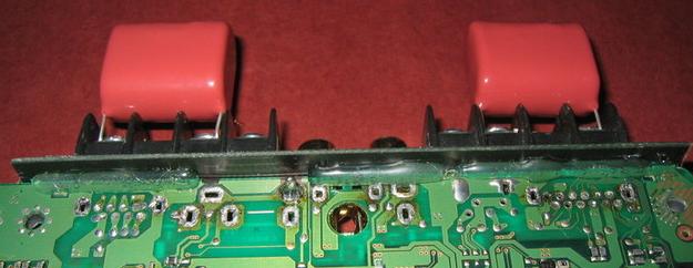

All in all it was a fun project with great benefits and can't wait to get the remote in. I plan on doing something similiar like I did on the back by removing the board from the plug for the controller and memory card slot and putting a blank plate to cover the hole in the front. This way should give plenty of room in front of the ps1 to work with. Also am thinking of mounting everything to the pcb so the cover can be removed without anything fixed to it. When the time comes I will post pics.

Forgot to mention that I hit the safety switch with my iron when soldering the left channel straight to the dac and messed it up. I had to jam the switch so it always stays on to make things work. Anyone see any problems with leaving this like this or should I look into replacing it?

ecir38
Now that's a clever set-up for testing different coupling caps/resistor combinations....😎

hi ecir38, nice work. A great idea for trying different caps, some of which can be huge.
I did the same to my switch, melted the white block while soldering the caps to the DAC pins. Mine actually still works but I don't think there is any harm in jamming it on. It's only function is to cut the motor when the lid is open, but you'd probably do that anyway via the STOp function on the remote or by the CD stopping at the end of the last track.
