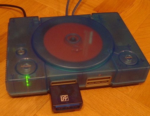

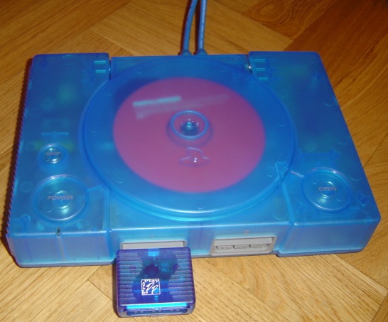

Thanks for links, I'll give the transparent cases a go. IMHO the 5552 sounds the same as the 1002 so those cases will fit OK.
I usually keep all the mods in the case but I thought I'd try some big caps this time and that's how it evolved.
I will make an original case model next with a separate external box for the caps and rca's.
Attached picture of one of my 1002..

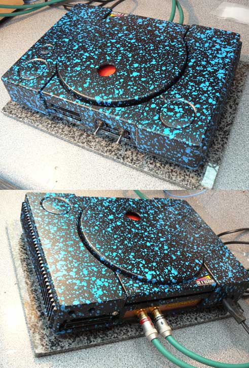

Wow ,
audio1st - fantastic design. Somehow reminds me of the Voight-Com test machine from "blade runner"
diydummy - pretty much all of this work is described in this thread. the only thing alluded to is the DAC decoupling caps, which AFAIK no-one has changed, mainly because these are tiny surface mount cans. Easy to get off, less easy to resolder, but I'd guess they are referring to SM OSCON caps which are available.
AnthonyPT - thanks for the links - I ordered myself a transparent blue case to go with the remote I have.

A couple of things :
1) I ordered this from Anthony's link (interesting-devices), and they seem to have different cases for the various models. Some sites sell similar but they are only the later models with no parallel port. Price was £0.99 so around $2 (US) or 1.5 EUR, but with postage and tax was £5
2) Pretty easy to fit. I took the old case off and fitted the parts back into the new. Switched on, green light - good. However the CD would not rotate, not even the little test rotation from turn on. It turned out to be the plastic "pin" which pushes down from the Lid to activate the micro switch on the board. It was not quite long enough, so I stuck a small piece of bitumen on the top of the pin head, and all is well
3) My blue world effect is compromised a bit by the controller connector plastic still being grey and the LED being green. I guess it's possible to change the PSU LED for a blue or white light ? Anyone know a suitable value ?
4) While I was messing with the lid, I tracked down the cause of the "twang" noise you get from the lid eject with either case. The small spring which slowly opens the lid is the culprit, and it rings like a piano chord. I pushed a tiny piece of speaker wadding inside the central coil - the damping springs on a Thorens TD turntable use the same trick. No more buzz when the lid opens. A small detail, but all part of making the whole thing as vibration free as possible.
Hiya!
I just fitted the transparent case to my PS1. Same trouble with the pin not being long enough to activate the CD spin safety switch. Actually I think the spring hinge lifts the lid up too much on one side - you can see this by looking at the back of the unit. The lid slopes very slightly.
I'll try your trick if extending the pin slightly!
- JohnM
- JohnM
