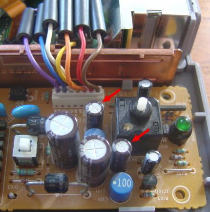

Possible SMP upgrade
So I'm thinking that it's probably worth looking at Caps C103 & C104 (arrowed - both 180uF/16v) as a fairly easy starting point as these appear to form part of the final LC filtering of both the supply voltages. Looks like the cap diameter is 6mm. Might be tight to get an oscon in there. Any suggestions as to best High Freq cap for this space ?
I upgraded those caps and 2 more electrolytics, which have the same 16v rating. Unfortunately, I didn't hear much difference as compared to the stock caps. The biggest change I got was when I changed the diodes and the first big filter cap before the transformer. However, I'm thinking of changing those .048 400v caps that are in series with a resistor, right at the AC side. These form a filter right? What changes, if any, if I placed a higher value polypropelene cap, around .1uf in place of these? Will this help in improving the sound?

Thanks Greg. I think I might get a couple of ZA's and replace the final filters in the LC network (C103, C104). forgive me, but I'm a bit sceptical that replacing the diodes in the bridge would have any effect, isn't any noise from these utterly swamped by the noise from the chopper circuit? The 2 large diodes to the right of the Transformer look harder to replace, though they might be worth it ? Maybe also the big smoothing caps (C101, C102)
Re: Re: Re: improvements to existing SM PSU ?
Jives11,
I'm basing my choices on what several of the professional modifiers do (www.referenceaudiomods.com and www.tweakaudio.com, among others). They all pretty consistently replace that first set of diodes along with just about every other cap in the SMPS.
And given the cost of those Rubycon ZA/ZLs, it was an easy enough decision for me to do them all.
I didn't do the 2 large diodes because I wasn't sure of an equivalent high-speed/soft-recovery version.
The only thing you'll need to decide is what to use for the larger smoothing cap... there was no ZA/ZL equivalent, so it was that expensive and large Jensen 4-pole or an equally expensive Black Gate... and I see the modder's going more to the Jensen for that position.
Finally, I did two SMPSs... and they were different types... and they sounded slightly different before I mod'd them and continued to do so afterwards, with the one I preferred beforehand being the one I preferred afterwards.
Greg in Mississippi (usetabe Minneapolis)

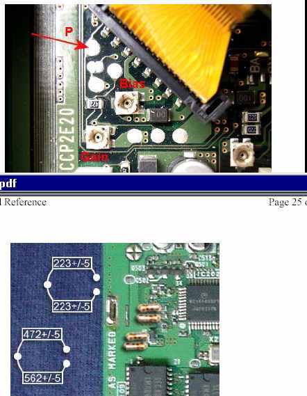

Hi
So far all the PS1 1002s I have
adjusted have been cooperative
all except one! This early unit seemed to have
something wrong with its gain control
trimmer. Do no seem to be able to get
it past 1.75v at best. On one extensive repair
site I came across it had a suggestion for fixing
the bias and gain permanently. I enclose a
picture from Mike_F"s excellent site and
from the other site showing resistors and
values being suggested. I only do this
so we know what we are talking about.
Anyone else had the trimmer blues?
Other site seems to be showing different part
of the motherboard near the crystal not
where the trimmers are! Maybe its not even a
1002 board at all!
regards
AnthonyPT
http://bearykirby.com/tech/ps1.htm (site where resistors suggested)
http://dogbreath.de/PS1/LaserAlignment/Laser.html
Mike_F's excellent site we all know!
