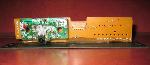

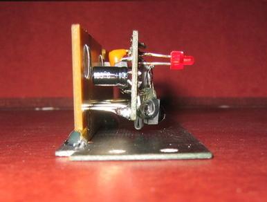

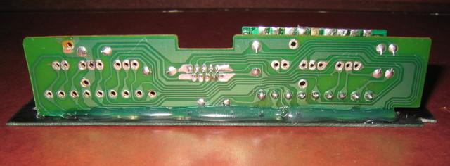

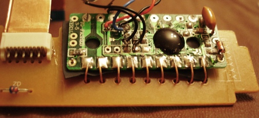

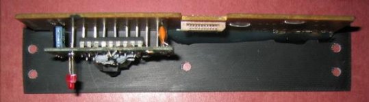

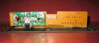

remote
Finished the remote today. I gutted the remote receiver and the input connection for the wired remote. Cut a piece of fr4 board the same size as the original input that mounted inside the ps1.

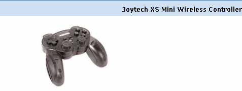

Hi
Have been experimenting with an RF joystick from
Joytech. It works through walls and the sensor
which can be inside the PS1 case seems not to
hassle the player as far as I can see
On sale for AUD$19. Good up to 30 plus
feet they say. Has sleep mode for batteries
No more code errors when your playstation
gets LG or Sharp TV signals muddled with
some remote codes ! ! !
Regards
AnthonyPT
Hi ecir38
Joytech have some interesting controllers.
Is that one you highlighted a RF unit?
If you go for their more costly RF controllers
you can I believe have them set to two codes
so if you have a dual PS1 set up with fader
you could switch the controller to either PS1
or have one controller for each PS1. Used to
do this dual thing with my CD32s before I got into Ps1s.
Joytech also made a Ir controller module that runs
on same codes as a Futuretronics remote.
It says 39/50k series and behaves better with the
Futuretronics controller than with its own JT silver remote
on the PS1. Hope to write up a thing on remotes sometime soon. Many other IR brands I have tried perform badly with PS1s.
Anyone else having TV remotes sending odd codes to their
Ir recieves on their PS1s??
Regards
AnthonyPT
