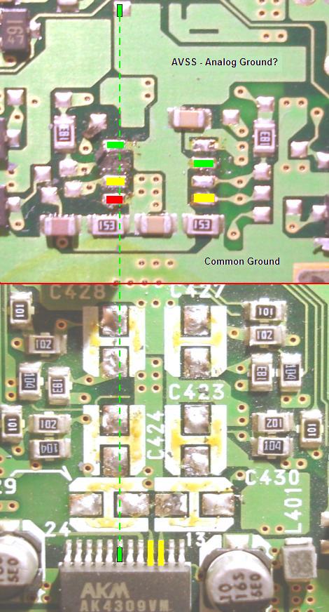

Hey guy's just modding another PS1 and was about to connect the ground wire of my bypass wires to a place that is supposed to be connected to the analog ground pin on the DAC... but it shows 15K to the general ground on the board.
Should I use this one or just pick up one of the general ground planes?
Thanks chaps
This is the area I'm talking about... AVSS analog ground?...
If you fold the picture along the red line you have a mock-up of the board.....
It is the analog ground for both Opamp inputs as you can see (opamp removed) and is connected to the common board ground by that 15K SMD.
I'm assuming that the solder blob on the underside of the board is covering a throughhole to the AVSS pin of the DAC.

Ah well, just reboxed my PS1 and plugged her in...
Right channel good! 😀
Left channel dead🙁
When I turn the pot I just get static and 5V DC out of one channel (2.6 on the other) do you think the DAC has gone or could it be the transport?
The schematic is extremely simple at the moment with a 50K pot wired in straight after the DAC pins and then blocking caps after that so you can hear the DC when you turn the pot on the bad channel. This feeds a T-amp so the caps need to between the pot and amp (Bias voltage on it's imput). I could put another set before the pot but I didn't think it would really matter.

This is the 3rd PS1 I've modified and I prefer it with no buffer or anything in the signal path so I try and keep it minimalistic.
If you add a capacitor you change the sound so the fewer bits the better.
I have it running like this in it's original case but after re-casing it developed this problem. Must have disturbed/damaged something.
I was just wondering if it could be the laser cable that has a bad connection......
loss of a channel . I recall I had this problem earlier in the thread with the configuration of the output resistors. The RCA plus have a shorting function so that if you connect the PS UHF Mux into it it sums the two channels and provides a mono down mixed version via one of the out RCA's. This doesn't explain why a rebox looses a channel but it does explain why the poutput mod does. Check out the earlier posts in this thread. Mick_F's mod avoids this problem by his choice of earth point for the resistor
Thanks for the reply sir but I have completely bypassed everything and jumped off the pins straight to the pot and used a common ground as shown in a few posts above.
Even if I put an extra cap and resistor combo in there it will still have the same problem.
I was wondering if the signal may not even be getting to the DAC? Maybe it's the cable connections for the transport? I'll open her up at the weekend and have a look.
