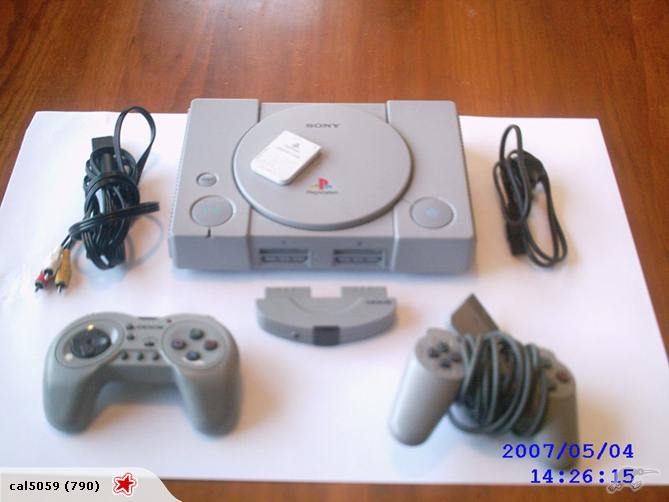

Man this thread is loooooong!! ok so I have skimmed through the thread, and I think I'm going to pick up an old PS1 on flebay...I'm just currious how it will stack up against my Marantz CD5001... has any thoughts?

Toggle switch for PS 1
Hello,
i want to recasing my playstation. I have seen on www.musicconnection.de that they use toggle switches for the player functions. I have no idea how to make it. Can someone help with schematics, etc.? Many thanks.
Made the output mod with 3,3 Audyn caps and Vishay CFM 55 resistors, it is a really big improvement. Thanks.
Hello,
Re: Toggle switch for PS 1
You just need the board of the gamepad (is that the correct name for the thing the PS1 is played with?). Replace the required switches of the gamepad by switches to be placed on your recased PS1. The internal connection of the gamepad board can be done as shown in the RC article on my website.
Glad to hear you are happy with the output-stage modification.
Mick
risperdal said:Hello,
Mick
