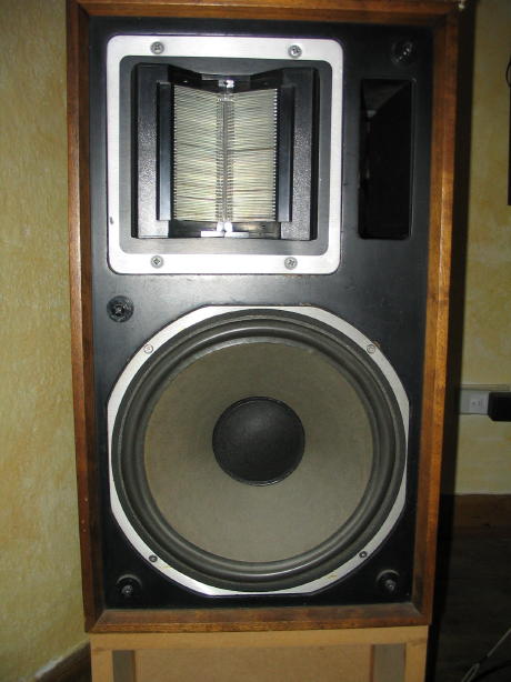

very nice ! Can you give more detail of the speakers ?

the speakers are original ESS-bookshelf from the seventies with the legendary ESS air motion transformers (a patented design by Oskar Heil) and a 30cm bass woofer. The speakers have a efficiency of around 93dB/1W, so 2,5W are prettty loud.
I refurbished the speakers some years ago and I will post a photo tomorrow.

Hi Jives,
this is for you: ESS-bookshelf
