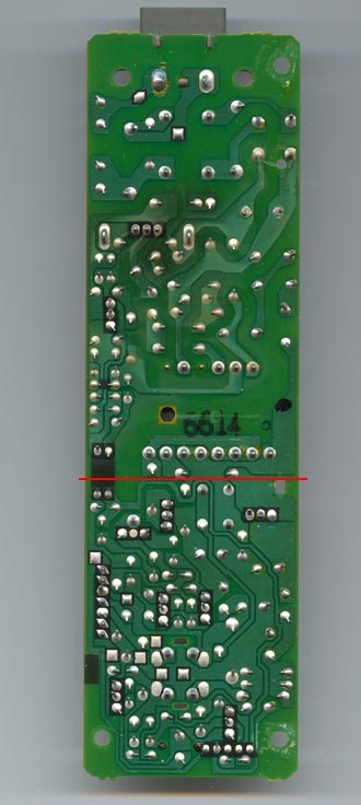

Antoine, I'm talking about splitting the PCB, so the leads go between them. You still use the 7-pin connector.
As said, the idea is to keep the hot voltage regulator and transformer (?) away from the CDM.
I'm not saying this is ideal. But it sure beats making two PCBs. I haven't made any PCB in more than two decades and don't really feel like starting again. I assume it's a lot easier today, but still.
Once I have checked into this a bit more, I'll post back here.
Here's what I mean. The red line is where the PCB is being split and the blue lines are leads.

The PSX SMPS is complex. But to me it gets a bit easier when you split it in two at the two big diodes. I was considering rebuilding it as two PCBs, keeping the parts that get hot away from the PSX. That way I would need a cable with only two leads. It will still be complicated as far as I'm concerned. But if you must re/make a PSU, I think this is the best alternative.

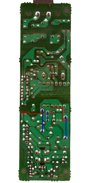

That might be true. I made a mistake though. You will need 5, not 3 leads. 3 works in the schematics but not with the PCB layout. I forgot the PC1001 IC. I guess that's the reason they say "measure 2 times before you cut" over at the speaker section.
I also noticed my drawing has one error, but is basically correct.

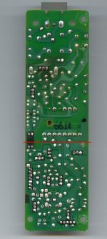

Sorry for spamming the tread. But the earlier EAMX5 (?) PCB will work. It will be even easier since you can cut it in a straight line. Don't take my word for it just yet, but it sure looks that way. Again you will need five leads. In any event, this is the one I will try to work with.
DragonMaster, if your reply is for me, I'm lost. But that's the least of my problems right now. I have a PCB to look into.
Added an image of the old PCB. Remember, double check before you cut it.
My EAMX5 board just went up in smoke. The big cap had come loose, so I tried to repair the board. I then checked the outputs and got 4 V from them all!? Then I'm not sure, but it went wham and the room went black, sparks flying and the probes melted.
The board didn't look healthy to begin with. Cracked and discolored. Now it's retired.

I will buy two of those new ones to play around with. Cut them in two, to be more exact.

I've been meaning to ask what you plan to accomplish by cutting them in half?
Given some of the radical things I've done to my PS's, I'm not the one to be the skeptic.... OTOH, I wonder if the inductance in the leads of any length after the transformer might cause problems with the output rectification and be a source of radiated noise.
Just curious... and if it turns out to work well, I'll be sawing on mine the next weekend!

PS Why should the SPMPS board be cut???
