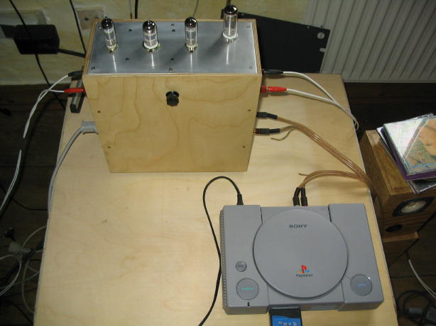

PS-Power Booster
Hi you all,
I am afraid this is a little bit off topic...I built a flee power SE amp that delivers 2,5W into a 4 Ohm load. My PS is directly connected to this little amp. Realy good sound with my highly efficient ESS-bookshelf speakers.
Nice Easter Holidays and happy listening!
Peter
