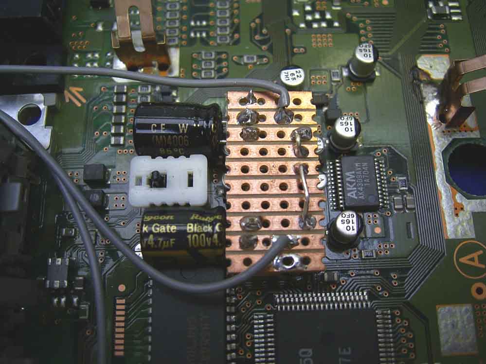

On the Playstion I just connected straight to the possitive side of the second pair of caps, removed nothing, added a pair of Black Gates for blocking and ran straight to the new RCA's. Picked up a ground and placed 47k resistors to ground, ( also tried 100k and 1k).
This all works fine with the T Amps, the problem is when I bridge out the 4.7 Black Gates that I get DC problems.
I have attached pictures showing where I attached to..
Back to the PS1...so you have 2 circuits running to the RCA's? You jumped in but didn't break the original circuit anywhere? Not being an electronics expert on this one I cant comment but could this cause issues? EDIT** Ah, read it properly befor ecomment Lee..Doh!...New RCA's..sorry!audio1st said:
Lee

Nice and neat Mick...Just to clarify, that is magnet wire (laquered) you have used so as not to confuse someone who may wish to try it..😉

before I implement Micks new simplified output circuit I was wondering if anyone has found a suitable place to put some ceramic decoupling under the board ? Dommi used some ceramics around the existing 10uF caps, but there may be a useable place somewhere else .....
jives11 said:before I implement Micks new simplified output circuit I was wondering if anyone has found a suitable place to put some ceramic decoupling under the board ? Dommi used some ceramics around the existing 10uF caps, but there may be a useable place somewhere else .....
Other than decoupling the pins on the chip, I think thats as close as you can get.
Lee
