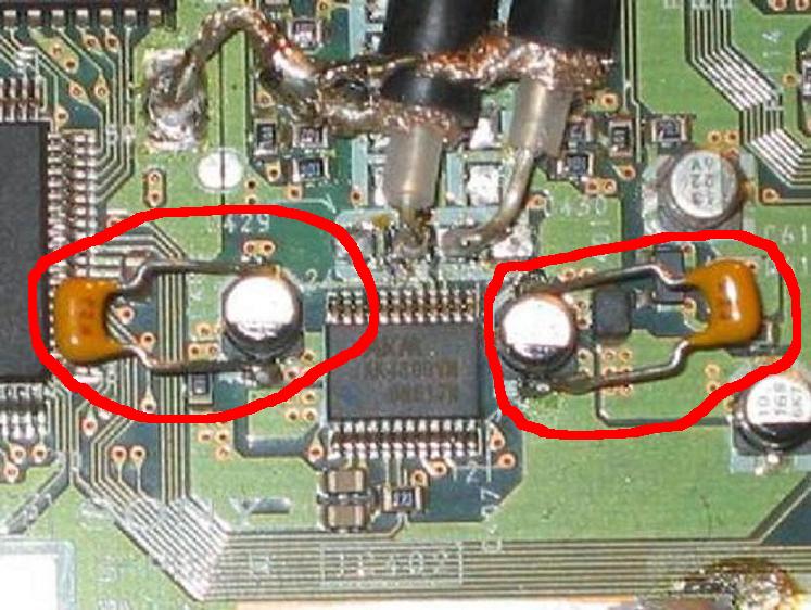

<Dommi, can you elaborate on this modification please?
I will try it
This are caps which have a very small capacity. I think it`s better to use them to make the original caps faster. Next week i have to go to my electronic dealer and i will take 2 new fast caps for them, so i can disolder the original one and solder the new one.
I don`t know if it' neccessery or audible, but if the soldering iron is just hot.............

Thanks Dommi, so you've bypassed what seem to be 10uf with....1uf? I wonder if a bigger one behind that would help at all?Dommi said:
Dommi
that's not right. I don't bypassed the 10 uf, i'd put the 1uf parallel. The 10uf caps are still active !

Sorry Dommi, that's what I meant. The terminology on these forums seems to change throughout the areas. Some call this bypassing even though technically it isn't!!! Go figure!
Lee
<Sorry Dommi, that's what I meant. The terminology on these forums seems to change throughout the areas. Some call this bypassing even though technically it isn't!!! Go figure!
OK, i only want to avoid misunderstanding because my English is not the best !!
I think a bigger cap is not neccessery because the needed current from the DAC isn't big. And don't forget the bigger cap is the slower cap.
BR Dommi

What do you think about this:
First I drilled a hole into the board between the RCAs and disconnected the RCAs from the circuit (by cutting the traces with a small screwdriver). Three cuts are necessary, two on the bottom.....
....and a cap on top of the board next to the strange thing Jives recently discussed here has to be removed. You can see the empty pads on the left of the thing.
Then I soldered two 3.3uF polyester caps to the input pads of the first set of caps, i.e. directly to pins 15 and 16 of the DAC. Two wires go from the caps through the hole.....
... to the bottom of the board, where they are connected to the + poles of the RCAs. Finally I soldered a 22k ground resistor directly from the + to the grounds of the RCAs.
This way, the complete stock output stage is bypassed. The only things which are now in the signal path are the Wima cap and the ground resistor. What do you think about it? I have not powered it up yet (I never do that after late night soldering).
