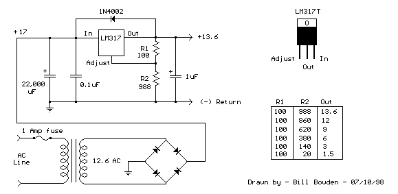

no no no my friend.
forget the batteries.
you need a linear power supply regulated capable of 5A minimum.
i made one with 7A and the result is outstanding.
but it`s a lot of current for batteries.
if you go back to this thread you will find info about it.

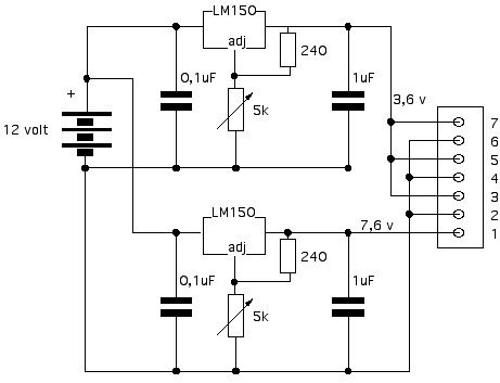

Hi all,
I have been reading all of this thread last night. I bought a playstation one
some time ago because of the rumours that it should be such a good CD player.
It is a 1002 without any modification (so far). Although I like the sound very much
is does not come near to my reclocked Marantz CD80 with external non oversampling DAC.
It would be very nice however to use it on my sailing boat. On the boat there are 2 lead-accid bateries, one for starting the diesel, one for lamps, radio, etc. Capacity about 100 amp/h
This should keep the Playstation running for a while.
Reading all your posts I came to the next scheme to realise Lead-accid power supply
Maybe you could look at it and tell me if this is the right way to connect the Playstation to a battery
thank you in advance

Re: Playstation on lead-accid
yes this schematic is right for battery use.
just change the output cap with 1000uf at least.
of course you can run it from a car battery but it will need a charger and it isn`t practical.
anyway for the rest

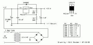

and for anybody want a supply from AC i attach the full schematic but you have to use instead lm 317 the lm 150 or lm 338 or lm 350
i hope that you understand you have to make two of them
one for the 7.6 and one for the 3.6 volt and if you do it
with separate transformers or at least one transformer with two separate secondary windings it is better because the motor (7.6v)
causes noise to the electronics (3.6v)
in all cases you will need 1000uf the last cap even if you have
the 22000uf after the rectifiers

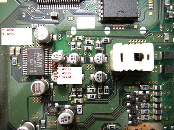

DAC chip power pins
In an attempt to better understand the power layout to the DAC I have taken the liberty of annotating one of Micks photos.
I Think that Pins 2 & 3 are the digital supply (DVDD ) and ground (DVSS) and we can see there is a small ceramic close by. Good !
However the VCOM and the AVDD (analog Voltage) & AVSS (Analog ground) have no traces that are visible. I assume the traces are underneath the chip. There are a couple of ceramics on the underneath, south of the Opamp. perhaps these are decoupling these pins ? I'll check these with a meter, but Christmas preperations are the main focus for a few days .....
