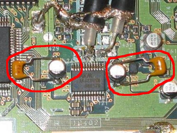

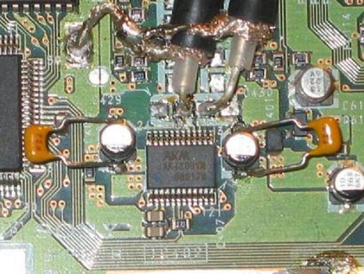

Hi Lostcause
you're right, but desolder all 6 Caps, than use the pad of C429 and C430 and not C424 and C423 like back said. You don't need a 600 R resistor in seies. I'ts verry simply. Use the inner pads of the caps C429 and C430 and go direct to positiv contact of RCA. For GRD use a ground point near the DAC. Than a 1K resistor parallel to the RCA out and finish !!
Look at the picture

Dommi said:
Hi Lostcause
Look at the picture
Thanks Dommi, seems damn simple to me. A common ground for both...OK...would you bridge with the resistor directly on the RCA's? I suppose I could ground just one of the RCA's as they are joined in the T-amp anyway?

Got confused with terminology and opamps 'n stuff!
By the way, the two bypass's on the photo...do these still stand as a good modification?
Lee

My favourite mod is to remove the six caps and use a new cap to go to external RCAs plus an appropriate ground resistor. This is about what dommi is suggesting too.
If you want to keep the RCAs in the original case, I suggest to remove the six caps, replace the jumper (seen on my photos) by a cap and remove the muting transistors. When you are sure that your subsequent stage has DC blockers, you can use the jumper wire as shown.
