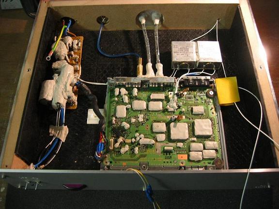

Hy,
i've done following:For the power unit i changed the diodes and used faster one. I changed all caps to MKP. I covered all caps, diodes etc. with lute.(??)
Than i shielded the power board with copper
On main board :
I desoldered the 6 Caps. On the first cap near the AVM ( C429 and C430 ) i soldered a shielded wire at the neg. pad. This i soldered with a new oil/paper cap which is outside the original PS Case. Than i connected a shielded wire from the oil/paper cap to the positiv pin of the RCA which is outside the original PS case, too. I connected the neg. pin with the shielding, and with a ground point of the board. Than i soldered a 1MOhm resistor parallel to the RAC jacks.
The sound intensity is about 5db lower as with op.
At the two caps right and left the AVM i soldered a small fast cap parallel.
Now i will cover all caps and ic's with lute (??) to avoid microfone effects.
I mounted the Laserunit on fixed thread-rods.
On my HP there are some pictures of the old modification .
If you want i will make some pictures of the new mod and set them here, if i can find out how to do ;-))
The power for the blue led came from the 5V DC out at the rear of the PS.
I can't recommend to use the PS without DC-Filter CAP whan you don't know if your pre have one inside the IN STAGE. Most pre haven' t one or only a small one.
Take care if you have a tube amp !!!!!

Rodeodave said:Please, really, in a few words, could you sum up your modifications?
i guess it`s for me so here we go.
dc block caps c 423 c 424 bypassed.
unsoldered muting transistors Q 403 Q 404.
after that nothing is between the DAC and the output except 2 resistors per channel 1k and 100 ohm in series with the signal and two more 100k parallel from output to ground.
new linear regulated power supply 7A.
screwed with rubber feet on a piece af heavy wood (i will build a wooden box later)
everything was done in steps and every step improved
the sound.
