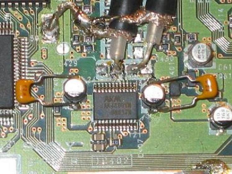

Hello,
i've made a picture of my mod. perhaps now is it easier to understand which kind i've done it
That must be a clean signal! The only thing I'm worried about is that the pads where your coaxes are soldered to may lift. Sony PCBs normally are well made but we never know.
back said:hey dommi since you have done that can you measure the resistance between the channels and the ground?
before the caps of course at the output of the DAC.
i measure very small value 1k strange.
i found out what was wrong.
there are 2 resistors 1k parallel to the output.
i desoldered them and i measured 100k per chanel
but the sound destroyed so i soldered them back.
after that i desoldered the two caps parallel to the output
and the sound became better.
they cause a treble roll off.
so after all the trouble the best sound comes
with 1 resistor parallel to the outout 1k per channel.
and if you don`t have caps to your pro 1 cap 10uf in series with each channel.
DragonMaster said:
That must be a clean signal! The only thing I'm worried about is that the pads where your coaxes . Sony PCBs normally are well made but we never know.
Hy DragonMaster,
what you meen with "..are soldered to may lift" ? I don't understand it.
@back : Can you please read off the number of the caps you meen and the resistors ? Or better can you please make a picture ? Or please try to explain it again because i don't undersood the last 2 Part's.
I have to learn english
BR Dommi

Hy back,
in my configuration there are only the new cap's and the 2 1MOhm resistors parallel to the RCA's. What should i measure ?
Regards Dommi

forget it i measured it myself.
why you have 1mohm resistors parellel with the output?
aren`t they too big?
the originals are 1k
Dommi said:@ back
I will try it first with 1 MOhm, than with lower values. But i think 1 Mohm is o.k. We will see
Dommi
when i desoldered the 1k the impedance was 100k (i think that`s the internal impedance off the DAC) and the sound very bad so soldered them again.
try 1k and tell me the results.
