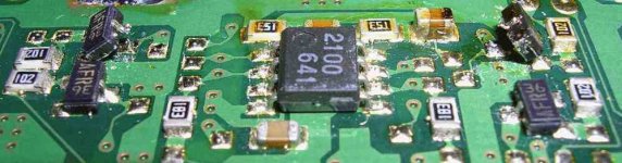

OK so here's the muting stage transistors disconnected.
Note that I didn't disconnect the AV MULTIOUT ones as I did not reconnect the caps.
And I just noticed that we can actually see the markings on the transistors. I wasn't able even with a magnifier.

is it right, that you disconnected the transistors but you leave the resistors ?
Another question : on your picture you removed the caps left and right of the AVM. Aren't there for buffering the pwr. supply of the AVM ?
quote:Even if you connect it directly to the RCA jacks, the muting stage is still there.
No, you can remove the 2 100ohm resistors or sever the positiv line of the RCA's on the board.
Yes. The other side of the resistors are connected to nothing now.
Yes, there's that too but it's harder to do.
I just removed the 6 caps. Maybe they are not in the pic. Or maybe I have a different board revision (I have PU-8)

dragonmaster, sorry but i have to contradict. If im not wrong you soldered the bypass connection on the pad before the 1K and 100 ohm restrictor. So the ristrictors are in the signal path.
2. You haven't a dc-blocker cap in the output stage, if your pramp haven't a dc-in cap blocker you might have problems.
@jives : Try to find the 100 ohm restrictors, solder them out like the transistors and connect your cap at this point. You will see that the bass-performance is better.

About the muting transistors, in every CDP I used, the transistors were only stopping the pop when the CDP was starting or stopping. They can only mute so they shouldn't work when playing music.

OK so I lifted the leg of the transistors as per Dragonmasters instructions which were very easy to follow. Not yet had time to check the sound
I was investigating the remaining resistors then I noticed this unidentified SMD in the signal path.
On my SCPH 1002 if I trace the Left & Right signals from the DAC, past the opamps then close to the RCA sockets. The traces seem to converge around a dark gray block with 6 solder pads and red ends. It appears to be in series with the signal and has resistance lower than I can measure , so I guess it's not a transformer. It's much bigger than the transistors.
Anyone know what this is ?
