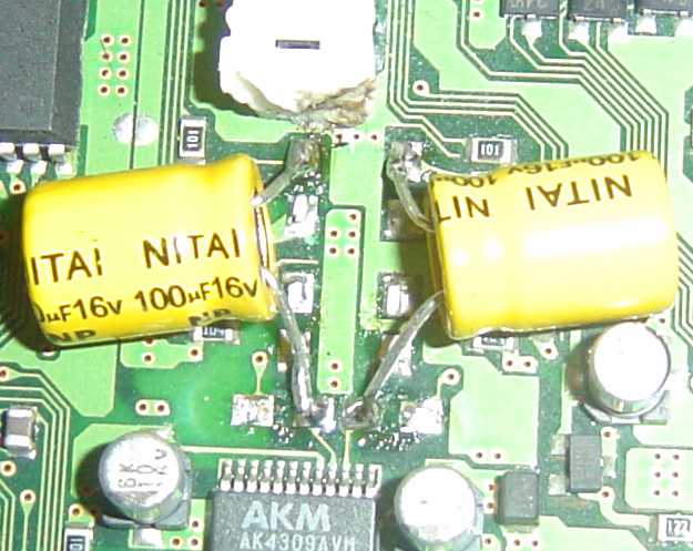

well I followed dragonmaster instructions and removed all 6 caps.
I them shorted the input of the first cap pad (+ve) to the output of the last cap pad (also +ve ? which I still don't understand)
anyway I followed the pdf that Dragonmaster did.
I decided not to remove all DC blockers as I might use with a different amp in the future (T-amp) so didn't want to leave a surprise for myself 🙂
So I used a pair of Nitai 100uF/16v bipolars to join the pads
As Dragonmaster described I desoldered one pad and bent the old caps back. Most actually came away at this point. I then melted each pad to give a nice solder dome for each one. it was then easy to solder the caps on their side (not much height clearence ). An axial would be easier here.
Sound is better for sure. More bass, and none of the slight grittiness I perceived before. I could use a bit more bass, but maybe that needs more PSU work.

With these caps a) I had these caps in my parts bin and b) the signal goes through 4 of them up stream in the preamp anyway.
below is a picture showing that a) my photography is getting slightly better but b) my soldering shakes have taken there toll on the poor old saftey switch at the top
