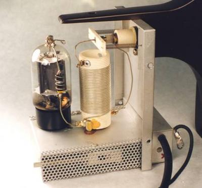

Look at this picture for understanding:
First biild it. Then you will see and learn !
