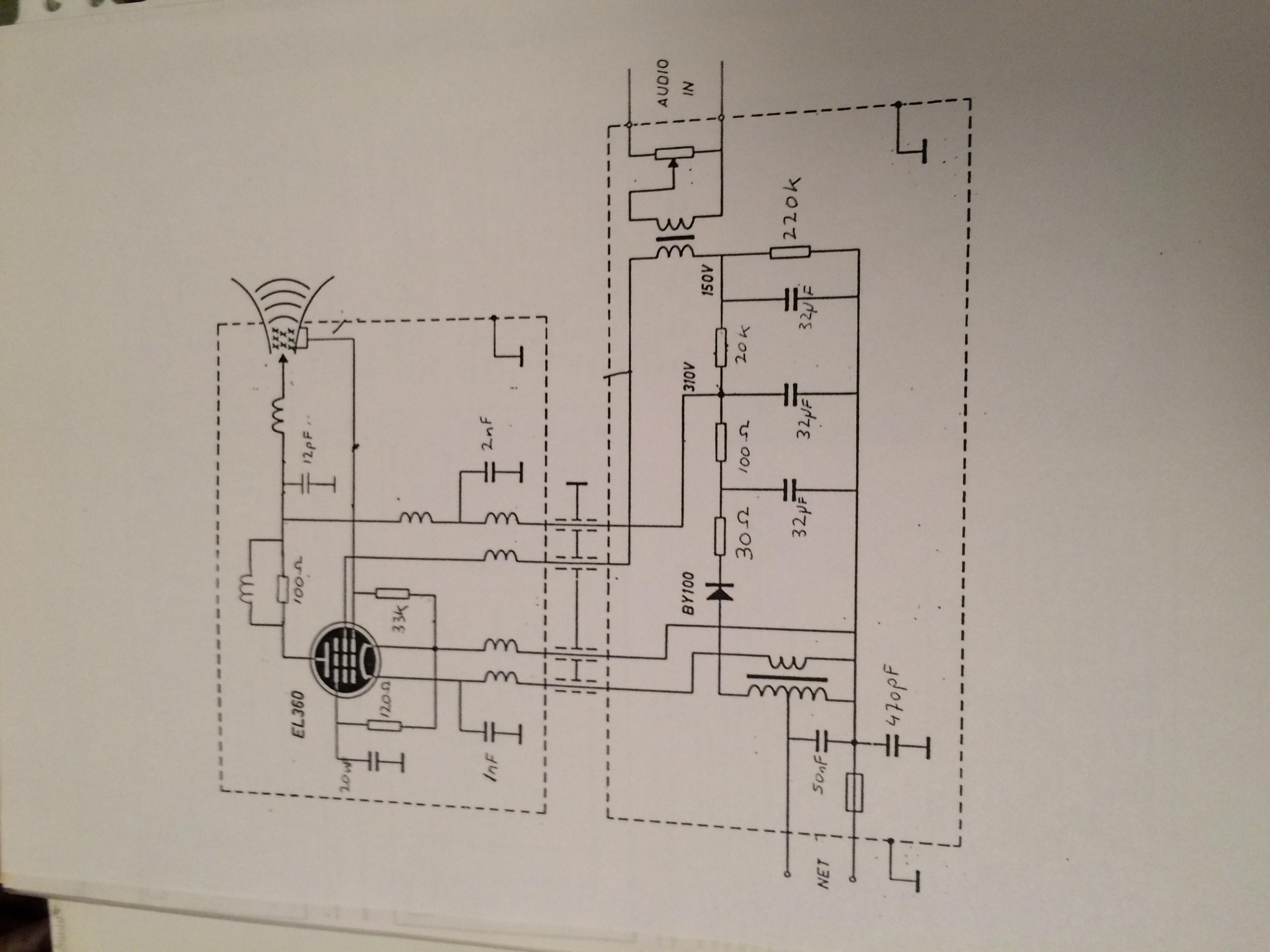

Hi Chris, tubes are forgiving when pushing too hard during experimenting. So it is easier to start a project with them. The additional heater power supply is no fun but now we can get cheap switched mode psu’s. The high voltage should not scare you of but arrange some fuses or current limiters in case something goes wrong. Best you start with a proven circuit like the one i provided in a previous entry. Good luck !
Best regards, Frank
Best regards, Frank
I have found some documents on this topic that i collected over the years. When ever i find more i will place it.
