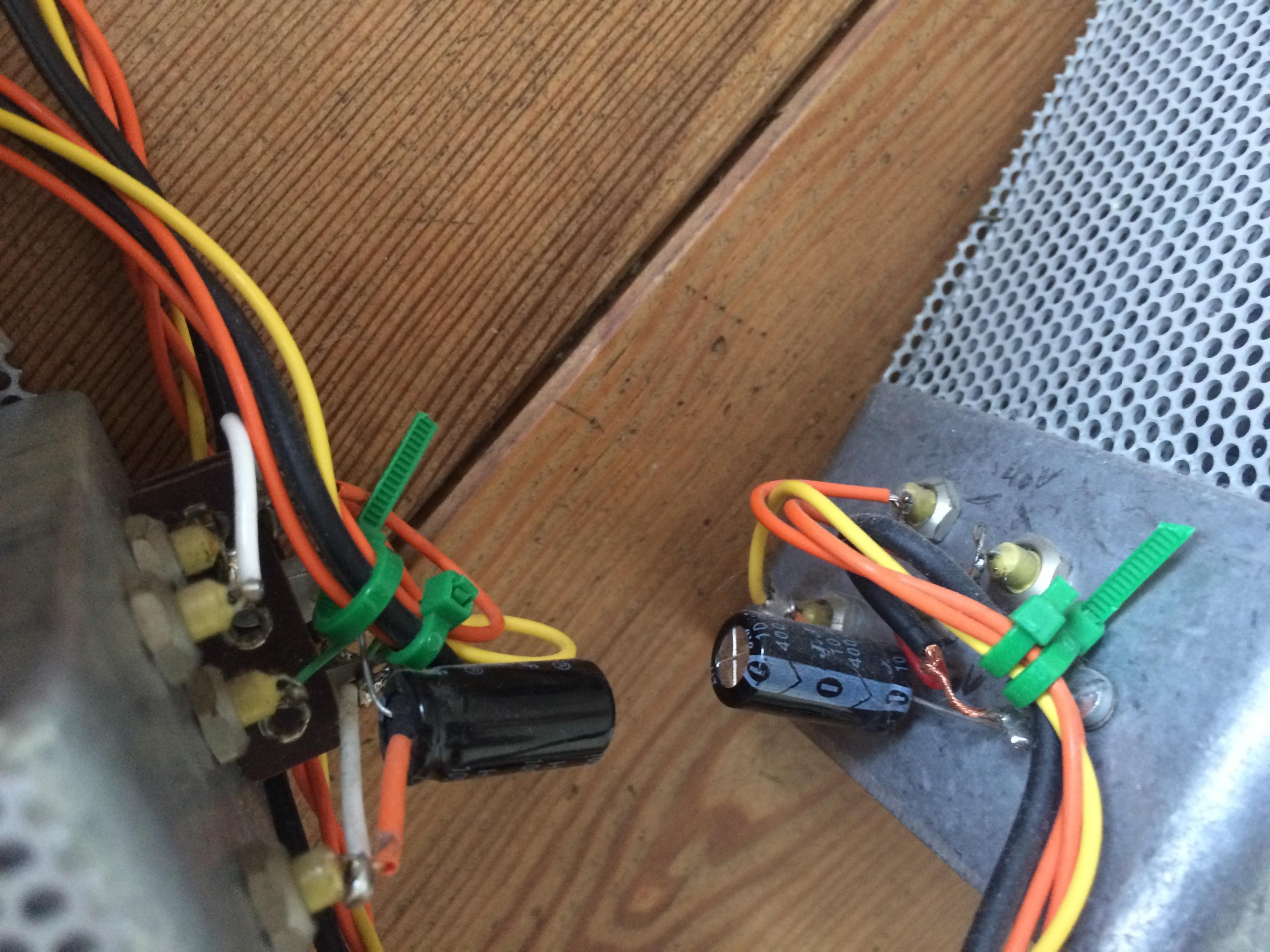

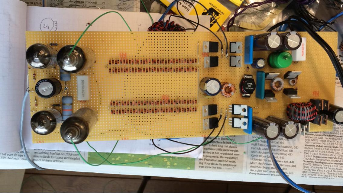

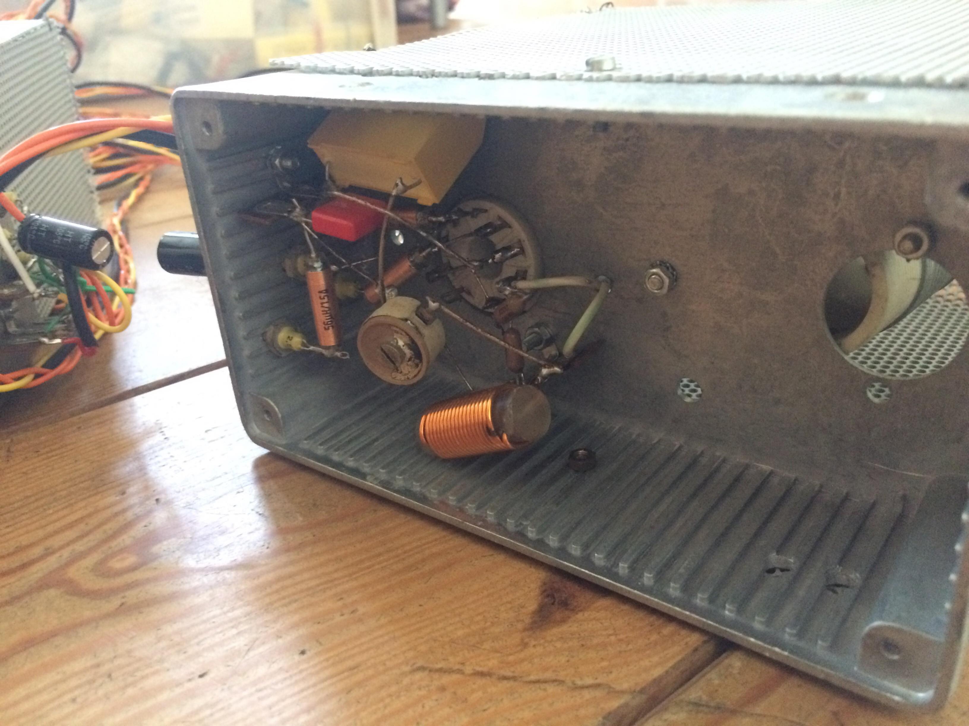

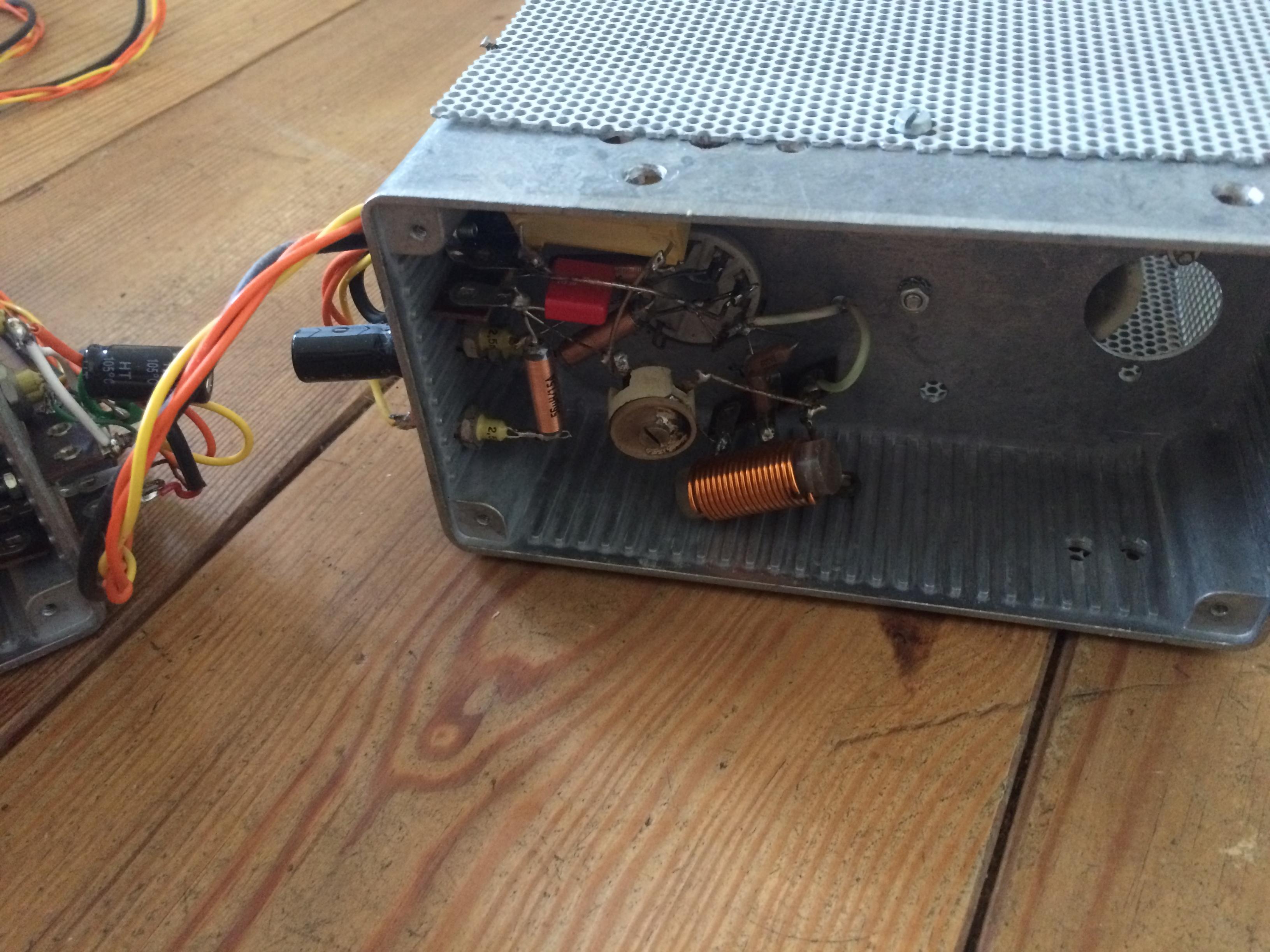

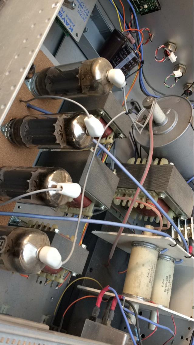

I would use no transformer but if you do then choose a toroid or c core transformer 230v to 15v or so (in reverse). Choose higher anode voltage otherwise the audio signal will stop the oscillation at high gain. I found my old diy plasma’s and made some pictures.

I used 310v on the anodes and about 60 to 80v on the screen, depending on the current i liked to draw (flame size). Naturally that depends on the tube you will be using. My favorite is the EL/PL519 (Lampie519).
If you choose a higher anode voltage then you will need to reduce the screen voltage. If the anode gets too hot (red glow) you will need to replace the tubes more frequently. Try to prevent this. Tubes are forgiving when it happens not too often. If oscillator does not start you also will draw to much current. I use a regulated PSU when experimenting. Then i can see exactly what current is drawn. Plus i can adjust the voltage and see what happens before blowing up stuff.
